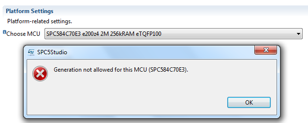

Generation not allowed for this MCU (SPC584C70E3)
Siva Sankar Chandika
Posted on December 12, 2016 at 07:06
Hi, this is siva sankar chandika from Embitel technologies from bangalore please help me to choose
SPC584C70E3 microcontroller in spc5studio chorus 4M family
Thanks in advance.
Looking forward for your response.
Regards,
SIVA SANKAR CHANDIKA,

Hello Siva ,
the version compliant for SPC584C70E3 is a engineering release for key customer.
(not present in Public release)
it is a version focused for the Pinmap Wizard.
We can not generate the code.
   Best Regards
                  Erwan
