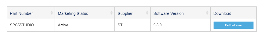

Just upgraded to 5.8.0 (the ONLY and LAST available version on ST website), and we ran into a lot of troubles. First of all, SPC5STUDIO updates URL had to be fixed because of the lack of trailing "/". Once fixed, we're still unable to install/update/download anything because of a 404 error. Who's the guy in charge of tests ?
Before replying by a "please update to 5.8.1", be aware that there's no "5.8.1" version available at the ST website :
Where's that 5.8.1 ? Please provide a link asap since we're stuck.
