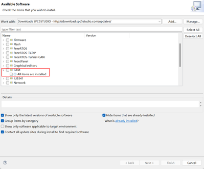

Hi Erwan,
I cannot also access to http://gtm.spc5studio.com, so in order to run sample, SPC572Lxx_RLA GTM DPLL Test Application for Discovery, do I only need to send an email to credentials@spc5studio.com for authorization of this sample? Thanks!
To run SPC572Lxx_RLA GTM DPLL Test Application, the library url is http://download.spc5studio.com/updates
Install directly from default spc5 studio installation.

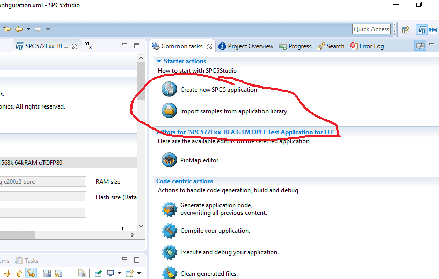

Hi Jmary,
Please refer to the pic below.

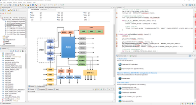

then how to import SPC572Lxx_RLA GTM DPLL Test Application project? I cannot find it. Thanks!
Hi Jmary,
Thank you very much.
