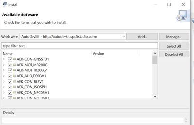

Where can to find the available demo for the AEK-MOT-WINH92?
Zhc
In the AutoDevKit,I can't find the demo of AEK-MOT-WINH92 to drive a motor,so where can i find?
Max VIZZINI

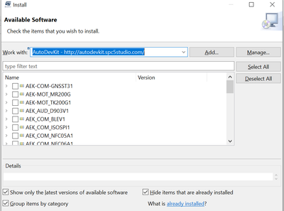

You need to install online updates of AutoDevKit Studio.
Help>Install New Software

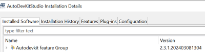

When you finish with the installation, check the "already installed" link in the same location:
You should AutoDevKit Group feature version 2.3.1.xxx

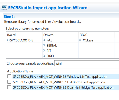

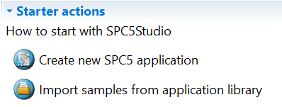

The  import samples from application library button
Select Chorus 4M platform and following examples to import shall appear:
