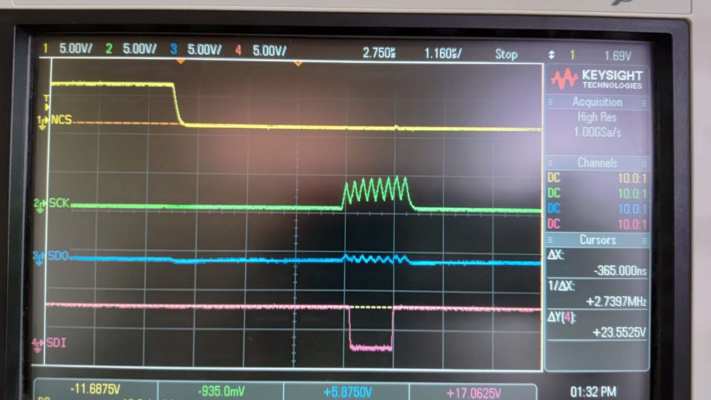

Hello team,
I am using the GUI demo (single) for BMSCCTX and C4MINI with 4 LFP Batteries. I have followed the steps described by @ritehracingteam in this thread.
After I run the program from the AutoDevKit Studio, my D9 and D2 LED are lit up and D8(Blue) is blinking. D7 remains turned off. Which according to the documentation means SPI is not working.
I made sure Hotplug connection is made and the pin configuration is correct, also checked all the connections.
Is there something I might be missing?

Hi Zen,
From the signals it seems you are missing GND reference.
Make sure to connect the GND of your BMSCCTX to C4MINI GND

Hey Simone,
Thanks for the reply.I checked the connections and the Jumpers they are in the correct configuration as you suggested.
I am attaching the Oscilloscope reading please see them. The SCK reading is similar to @ritehracingteam issue, but the hotplug connection is there. I measured the voltages and found:
VREG = 6.6V, VCOM = 5V, VANA = 3.3V but VTREF = 0. I believe this is the default setting for the L9963E from datasheet. Although in the BMSCHAIN component VTREF is set to always on (5V). ISOLp and ISOLm are both +1.2V w.r.t to GND_BMS. I don't see any activity.
I also tried connecting the hotplug connection to VREG instead of VTREF, same results no changes.

Hey Simone,
I tried changed the SCK pin setting from weak drive to strong drive since the clock was not square(See pic), still no D7 LED. Moreover after changing any setting in the demo the D2 LED doesn't light up. It only works with the demo as is. Is the L9963T faulty? Should I get a new board?
Regards,
Zen
Weak DriveWeak DriveStrong DriveStrong Drive

Hi Zen,
