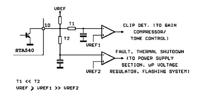

I have a question about transistor's connection to the GND (pin nr.:10).
To which one (SGND or PGND) E of this transistor is connected?
Datasheet: Doc ID 13907 Rev 6, Figure 28.
