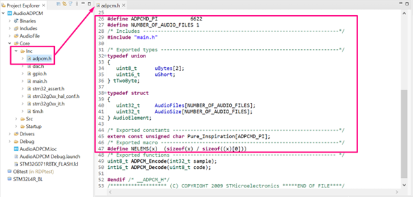

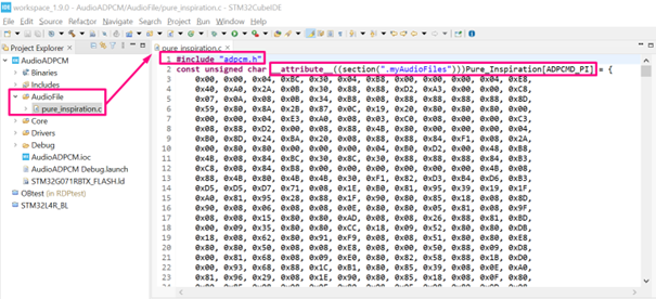

Now, on the audio file, you can use the __attribute__((section(".myAudioFiles"))) to place it in the newly created section in the external memory. The reason we add the audio file array with the attribute is to create a binary with both the program, and the audio file the audio file binary will have different address based on the linker script settings and this will be used by the STM32CubeProgrammer external loader to program the audio file array portion in the external memory and the code in the MCU's memory. As the C vector file created can be edited, it is suggested to create a define for the size and add this define in the “adpcm.h”, thus adding these modifications:
In the adpcm.h, these small modifications were made to create the defines used previously and to create a structure that will allow multiple files to be loaded
#define ADPCMD_PI 6622
#define NUMBER_OF_AUDIO_FILES 1

Note that the #define ADPCMD_PI 6622 should reflect your actual vector size and you can customize the name. As this implementation only deals with a single audio file, we use this: #define NUMBER_OF_AUDIO_FILES 1
