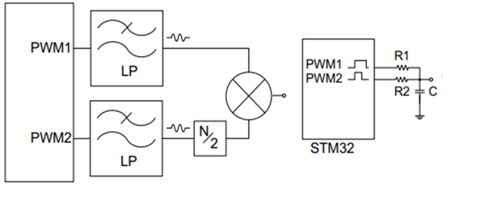

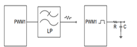

Before diving into the firmware, a few notes about the hardware construction. We’ll aim to have a 16bit resolution in total when using the PWM. This will be implemented with separate 8-bit MSB using TIM3 channel 1, and 8-bit LSB using TIM3 channel 2. To achieve this, the PWM output pins must pass through combined low pass filters as shown in the image below – note that there is a relationship between the resistor values, where R2 is obtained by dividing R1 by 256:
Alternatively, for a simple experiment, you can use just the MSB portion (TIM3 channel 1) and have a simpler low pass filter, like this:
The actual values used for this demo were: R1 = 8.2KOhm, R2 = 33Ohm C = 10nF, but the demo was also tested using only the PWM1 (no R2 connection), which provided a good output audio overall as well.

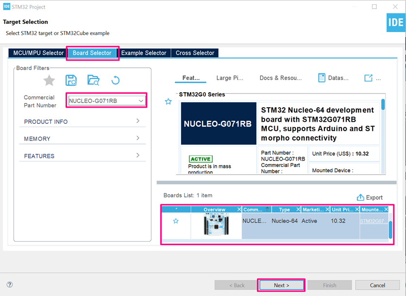

  1. Open the STM32CubeIDE
  2. Go to File->New->STM32 Project
  3. Go to the second tab “Board Selector” and type “NUCLEO-G071RB”
  4. Click on the board and then “Next”
  6. Name the project and click Finish
  7. When the pop-up message appears, make sure to accept the peripherals with their defaults

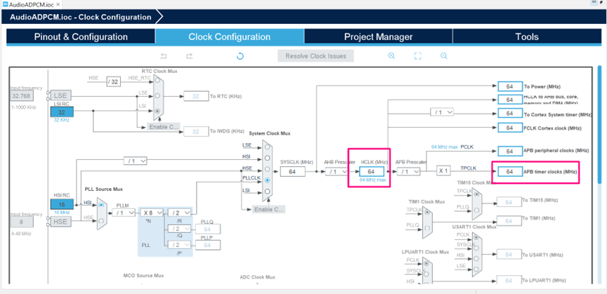

Start by making sure your clock is set as 64MHz, this can be done by going to the “Clock Configuration” tab and asserting the value if needed:

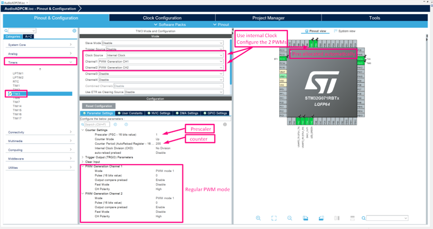

Back to the Pinout & Configuration Tab, add the TIM3 and configure it like this:

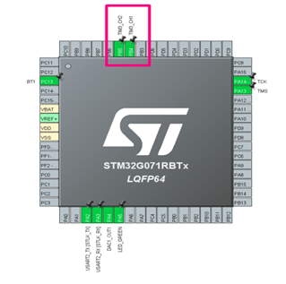

Note that for this demo, the PB4 and PB5 are the pins used for the TIM3_CH1 and TIM3_CH2 respectively:

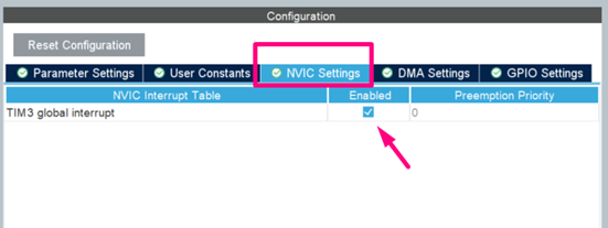

Enable the TIM3 interrupt:

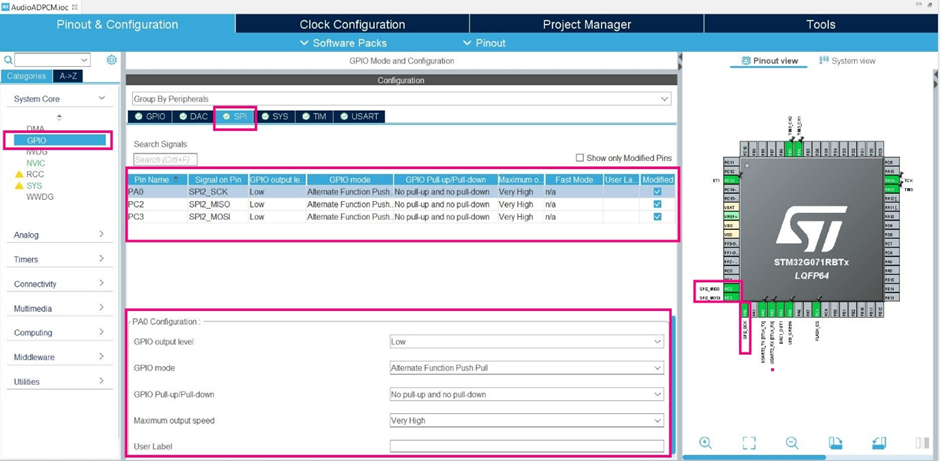

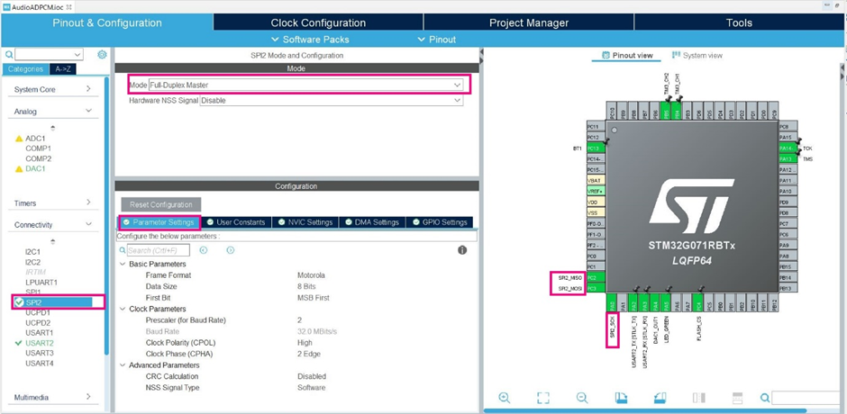

SPI2 Configuration on Pinout & Configuration Tab, add the SPI2 and configure it like this:

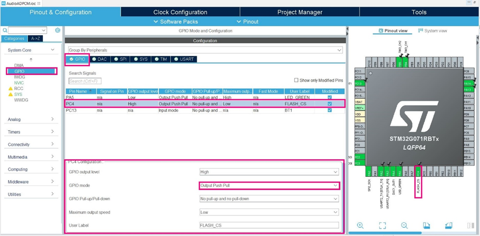

Pins PA0, PC2 and PC3 are used as SPI2 CLK, SPI2 MISO and SPI2 MOSI
respectively. As you might have noticed, the chip select pin configuration (NSS signal) is set to be handled by software, this means we’ll have to manually configure the GPIO pin PC4 as GPIO Output to drive the external Flash’s Chip Select

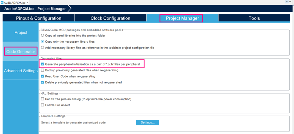

This implementation also used the Code Generator settings to split the peripheral initialization as a pair of source and header file, this can be achieved by going into the Project Manager tab/ Code Generator as shown below:
Now, you are all set to generate your project, so either use the short cut “Alt+K” or go to Project->Generate Code.

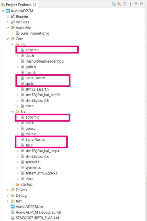

Once the files are created, you need to manually copy the SerialFlash.c and SerialFlash.h the flash driver created in this article
How to play audio files from External Flash memory using STM32?”. Also copy the adpcm.c, adpcm.h files from the STSW-STM32022 pack into your STM32CubeIDE project as mentioned in the previous article, under the Core/Src and Core/Inc folders.

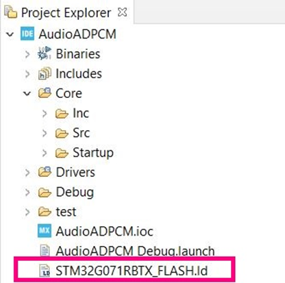

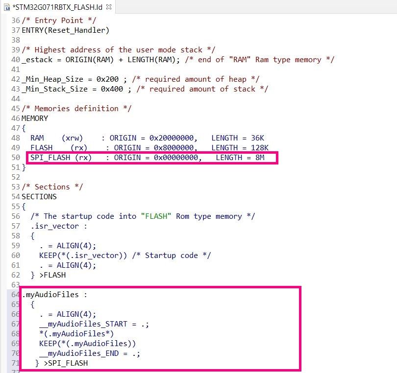

To prepare the External Flash memory section we need to edit and add this section into the linker file. The linker file is the STM32G071RBTX_FLASH.ld:
Once opened, add the lines below, where the external memory position is mapped on the linker by creating a section called “myAudioFiles” :
/* Memories definition */
MEMORY
  RAM    (xrw)    : ORIGIN = 0x20000000,   LENGTH = 36K
  FLASH    (rx)    : ORIGIN = 0x8000000,   LENGTH = 128K
  SPI_FLASH (rx)   : ORIGIN = 0x00000000,   LENGTH = 8M
.myAudioFiles :
    . = ALIGN(4);
       __myAudioFiles_START = .;
       *(.myAudioFiles*)
       KEEP(*(.myAudioFiles))
       __myAudioFiles_END = .;
   } >SPI_FLASH
