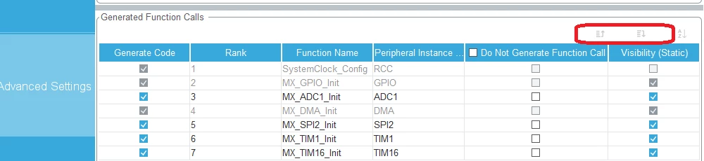

DMA not working in CubeMX generated code - order of initialization
Here is a (possibly incomplete) list of threads affected by this CubeMX issue:

[EDIT] Official method to fix the incorrect order, if project was generated in "incorrect" version of CubeMX: https://community.st.com/s/question/0D53W00001EzCmCSAV/mxdmainit-order-in-the-mainc-file-generated-by-stm32cubemx-how-to-fix

Here is the official method to fix the incorrect order, if project was generated in "incorrect" version of CubeMX:

> Unfortunately, the bug persists in version 6.5
Are you talking about a project started freshly in v6.5? If you migrated projects started in older versions, see last link in the initial post for the official method to fix.
> Why is my USB Virtual Com Port UART (UART3) initialization order entry grayed-out?
I don't know, but you may want to start a thread describing exactly what you've done and what are the symptoms, to allow the Cube crew to reproduce the problem and react adequately.

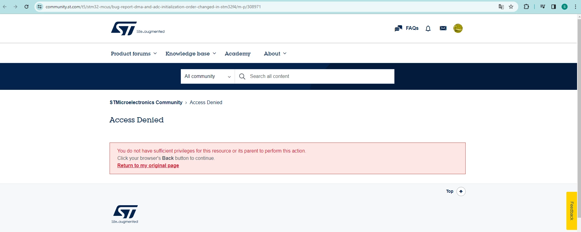

Mar 27, 2024 3:40 PM UTC
Hi, I'm new here, could someone please explain why can't I open some issue pages?
Thank you in advance.
waclawek.jan
Mar 27, 2024 3:47 PM UTC
This forum underwent migration to a different software, and some threads did not get migrated correctly. ST may fix this in the future.
I'm not sure you need to see that particular thread, though; they all were related to the same underlying problem, as discussed further in this thread.
