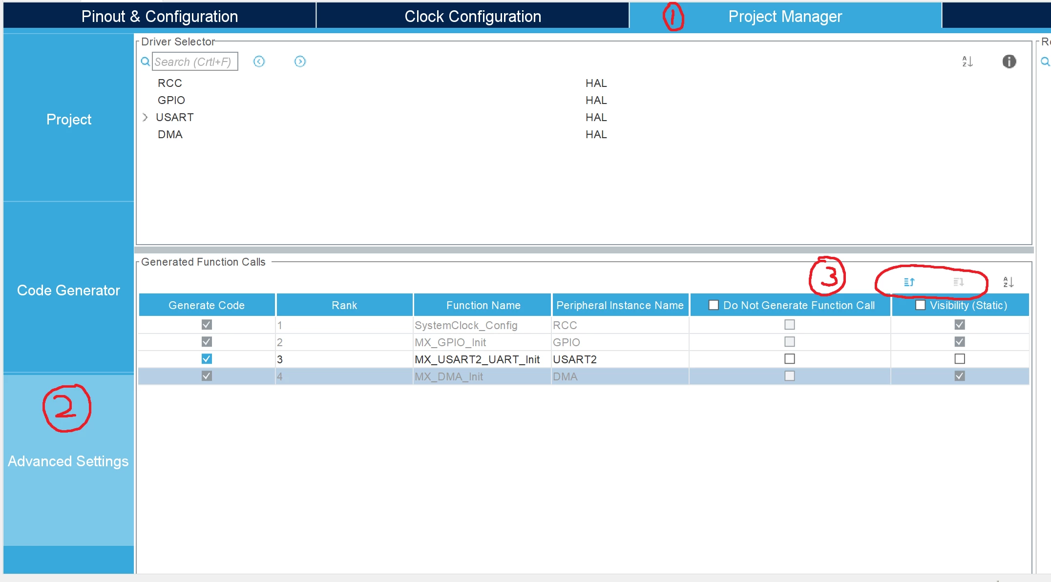

Can't edit, so just to note that manually changing the order in `main.c` actually didn't fix the issue. The correct fix is to re-order in the Device Configuration Tool -- as noted in https://community.st.com/s/question/0D50X0000Boy3eVSQQ/cubemx-540-generates-broken-code-for-stm32h7-stm32h7432-sai-dma
Use the buttons (3) to move `MX_DMA_Init()` above the peripheral init

(CubeMX v6.5)
Why is my USB Virtual Com Port UART (UART3) initialization order entry grayed-out?
(For that matter, why is the DMA init grayed out, and prevented from being moved?)
This prevents a user fix by moving the DMA init to the top!
