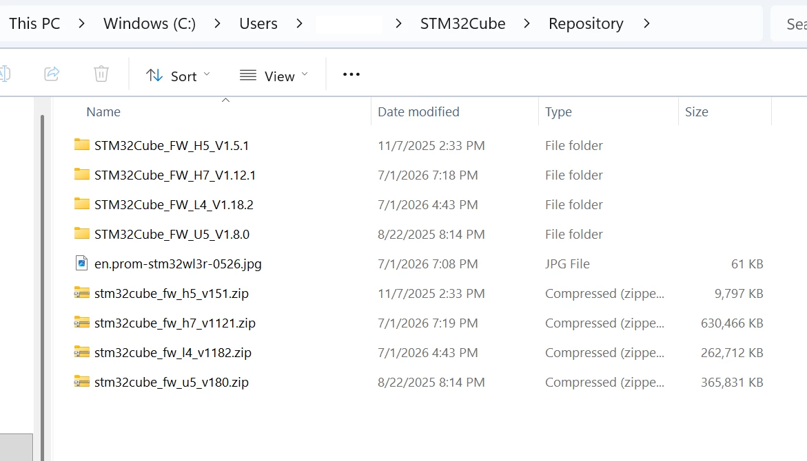

I know there is a newer version of this (v2.2) but I'm still on the old one. I can click the ok button on the "Download has failed, some data may be not updated. Please retry later" window and the target selector shows up but the project I make (TestH7A3VIT6) for STM32H7A3VIT6 has an exclamation point on a triangle in it.
BTW I'm using this in my windows 11 laptop and there is no crdb.zip in the repository folder.

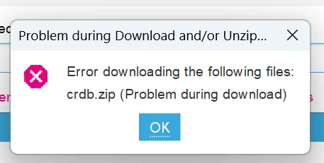

Hi everyone,
I'm experiencing the exact same issue as described above on STM32CubeMX6.16.0 at my environment.
As a workaround, I tried manually downloading crdb.zip in the browser, following the steps described in this thread, but the request just times out as well.
Could this mean the server hosting crdb.zip is currently down?
Thanks in advance for any info.

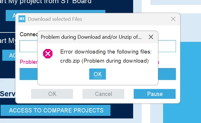

I just downloaded and installed STM32CubeMX 6.18.0 and after I click on “ACCESS TO MCU SLECTOR” I get the same error. It looks like the server has a problem. I wonder if me picking “Install for all user” instead of the recommended “for me” has anything to do with it? Anyhow … I’m glad is not STM32CubeIDE v1.19.0. Hope they fix it soon… thanks.

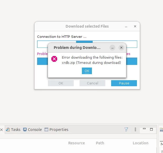

I am having the same issue on Ubunutu noble(24.04) , STM32CubeIDE ver 1.19 . I tried to download the files via terminal using curl. I tested two seperate networks + one time with vpn but it seems like I couldn’t connect to server the files are supposed to be downloaded from. Please lmk if you find a solution.

The problem is not just STM32CubeIDE v 1.19.0. The latest STM32CubeMX (version 6.18.0) that I tried also has the same error.
Andrew Neil
Aug 10, 2026 3:57 PM UTC
That’s not the latest!
6.18.1 is now (since 31Jul)  available, and fixes this issue:
