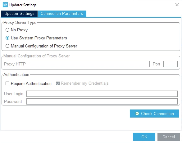

Could you please retry to delete the crdb.zip and try to download it manually by opening this URL on any web browser:
http://xsel.stmcufinder.com/refresh/v2/crdb.zip ( the manual download should be attempted on the same machine you are running CubeMx) then restart CubeMX and check if this workaround can help you to resolve Data Refresh problem.
Also, could you tell me if you had 2 CubeMx instances started when the problem occurred ? and what type of Proxy Server are you using ?

I deleted both the crdb.zip and crdb.db (database file) and replaced it with the crdb.zip and crdb.db (inside the zip file) from the link you provided and the Data Refresh problem still occurs.
Yeah - I had two CubeMX instances open when the error occurred, but I usually have 2+ instances of CubeMX open before and the error wasn't there (I usually have one window open for a new project and other windows of past .ioc files open). Regarding the Proxy Server Type, I have No Proxy (am not using any Proxy).
Thank you!

Ahmad M.Nejad
Jun 4, 2021 7:38 AM UTC
0693W00000Ba51oQAB.pngAbove setting solved my problem
