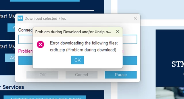

Workaround for file download error: crdb.zip (Problem during download)
An issue has been identified in which STM32CubeMX displays a download error pop-up during data updates.
This issue does not prevent STM32CubeMX from working properly. To continue:
Click OK  twice.
After these steps, STM32CubeMX can operate normally.

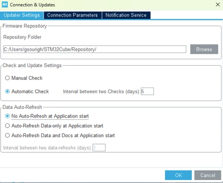

If this pop-up affects your workflow, disable the Auto-Refresh feature:
In Help → Connection and Updates, select No Auto- Refresh at Application start.
Please note that if Auto-Refresh is disabled, STM32CubeMX uses the local cube-finder-db.zip file and does not retrieve updates automatically.
If needed, manually update the data:
Help → Refresh Data
A fix is in progress in a future version.

Explorer
Jul 8, 2026 11:33 AM UTC
Question is if it’s gonna work with new installed program without downloading that file before.
Ghofrane GSOURI
Ghofrane GSOURIAuthorBest answer
Jul 8, 2026 12:03 PM UTC
Hello ​@Rampi
Yes , STM32CubeMX should work after a new installation even without downloading that file crdb.zip
THX
