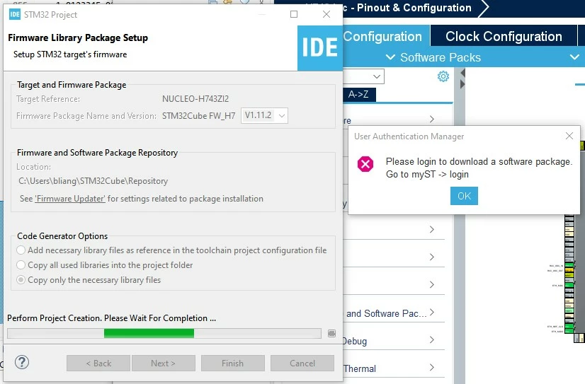

When I try to create a new project for NUCLEO-H743ZI2, STM32CubeIDE asked me to login myST to download software package. But when I tried to login, it hangs there. I checked the forum for solutions:
https://community.st.com/t5/stm32cubeide-mcus/myst-login-issue-in-stm32cubeide/td-p/575447
and
https://community.st.com/t5/stm32cubeide-mcus/stm32cubeide-login-issue/td-p/658990
But unfortunately both doesn't work.
Anyone could help me in solving the problem?

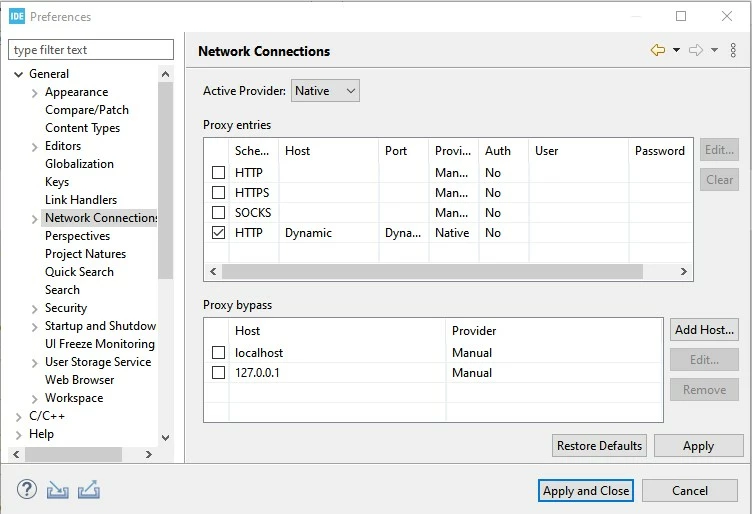

    Following the fixing suggestion from Palak, the network issue is solved.
    https://community.st.com/t5/stm32cubeide-mcus/unable-to-login-to-st-account-in-stm32cubeide/m-p/671082#M27051
    Indeed it is my company's IT proxy setting that blocks STM32CubeIDE from connecting to the STMicroelectronics server.

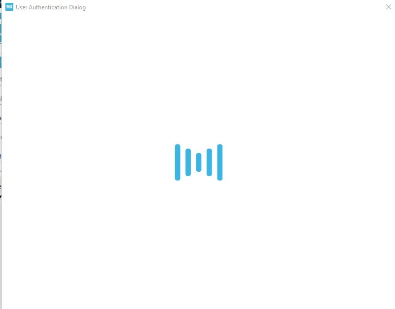

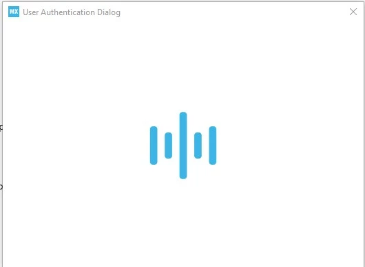

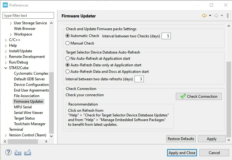

    May 7, 2024
    The network check is OK. But still the User Authentication Dialog hangs forever. Please kindly help! Thank you in advance.
    Screenshot 2024-05-07 110704.jpgScreenshot 2024-05-07 110735.jpgScreenshot 2024-05-07 111013.jpg
    nickliangbinAuthorBest answer
    May 9, 2024
