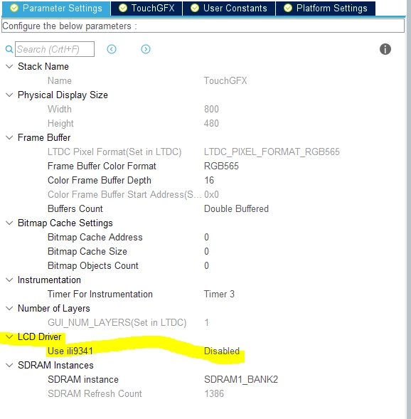

NSeba
Sep 24, 2019 5:48 PM UTC
Sir,
Thanks for the consideration.
I got it correct and compiled successfully , I missed enabling some interrupts as in your example.
  1. I am using an LCD without controller (800*480) connected to LTDC. Disabled ILI 9346 in TouchGFX Parameter. Am I correct ?

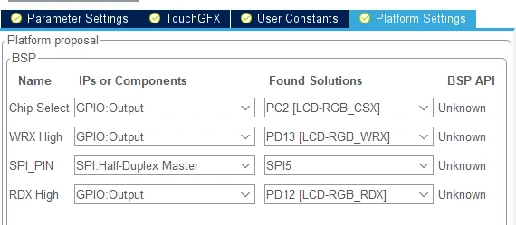

  2. Even after that the system is asking to specify other pins and SPI which are not in my LCD (platform settings). Will it cause any issues ?; I am yet to test it on hardware.
  3. How to interface my touch controller XPT2046 with touchGFX ?

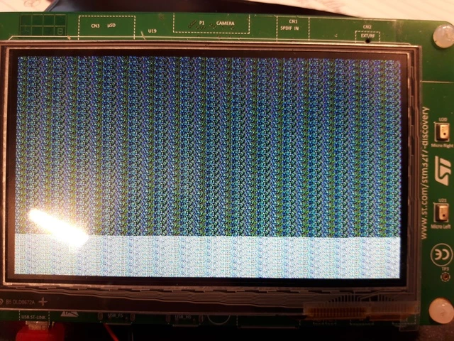

Cvega.11
Oct 29, 2020 7:13 AM UTC
0693W0000059guTQAQ.jpghello friend
Touchgfx does not work for me, I get the pixelated screen I use stm32cubeide 1.4.0 it does not work for me download version 1.2.0 and also download TouchGFX V4.14 and nothing, change the version ==> V4.13 and still some help friend , I hope you can help me ??
I made a simple program in touchgfx and there it works, but the detail is that I use LWIP in my program, I need to use it from stm32cubeide
