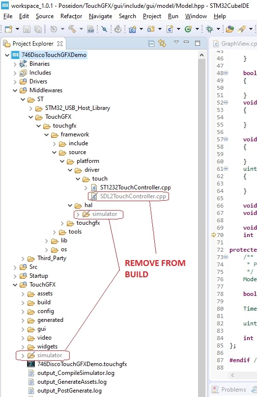

Due to an increasing number of people having issues with CubeIDE and TouchGFX Integration i'm attaching a working project for STM32F746G-DISCO for your inspection - There were a good number of things to do before it worked, only some of which i highlighted in my quick-guide and even some of those steps were a bit ambiguous and could be executed in different ways.

Finally got it working... have to re-exclude folders and files *each time* the code is regenerated ! And also re-edit the .touchgfx file
& relaunch code generation several times !! Really time consuming ... Hope a better integration in CubeIDE will arrive soon.

yes, there's an issue that every time you re-generate code you'll get your modifications overwritten.

Glad you got something working. About "generating code", then you're in luck, because in 4.12 (we're going to skip 4.11) code generation is a manual thing.

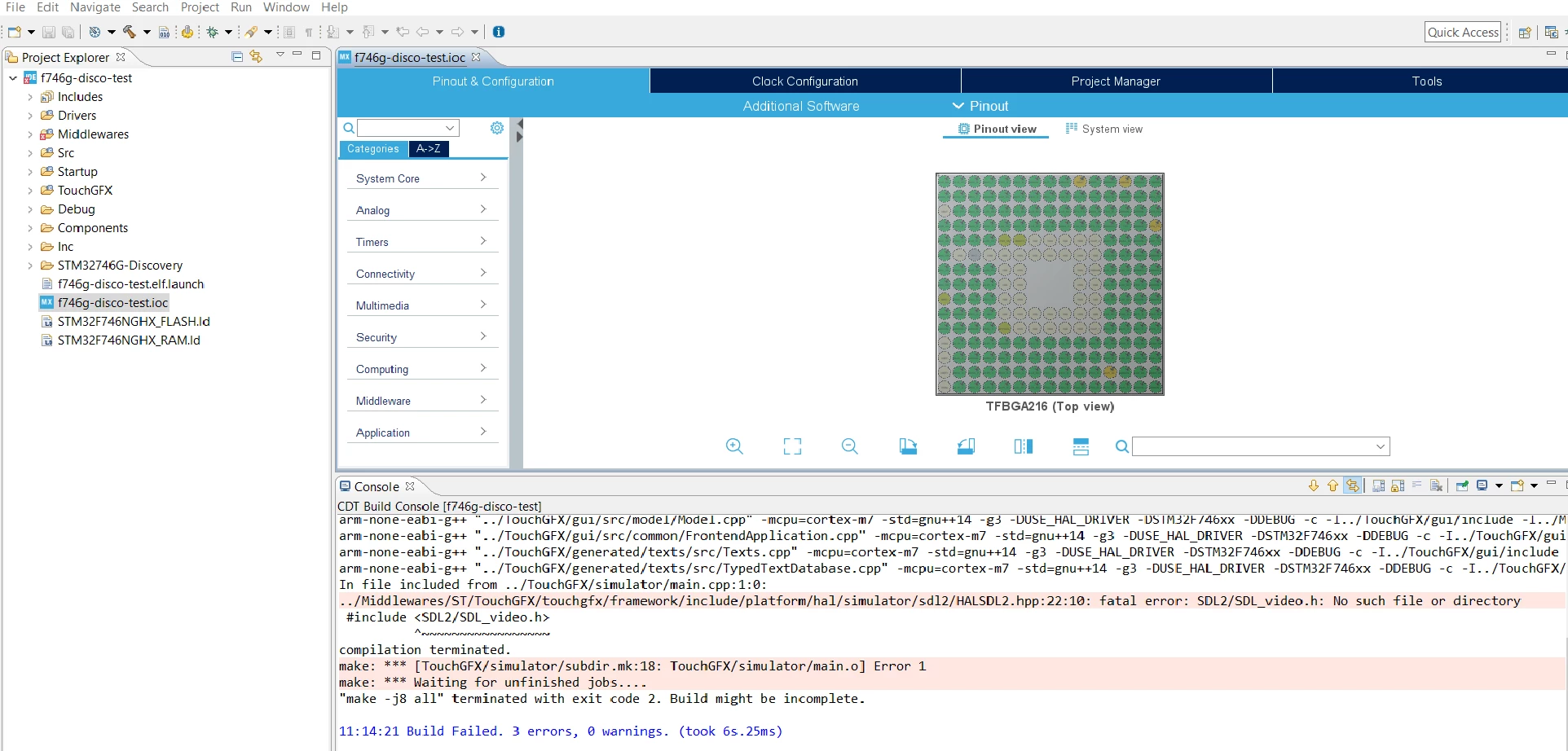

I can't solve the issue "../Middlewares/ST/TouchGFX/touchgfx/framework/include/platform/hal/simulator/sdl2/HALSDL2.hpp:22:10: fatal error: SDL2/SDL_video.h: No such file or directory"
exclude simulator doen't fix it.
What other changes did i need to do?
Martin KJELDSEN
Principal III
Jun 20, 2019 10:49 AM UTC
Can you post your entire error log? There are a number of simulator files/folders to exclude

It complies fine when I migrate it to CubeIDE. I am getting the following error once I compile after opening f746g-disco-test.ioc file to make changes to configuration. It asks me to migrate and I click yes. Compile straight away without making any change and it throws these errors. I am on version 1.0.2 of the IDE.
Any ideas?

as shown in the video I think you must remove some files and directorie from project build.

This does not always work. I have gotten STM32CubeIDE into a state where even when selecting some items to "Exclude Resource from build", it will still fail to compile because it still attempts to include them (even after explicitly telling it not to).
What I have done to alleviate this problem is edit the actual project file (as mentioned previously in this thread). A good idea is to keep the project in a repository (I use SVN) and restore some of the changes that have been altered as a result of a STMCubeMX code generation.
I have yet to determine exactly what needs to be changed, however.
