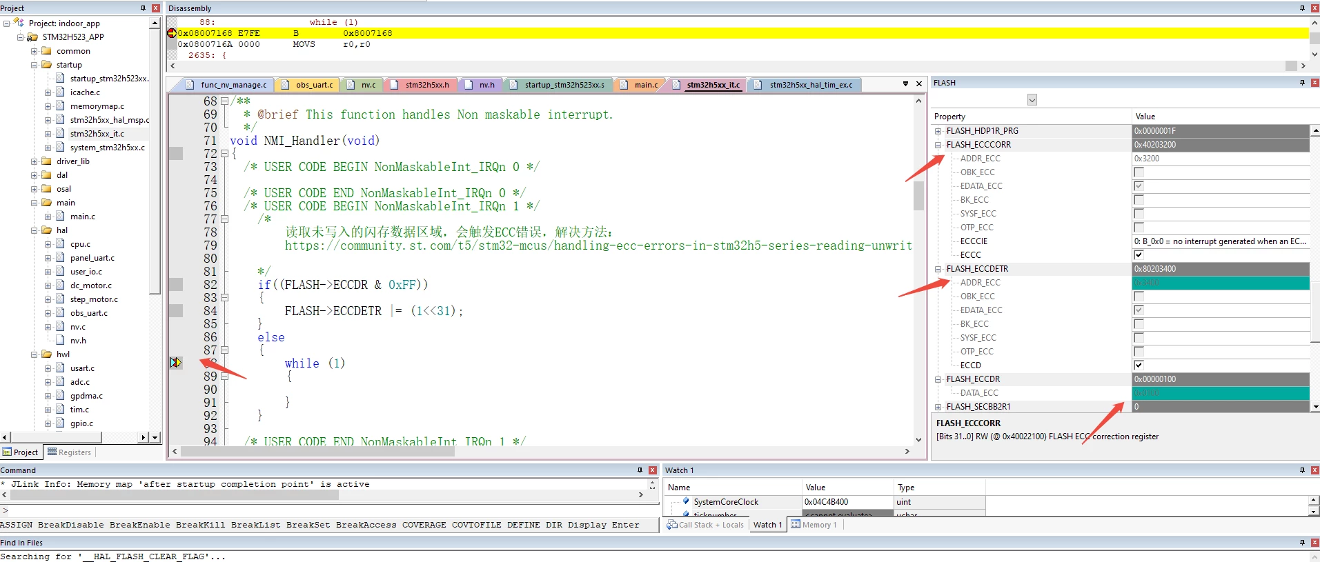

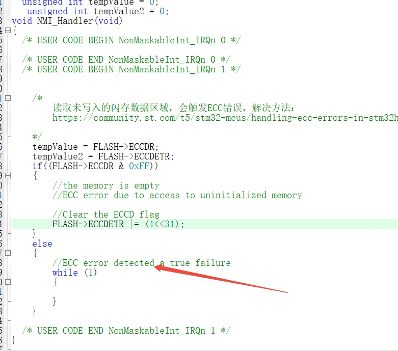

stm32h5 high-cycle flash NMI_Handler

Dear @aa3 ,
You can refer to this Knowledge Article
https://community.st.com/t5/stm32-mcus/handling-ecc-errors-in-stm32h5-series-reading-unwritten-otp-and/ta-p/750986
and pay attention to configure the MPU to this Area using this Knowledge Article :
https://community.st.com/t5/stm32-mcus/how-to-avoid-a-hardfault-when-icache-is-enabled-on-the-stm32h5/ta-p/630085
Hope it helps you .
