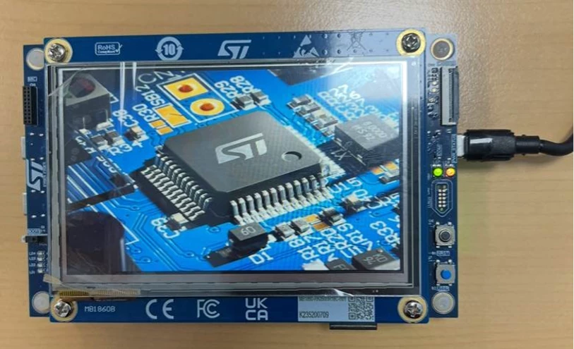

How to use XSPI external flash to display an image with LTDC and protect data using MCE

1. Project overview
This project illustrates how to configure the MX66UW1G45G external NOR flash memory on the STM32H7S78-DK board using the XSPI2 interface. It also shows how to access an image stored in external flash through memory-mapped mode and display it on the LCD screen via the LTDC controller. In addition, the project uses the MCE peripheral to encrypt and decrypt data stored in external flash memory. If you want to have the edited files at hand immediately, download the extractable file attached at the bottom of the article.

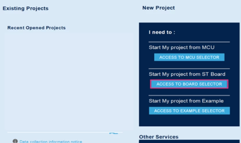

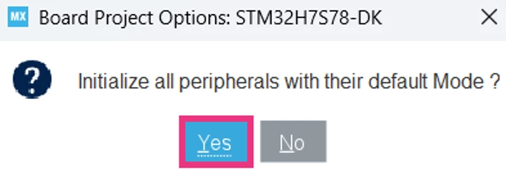

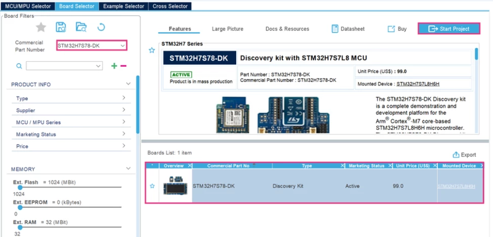

Step 1: Open STM32CubeMX and click the [ACCESS TO BOARD SELECTOR] button.

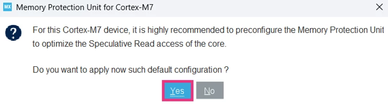

Step 2: Enter the relevant Part Number in the [Commercial Part Number] field. In this example, we use the STM32H7S78-DK board. Select it and click on [Start Project].
A pop-up appears, as shown in the screenshot below: Click [Yes].
Another pop-up appears, click [Yes].

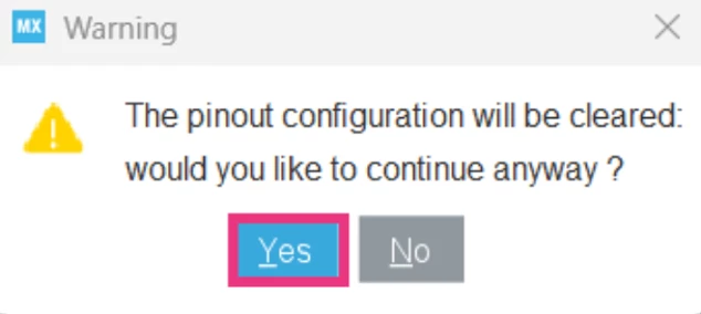

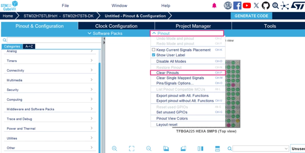

Step 3: Click [Pinout] and then [Clear Pinouts].

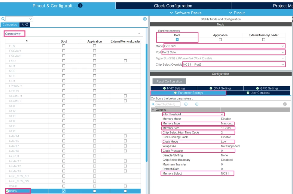

Step 4: XSPI mode and configuration
To access and communicate with the external flash memory, configure the XSPI2 interface as shown in the screenshot below.
For the GPIO Settings, verify that the XSPI pins are configured in Very High.
Note: For more details about the type of external flash memory and its specifications, as well as the XSPI2 configuration and GPIO settings, refer to this article: “How to configure the external flash memory MX66UW1G45G on the STM32H7S78-DK via XSPI interface".

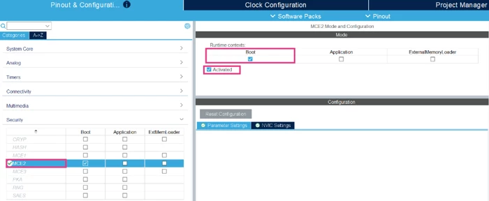

Step 6: MCE mode and configuration
The Memory Cipher Engine (MCE) is a hardware security accelerator integrated into the STM32H7S78 microcontroller. It provides transparent encryption and decryption of data stored in external memories, such as NOR Flash or PSRAM, without processor intervention. In this example, we enable it to encrypt and decrypt the data stored in the external NOR flash memory, as shown in the screenshot below.
Note: To understand the concept of MCE and get more information on it, refer to this application note: “How to use MCE for encryption/decryption on STM32 MCUs” and consult RM0477 specifically section 39 Memory cipher engine (MCE).

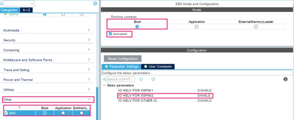

Step 7: SBS mode and configuration
Enabling HSLV is recommended in cases when the XSPIM domain is powered by 1.8 V and operates the serial memory interface at its maximum speed of 200 MHz.
Note: For more details about HSLV, refer to this FAQ: “Recommendations for high-speed low-voltage mode (HSLV) on the STM32H7RS”.

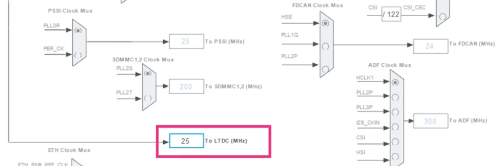

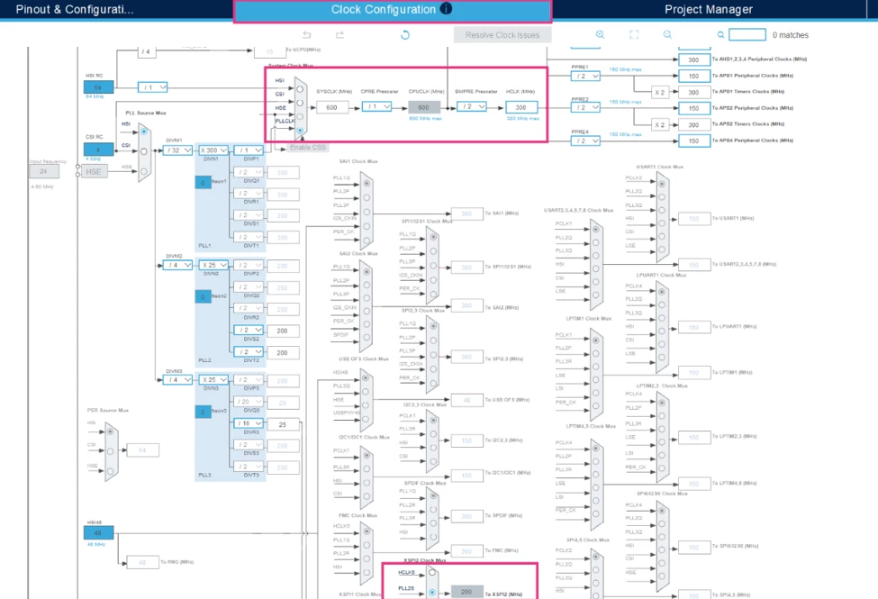

Step 8: Clock configuration
- MCU Clock Frequency = 600 MHz
- f_Kernel = 200 MHz
- LTDC Frequency = 25 MHz
Note: For more details about the LTDC frequency, refer to the KB article: "How to display an image stored in external flash on the STM32H7S78-DK using the LTDC controller".

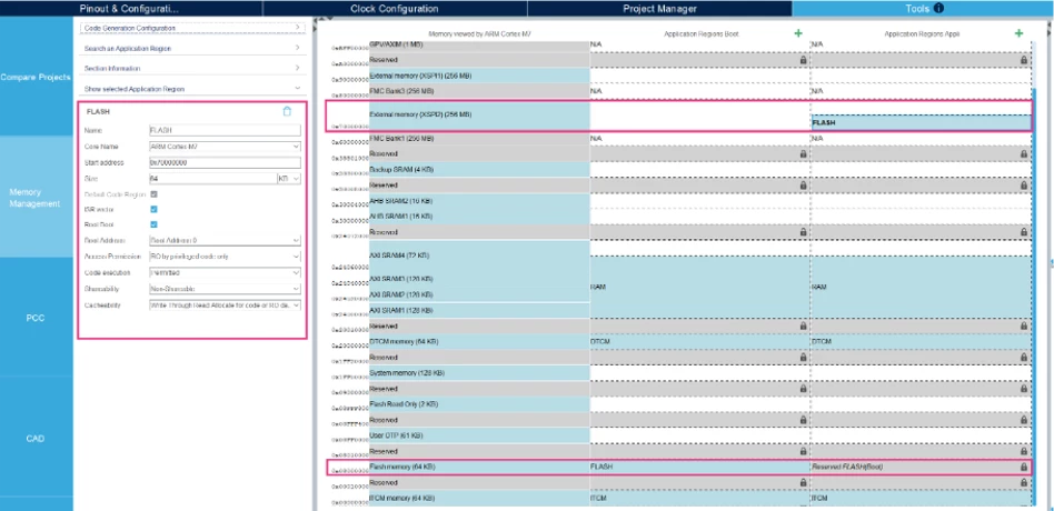

For the memory management:
Make sure that the configuration is set up as shown in the screenshot below.

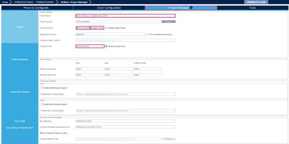

Step 9: Generate code
Enter the Project Name, choose the Toolchain/IDE, and click [GENERATE CODE], as shown in the screenshot below.

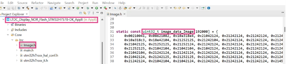

Step 10: Image conversion
To display the image from external flash memory, the picture must be converted into a pixel format compatible with the LTDC framebuffer. This conversion allows the LTDC to read the image directly and show it on the LCD-TFT panel.
To convert the image and generate the header file (Image.h), use the LCD-Image-Converter-20190317 tool by following the steps described in this article: “How to display an image stored in external flash on the STM32H7S78-DK using the LTDC controller”

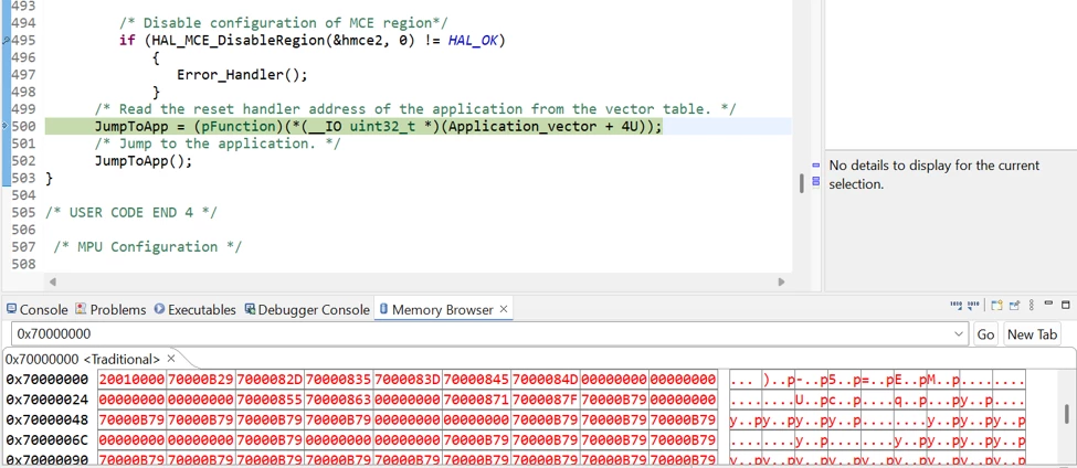

Step 11: Edit main.c in the Boot project
In main.c, several code sections must be added to configure the MCE2 peripheral and the external flash memory MX66UW1G45G connected via XSPI2. In this project, MCE2 is configured in Noekeon Block Cipher mode.

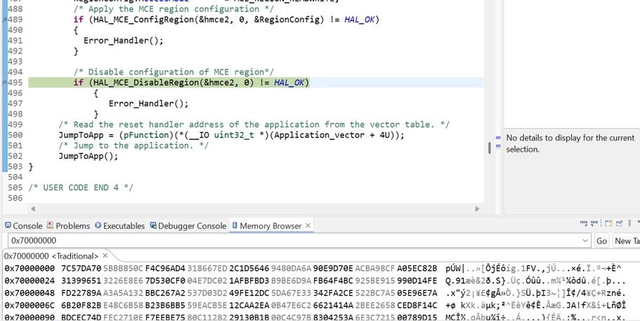

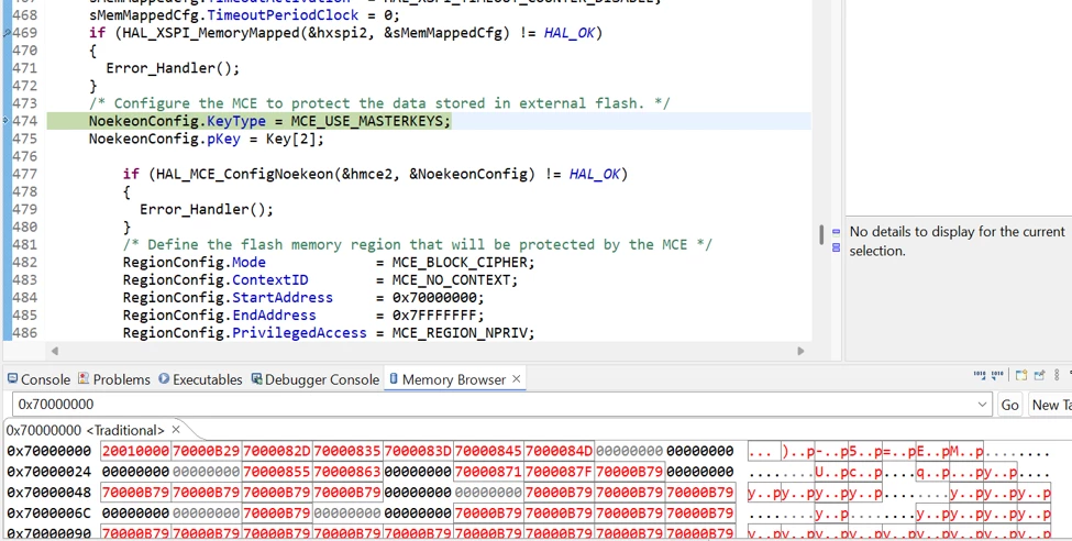

/* configure the MCE to protect the data stored in external flash. */
NoekeonConfig.KeyType = MCE_USE_MASTERKEYS;
NoekeonConfig.pKey = Key[2];
if (HAL_MCE_ConfigNoekeon(&hmce2, &NoekeonConfig) != HAL_OK)
Error_Handler();
/* define the flash memory region to be protected by the MCE*/
RegionConfig.Mode = MCE_BLOCK_CIPHER;
RegionConfig.ContextID = MCE_NO_CONTEXT;
RegionConfig.StartAddress = 0x70000000;
RegionConfig.EndAddress = 0x7FFFFFFF;
RegionConfig.PrivilegedAccess = MCE_REGION_NPRIV;
RegionConfig.AccessMode = MCE_REGION_READWRITE;
/* Apply the MCE region configuration */
if (HAL_MCE_ConfigRegion(&hmce2, 0, &RegionConfig) != HAL_OK)
Error_Handler();
/* disable configuration of MCE region*/
if (HAL_MCE_DisableRegion(&hmce2, 0) != HAL_OK)
Error_Handler();
/* read the reset handler address of the application from the vector table */
JumpToApp = (pFunction)(*(__IO uint32_t *)(Application_vector + 4U));
/* jump to the application */
JumpToApp();
/* USER CODE END 4 */Step 12: Edit main.h in the Boot project

Step 13: Edit main.c in the application project
In main.c, we need to add the generated header file (Image.h) and the framebuffer start address used by the LTDC.
- Insert Image.h in Private includes section
#include "Image.h"
/* USER CODE END Includes */- Set the framebuffer start address used by the LTDC:

- The frame buffer start address value is found in the Image.h file, as shown in the screenshot below.
In the same file (Image.h), the user must comment out the structure definition. This definition is located just after the table and keep only the table definition, as shown in the screenshot below.

The screenshot below shows the image on the LCD panel. This confirms that the framebuffer content is stored correctly in external flash memory and rendered by the LTDC. Meanwhile, MCE2 handles the encryption and decryption of data.

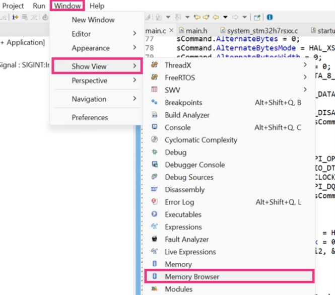

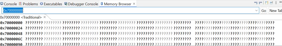

- Click on [Window], then select [Memory Browser]. Enter the corresponding address of the memory-mapped external flash, accessed through XSPI2. The address is “0x70000000”, as shown in the screenshot below.
Note: The XSPI2 Base Address “0x70000000” can be found in the reference manual RM0477.
Set breakpoints on the following instructions to pause execution at key stages of the Boot sequence. It helps control access to external flash memory and validates the MCE configuration.
- if (HAL_XSPI_MemoryMapped(&hxspi2, &sMemMappedCfg) != HAL_OK),
click [Resume]. Then use [Step Over] to verify that the external flash memory is correctly accessible in memory-mapped mode and its content.
The raw data stored in external memory becomes directly accessible and visible at this address once the application enters memory-mapped mode.
- if (HAL_MCE_ConfigRegion(&hmce2, 0, &RegionConfig) != HAL_OK), click [Resume]. Then use [Step Over] to verify the encrypted region managed by the MCE peripheral, as shown in the screenshot below.
Once the MCE region is configured, the external flash content is no longer handled as plain text. This confirms that the protection mechanism is correctly applied.
• if (HAL_MCE_DisableRegion(&hmce2, 0) != HAL_OK), click [Resume]. Then use [Step Over] to verify that the protected region returns to clear data when the HAL_MCE_DisableRegion() function is executed.
When the system disables the MCE region, the protected memory content becomes clear data. This shows that the encryption mechanism is no longer applied.
