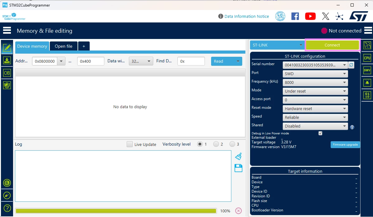

1. Open STM32CubeProgrammer.
2. Click on [Connect].

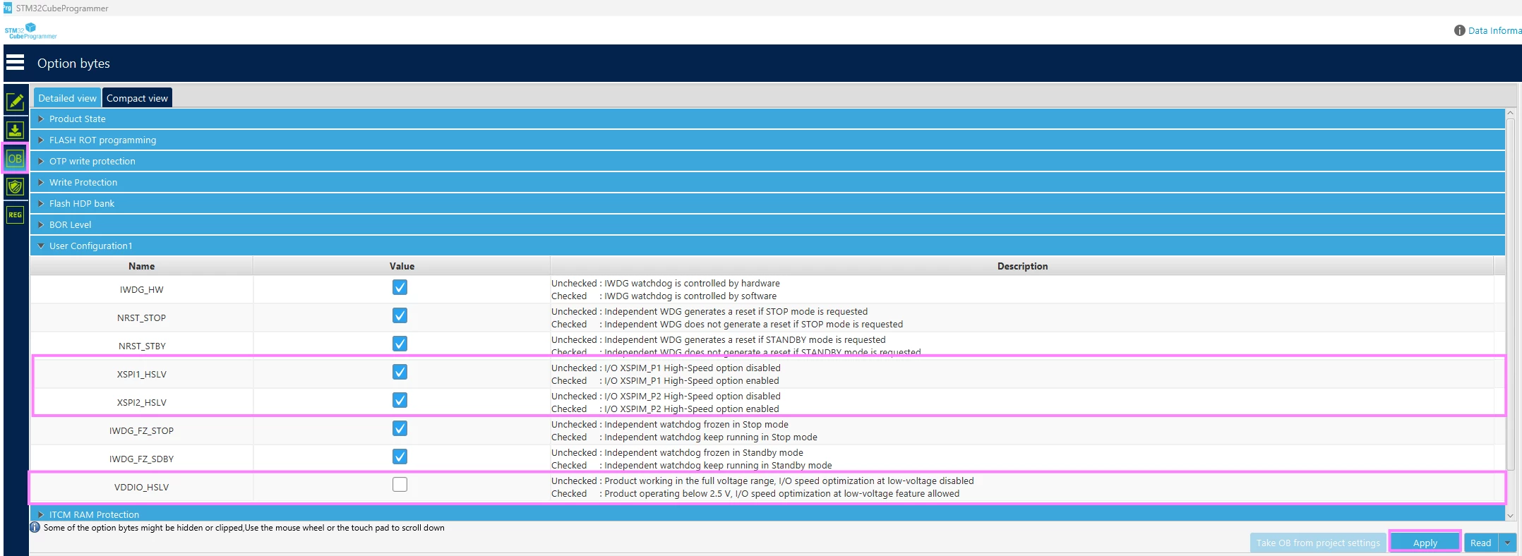

3. Click on the [OB] option bytes and then [User configuration1].
4. Choose the HSLV bits levels and then click on [Apply].
