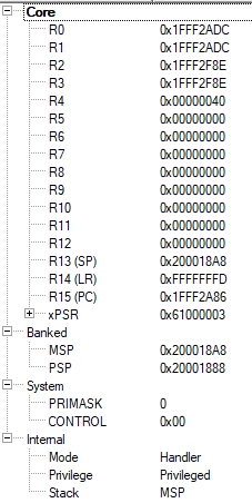

There are different useful ways to test if the code worked successfully, two of them are explained below.
2.1. STM32CubeIDE debugging tab.
You can check whether the PC is set to the Flash or Boot address in the debug tab on the top left corner of the debug perspective. At first, the PC starts in Flash address: 0x08000614 (for this particular demo).
After entering the Bootloader, the PC is now set to an address inside the Boot region: 0x1FF127BC. You can see the tab below after hitting “pause” button.

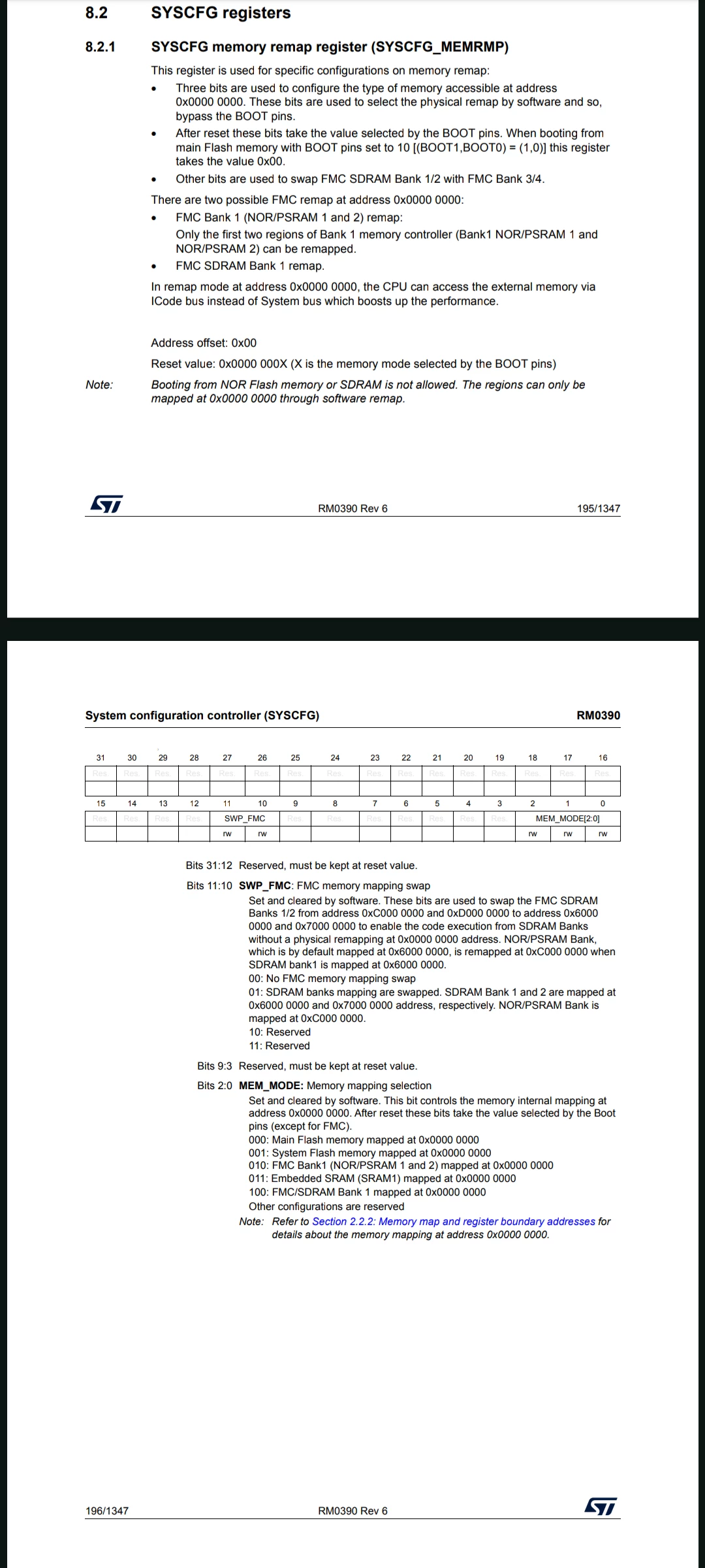

Nov 22, 2023 2:23 AM UTC
@APrim.2
Refer RM-0390 section 8.2.1. Using SYSCFG_MEMRMP register you can boot from desired memory location.
EThom.3
Senior II
Nov 22, 2023 7:14 AM UTC
@Lavanya1
Yeah, that's exactly what @APrim.2 is trying to do.
 // REMAP
 SYSCFG->MEMRMP = 0x01;
// Re-enable all interrupts
__enable_irq();
// Set the MSP
__set_MSP(BOOTVTAB->Initial_SP);
// Jump to app firmware
BOOTVTAB->Reset_Handler();
 Could it be a problem with the order of events? The manual is more than a little vague on this.

I see bit 0 of MEMRMP is set with BOOT0 pin (and BOOT1 option bit) at reset.
after adding the following code
 ldr r4,=0x40010000 /* SYSCFG */
 mov r1,#1
 str r1,[r4,#0] /* SYSCFG_MEMRMP */
All is working like a charm :)
