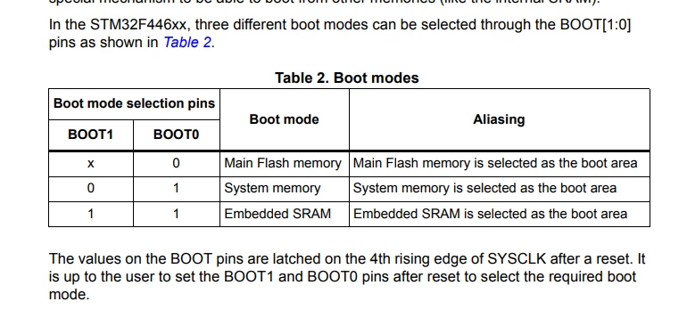

Nov 20, 2023 10:09 AM UTC
@APrim.2
Connect the board through the Cube Programmer by forcing the BOOT pin to VCC and check for the Option Bytes. For the System Bootloader, BFB2, DBANK/DB1M, and nBoot0 are to be unchecked. The rest of the options are checked. Now you remove the pull-up of Boot0 and try that program, it will enter into boot mode.
EThom.3

@Lavanya1
The bits you mentioned it doesn't exist on STM32F446RE.
Nov 21, 2023 7:45 AM UTC
@APrim.2
I'm really sorry. Without checking the reference manual I suggested that one. As most of the STM32 series devices require option bytes changes. Here, what you missed is pulling up the boot0 pin. The condition to enter into system memory is Boot0 pin should be pulled up.
So, whenever you're trying to jump to system memory, need to pull up the Boot0 pin by software. Please try this and update me. Find the correct GPIO port and pin, and do a pull-up like this. Please add this pull-up condition here.

APrim.2
Visitor II
Nov 21, 2023 9:21 PM UTC
@Lavanya1
on the STM32F446RE the boot0 pin is not shared with some port pin so I think there is not the possibility to enable the internal pull up.at least I did not found it, I searched also on the graphical configuration tool but there isn't any possibility to enable the boot0 pull up.
