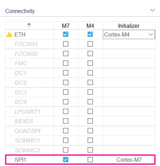

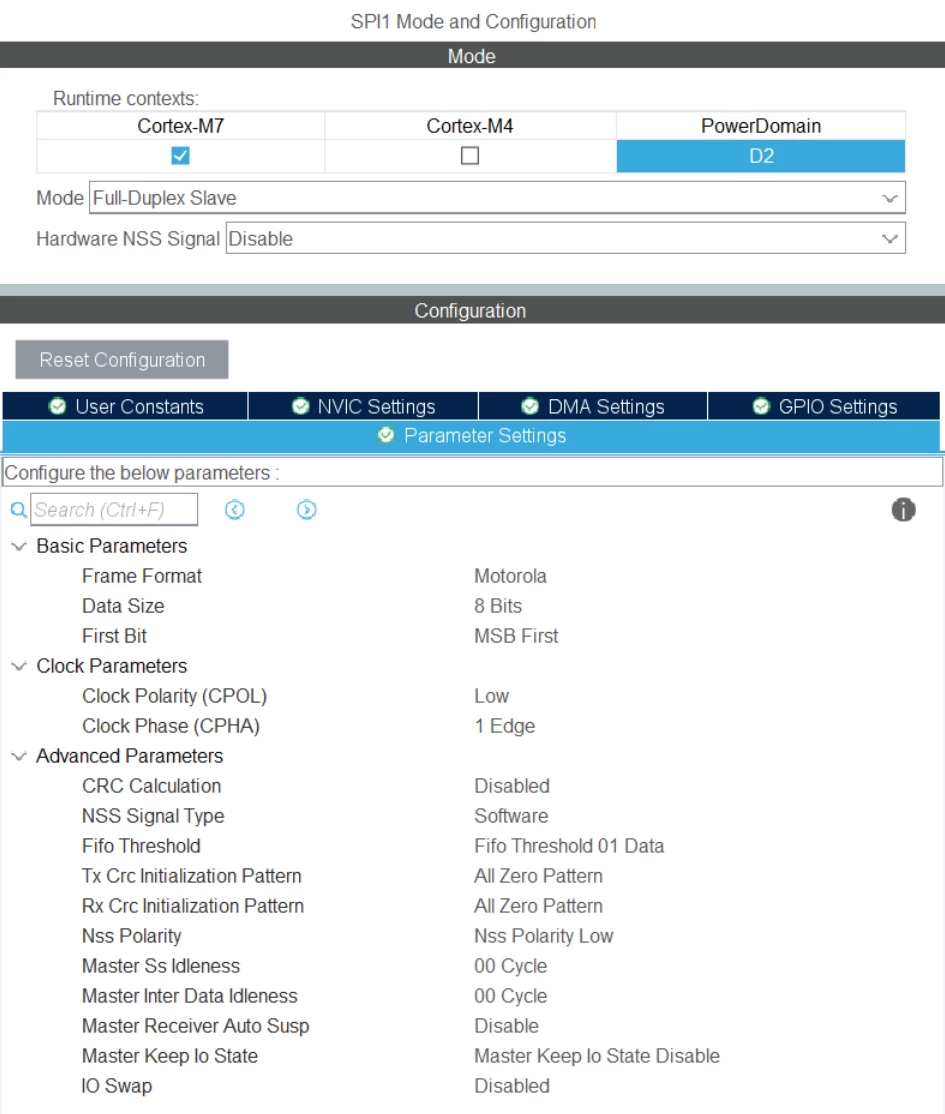

We use the SPI1 on CM7 as target and SPI3 on CM4 as controller. Firstly, we can configure the SPI1 by going to [Connectivity] and checking the M7 box on [SPI1]:
The mode is [Full-Duplex Slave] with the hardware NSS signal disabled. The parameter settings are described in the image below:

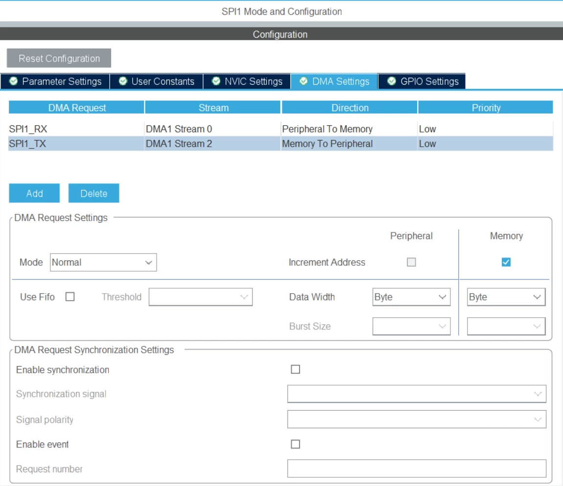

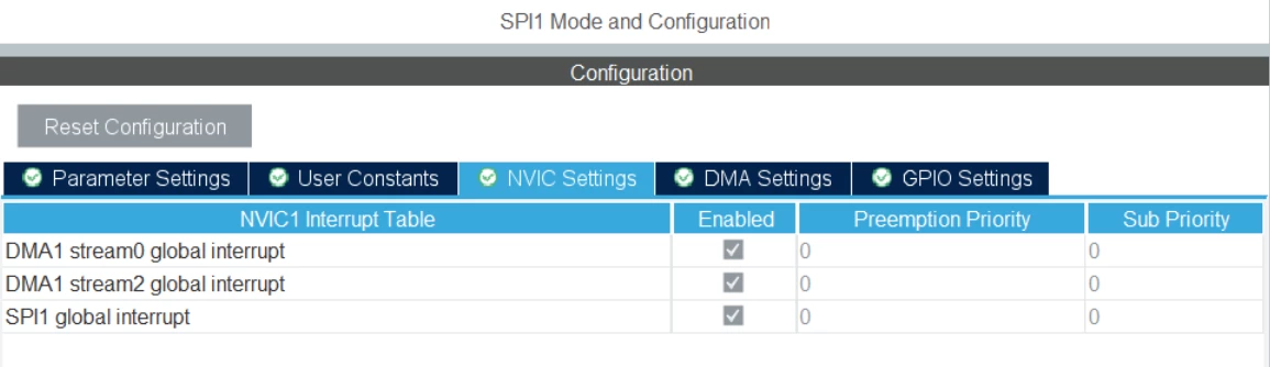

Also, this SPI uses DMA. Configure the DMA settings and the NVIC settings so they align with the figures below:

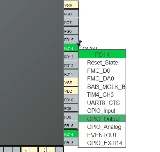

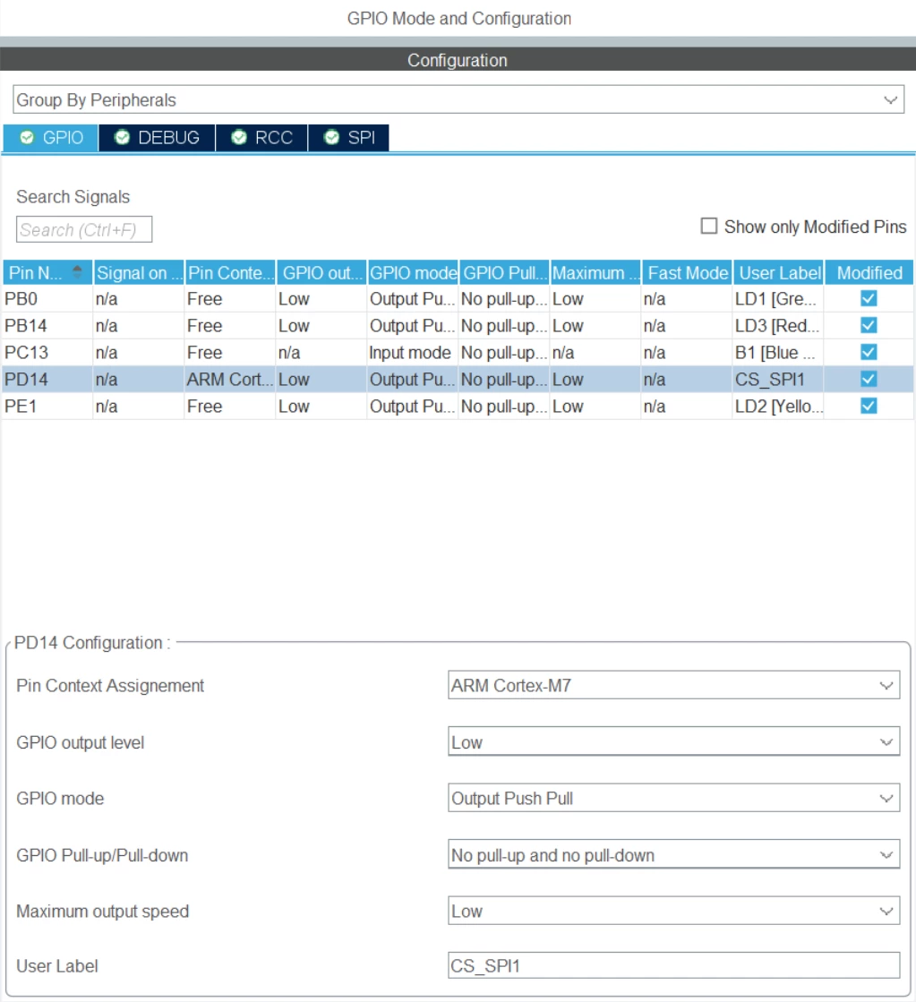

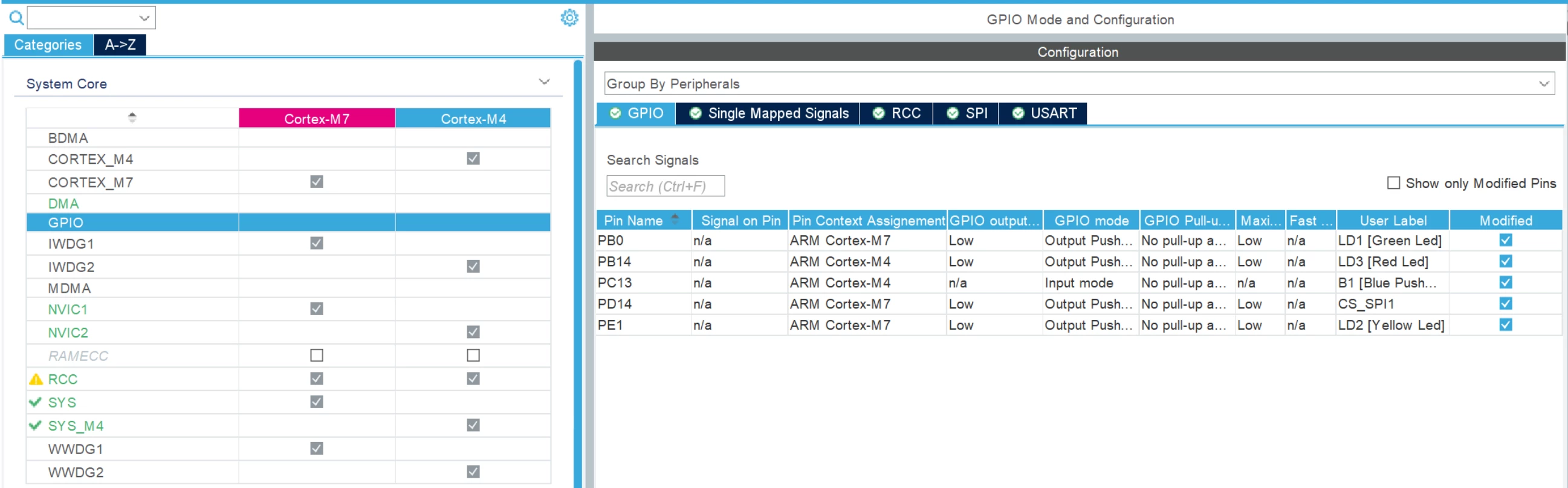

We also define the PD14 GPIO as output to be the CS pin for the SPI1. Select the PD14 as GPIO_Output and go to System Core → GPIO to configure the following settings, making sure that the PD14 is assigned to the M7 core:

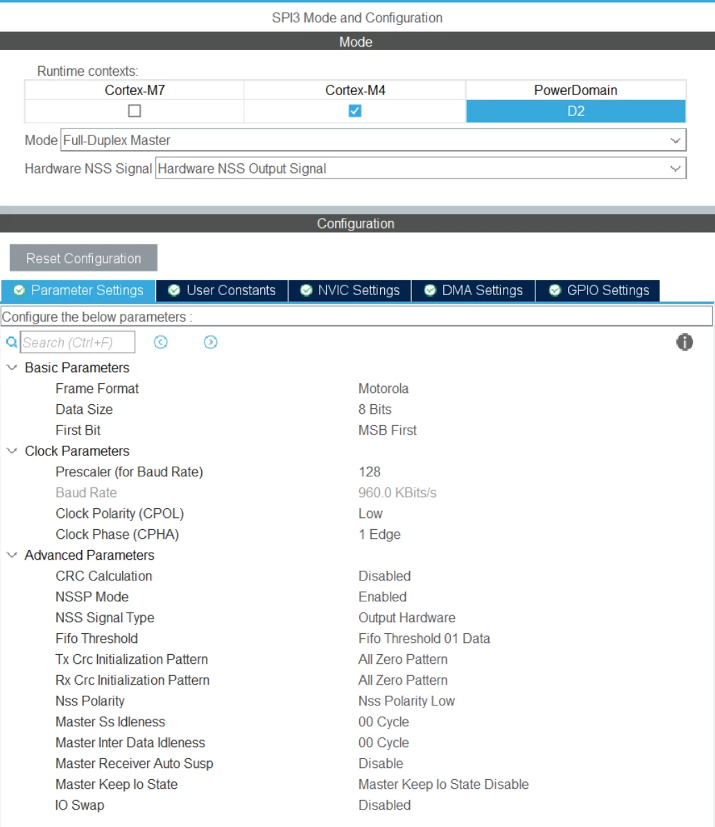

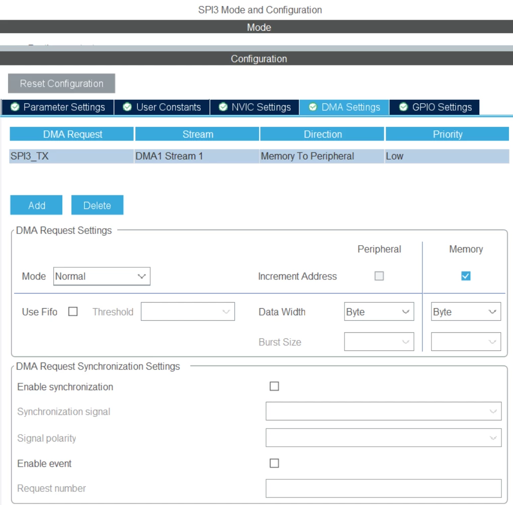

That is all for the SPI1. The SPI3 configuration is almost the same, but the M4 box is checked:

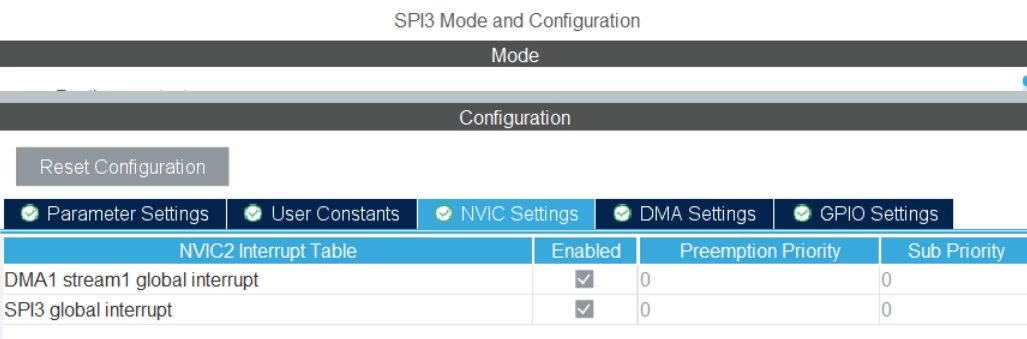

The mode is [Full-Duplex Master] with the hardware NSS output signal enabled. The parameter settings are listed in the image below:
This SPI uses DMA only for transmitting. So, configure the DMA settings and the NVIC settings like the figure below:
With this, the SPI3 is all done and now we need to allocate the GPIO pins for each core. As this application example is quite simple, we use the PC13 (Blue button) and the PB14 (LD3) for the M4. The M7 is responsible for the PB0 (LD1) and PE1 (LD2).

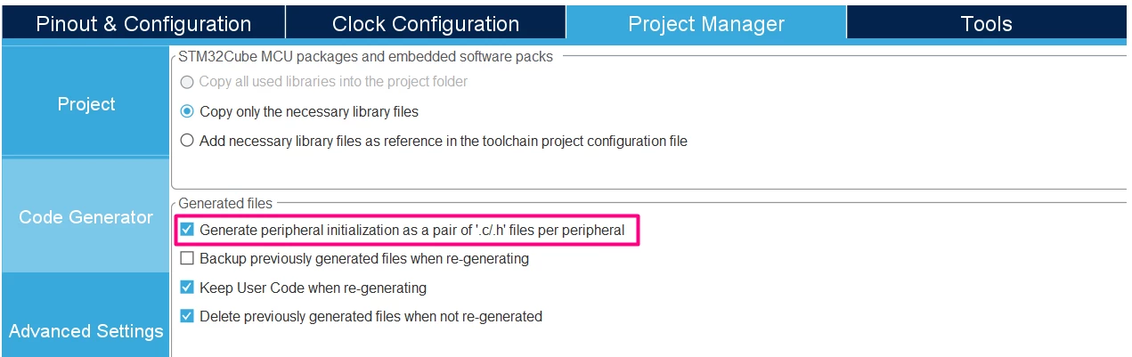

The clock configuration can be kept as default and as a recommendation, an extra configuration that could be a powerful tool to organize the code workspace is to check the option "Generate peripheral initialization as a pair of '.c/.h' files per peripheral" in Project Manager → Code Generator:

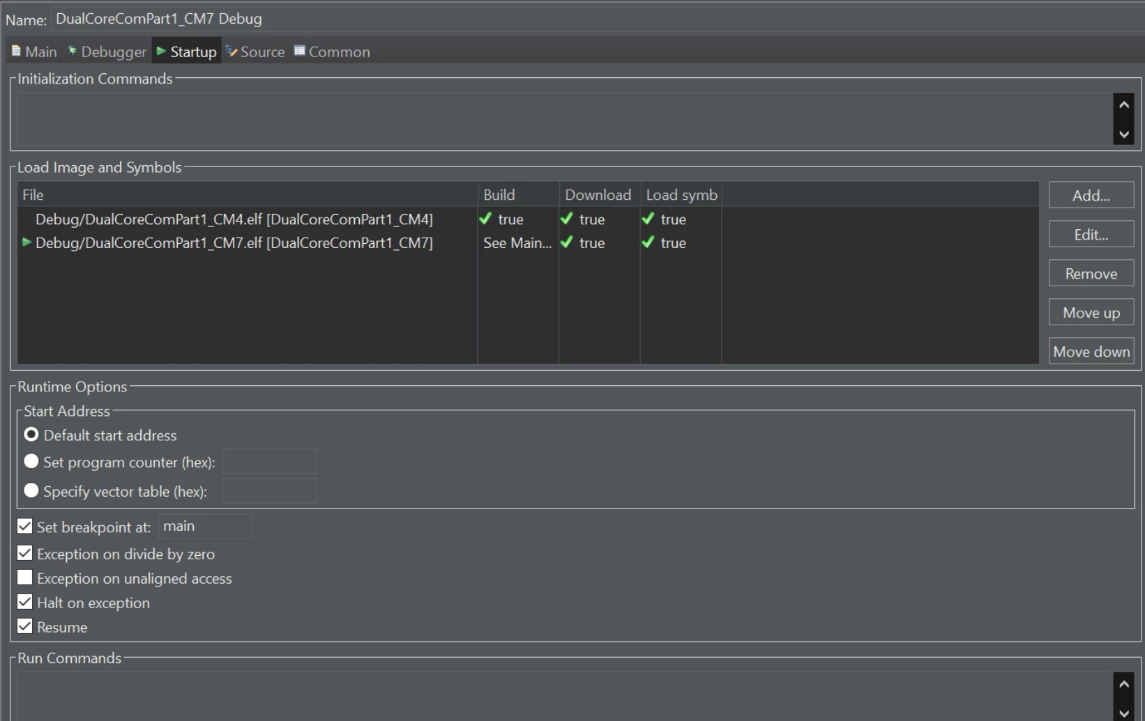

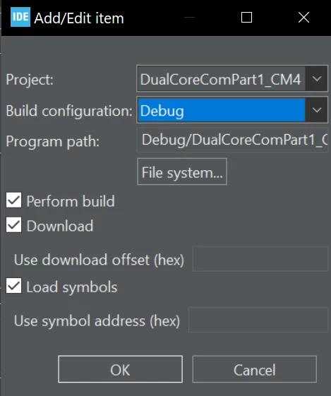

In a summarized version, you need to follow these steps to configure the debugger:
- Right-click the CM7 project and go to [Debug as] → [STM32 C/C++ Application] and open the Debug tab.
- In the [Debugger] tab, make sure the Shared STLINK checkbox is checked. You might need to scroll down to locate this.
- In the [Startup] tab, at the Load Image and Symbols section, click on [Add…] and link the CM4 Project just as below:
- It should look like this:
- If you are ready, you can click [Apply] and [Debug] to enter in debug mode. Remember to physically connect the SPI controller pins with their corresponding match on the target side, including the CS and NSS pins.

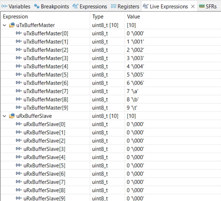

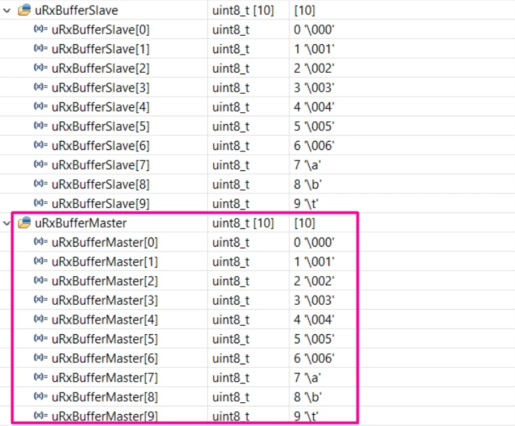

4. Code validation

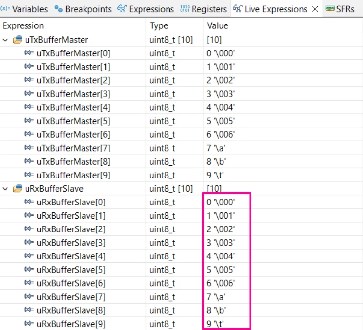

At the end, you can check the buffers at the controller and target side while debugging to understand the hole process of transmitting and receiving. Add the buffer in the live expressions tab so you can see it dynamically changing.
This is the initial value for the uTxBufferMaster and uRxBufferSlave:
By adding a breakpoint to the CM7 “main.c” in HAL_SPI_TransmitReceive_DMA function, located inside the HAL_SPI_TxRxCpltCallback, we can see that it is triggered by pressing the user button. The uRxBufferSlave receives the uTxBufferMaster data:
At the same time, the uTxBufferSlave transmits its data and it is received by the uRxBufferMaster:
