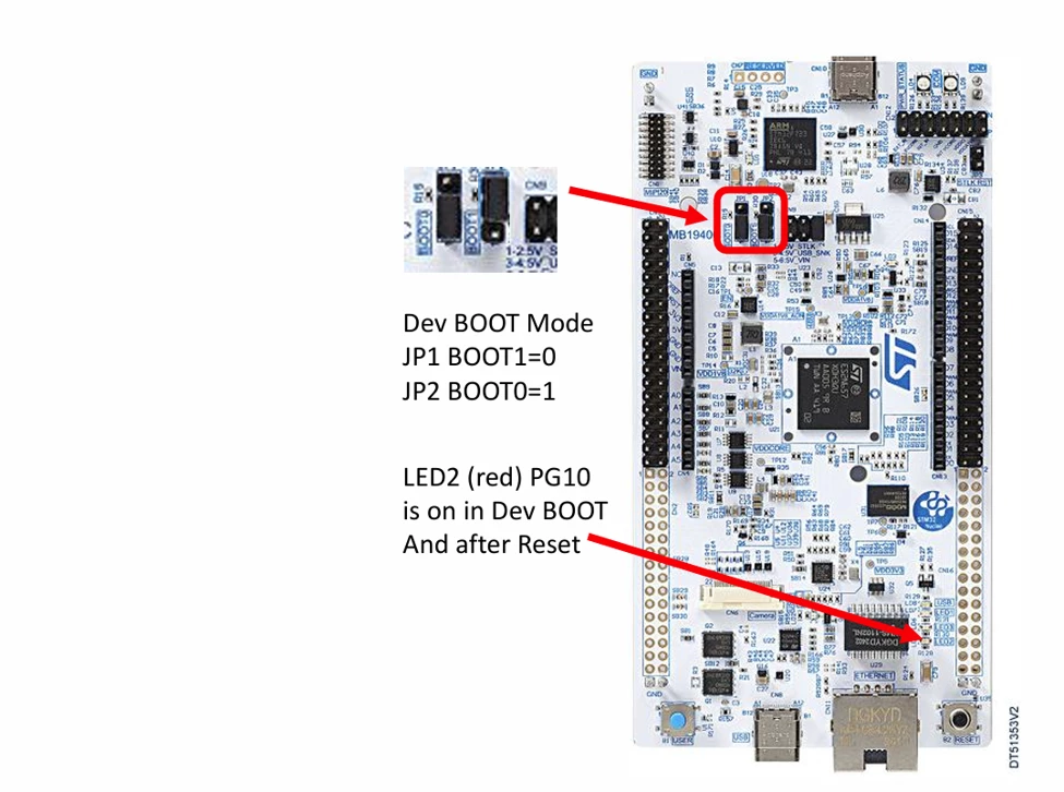

Just wanted to add for those working on the NUCLEO board the procedure is a tinyy bit different not much.
  • the gpio pin for led becomes P01
  • When in MXCube Programmer, change hardware pins to devBOOT by changing BOOT2 to 2-3 from 1-2
Rest is similar.
