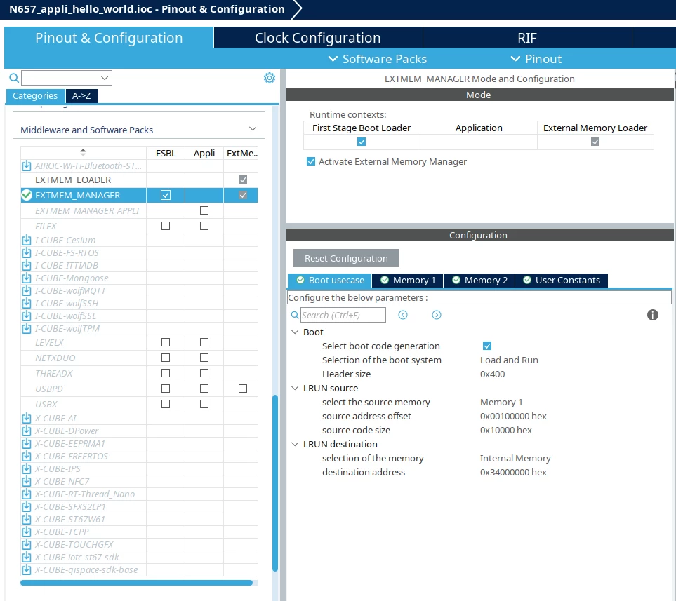

The next step is locating the [Middleware and Software Packs] in the [Categories]. Expand the [EXTMEM_MANAGER]. Add the FSBL and activate it using the following settings:
[LRUN source address offset] =  0x00100000
[LRUN source code size] =  0x10000
[LRUN destination address] =  0x34000000

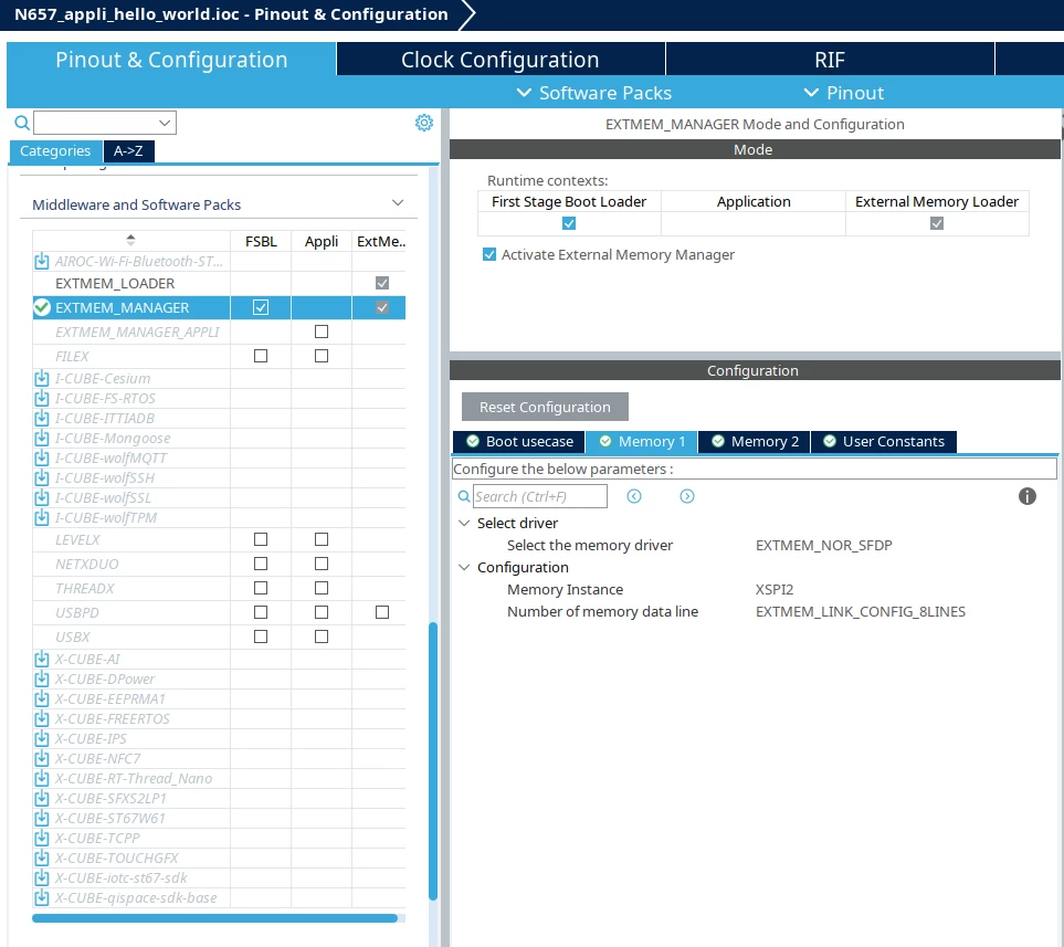

In the [Memory 1] tab, ensure its as follows:

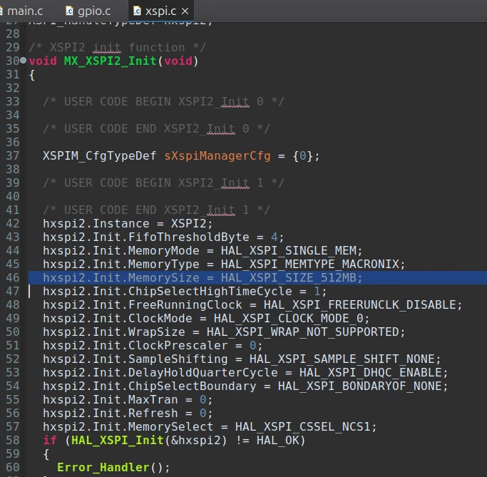

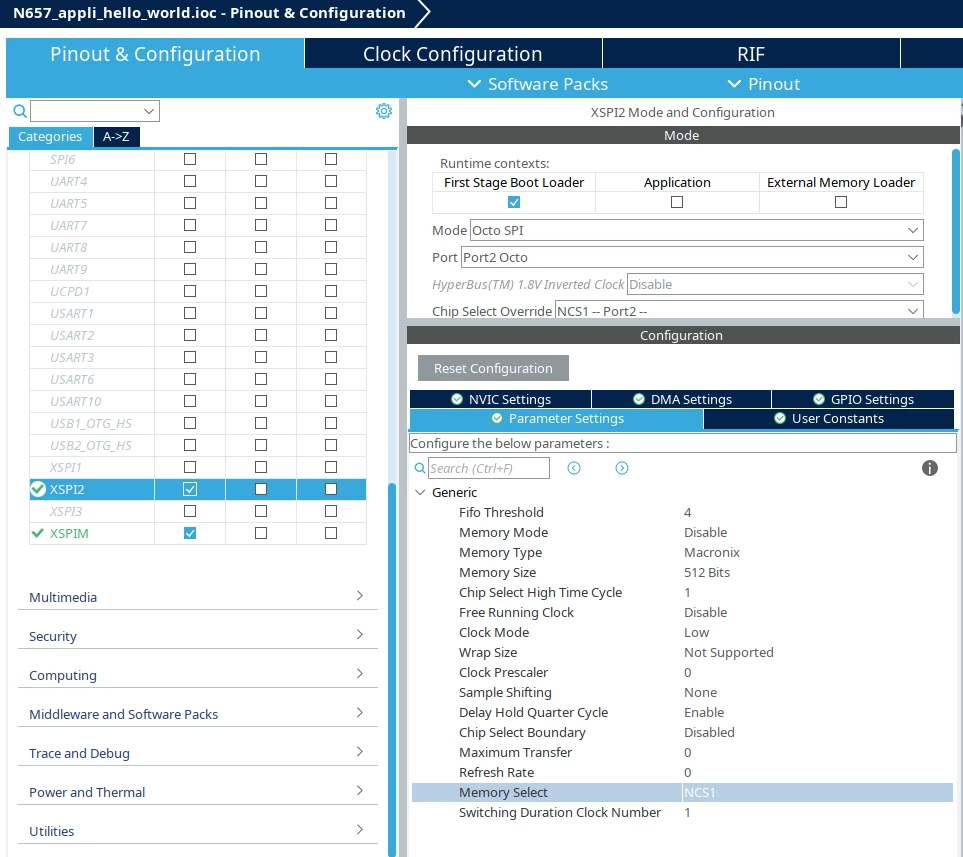

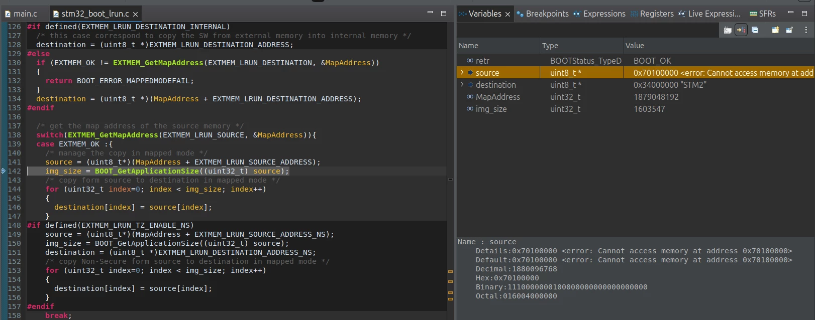

However, when I tried to run it again, the FSBL no longer loaded the APPLI. I have checked the parameters and configurations several times, but to no avail. When I debugged the FSBL, it seemed that it could not access the flash memory. The error is:
0x70100000 <error: Cannot access memory at address 0x70100000>
I am attaching an image:
Hard faultHard fault
This is my configuration:

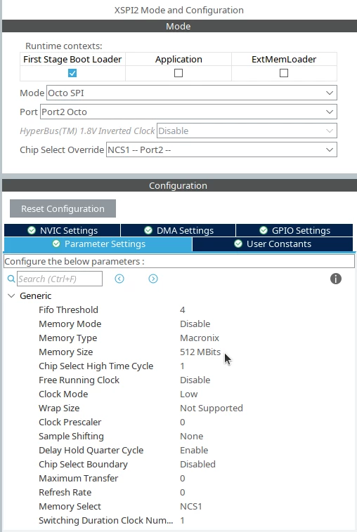

I use 512 bits because my card is a NUCLEO-N567X0-Q and has 512 Mbit Octo-SPI flash memory.
The board works because I can run the .bin files that were created previously.
Best regards!

while solving my problem, I found two errors:
  • I set the memory size to 512 Bits instead of 512 Mbits.
  • Using the latest version of the STM32 Signing Tool (v2.21.0), I had to use the '-align' flag to correctly perform the signing.
.../STM32_SigningTool_CLI -bin ${ProjName}.bin -align -nk -of 0x80000000 -t fsbl -o ${ProjName}-Trusted.bin -hv 2.3 -dump ${ProjName}-Trusted.bin
Now, it works ! Best regards!
