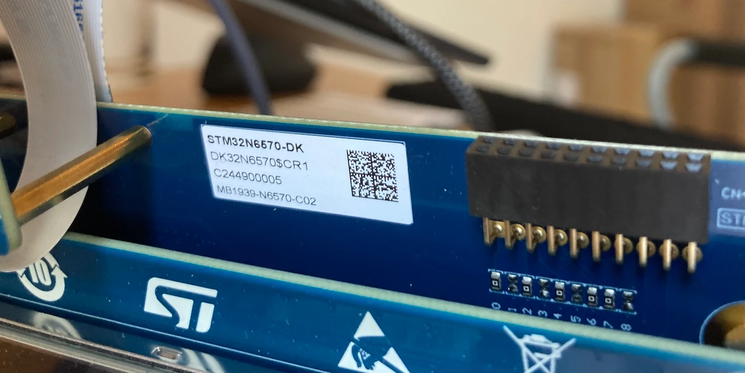

This article uses the STM32N6570-DK as the base for its hands-on portion, but the content can be tailored to any specific STM32N6 hardware. Two examples are shown: the first example is a simple blink LED running directly from the FSBL, and the second example is composed of two binaries, the application and FSBL. Both examples have the header added and programmed on the external memory. It is up to the FSBL to execute the application directly from the internal RAM, or copy from the external FLASH to the internal RAM and execute the application.

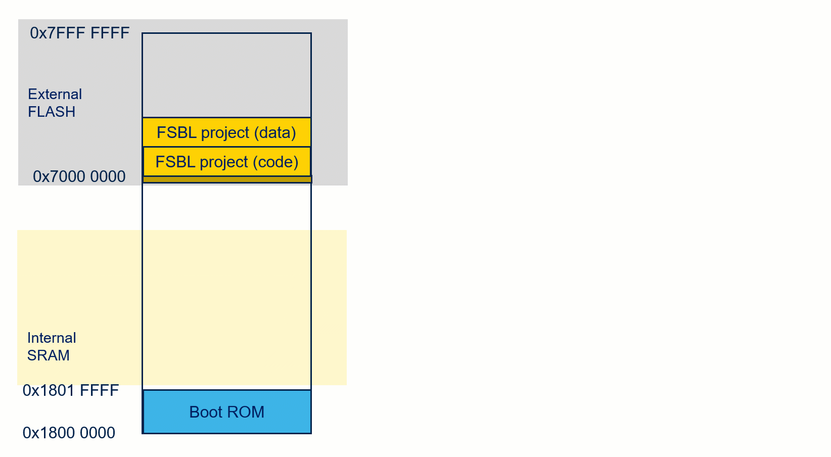

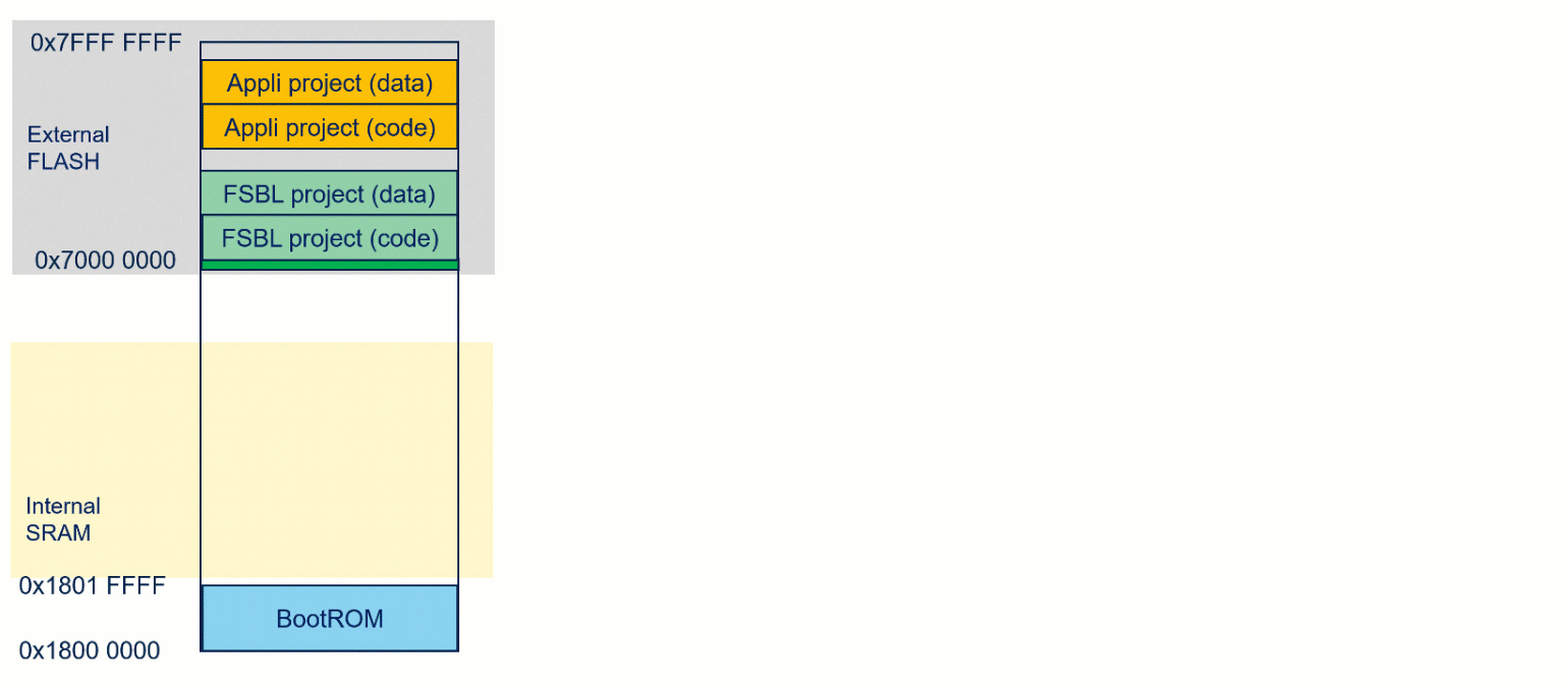

1.1 Application as part of the FSBL
In this mode, the boot ROM fetches the FSBL from external serial NOR flash memory. As the FSBL and application are contained in the same binary, there is a 511 KB size limitation in this mode. This is due to the total area of 512 KB that the boot ROM copies from the external memory into the internal SRAM. The visual representation can be observed in the small animation below:
1.2 FSBL with load & run application
In this mode, the boot ROM fetches the FSBL from external flash memory. This time, the FSBL proceeds to configure the external memory and fetch a second binary stored in it, then copy it into the internal SRAM. Once the binary is loaded, the FSBL jumps to the new position in RAM, where the application code is located and starts the execution. This mode is applicable to a few examples available in the STM32Cube_FW_N6. The interesting aspect is that the 511 KB size limitation is no longer applicable, as the user code can be placed in the remaining area of the internal RAM.

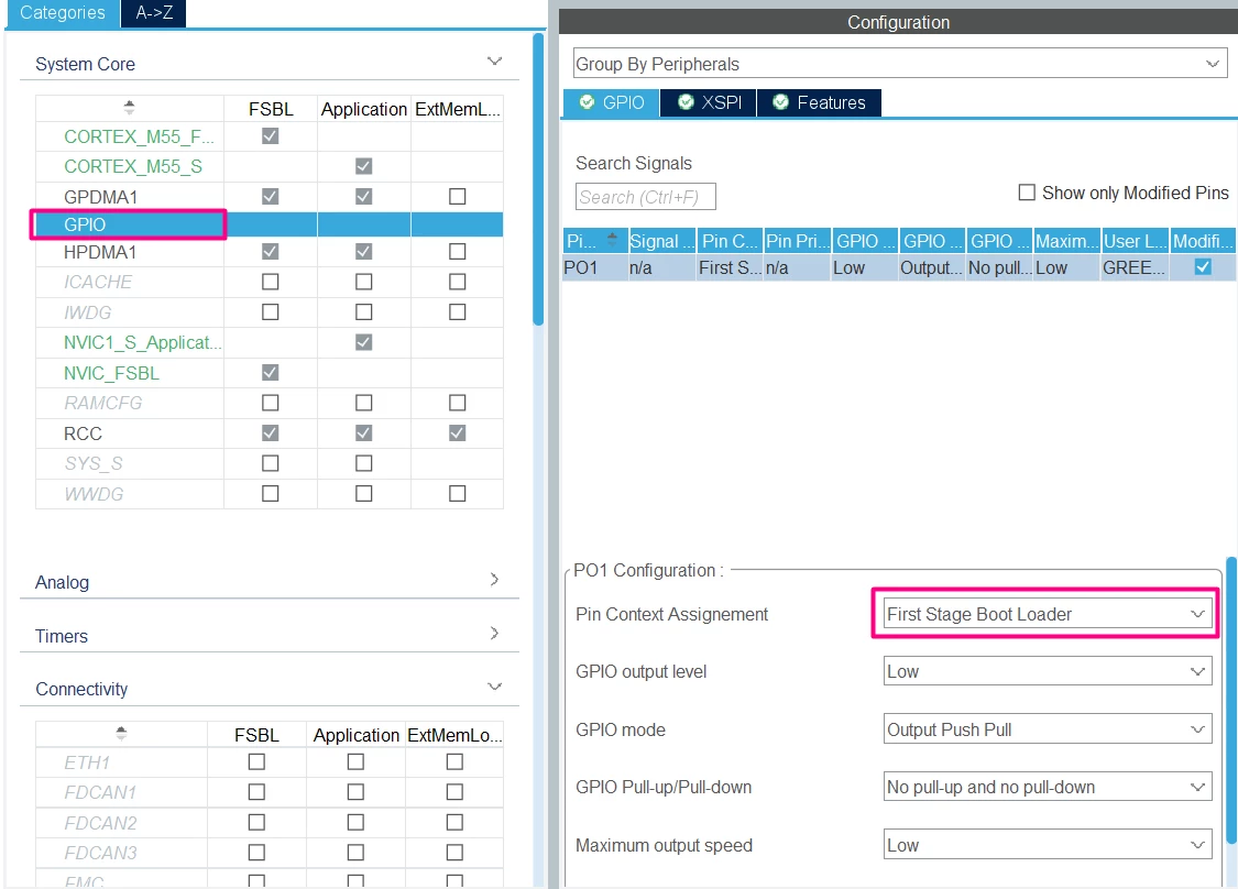

2.1.1 Configure the LED pin
Locate the PO1 and configure it as GPIO_Output and use the label to name it GREEN_LED.
We need to assign the GPIO to be used by the FSBL

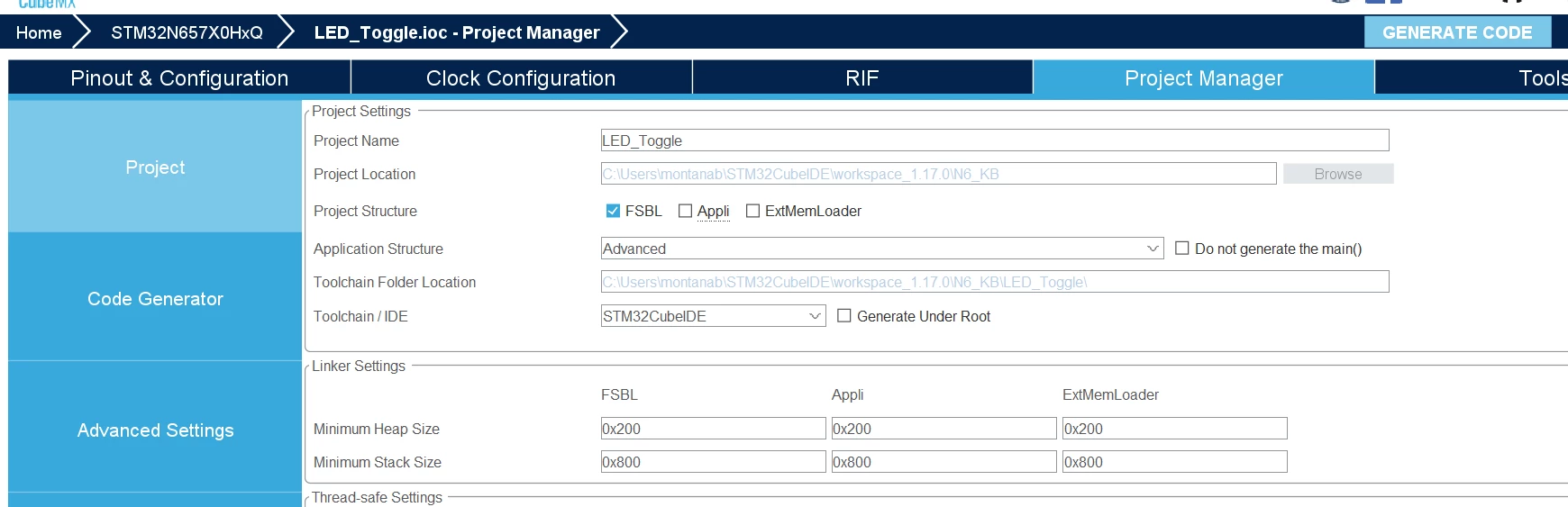

In the [Project Manager] tab, ensure the [FSBL] checkbox is selected and generate the code for your preferred toolchain.

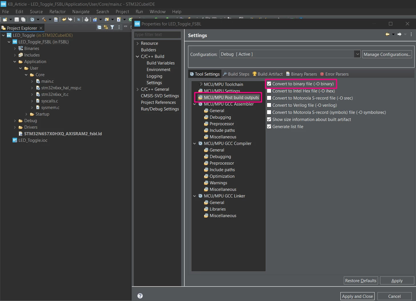

Make sure that your project settings are configured to generate the *.bin as well, since we use it to run the scripts.
Enter in debug mode and validate that your code is working. Now that you have, we need to add the FSBL header to ensure that the boot ROM is capable of reading and copying it from the external memory. To do this, we use the STM32CubeProgrammer’s CLI. The next assumes the STM32CubeProgrammer was installed in the default path, if not, make sure to adjust it accordingly.

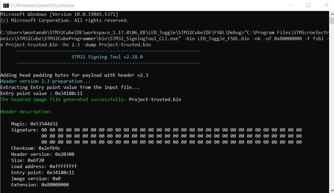

To facilitate the process, its possible to type [cmd] in the binary folder. For example ..\LED_Toggle\STM32CubeIDE\FSBL\Debug. This will pop up the cmd in the selected path and its possible to use the command line interface from STM32CubeProgrammer and its Signing Tool. Starting from STM32CubeProgrammer version 2.21.0, a new parameter is needed at the end "-align". Please make sure you use the updated command, as follows:
"C:\Program Files\STMicroelectronics\STM32Cube\STM32CubeProgrammer\bin\STM32_SigningTool_CLI.exe" -bin LED_Toggle_FSBL.bin -nk -of 0x80000000 -t fsbl -o Project-trusted.bin -hv 2.3 -dump Project-trusted.bin -align

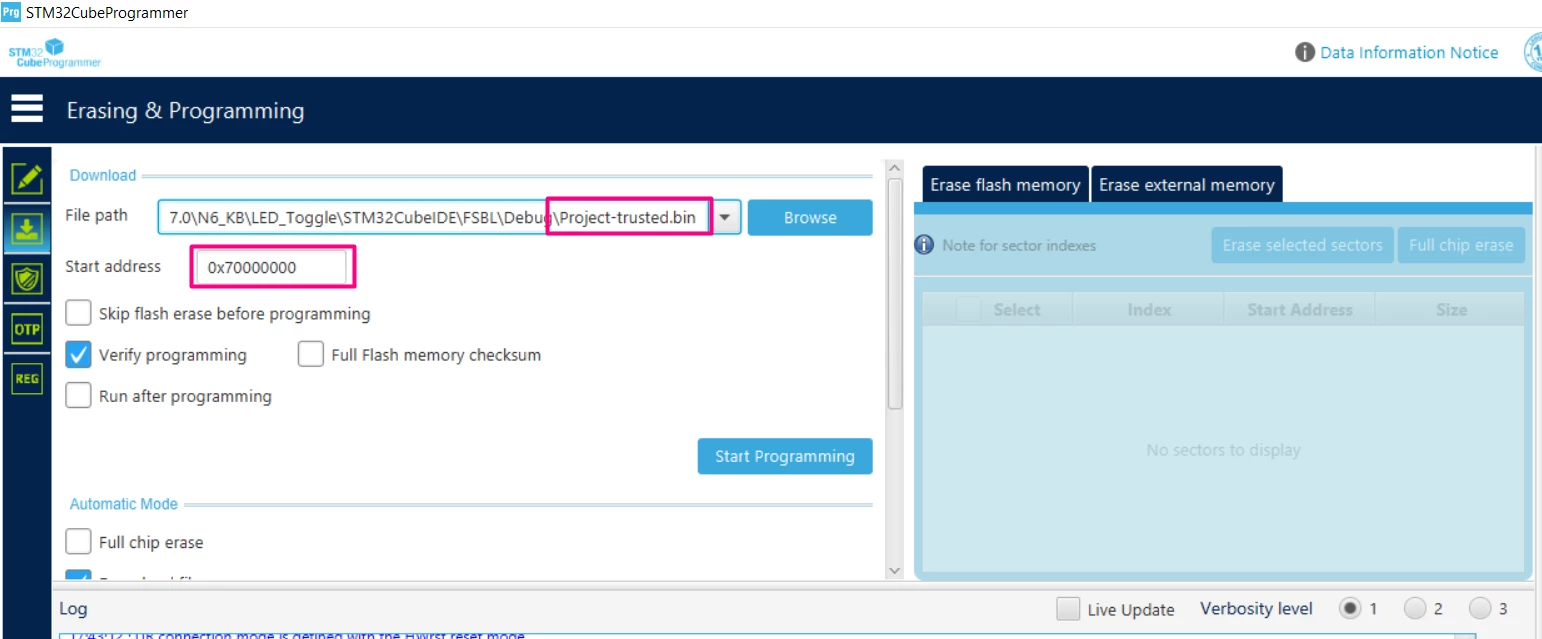

This creates the header for the binary, which can now be loaded into the external FLASH using STM32CubeProgrammer.

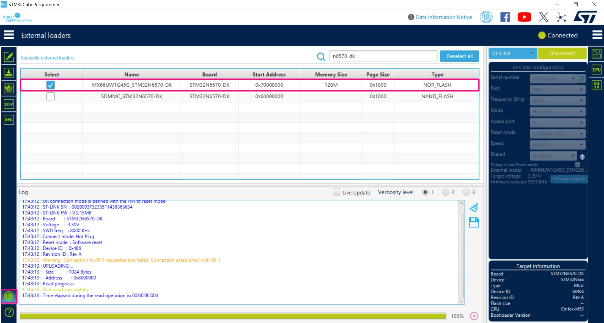

2.1.4 Programming the binary
Make sure that the external loader for the flash memory is enabled and use the address [0x7000 0000] to program the binary.
TIP: you might need to power cycle the board in case a failure message appears when clicking [Start Programming].
To validate the entire process worked, disconnect from the STM32CubeProgrammer. Then switch BOOT1 to 0 and reset the board. This ensures that the boot ROM uses the external memory and the green LED should blink.

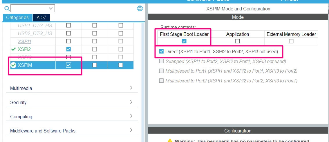

2.2.1 Configure the XSPI and XSPIM
Using the same STM32CubeMX project, locate the [XSPIM] under the [Connectivity] menu on the left and select it to run during the [FSBL] and have the [Direct] mode selected:

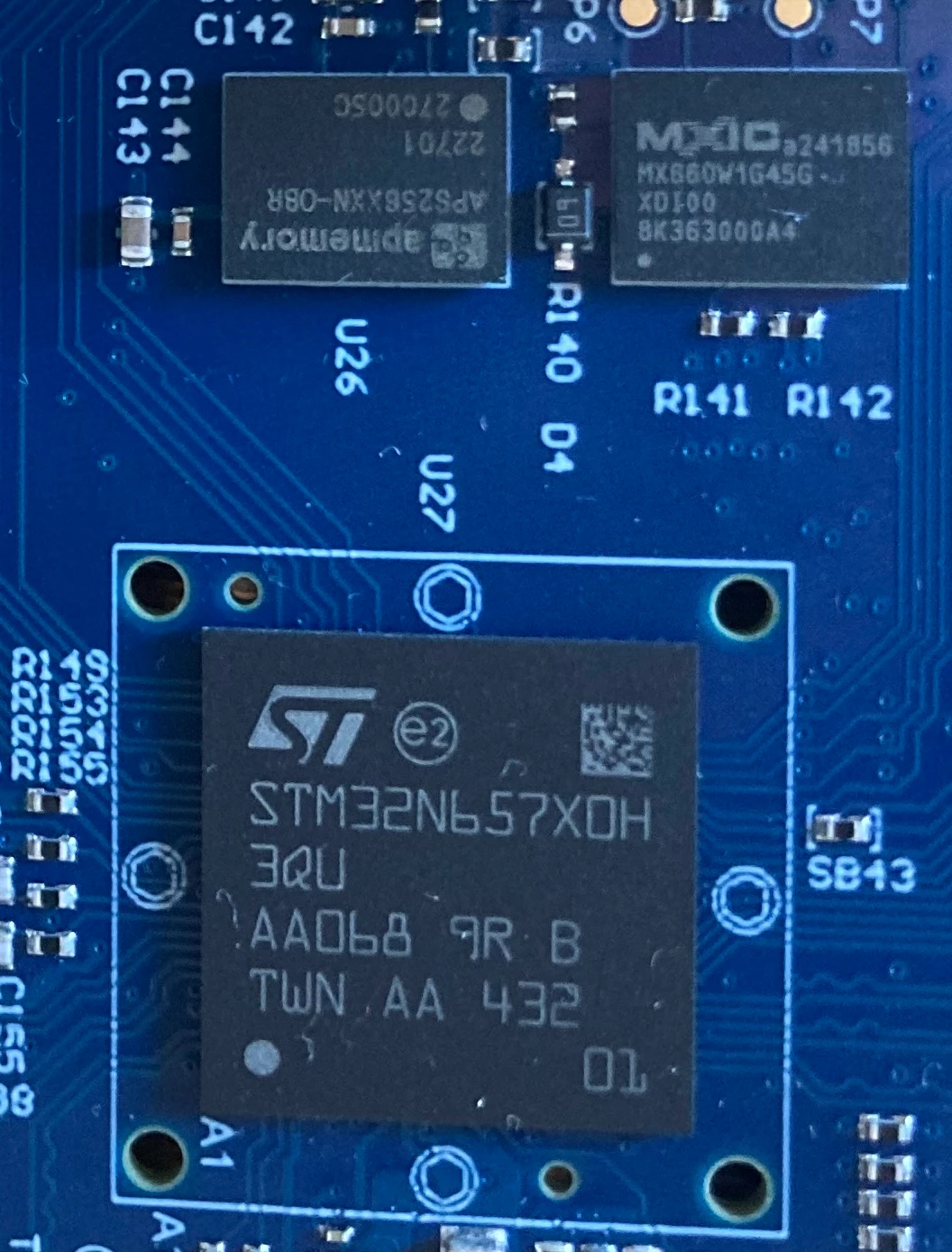

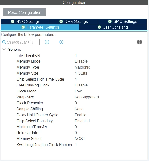

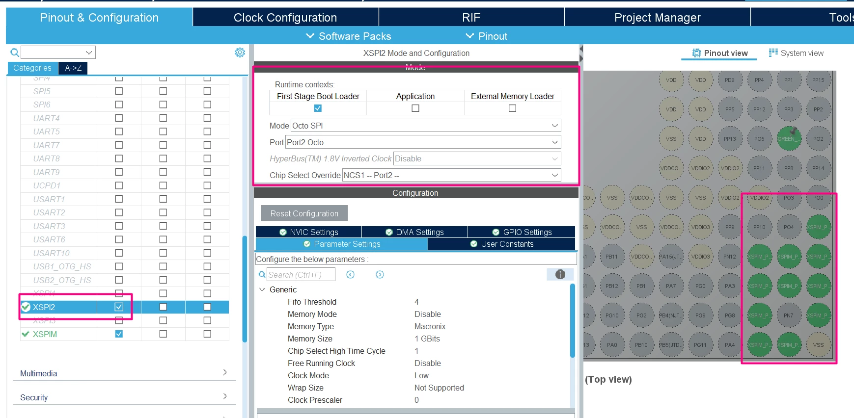

The OCTOSPI flash memory has the following characteristics: 1 Gbit, 1.8 V, 200 MHz, DTR, read while writing. It is connected to the OCTOSPI interface of the STM32N657X0H3Q microcontroller on the STM32N6570-DK board on XSPI2. With that information, go to XSPI2 to configure the peripheral according to the hardware available:
As for the [Parameter Settings], look carefully at the image below:

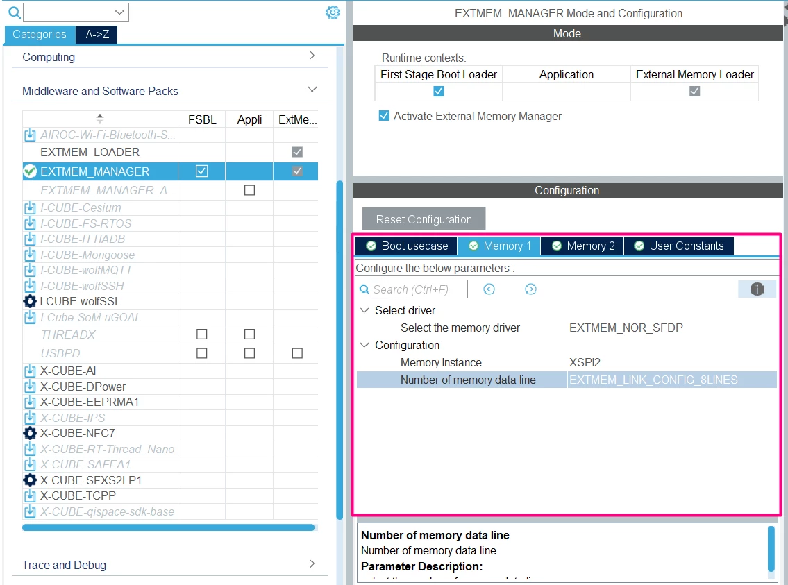

2.2.2 Configure the EXTMEM_MANAGER

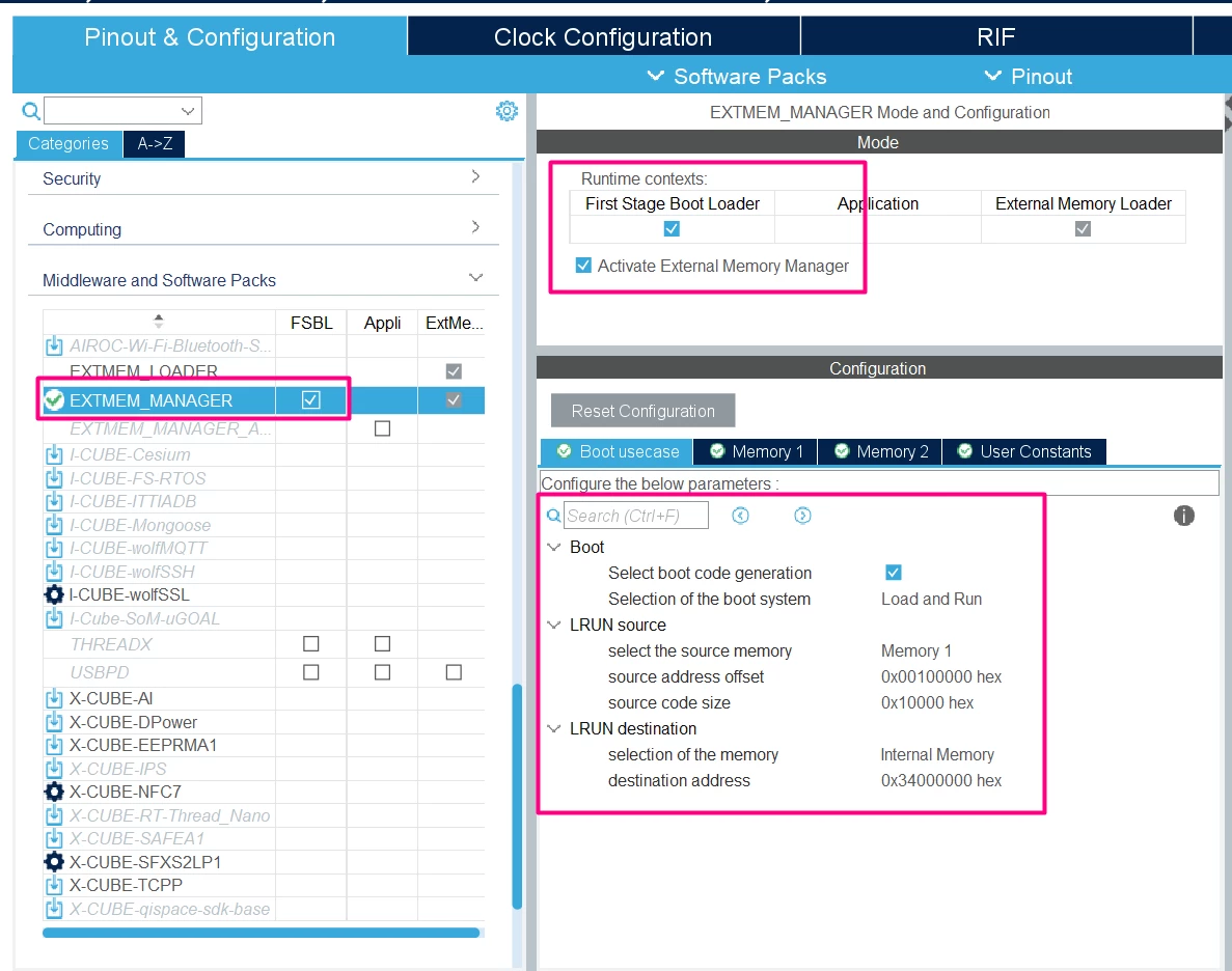

The next step is locating the [Middleware and Software Packs] in the [Categories]. Expand the [EXTMEM_MANAGER]. Add the FSBL and activate it using the following settings:
[LRUN source address offset] = 0x00100000
[LRUN source code size] = 0x10000
[LRUN destination address] = 0x34000000
In the [Memory 1] tab, ensure its as follows:

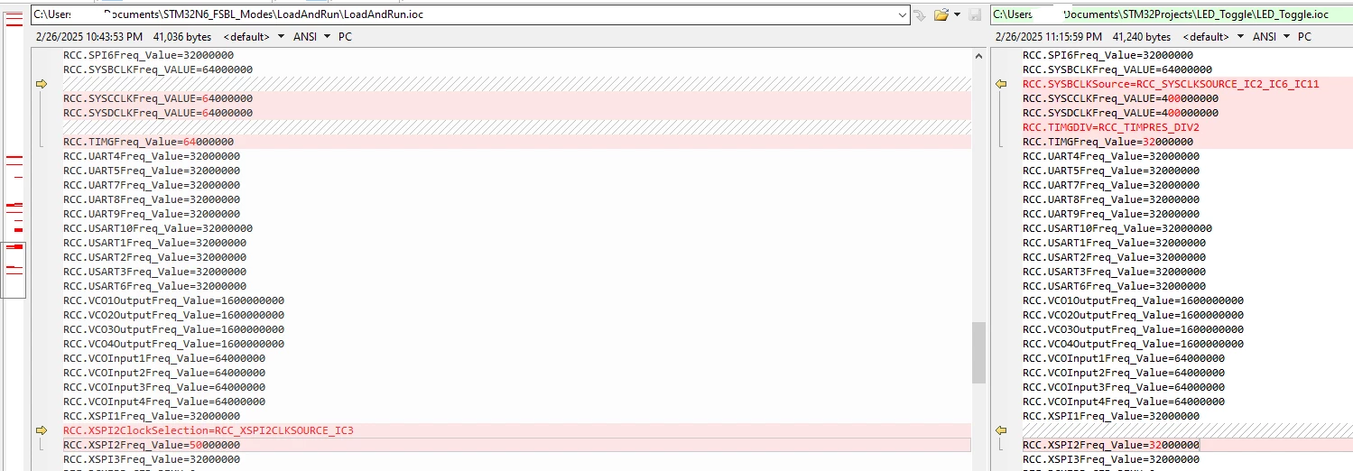

2.2.3 Configure the XSPI clock

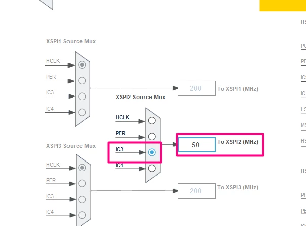

The last step for the XSPI is to configure its clock. For this example, we will set the XPI2 clock to 50 MHz. To achieve higher speeds up to the 200 MHz supported by this serial NOR FLASH, you need to make changes to OTP for I/O speed optimization, which is not covered in this article. Go to the [Clock Configuration] tab and have the IC3 as the source for the XSPI2 and type 50 and press enter for the clock to be automatically adjusted:

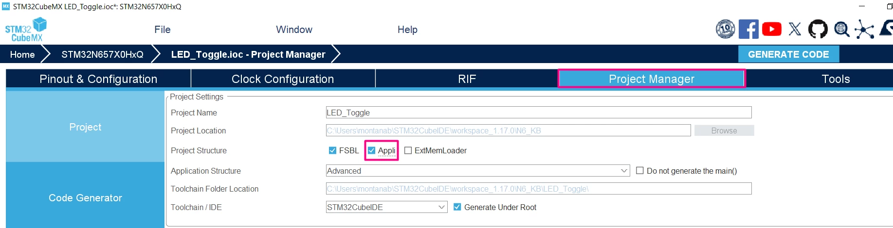

Now that we are done with the XSPI, it is time to add the [APPLI] checkbox in the [Project Manager] tab, so the application project can be created:

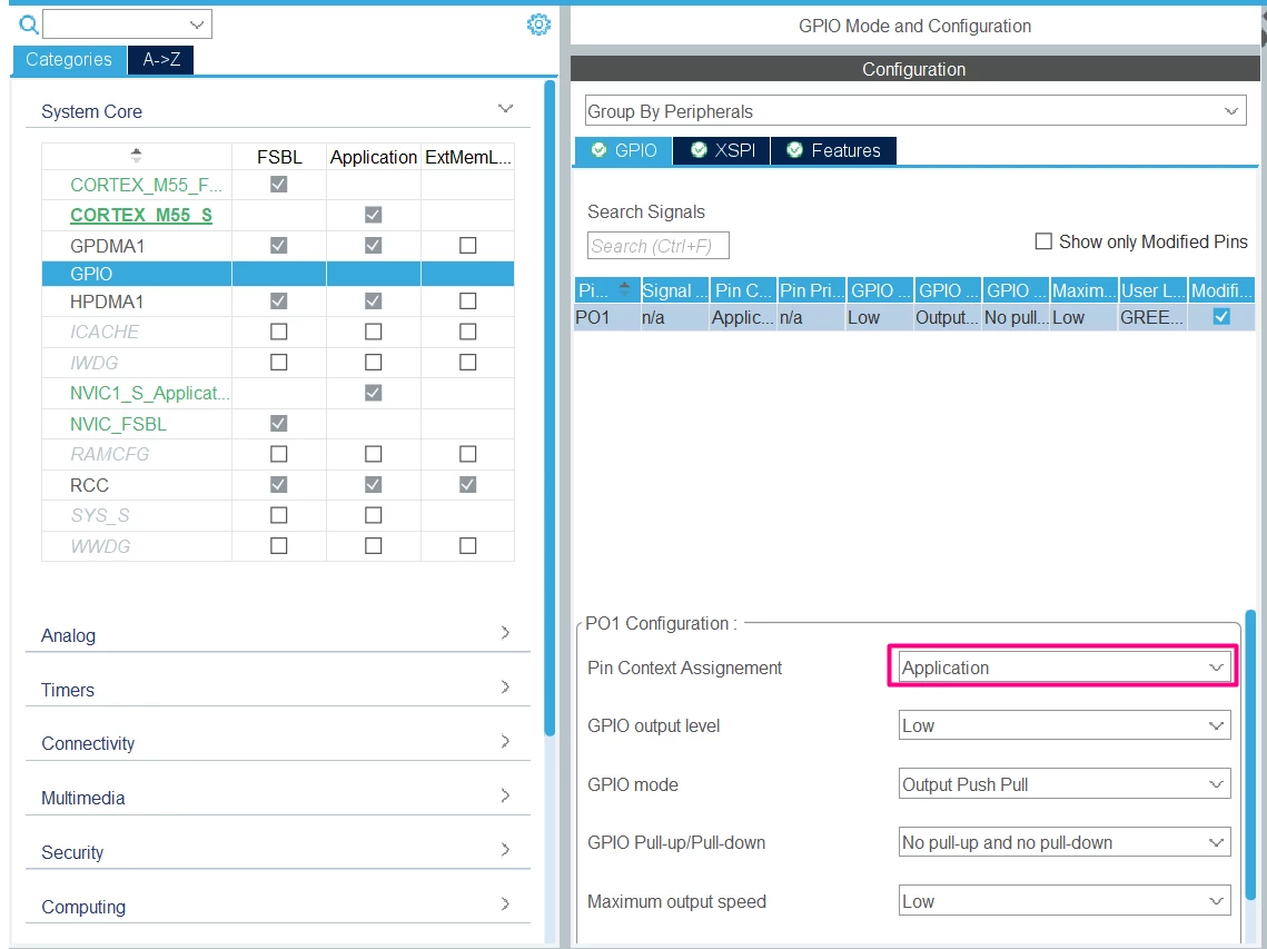

And roll back to the [Pinout & Configuration] tab to change the [GPIO] LED pin to be assigned to the application instead of the FSBL:
Proceed with the code generation for both projects.

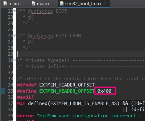

In the FSBL project, remove the previous user code portion in the main.c file, responsible for the LED toggling we had in the first hands-on. Make sure to either change the #define EXTMEM_HEADER_OFFSET from 0x0 to 0x400 in the stm32_boot_lrun.c or define it in the stm32_boot_lrun.h. The reason is that our application also has the 1 KB header, added by the script.
