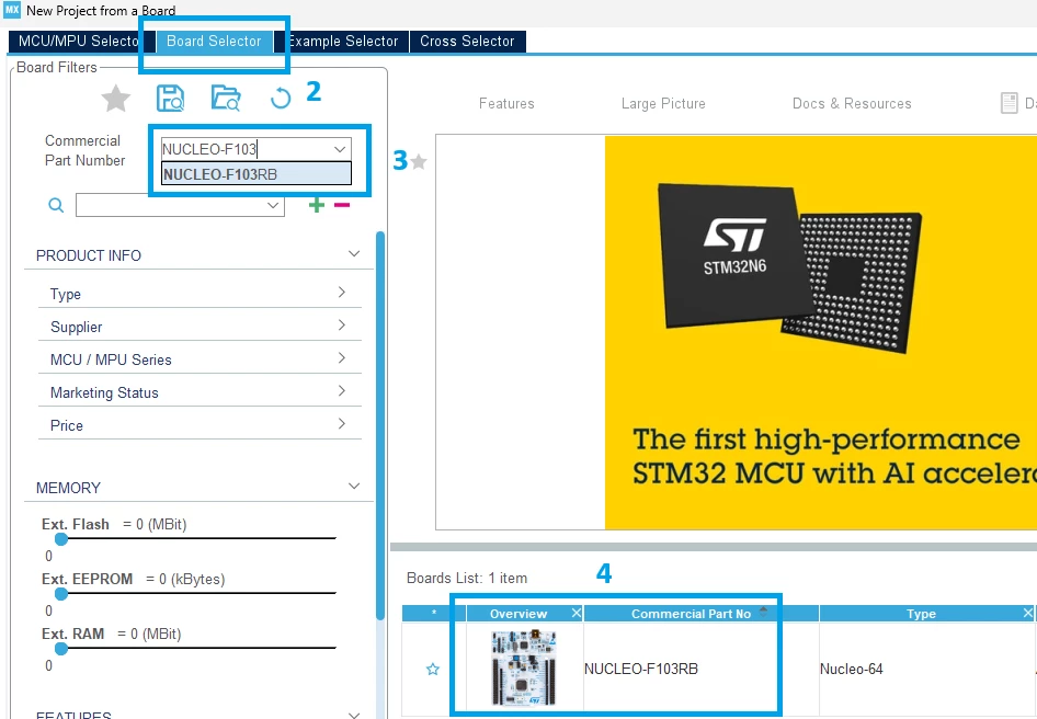

2.1 Starting the project based on the board
The example is based on the NUCLEO-F103RB board. The first thing to think about is the pins to be used by the CAN interface. So, you need to find which pins are free on the board. Although an example is using Loop back mode, you need to select CAN_Tx and CAN_RX with an externally unconnected I/O. For that we need to refer to the board’s schematic.
On the STM32F103RB MCU, there is only one CAN instance which is CAN1.

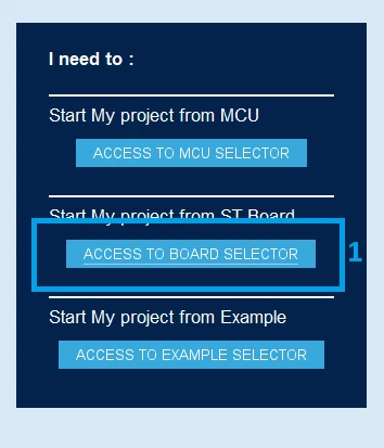

We need to start a project based on the board in STM32CubeMX:
- Create a new project starting from the “ST board”
- Select the [Access to board selector]
- Find the board “NUCLEO-F103ERE”
- In the bottom right of the window, double-click on the board image.
Figure 1. Start a project based on a ST board
Figure 2. Select NUCLEO-F103RB

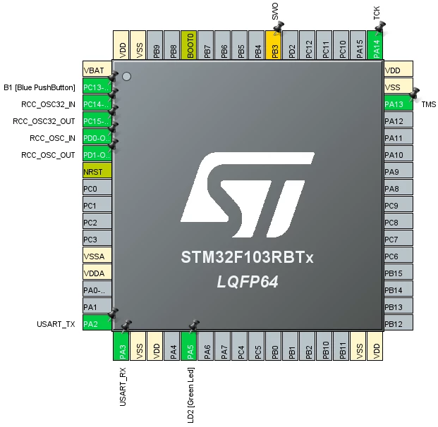

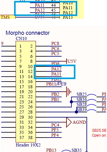

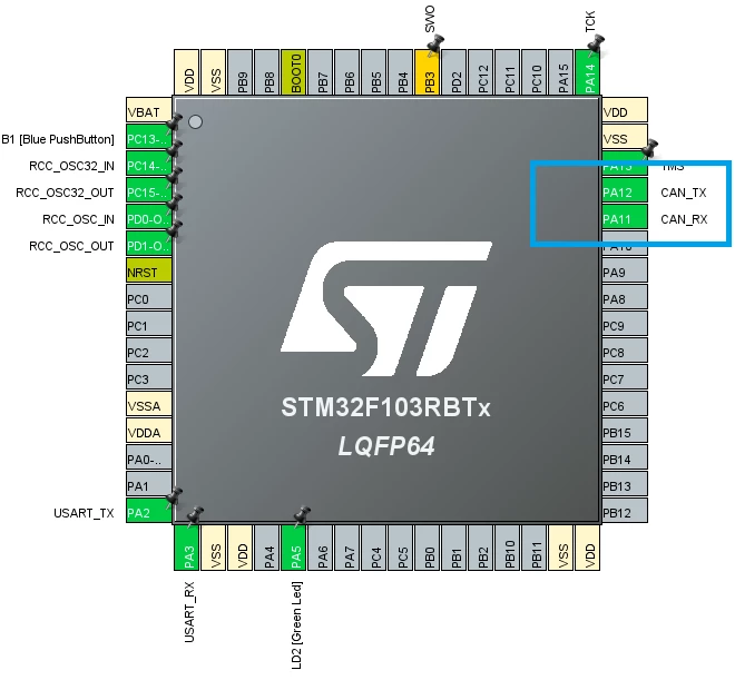

At this stage, the board default pinout is set and the used GPIOs are shown in the pinout view:
Figure 4. Default pinout view
The first thing to do is to enable CAN1 from the “Connectivity” menu:
Figure 5. CAN activation
Figure 6. CAN pins activated
After enabling CAN1, PA11 and PA12 GPIOs are enabled by default for this product. There were no conflicts between the already enabled GPIOs on the board and the CAN Ios. This is confirmed by looking at the board’s schematic, PA11 and PA12 are free, and nothing connected to them. So, these GPIOs can be used for the CAN application.
Figure 7. CAN pins on the board are free
After the CAN interface activation, there are three stuff to configure: the clock configuration, the CAN timing configuration and the GPIO configuration.

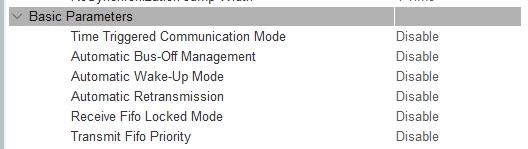

For the basic CAN parameters, we keep them to their default settings. Not needed in our basic example:
Figure 10. Basic CAN parameters setting

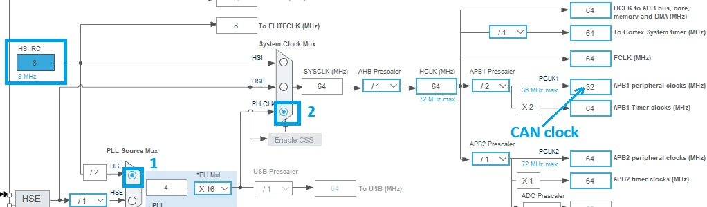

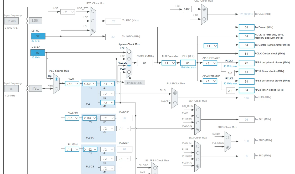

2.3 Clock configuration
As the Loop back mode is used, there is no need for a precise clock source because the bit sampler and the bit generator have the same clock source. So, HSI is used as the clock source in the example. In the case of STM32F103, the CAN peripheral is clocked from the APB1 domain as stated in the reference manual:
Figure 11. The CAN clock is on APB1 domain
So, the CAN bit time is generated and sampled based on this clock source.
In STM32CubeMX, we select an HSI clock source over PLL. The system clock source is 64 MHz and the APB1 clock is be 32 MHz (the maximum).
In STM32CubeMX, in “Clock Configuration view”:
- Select HSI clock source (8MHz/2)
- Select PLLCLK to enable the PLL
Figure 12. System clock configuration

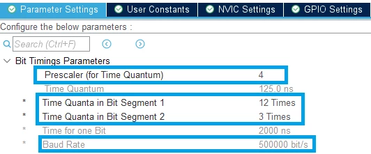

2.4 CAN timing configuration

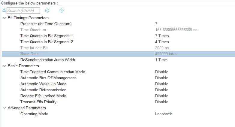

In this example, we set the CAN bitrate at 500 KB/s. Knowing that in the Loop back mode, the bitrate configuration is not a must. The CAN bit time configuration applies for both Tx and Rx and the transmitted messages are received at the same CAN bitrate.

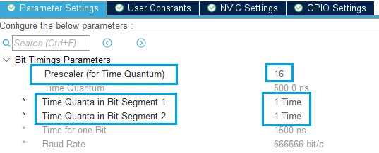

Take precaution. Setting BS1 and BS2 to very low values such as BS1=1 and BS2=1 leads to a communication issue. Better to decrease the CAN clock prescaler and increase BS1 and BS2 as much as possible fitting the CAN bitrate.
In STM32CubeMX, in “Parameter Settings”, the default timing config values set are:
- Prescaler = 16
- Time Quanta in Bit Segment 1 = 1
- Time Quanta in Bit Segment 2 = 1
These are not ideal settings.
Figure 13. Default CAN timing configuration in STM32CubeMX
The first thing to do is to increase BS1 and BS2 to their maximum values (BS1=16, BS2=8) in STM32CubeMX. Decrease the prescaler step by step until the CAN bitrate target value is found. If the operation does not allow to converge to the wished exact bitrate, try to play with the prescaler.
As said, in our example the CAN bitrate is set to 500 KB/s. The sample point needs to be selected between 75% and 87% of the bit time.
In STM32CubeMX, we choose these settings:
Figure 14. CAN timing configuration
The bit time = SyncSeg + BS1 + BS2. In our case, the bit time = 1 + 12 + 3 = 16
Where SyncSeg is always = 1.
The sample point = (SyncSeg + BS1) / bit time = (1 + 12) /16 = 0,8125 à Sample point at: 0,8125%
In this configuration, the sample point is set at ~81% of the bit time.
You can use the attached excel file calculator (CAN bitrate calculation.xlsx) to find the suitable timing configurations for the CAN bitrate, including the sample point.

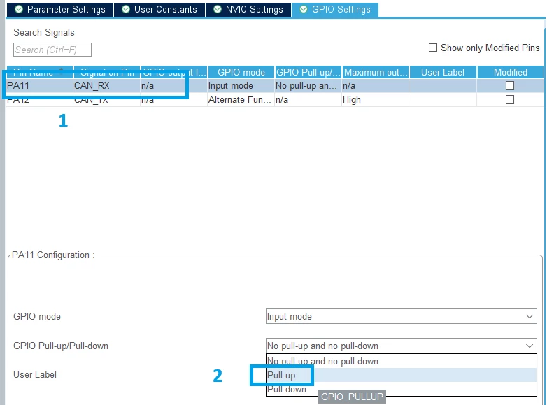

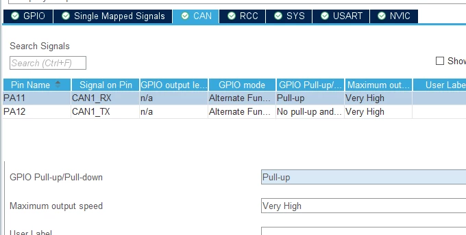

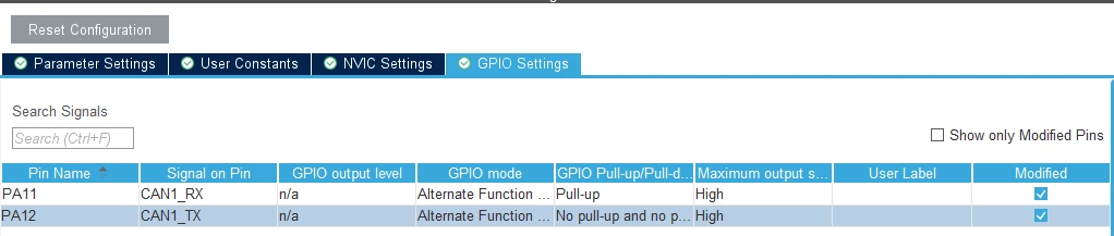

2.5 CAN GPIO configuration
Even if the CAN signals are internally connected by hardware, it is mandatory to configure the I/Os. This is already done when CAN is activated in STM32CubeMX as shown in the figures 5 and 6. To avoid issues, we need to activate the internal pull-up resistor manually on the CAN_Rx pin.
In that case, we need to go to the “GPIO settings” tab and set the pull-up on CAN_Rx pin which is PA11 in this case.
In STM32CubeMX, go to the “GPIO Settings” tab, and:
- Click on the CAN_RX pin
- Go to the PA11 configuration then to “GPIO Pull-up / Pull-down” and select [Pull-up] to set the internal resistor.
Figure 15. Setting the pull-up on CAN_Rx pin

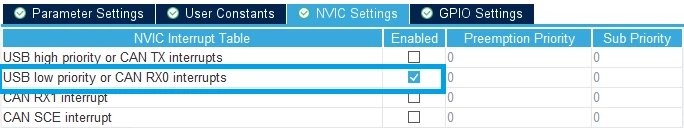

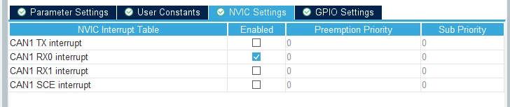

2.6 CAN interrupt settings
In the example, we use the CAN message reception in the interrupt mode. There are three NVIC interrupts available for CAN: two for the FIFOs' reception (FIFO0 and FIFO1) and one for the CAN error management. On STM32F1 family, the CAN Rx FIF0 NVIC interrupt line is shared with a USB low-priority interrupt line. In our case, we activate the interrupt only on FIFO0 as we do not use FIFO1 or the CAN error.
In STM32CubeMX, go to the “NVIC Settings” tab, and check [USB low priority or CAN RX0 interrupts] option:
Figure 16. Enable CAN RX0 NVIC interrupt channel
We can keep the “Preemption Priority” and “Sub Priorities” set to their default values 0.

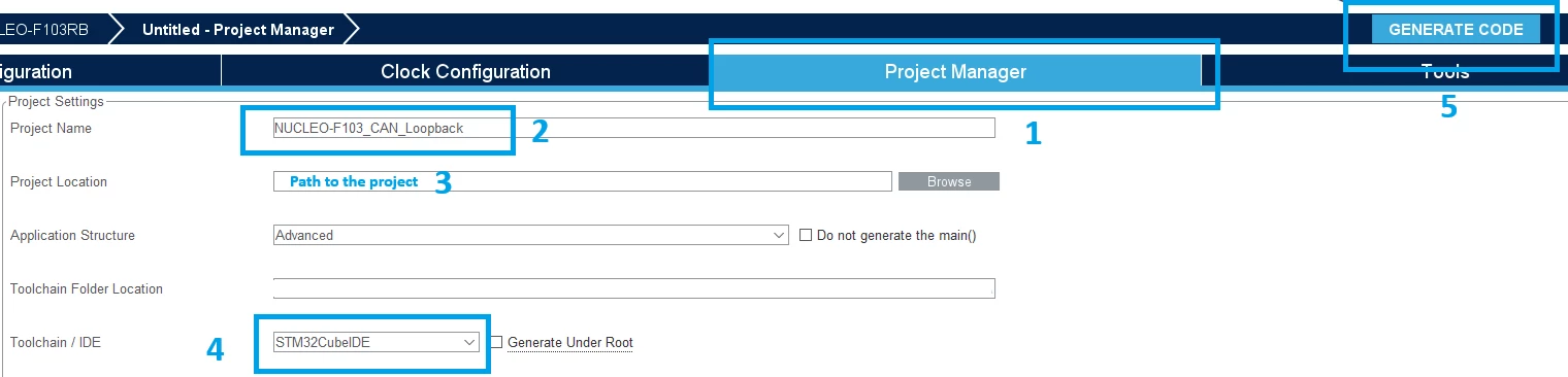

3.1 Generating the code
In STM32CubeMX, after setting all the parameters of the RCC and the CAN peripheral, we need to name the project. Select where the project will be saved and set the toolchain to use. In our case, it is STM32CubeIDE.
In STM32CubeMX,
- Go to the Project Manager view
- Name the project. Example: NUCLEO-F103_CAN_Loopback
- Browse to the location where the project will be saved
- Select your preferred toolchain. In our case, it is STM32CubeIDE
- Click on “Generate code”
Figure 17. Project code generation

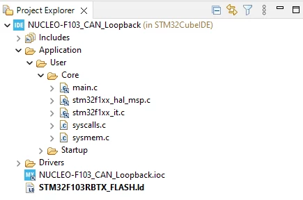

After generating the code, and opening STM32CubeIDE, this is what you need to see in the “Project Explorer”:
Figure 18. Project explorer view after generating the code

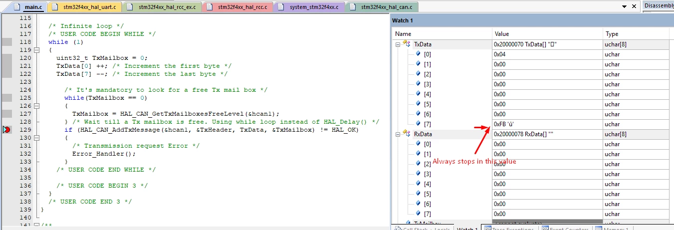

Now, it is time to add the code responsible for the CAN transmission in the while loop. Note that we need to check first if there is one Tx mail box available to send the current CAN frame. Otherwise, HAL_CAN_AddTxMessage() returns an error if you do not wait until the previous frame is sent.
Some users put HAL_Delay(). It works but for efficiency reason, it is preferable to poll on the Tx free mail box.
The application transmits 8 bytes where the first byte (byte 1) is incremented, and the last byte (byte 8 is decremented.
Insert this code between while (1) { and /* USER CODE END WHILE */
TxData[0] ++; /* Increment the first byte */
TxData[7] --; /* Increment the last byte */
/* It's mandatory to look for a free Tx mail box */
while(HAL_CAN_GetTxMailboxesFreeLevel(&hcan) == 0); /* Wait till a Tx mailbox is free. Using while loop instead of HAL_Delay() */
if (HAL_CAN_AddTxMessage(&hcan, &TxHeader, TxData, &TxMailbox) != HAL_OK)
/* Transmission request Error */
Error_Handler();

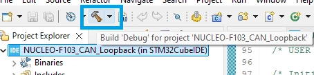

}Now, compile the project by clicking on the hammer button:
Figure 19. Compile the project

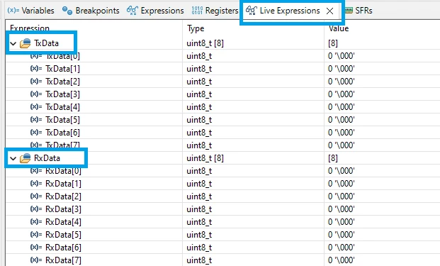

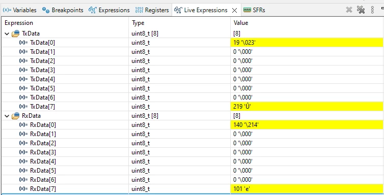

4. Running the application and tests

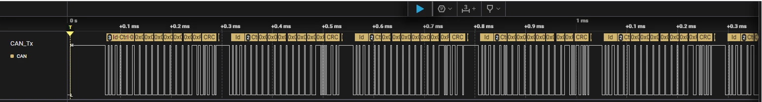

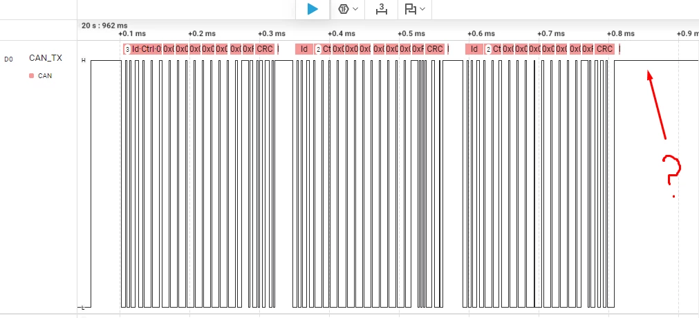

In this section, we show how to test the CAN in Loop back mode. For that we use the Saleae logic analyzer in CAN mode. We probe CAN_Tx (PA12). On NUCLEO-F103 the connector pin CN10/12 is used.
Connect the GND of the logic analyzer to the GND of the board and connect the data 0 (D0) of the logic analyzer input to CAN_Tx (PA12).
In the Saleae logic analyzer software interface, enable the digital channel 0. Go to the analyzer menu “Add Analyzer” and search for “CAN” and select it.:
Figure 20. Configure the Saleae logic analyzer digital channel 0 input in CAN mode
A window is shown to configure the CAN bitrate. In our case 500 KB/s is used. Set the value to 500000 (in Bits/s) and click [Save]:
Figure 21. CAN configuration with Saleae logic analyzer

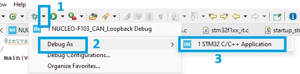

Now, connect the board to your PC/laptop with a USB data cable over STLINK USB connector and in STM32CubeIDE, start a debug session:
Figure 22. Start a debug session of the application in STM32CubeIDE
Wait until the debug to start.
You can add TxData and RxData to the “Live Expressions” view, to check how they update while the application runs:
Figure 23. Adding TxData and RxData to the Live Expressions in STM32CubeIDE

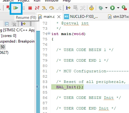

Now, run the application from STM32CubeIDE by clicking the green triangle:
Figure 24. Running the application on STM32CubeIDE
The logic analyzer starts capturing the CAN frames sent on CAN_Tx pin (PA12).
These are the frames captured by the logic analyzer:
Zoom out of the capture:
Figure 25. Zoom-out of the CAN frames captured by the logic analyzer
In the first frame sent by the application, the analyzer indicated that the frame ID is 0x123. The first byte sent in the frame is 0x01 and the last data sent is 0xFE. Which corresponds well to what the application is doing.
Figure 26. Zoom-in on the first CAN frame sent by the STM32 and captured by the logic analyzer
Note that the pulses related to the zeroed data correspond to the bit stuffing.
In the debugger we can see that RxData is changing in live in the “Live Expressions”. Only the bytes 0 and 7 are changing (in yellow color):
Figure 27. Tx and Rx buffers are changing in live in the STM32CubeIDE debugger
