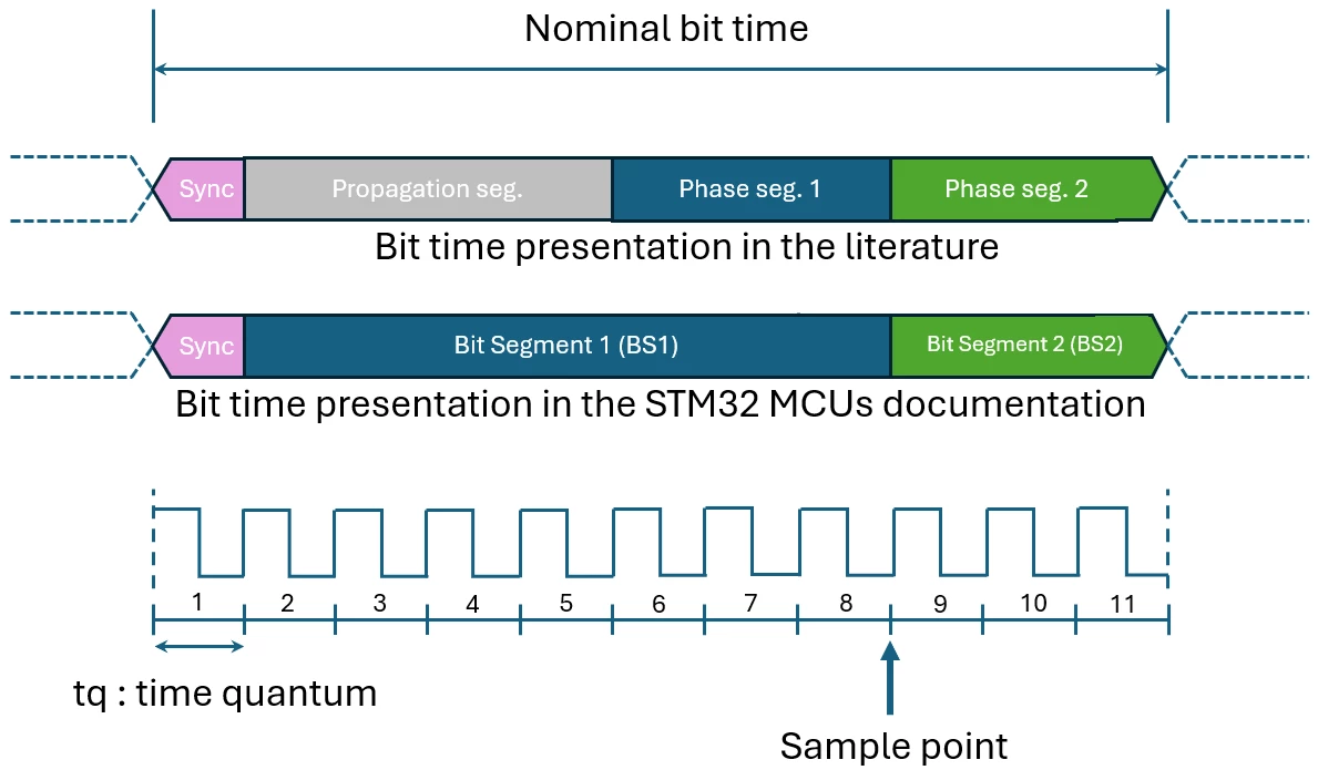

1. The CAN bit and its generation on STM32
A CAN frame is constituted by a bit sequence. Each bit has a value of “1” or “0”. In CAN jargon, “1” and “0” are respectively called recessive bit and dominant bit. In the next sections we describe in detail the CAN bit time, time quanta, sample point concepts, and what purpose they are used for.
As shown by the figure 1, the CAN bit is divided into several segments. Figure 1 below shows the representation of the CAN bit and its timing described in the literature: Synchronization segment, Phase segment 1 and Phase segment 2 as well as in the CAN bit and its timing in the STM32 documentation which are the Synchronization segment, Bit segment 1 (BS1), and Bit segment 2 (BS2).
  Figure 1. The CAN bit time
Note: the tq definition is provided in section 2.

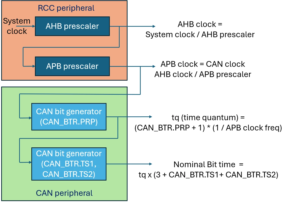

Figure 2 gives a view on how the CAN bit time is generated.
Figure 2. CAN bit time generation on STM32Figure 2. CAN bit time generation on STM32

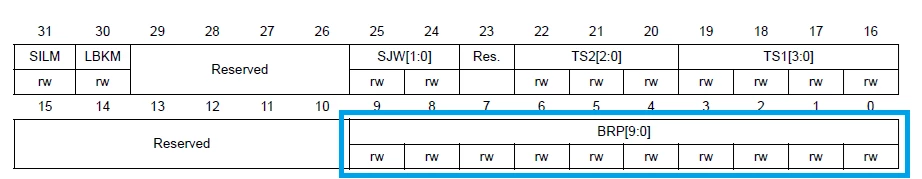

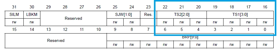

On STM32, the register responsible for the CAN timing is the CAN_BTR register. Refer to the reference manual of the product/section “Controller area network (bxCAN)”.

On STM32, the tq is generated from the APB clock divided by the CAN prescaler (see Figure 2) that needs to be set in the CAN_BTR.BRP field:  .Figure 3. CAN prescaler field in CAN_BTR registerFigure 3. CAN prescaler field in CAN_BTR register
The time quantum tq is given by the following equation (equation 1):

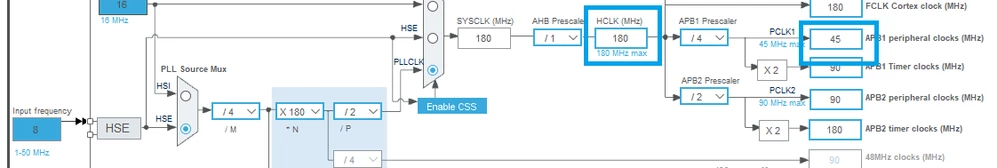

In the case of STM32CubeMX, if we take the STM32F439 MCU as an example, and if the RCC clock configuration is as follows:
Figure 4. RCC clock configuration exampleFigure 4. RCC clock configuration example

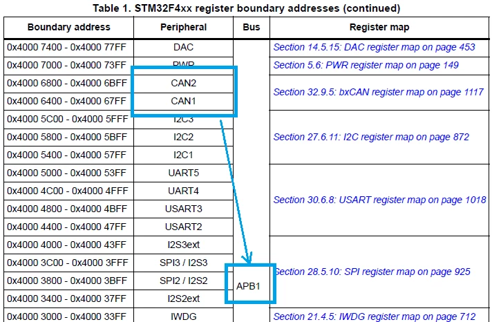

As the CAN instances are located on the APB1 domain, and the CAN clock is generated from the APB1 clock. From the STM32F4xx MCU reference manual (RM0090) we can see:
Figure 6. The CAN instances are located on APB1 domainFigure 6. The CAN instances are located on APB1 domain
That is why APB1 prescaler is used in the tq calculation.
3. The CAN bit time
The CAN bit time is the period of time for which the bit is actually present on the bus. It changes slightly due to the oscillator drift/jitter of the CAN node caused by the temperature or the voltage fluctuations and the aging of the components. In the CAN world, the wording “CAN node” refers to a CAN station connected to a CAN network.
The CAN nominal bit time is the theorical/ideal value that the designers of the CAN bus system wish to assign to their network. Each CAN node connected to the same CAN bus must be configured to have a such ideal and the same value.  In the CAN literature, the CAN bit time is fictively divided in four parts: Synchronization (sync), Propagation segment, Phase segment 1, and Phase segment 2.
The CAN bit time is defined as tq x TQ.
Example, in Figure 1, the time quanta (TQ) = 11. If the tq = 0,0909 µs,
à CAN bit time = 0,0909 x 11 = µs.
3.1 The synchronization slot
The synchronization segment is the first segment of the CAN bit time, and it is used to synchronize the different nodes connected on the bus. The first border (rising or falling edge) of the CAN bit should appear within this timing window. The duration of this segment is always fixed at 1xtq (see later for the tq definition).
tsync = 1 x tq
The synchronization segment should not be confused with the synchronization jump width (SJW), which is another timing parameter that is not covered by this article.
3.2 The propagation segment
As you may now the signal takes time to propagate in a medium. An electrical signal on an electrical wire takes time to propagate from point A to point B. The longer the wire, the longer the signal takes time to propagate from end to end.
The propagation segment is intended to compensate all the delays induced by the signal propagation on the medium (electrical or other). This is the type of topology adopted by the CAN system designer to develop the CAN network.
3.3 Phase segment 1 and 2
These two segment phases are used to compensate for changes of the edge position of the signals due to the frequency of the various nodes of the network. The voltage thresholds level at the input of the comparator inside the CAN transceivers etc.
In the STM32 documentation, the propagation segment and Phase segment 1 are merged to form the Bit segment 1 (BS1). See Figure 1.
So, the bit time segment 1 is defined as: tBS1 = tprop_seg + tph_seg1
Where tprop_seg is the duration of the propagation segment and tph_seg1 is the duration of the Phase segment 1.
For Phase segment 2, its duration is defined as tBS2 or tph_seg2 and it defines, with tBS1, the bit sample point position (see section 3).
On STM32, the possible values of time quanta (TQ) for BS1 can be set between 1 and 16. For BS2, the TQ can be set between 1 and 8 in the CAN_BTR register. When TS1 or TS2 value is set to 0, it is interpreted as 1TQ.
Figure 7. Time segment 1 and Time segment 2 fields in CAN_BTR registerFigure 7. Time segment 1 and Time segment 2 fields in CAN_BTR register
So, the duration of tBS1 is between 1 x tq and 16 x tq and the duration of tBS2 is between 1 x tq and 8 x tq.
On the STM32, the bit time is defined as follows:
Note, 1 is added to CAN_BTR.TS1 and to CAN_BTR.TS2, 0 is actually corresponding to the value 1*TQ in these fields.
Since the synchronization phase duration is fixed to 1*TQ, the CAN nominal bit time will be (equation 5):

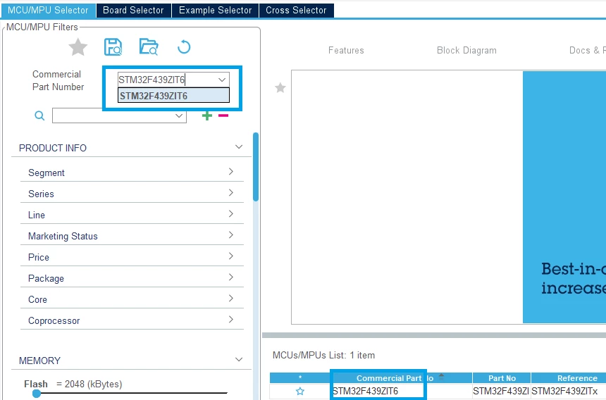

In STM32CubeMX, we start the project from the MCU part number STM32F439ZI (See Figure 8).
Figure 8. STM32F439ZI MCU selection in STM32CubeMXFigure 8. STM32F439ZI MCU selection in STM32CubeMX

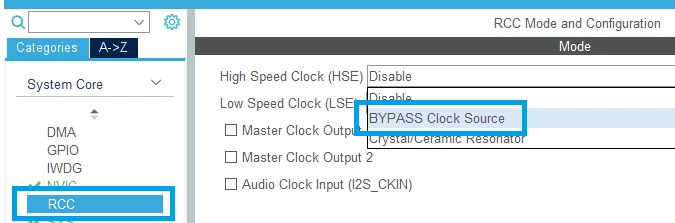

As the STLINK-MCO clock source is used, we need to set the HSE in Bypass mode.
Figure 9. Setting HSE in Bypass mode in STM32CubeMXFigure 9. Setting HSE in Bypass mode in STM32CubeMX

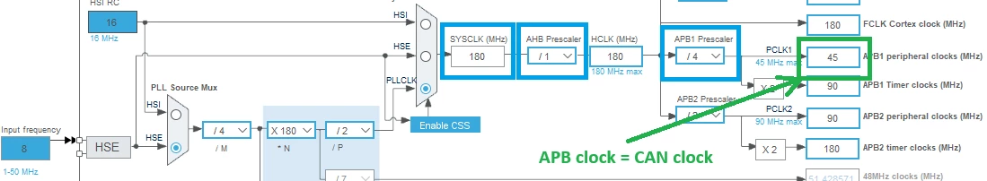

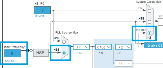

Now, make sure that the input clock is set at 8 MHz. Select HSE as a PLL source and the clock source of the system clock is generated from the PLL as shown in Figure 10.
Figure 10. Configuring the system clock source in STM32CubeMXFigure 10. Configuring the system clock source in STM32CubeMX
If STM32CubeMX shows errors, select them to fix them automatically by the tool according to the system clock frequency you need to use.
In our case 180 MHz is used as a system clock frequency of the MCU. The APB1 from which the CAN peripheral is clocked, is set to 45 MHz which is its maximum value as indicated in the STM32CubeMX (see Figure 11).
Figure 11. System clock and APB1 clock valuesFigure 11. System clock and APB1 clock values

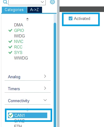

Now, we are going to enable CAN1 by activating it in CAN menu as shown in Figure 12.
Figure 12. Activating CAN1 peripheral in STM32CubeMXFigure 12. Activating CAN1 peripheral in STM32CubeMX

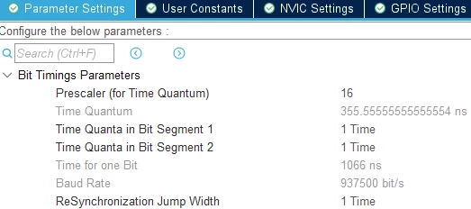

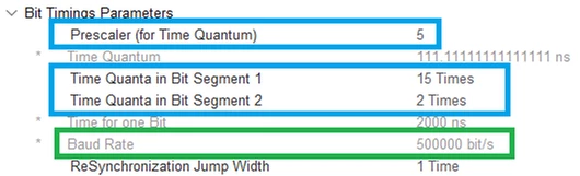

As shown in the Figure 13, the default CAN timing settings are not suitable for our case and need to be updated. The bitrate is set to 937500 bit/s while we need to set it to 500 kbit/s.
Figure 13. Default CAN timings in STM32CubeMXFigure 13. Default CAN timings in STM32CubeMX

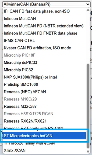

At this stage, we use this CAN bit timing web tool that helps us selecting the recommended values. These values are for the CAN prescaler, Time Quanta in Bit segment 1 (BS1), and the Time Quanta in Bit segment 2 (BS2) based on our needs: CAN bitrate = 500 kbit/s with a simple point set to 87.5% as provided in the table 2.
In the web tool, we start by selecting the version of the CAN to be used. We select “STMicroelectronics bxCAN” as shown in Figure 14.
Figure 14. Selecting the correct CAN versionFigure 14. Selecting the correct CAN version

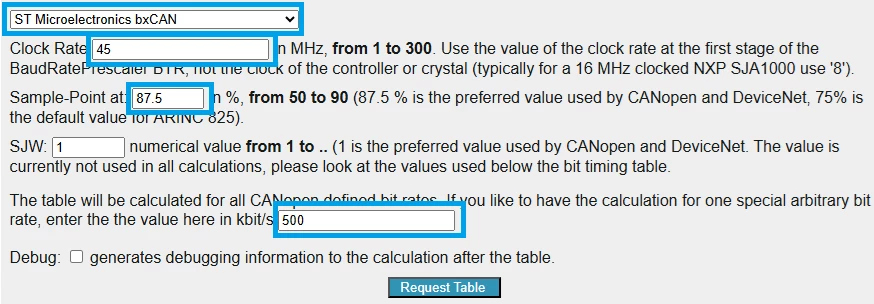

There is no need to select the CAN clock frequency in MHz. In our case, the CAN clock is the same as APB1 (see Figure 2). As the APB1 clock = 45 MHz (see Figure 11), we put 45 in the “Clock Rate field” as shown in Figure 15.
Figure 15. Putting the CAN clock frequency in MHzFigure 15. Putting the CAN clock frequency in MHz
The default value of the sample point is already set to 87.5% as shown in the Figure 16. We keep that value.
Figure 16. Sample point is already set to 87.5%Figure 16. Sample point is already set to 87.5%
As the CAN bitrate to be used is 500 kbit/s, we need to put 500 as shown in the Figure 17.
Figure 17. CAN bitrate at 500 kb/sFigure 17. CAN bitrate at 500 kb/s
For those who needs to change the SJW value, you can do it over “SJW” field. In our case, we keep the default value = 1.
Figure 18 shows the full picture of the settings in the web tool.
Figure 18. A full picture of the settingsFigure 18. A full picture of the settings

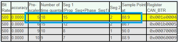

Now, we need to click the [Request Table] button (Figure 19).
Figure 19. “Request Table” buttonFigure 19. “Request Table” button
The tool generates a table where it provides many settings with these same CAN bitrates. There are different sample points as it did not find a suitable CAN parameters matching the 87.5% as a sample point. See figure 20.
Figure 20. Generated CAN timing tableFigure 20. Generated CAN timing table
In STM32CubeMX, we set these recommended values in the “Bit timings Parameters” menu as shown in Figure 21.
Figure 21. Setting the CAN timing parameters in STM32CubeMXFigure 21. Setting the CAN timing parameters in STM32CubeMX
To avoid a warning message on bitrates in STM32CubeMX, it is recommended to start by setting BS1 and BS2 then finish by setting the CAN prescaler. See Figure 20.
As shown in Figure 21, the wanted CAN bitrate is set to 500 kbit/s. At this level, the CAN timings is all set.
