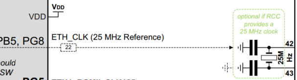

  1. RMII with 25 MHz crystal on the PHY; REF_CLK from the PHY (AN5031 Rev 3, Figure 44)
  2. RMII with 25 MHz on the ETH_CLK pad from the internal RCC, without a PHY crystal; REF_CLK from the PHY (AN5031 Rev 3, Figure 44)

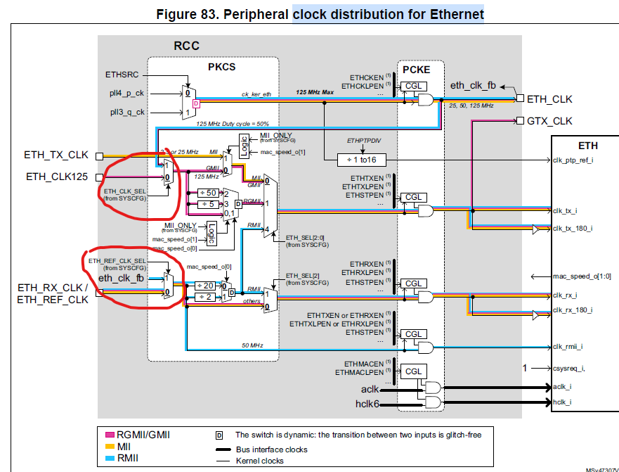

RCC Ethernet Clocks
You can see the GMAC clock configuration for the PHY in the RCC reference manual 0436rv5 fig 83
§ RCC
  Peripheral clock distribution for Ethernet
3 main STM32MP1 pads are to be considered between STM32MP1 GMAC and PHY:
  • The ETH_CLK pad which provide a clock to the PHY.
  • The ETH_REF_CLK pad or ETH_CLK125 pad to get reference clock from the PHY.
Depending on the configuration of your design, you have to configure the device tree, the ethernet driver controls the clock configuration via the below registers.
ETH_CLK_SEL, ETH_REF_CLK_SEL and ETH_SEL are controlled via the register SYSCFG_PMCSETR.
ETHMACEN,ETHRXEN,ETHTXEN,ETHCKEN are controlled by RCC_MP_AHB6ENSETR.
ETHSRC is controlled by RCC_ETHCKSELR.

"eth-ck": When no crystal feeds the PHY, the microprocessor unit (MPU) on pad ETH_CLK provides the 25 MHz or 50 MHz clock to the PHY. In this case, the clock (from ETH_CLK feedback) is provided by PLL4P or PLL3Q. This configuration corresponds to examples 3 and 6 in AN5031.
  1. Add the clock to the device tree (DT) Ethernet node:
clock-names = "stmmaceth", "mac-clk-tx", "mac-clk-rx", "ethstp", "syscfg-clk", "eth-ck";
clocks = <&rcc ETHMAC>, <&rcc ETHTX>, <&rcc ETHRX>, <&rcc ETHSTP>, <&rcc SYSCFG>, <&rcc ETHCK_K>;
<&rcc ETHCK_K> enables eth_clk_fb; see Ethernet figure 83, top-right corner.
  1. Ensure that the TF-A device tree st,pkcs property contains CLK_ETH_PLL4P or CLK_ETH_PLL3Q and that the enabled ck_kern_eth clock is present. This change updates the RCC_ETHCKSELR.ETHSRC bit.
  1. Ensure the used PLL setting define a 25 MHz or 50 MHz.

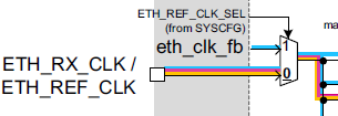

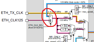

  • Set the st,eth-clk-sel Boolean property in the RGMII PHY when the PHY does not provide a 125 MHz clock to the ETH_CLK125 pad
The ETH_CLK125 pad is not used. The RCC provides a 125 MHz clock to the GMAC.
  • In RMII mode, set "st,eth-ref-clk_sel" in the kernel and "st,eth_ref_clk_sel" in U-Boot when the PHY does not provide ETH_REF_CLK.
The ETH_RX/REF_CLK pad is not used. The reference clock for RMII comes from the reset and clock controller (RCC) (eth_clk_fb).
