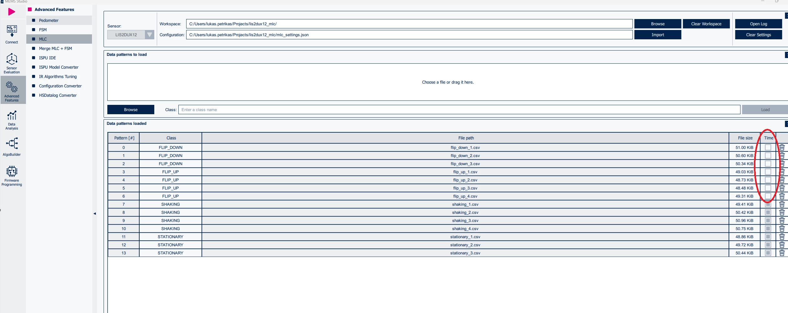

    I have collected some samples of different movements:
    1. Flipping down the device
    2. Flipping up the device
    3. Shaking the device
    4. Device stationary on the table
    When I upload all CSV's to the MLC tab Data patterns menu, something is not right.
    First thing I notice is that when I am uploading shaking/stationary samples, it loads very fast. When I select flip_down or flip_up samples and click "Load" button the MEMS Studio hangs for up to 1 minute to load 3-4 50KB files which indicates that something may be wrong. I did try to inspect the CSV's using text editor and they all look fine and simillar.
    Second thing, I dont understand what is the issue with the flip_up and flip_down samples. Why the Time option is different between these and stationary/shaking? As a result of that, I cannot proceed with ARFF generation.
    I have explained more about the issues I am having in the community forum post below:
    https://community.st.com/t5/mems-sensors/using-mems-studio-to-generate-custom-machine-learning-decision/td-p/892810
    hopefully you can clarify and explain the issues I am having
