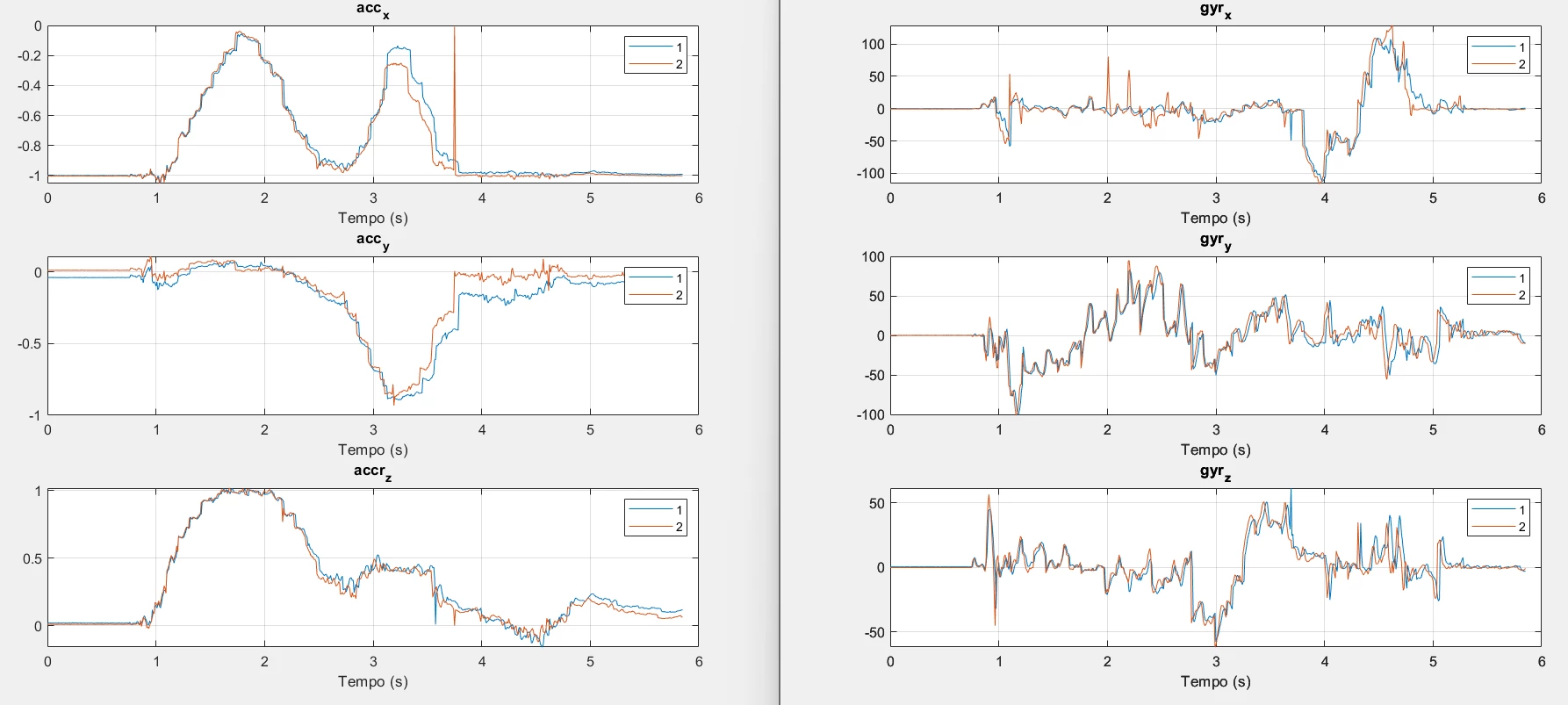

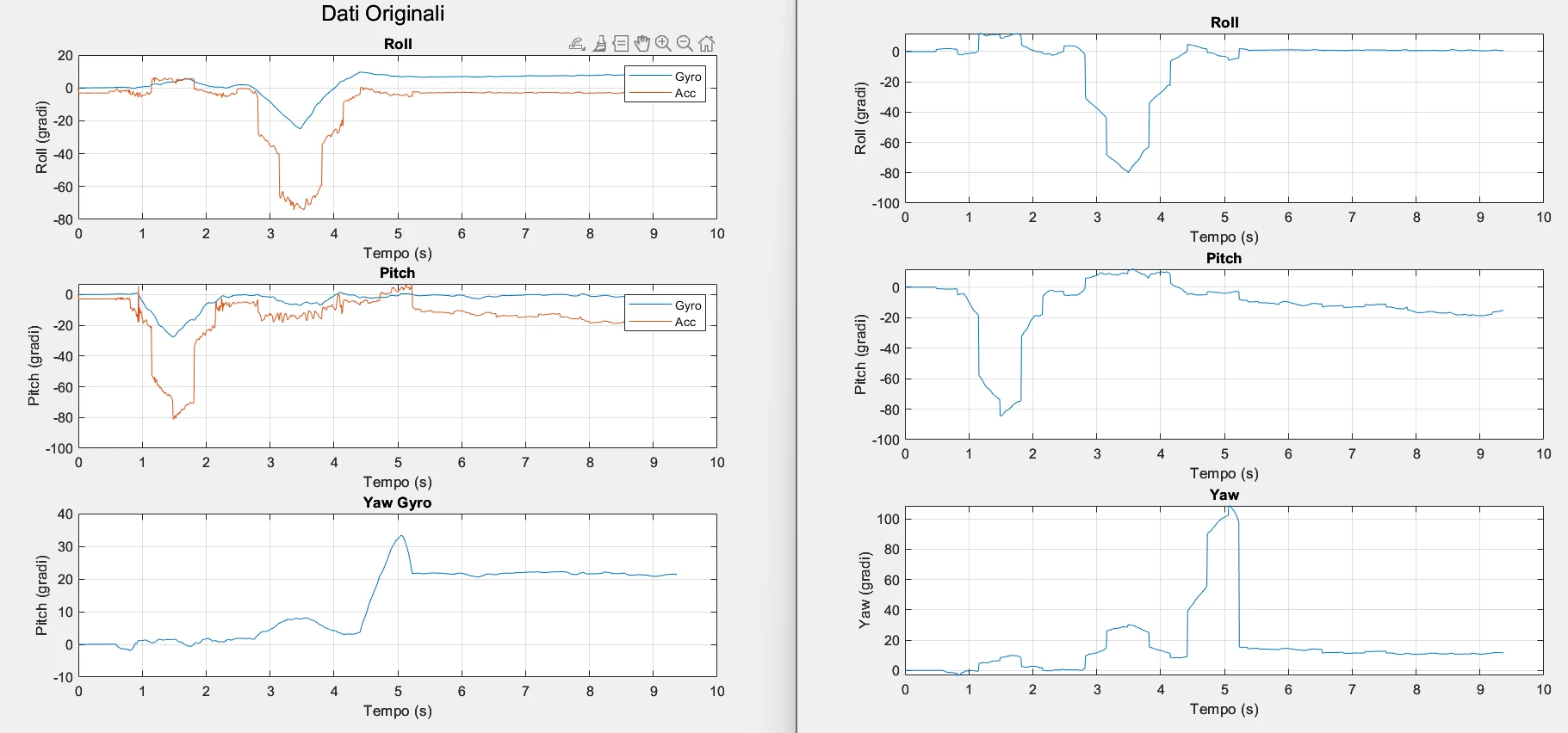

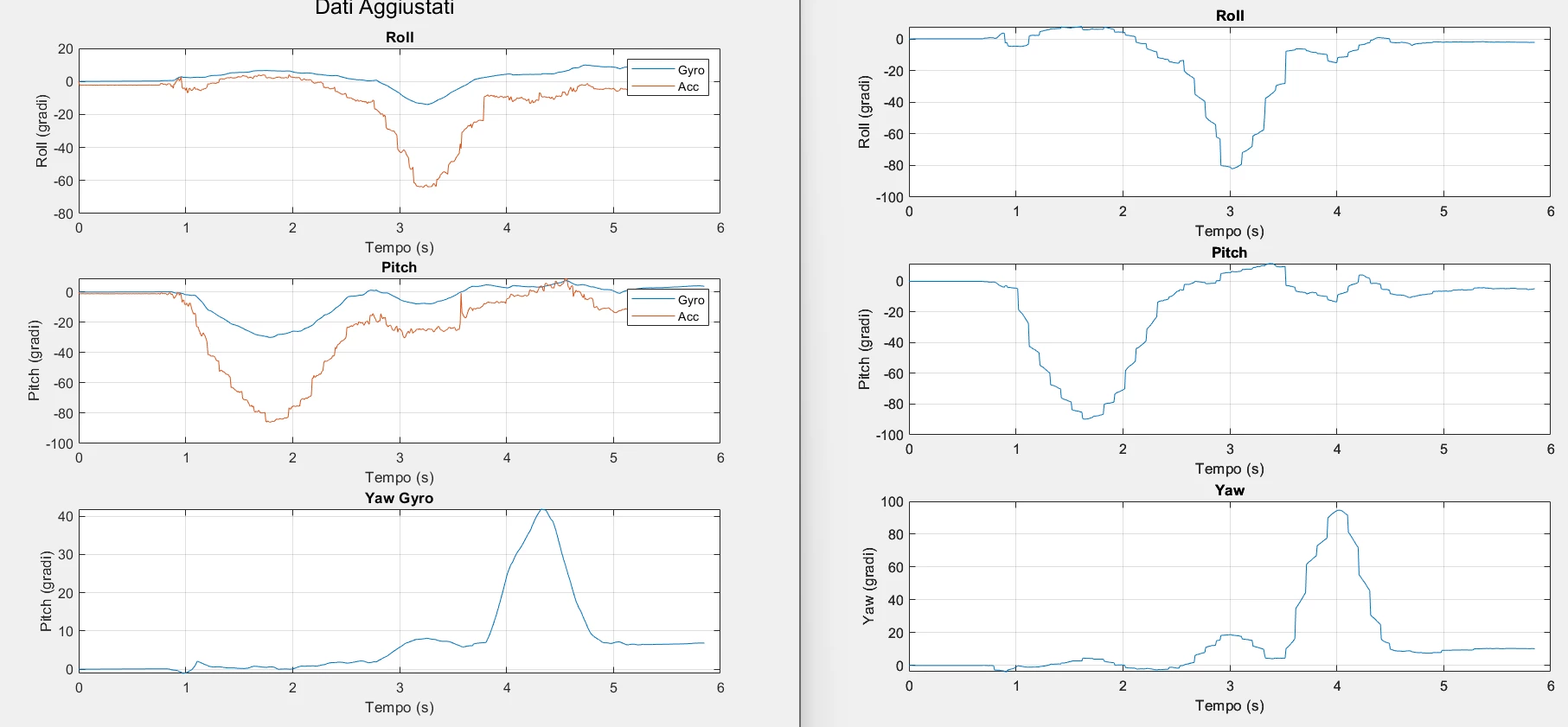

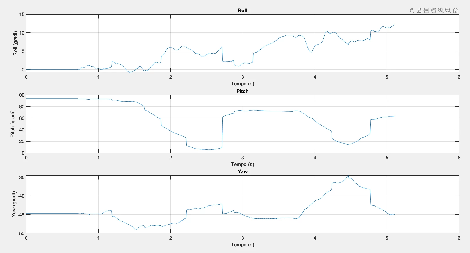

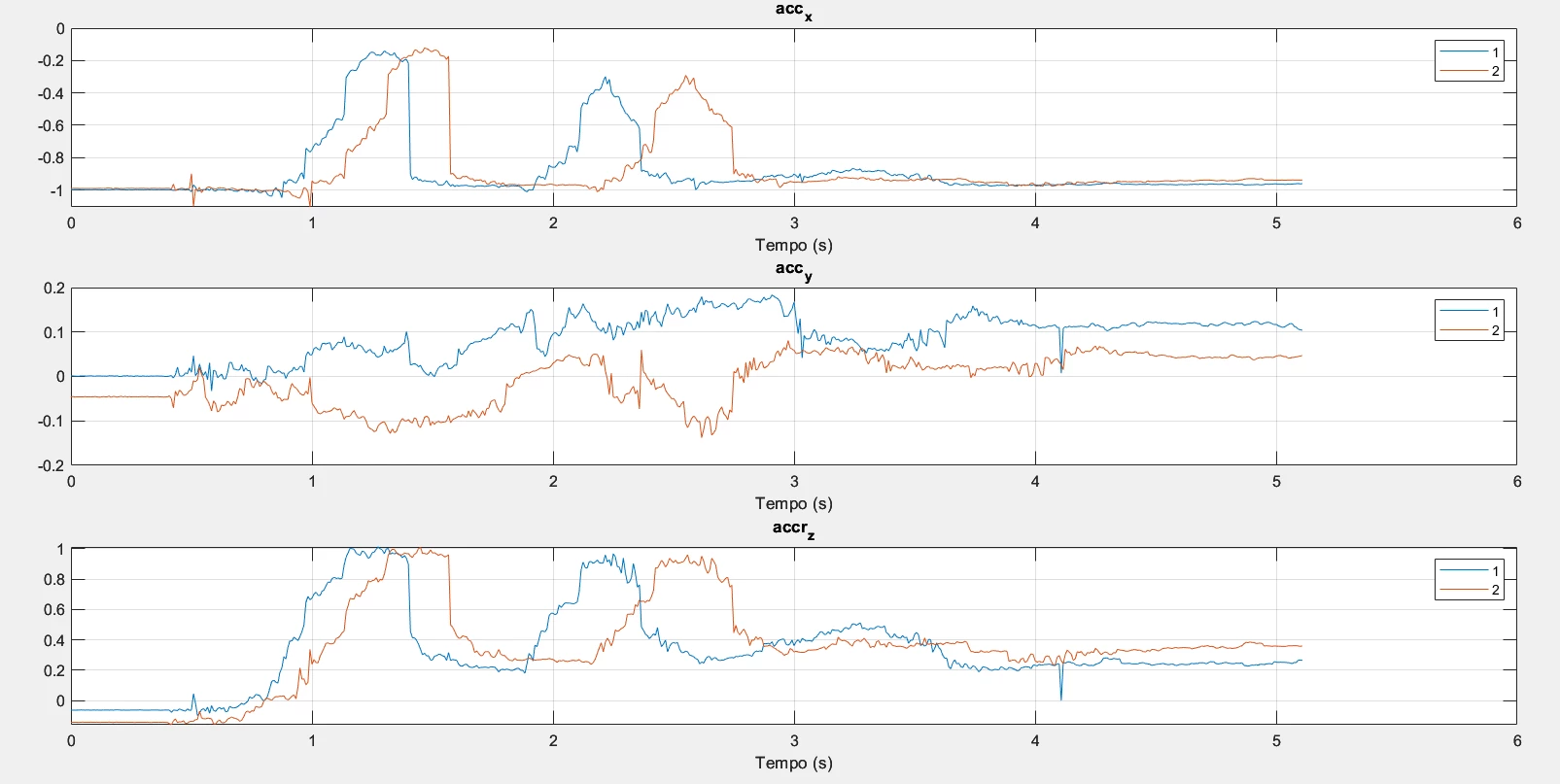

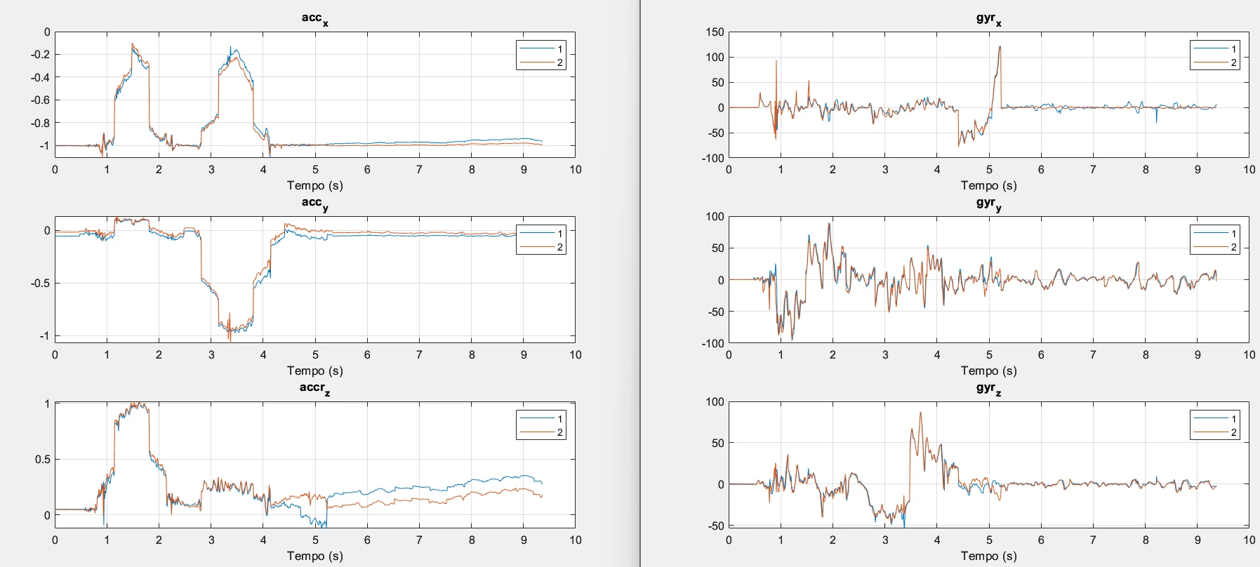

Hi @Denise SANFILIPPO , I am making a project where I use two LSM6DSV16X sensors (in particular two SparkFun Micro 6DoF IMU Breakout LSM6DSV16X (Qwiic), one with address 0x6A and one with address 0x6B) and the Nucleo F401RE board.
I am connecting the two sensors to the same I2C bus because I want simultaneous acquisition. My goal is to get the accelerometer, gyroscope and quaternions data from each of the two sensors.
I tested the two sensors individually by writing a dedicated code (I only change the address):

The problem is that the acquisition is not simultaneous, the data is very skewed and the quaternions are completely wrong. Am I doing something wrong in my code? Do you have any suggestions on how to improve the acquisition?
Dec 10, 2024 10:02 AM UTC
Hi @marti3110 ,
what do you mean with "the data is very skewed and the quaternions are completely wrong"?
Can you explain it better?
Dec 10, 2024 4:07 PM UTC
I tried the Continuous Mode and the FIFO Mode. In both cases I acquire data from two sensors performing the same movement simultaneously.
With the "Continuous Mode", for each occurrence (i.e. ACC1, ACC2, GYR1, GYR2, etc) the number of values ​​I get is different. Also, Sensor 2 data is lagging behind sensor 1 data. There is a delay in acquiring data from sensor 1 and sensor 2:
The figure shows the accelerometer data. Curve 1 indicates the data from sensor 1 and curve 2 indicates the data from sensor 2. Having performed the same movement at the same time, it is clear that there is a problem when the data is printed on the terminal.The figure shows the accelerometer data. Curve 1 indicates the data from sensor 1 and curve 2 indicates the data from sensor 2. Having performed the same movement at the same time, it is clear that there is a problem when the data is printed on the terminal.
 Also, from the quaternion I obtain the following angles whose trend is very strange and does not appear continuous:
I think the main problem is in the data management in FIFO. I don't understand why the data is not printed in order, i.e. "Game Rotation 1, Game Rotation 2, GYR1,GYR2, ACC1,ACC2" but the order changes over time (see this post Issue with Misaligned Accelerometer and Gyroscope ... - STMicroelectronics Community)

I have acquired both FIFO_WATERMARK set to 64 and 200, but the results I get are not satisfactory. Unlike "Continuous Mode", with "FIFO Mode" there is less lag between the data from the two sensors:
Watermark=200Watermark=200
Watermark=64Watermark=64
Furthermore, trying to obtain the angles from the acquired data I get the following graphs:
In the image on the left the angles are obtained by integrating the gyroscope data "gyro_angle_x = zeros(length(gyr_x),1); gyro_angle_y = zeros(length(gyr_y),1); gyro_angle_z = zeros(length(gyr_z),1); for i = 2:length(gyr_x) dt = time_s(i) - time_s(i-1); % Time interval gyro_angle_x(i) = gyro_angle_x(i-1) + gyr_x(i) * dt; % X-axis angle gyro_angle_y(i) = gyro_angle_y(i-1) + gyr_y(i) * dt; % Y-axis angle gyro_angle_z(i) = gyro_angle_z(i-1) + gyr_z(i) * dt; % Z-axis angle end " , for the accelerometer instead "acc_roll = zeros(length(acc_x),1); acc_pitch = zeros(length(acc_y),1); for i = 2:length(gyr_x) acc_roll(i) = atan2(acc_y(i), sqrt(acc_x(i)^2 + acc_z(i)^2)); acc_pitch(i)= atan2(-acc_x(i), sqrt(acc_y(i)^2 + acc_z(i)^2)); end " but the measurements differ too much (while if I acquire the data from a single sensor the results almost match). In the image on the right the angles obtained starting from the quaternions are represented and here too the trend does not appear continuous buIn the image on the left the angles are obtained by integrating the gyroscope data "gyro_angle_x = zeros(length(gyr_x),1); gyro_angle_y = zeros(length(gyr_y),1); gyro_angle_z = zeros(length(gyr_z),1); for i = 2:length(gyr_x) dt = time_s(i) - time_s(i-1); % Time interval gyro_angle_x(i) = gyro_angle_x(i-1) + gyr_x(i) * dt; % X-axis angle gyro_angle_y(i) = gyro_angle_y(i-1) + gyr_y(i) * dt; % Y-axis angle gyro_angle_z(i) = gyro_angle_z(i-1) + gyr_z(i) * dt; % Z-axis angle end " , for the accelerometer instead "acc_roll = zeros(length(acc_x),1); acc_pitch = zeros(length(acc_y),1); for i = 2:length(gyr_x) acc_roll(i) = atan2(acc_y(i), sqrt(acc_x(i)^2 + acc_z(i)^2)); acc_pitch(i)= atan2(-acc_x(i), sqrt(acc_y(i)^2 + acc_z(i)^2)); end " but the measurements differ too much (while if I acquire the data from a single sensor the results almost match). In the image on the right the angles obtained starting from the quaternions are represented and here too the trend does not appear continuous bu
So I don't know which of the two modes to use because both still have problems and I don't know how to get the best data.
Dec 10, 2024 4:20 PM UTC
What can I do to improve this situation?
Dec 12, 2024 8:11 AM UTC
Hi @marti3110,
here are some tips/comments which can help you:
- Using FIFO in FIFO mode or continuous mode does not change anything if the data is read and the FIFO does not fill up.
- Surely you could use I2C at 400 kHz instead of 100 kHz, in fact as it is now, it is super slow to do any kind of operation.
- If you want to compare the output of the fusion, why do you need the raw data? I think it depends on your specific use case, can you tell me something more?
- There are techniques to improve synchronization, however, only on raw data, not on SFLP.
