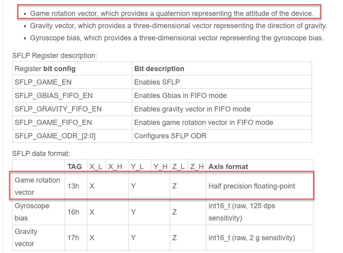

A sensor fusion low-power (SFLP) block is available in the LSM6DSV16X for generating the following data based on the accelerometer and gyroscope data processing:
  1. Game rotation vector, which provides a quaternion representing the attitude of the device.
  2. Gravity vector, which provides a three-dimensional vector representing the direction of gravity.
  3. Gyroscope bias, which provides a three-dimensional vector representing the gyroscope bias.

SFLP Register description:
Register bit config
Bit description
SFLP_GAME_EN
Enables SFLP
SFLP_GBIAS_FIFO_EN
Enables Gbias in FIFO mode
SFLP_GRAVITY_FIFO_EN
Enables gravity vector in FIFO mode
SFLP_GAME_FIFO_EN
Enables game rotation vector in FIFO mode
SFLP_GAME_ODR_[2:0]
Configures SFLP ODR

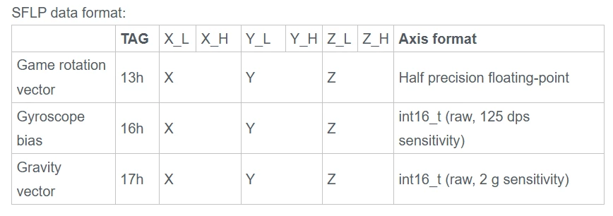

SFLP data format:
TAG
X_L
X_H
Y_L
Y_H
Z_L
Z_H
Axis format
13h
X
Y
Z
Half precision floating-point
Gyroscope bias
16h
X
Y
Z
int16_t (raw, 125 dps sensitivity)
Gravity vector
17h
X
Y
Z
int16_t (raw, 2 g sensitivity)

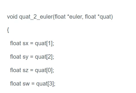

Hi @Stefan3,
Here below you can find an example based on quaternions read by the IMU. The IMU is oriented according to ENU frame.
The formula below can be used to convert the quaternions to Euler angles.
void quat_2_euler(float *euler, float *quat)
  float sx = quat[1];
  float sy = quat[2];
  float sz = quat[0];
  float sw = quat[3];
  if (sw < 0.0f) {
    sx *= -1.0f;
    sy *= -1.0f;
    sz *= -1.0f;
    sw *= -1.0f;
  float sqx = sx * sx;
  float sqy = sy * sy;
  float sqz = sz * sz;
  euler[0] = -atan2f(2.0f * (sy * sw + sx * sz), 1.0f - 2.0f * (sqy + sqx));
  euler[1] = -atan2f(2.0f * (sx * sy + sz * sw), 1.0f - 2.0f * (sqx + sqz));
  euler[2] = -asinf(2.0f * (sx * sw - sy * sz));
  if (euler[0] < 0.0f)
    euler[0] += 2.0f * M_PI;
  for (uint8_t i = 0; i < 3; i++) {
    euler[i] = RAD2DEG(euler[i]);
If you have further doubts, you can also ask them inside the Product Forum of MEMS sensors.

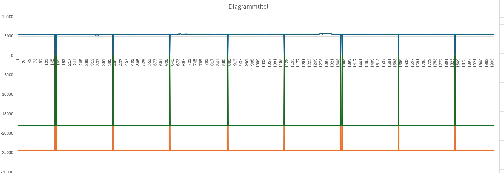

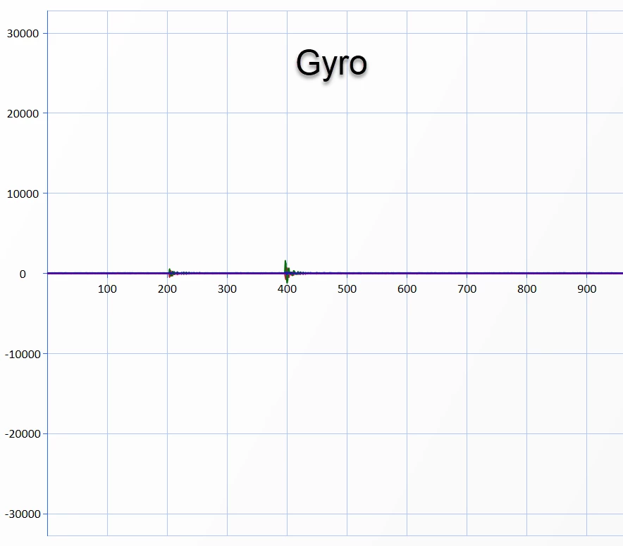

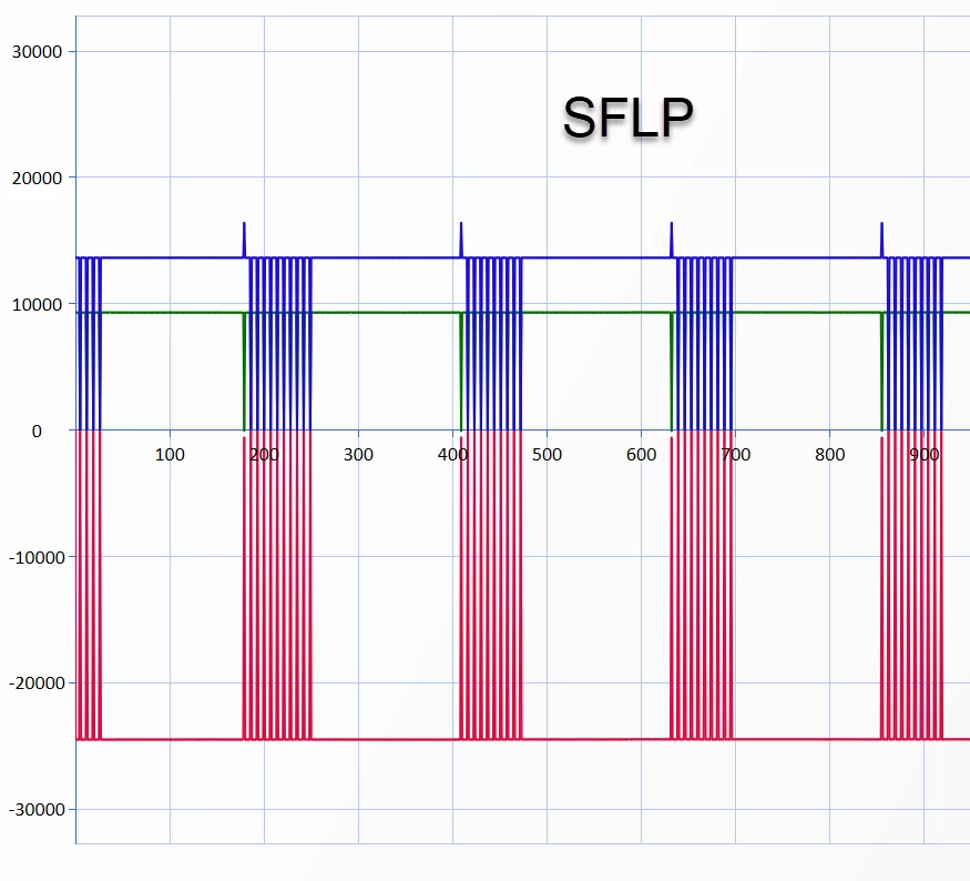

Nov 15, 2024 5:08 PM UTC
Hi Denis
It now works from configuring the LSM6, reading from FIFO, sending to USB and receiving in the App.
Also the conversion from FP16 to FB32 and the calculation of pitch, yaw, roll and each in grad degres is perfect.
A small problem is still, regular spikes in the data.
In decimal the values are about 20-40 und if I convert to FP32 it's looks like a very small number or somtimes very high number
I suppose I read a counter or something similar instead of the quaternion.
Nov 21, 2024 9:31 AM UTC
Hi @Stefan3 ,
In general, you must read from the FIFO (e.g., a set of 7 bytes) and interpret the contents of the data section according to the tag, as you did.

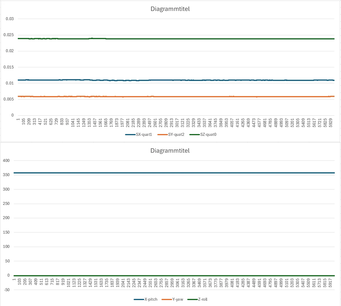

Nov 21, 2024 10:15 AM UTC
Hi Denis
Ok before I had only read 1 byte and if that was correct then I have read the 6 others.
With your suggestion to read 7 at once and then when the tag is right I use it, it works very well and also faster.
I can read and transmit at 15Hz, 30Hz, 60Hz, 120Hz, 240Hz, 480Hz without any problems.
The old chart shows Pitch, Yaw, Roll in Grad degrees.
Here a new chart with both, the convertet Float32 value (top) and the chart with the Pitch, Yaw, Roll (bottom). The x (pitch) is 358 grad. It changes the value when I turn, but I suspect not in the right range
Nov 21, 2024 11:05 AM UTC
Hi @Stefan3
a possible error in your code could be an incorrect convention used inside the function called “quat_2_euler”.
My suggestion is to convert the quaternion in such a way it is in the format [x, y, z, w], then you should pass it to the function void quat_2_euler(float *euler, float *quat) without applying any swap of the axes.
So the input of the quat_2_euler function must be quaternion (quat) in the format [x, y, z, w], while the output are the Euler angles in the format [yaw, pitch, roll] in deg. The convention of the Euler angles are that for Android.
