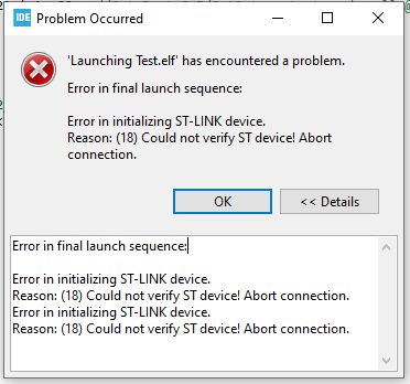

I'm having an issue using STM32CubeIDE to program my blue pill boards. I get the below error each time.
Error in final launch sequence:
Error in initializing ST-LINK device.
Reason: (18) Could not verify ST device! Abort connection.
The strange thing is I have no issue programming my boards using ST-Link Utility. I thought that maybe the chips on my boards were counterfeit but I've tried boards from multiple venders now.
I've looked around online and while I found some people getting the "Error in initializing ST-LINK device." message I haven't seen anyone getting "Reason: (18)".
Any help would be appreciated.

Ok, I solved it so I figured I'd update in case anyone comes across this thread in the future. It was 100% due to there being a counterfeit chip on my blue pill board. I bought some chips from DigiKey and used a hot air rework station to swap them out. I no longer get the error message I was seeing.
Beware of venders with counterfeit chips!

I'm pretty sure, man. Error 18 has to due with not being able to verify the MCU. Then once I put a new, known good, MCU on the board everything programmed as expected. Lots of blue pills has counterfeit MCUs on them. That's why they are so cheap.

I could always program using St-Link Utility. I've read that the St-Link Utility doesn't check for valid MCUs before programming but that STM32CubeIDE does check. I wanted it to work with the IDE so I could use debugging.

Yes, hate the blue pill with clone MCU on it. In my case I have a CKS32F103… instead of STM32F103…
However, if you do end up with one, there is a way to get it working with OpenOCD. >>
1.   Use OpenOCD as your debugger (GDB will not work)
2.   Find the config file : stm32f1x.cfg
Location is similar to this : >>
C:\ST\STM32CubeIDE_1.3.0\STM32CubeIDE\plugins\com.st.stm32cube.ide.mcu.debug.openocd_1.3.0.202002181050\resources\openocd\st_scripts\target
3.   Add the following near the top of stm32f1x.cfg (before the first If – statement):
set CPUTAPID 0
The zero tells OpenOCD to ignore id numbers, which means all clones or genuine MCUs will work.
4.     Save the changes. Now your flash and debug should work.
