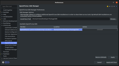

Is there any way of changing it and still be able to use built in build options.
I use the the `environment-setup-cortexa7t2hf-neon-vfpv4-ostl-linux-gnueabi` script to set the environment to run menuconfig. I was hoping that it will generate the config suitable for STM32CubeIDE to build the kernel.
What I am doing wrong?
Kind regards
Piotr Jankowski
