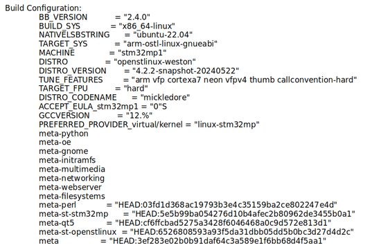

Build Configuration:
BB_VERSION = "2.4.0"
BUILD_SYS = "x86_64-linux"
NATIVELSBSTRING = "ubuntu-22.04"
TARGET_SYS = "arm-ostl-linux-gnueabi"
MACHINE = "stm32mp1"
DISTRO = "openstlinux-weston"
DISTRO_VERSION = "4.2.2-snapshot-20240522"
TUNE_FEATURES = "arm vfp cortexa7 neon vfpv4 thumb callconvention-hard"
TARGET_FPU = "hard"
DISTRO_CODENAME = "mickledore"
ACCEPT_EULA_stm32mp1 = "0"S
GCCVERSION = "12.%"
PREFERRED_PROVIDER_virtual/kernel = "linux-stm32mp"
meta-python
meta-oe
meta-gnome
meta-initramfs
meta-multimedia
meta-networking
meta-webserver
meta-filesystems
meta-perl = "HEAD:03fd1d368ac19793b3e4c35159ba2ce802247e4d"
meta-st-stm32mp = "HEAD:5e5b99ba054276d10b4afec2b80962de3455b0a1"
meta-qt5 = "HEAD:cf6ffcbad5275a3428f6046468a0c9d572e813d1"
meta-st-openstlinux = "HEAD:6526808593a93f5da31dbb05dd5b0bc3d27d4d2c"
meta = "HEAD:3ef283e02b0b91daf64c3a589e1f6bb68d4f5aa1"
I have tried many times to build the image, but I can't. I get some errors while building (generated log file, see attached file):
ERROR: rust-native-1.68.2-r0 do_install: ExecutionError('/home/alazaj/STM32MPU_workspace/STM32MP1-Ecosystem-v5.0.0/Distribution-Package/build-openstlinuxweston-stm32mp1/tmp-glibc/work/x86_64-linux/rust-

I've tried various ways, with and without accepting the EULA, but I couldn't get rid of this issue. Is this a known issue?
Best regards,
Arjan
2024-05-24 3:08 AM - edited 2024-05-24 7:11 AM
[UPDATE]
After looking at the log file again, I was finally able to see the reason why rust-native failed.
warning: gcc: fatal error: cannot execute 'cc1plus': execvp: No such file or directory
warning: compilation terminated.
It would be better if thouse lines started with an error.
Anyway, I had several gcc compilers installed on my system. I simply removed some of them and ran
bitbake -c cleanall rust-native
bitbake rust-native
After that I was able to get rid of the errors. I will now build the st-example-image-qtwayland image and see if I can run the PyQt5 application.
[update]
Thank you Philippe for your help. I am now able to run the pyqt5 application. It is important not to accept the EULA when building the image because we cannot start the application if the EULA is accepted.
Best regards,
Arjan
