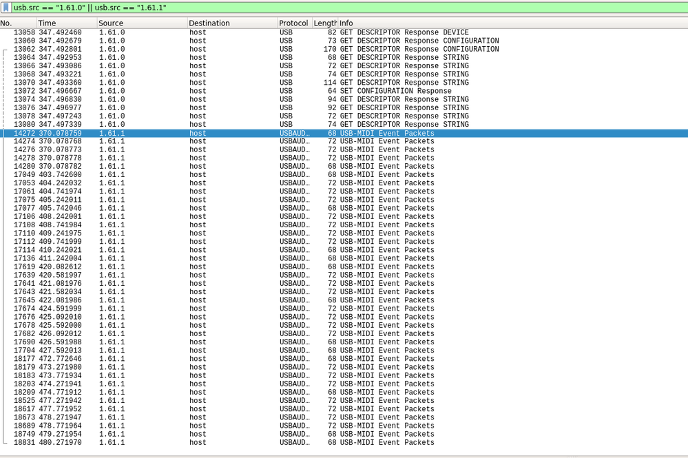

The issue is that every few minutes the host stops sending and receiving messages. I tried multiple cables and hosts and the result is that midi data will stop arriving to the host and the MP1 in the same time, after a couple of minutes. If I reset the usb cable or stop and start the usb gadget data will flow again for a similar period of time.
In order to debug this issue I used usbmon on the MP1 and wireshark on a host Mac. On the host mac I could see that when the driver freezes it receives a URB with an unknown request and then a URB with an abort request. After these two messages no midi messages can go in or out but the device is still seen as a connected usb-midi device on the host.
Trying to understand why this happens I looked at f_midi.c. There I could see that an abort URB is send when hardware forces ep reset.
/* this endpoint is normally active while we're configured */
	case -ECONNABORTED:	/* hardware forced ep reset */
	case -ECONNRESET:	/* request dequeued */
	case -ESHUTDOWN:	/* disconnect from host */
At this point I am looking for ways to debug why the hardware forces ep reset and when but I can not find a way to debug this. Any ideas or points will be highly appreciated.

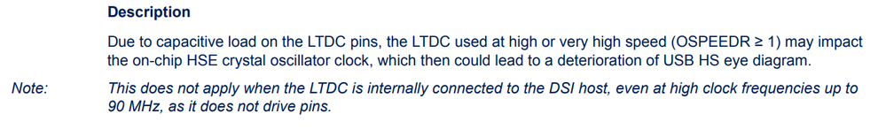

Regarding the investigation of your case, the experts showed me this errata:
https://www.st.com/resource/en/errata_sheet/es0438-stm32mp151x3x7x-device-errata-stmicroelectronics.pdf
Chapter 2.3.3
For testing purpose only, we will set your default MPU Frequency to 650MHz instead of 800Mhz and your VDD_CORE to 1.2V instead of 1.5V.
For doing that, please edit your file "stm32mp15xd.dtsi" (I know it's a dtsi file) in TF-A/ U-Boot / Linux and change the &cpu0_opp_table to:

Then I moved to the second suggestion. The note in the errata looked to match the issue. I builded a new image based on
this wiki. After applying the patches in every step
for p in $(ls -1 ../../sources/arm-ostl-linux-gnueabi/linux-stm32mp-*/*.patch); do patch -p1 < $p; done
I modified the equivalent "stm32mp15xd.dtsi" as per your suggestion. I did this for steps 5 and 6 of the wiki which included linux / tfa / u-boot. Then I flashed the new FIP_artifacts with Cube Programmer. My boot log looked very similar to yours and after boot I verified the new CPU clock as below.
0693W00000KbBZzQAN.pngThen I executed the usb-gadget script and tested. The communication was uninterrupted for almost two hours. After this I decided to test its behaviour with an HDMI connected. I plugged the HDMI and within 5 minutes the connection dropped with an unknown URB request. I run several tests (ex booting with the HDMI connected, connecting the devices in different orders, running the script on boot etc) but the behaviour is always the same, if the HDMI is connected the USB communication will drop within a short amount of time. Based on this observation I am thinking that although the note on the errata (a deterioration of the usb hs eye diagram) would match the issue it does not explain how the HDMI can affect usb communication.
In the meanwhile I implemented the alternative solution by using a teensy and sending serial from the M4 to the teensy and then to usb-midi and hardware midi. This is working fine for testing purposes. If the issue is related with AP10 or a hardware conflict I can use this solution until I design a custom board. If there is any way to verify this would be great as I can move forward with the development for now. Please let me know if you have any ideas or suggestions based on that.

Hello @KChar.1​ ,
Well I think I have something very close to your setup right now. Find below my Wireshark packet when we can identify USB packet when I plug to the USB-midi gadget, and then the MIDI packets that pass through when I want to play my midi piano file.
0693W00000Lx6zqQAB.pngOn board side, I plugged an HDMI monitor, quite standard, to make some HDMI activity. Should it be enough to replicate ? Do you need to have some screen activity to make it crash ?
Rgs.
Erwan
Hi @Erwan SZYMANSKI​ ,
The wireshark screenshot looks identical to mine. On my setup I use the weston extended image for DK1. The only screen activity is the desktop background and a weston terminal.
Thanks again for looking into this and for your support.
