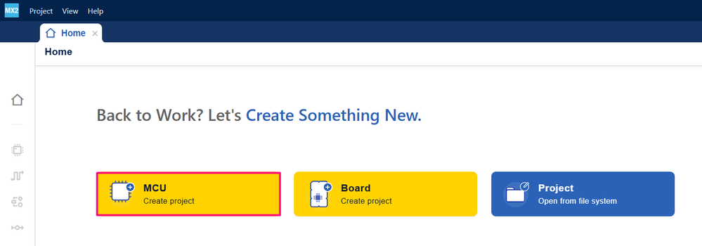

Open STM32CubeMX2. On the "Home" page, click the [MCU square] to create a new project.

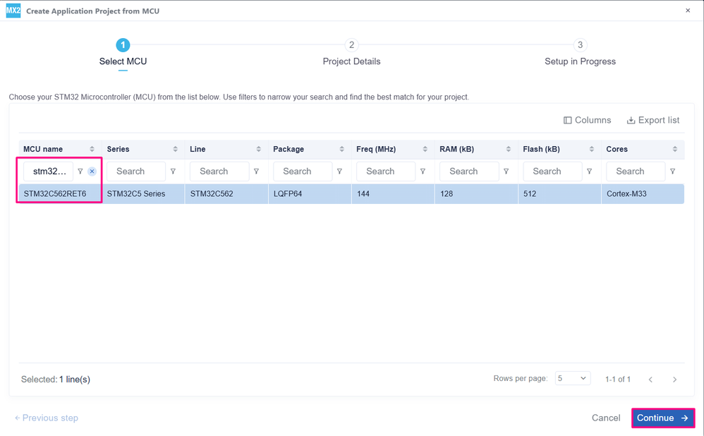

In the search field under MCU name, enter STM32C562RE and select the MCU. Click [Continue].

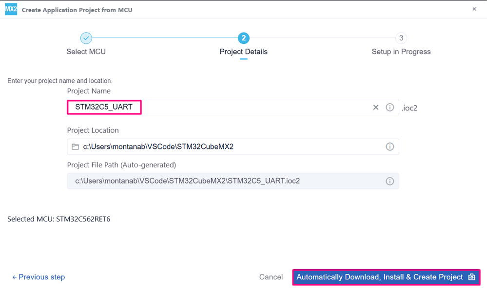

Enter the project name and location. Click [Automatically Download, Install & Create Project] to finish project creation.

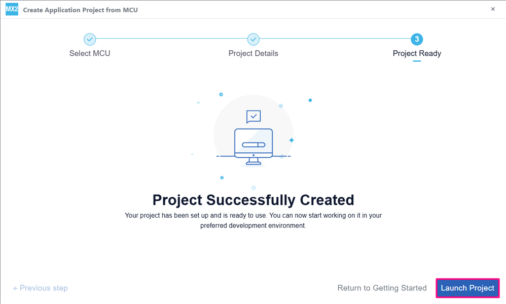

Select [Launch Project] to start.

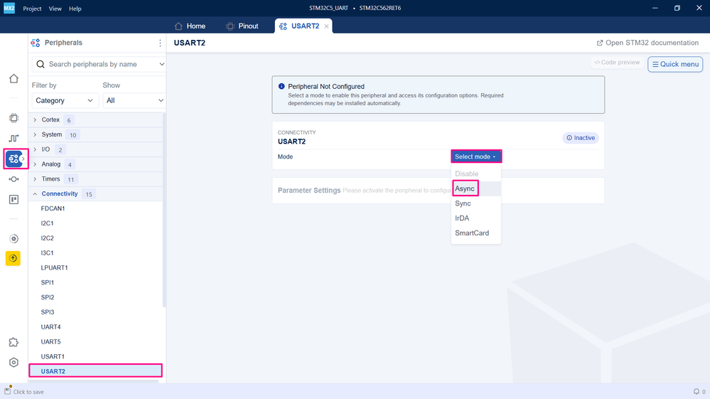

1.2 Pinout and configuration

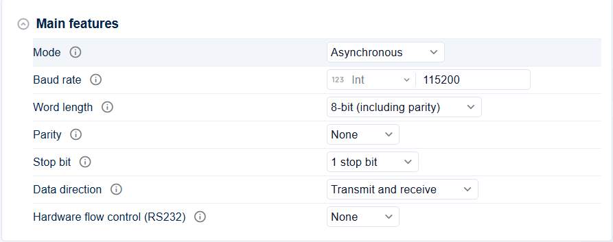

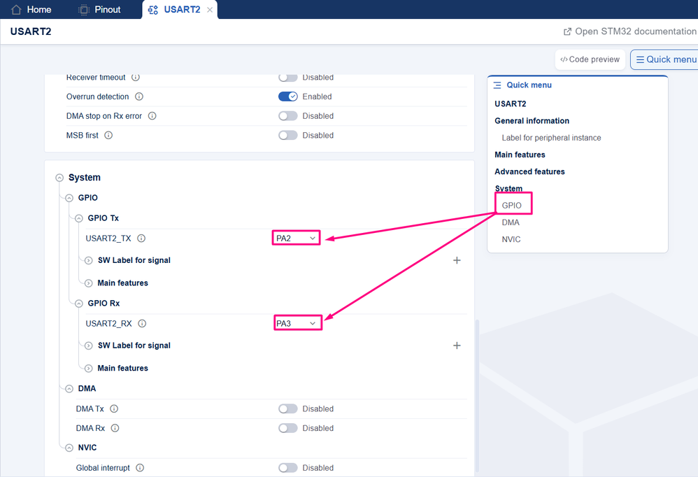

In STM32CubeMX2, go to the [Peripherals] section, then click [Connectivity]. Enable the UART by selecting the Async mode.
Configure the USART2 peripheral as shown in the figure:
The VCOM bridge available on the NUCLEO board uses USART2_TX and USART2_RX associated with PA2 and PA3, but these might not be the default pins selected. To change the GPIOs used, scroll down and change the GPIO Tx/Rx pins.

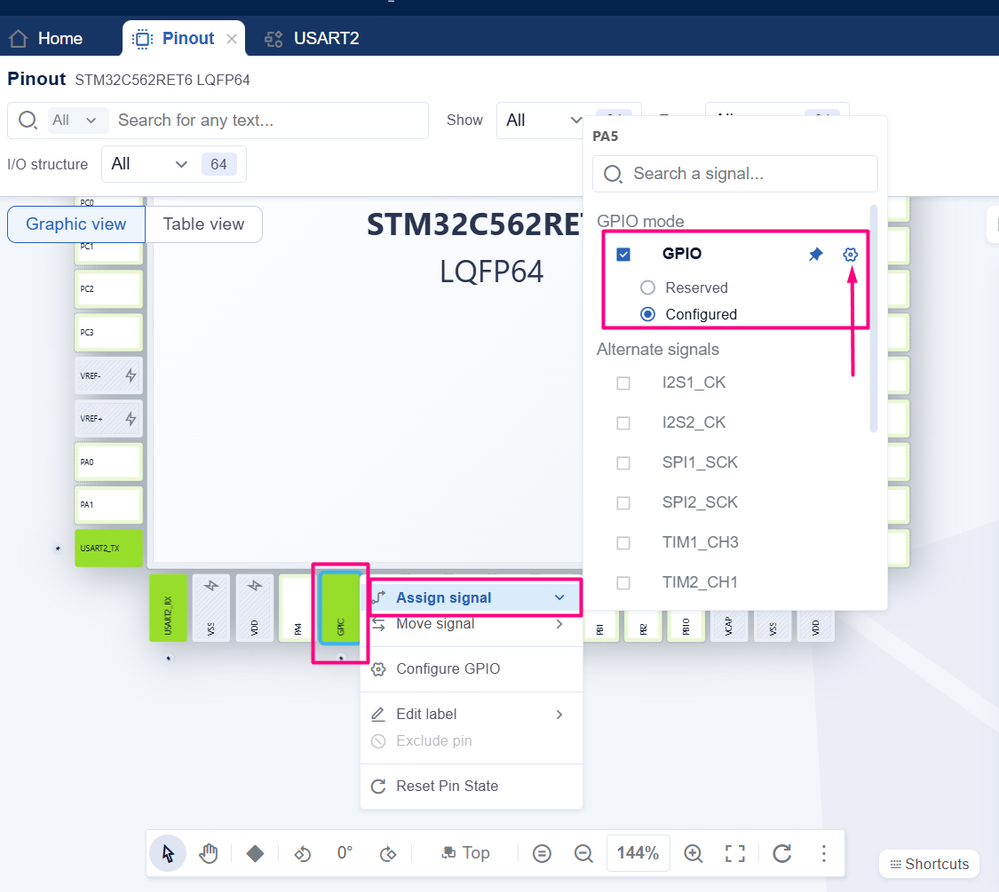

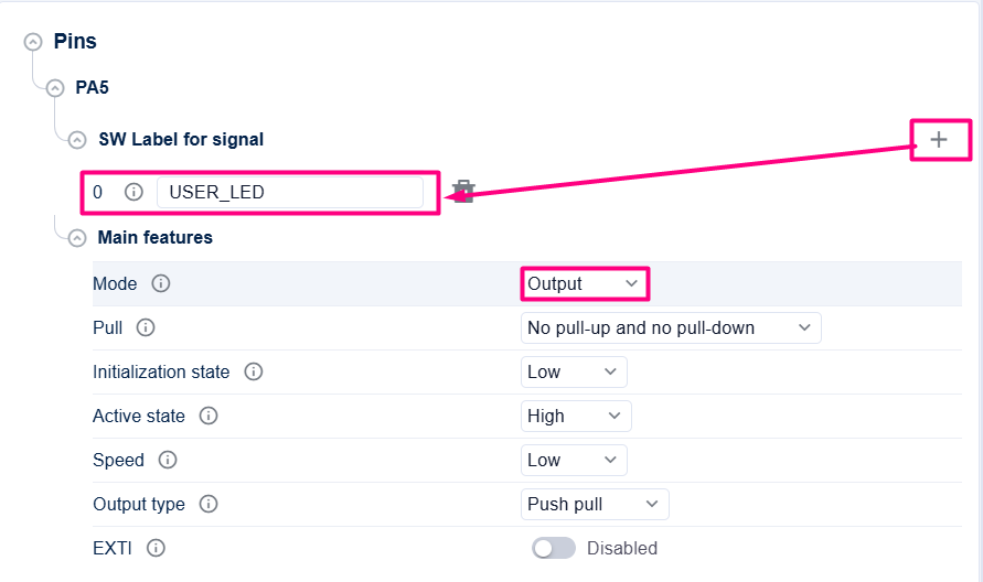

Change to the "Pinout" tab, and add the USER LED. Right-click on PA5, set it as a GPIO pin, then click the Engine icon.
The GPIO configuration tab appears. Configure the GPIO label as USER_LED and set the pin as Output Push Pull.

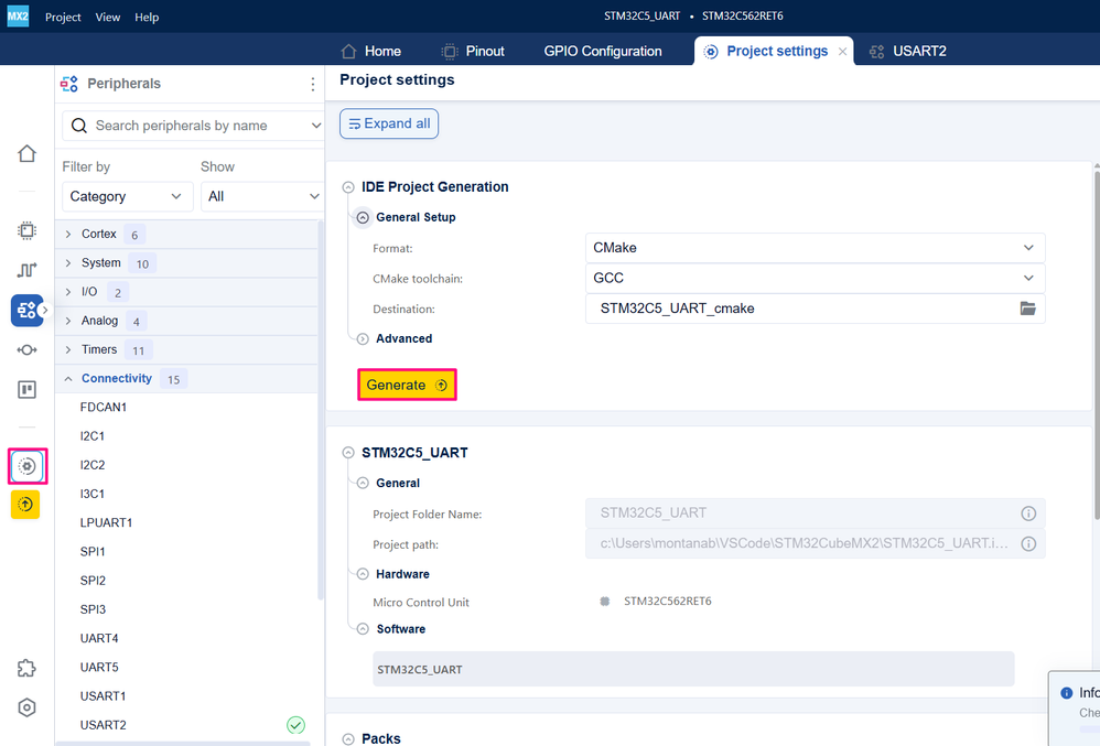

To generate the code:
  1. Click the [Project settings] icon and select the desired IDE.
  2. Click the [Generate] button.

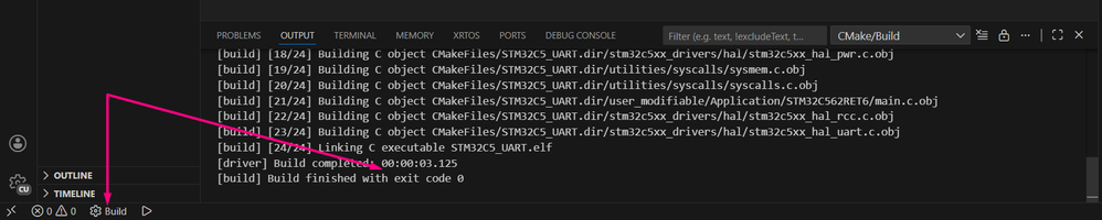

If prompted, select the configuration. If not prompted, press Ctrl+Shift+P, type CMake: Select Configure Preset, and choose the debug configuration.
Build the project to ensure everything is set, then proceed to code implementation.

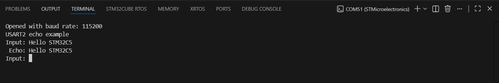

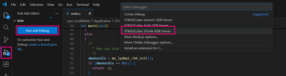

After building the application, select the [Run and Debug] icon. Create a debug session by selecting the STM32Cube: STLINK GDB Server option.
Press Ctrl+Shift+P and type [Open Serial] > COMXY (STMicroelectronics) > 115200.BMontanari_14-1769790160939.png

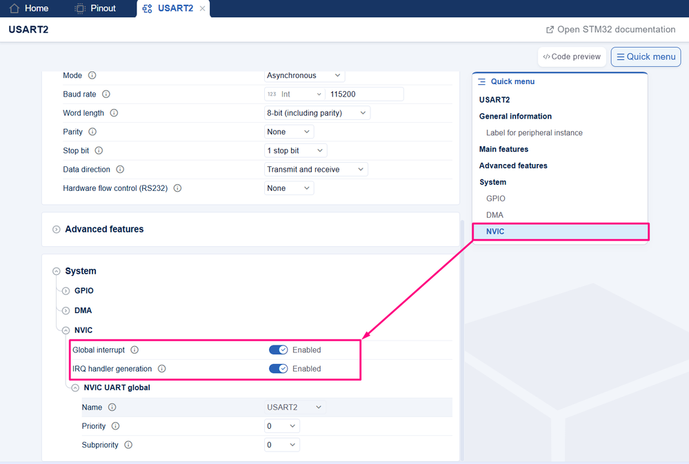

3. Using UART Interrupt
This firmware replaces getchar and implements a responsive echo system using hardware interrupts, allowing the main processor to remain idle when no data is being processed. After initializing the system and printing a welcome message, the code enters an empty infinite loop. Communication is event-driven: whenever a character arrives, the hardware triggers a callback function that echoes the received character back to the terminal and adds a newline character if the Enter key is detected. Before finishing, it reactivates the interrupt listener.
Go to the "USART2" tab in STM32CubeMX2 and scroll down to the "System" option or click [NVIC] in the Quick menu.
Regenerate your project.

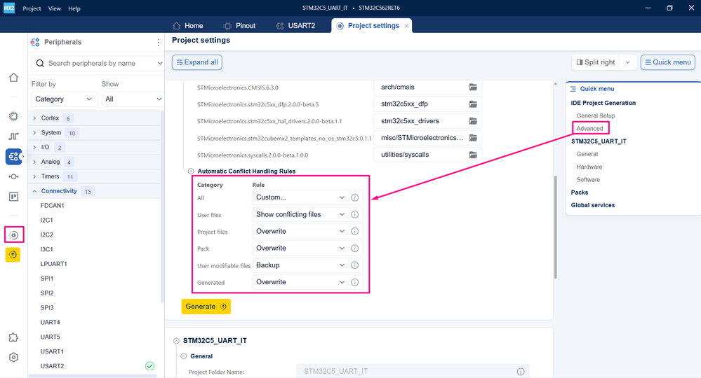

Pro-tip: You can use the advanced settings to specify how to re-generate your project. For example, it is possible to create a backup of the previous example.
Here is the entire main.c for the interrupt example.

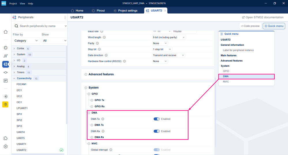

4. Using UART DMA
This firmware replaces the interrupts previously used and implements a DMA transfer of predefined content and waits for blocks of 10 bytes to trigger the receive callback, allowing the main processor to remain idle when no data is being processed.

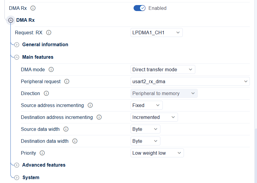

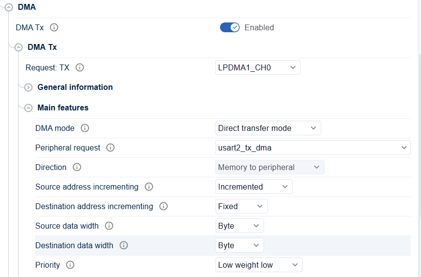

Go to the USART2 tab in STM32CubeMX2 and scroll down to the [System] option or click DMA in the Quick menu.
Enable DMA Tx and Rx and open their drop-down menus.
Regenerate your project and open it in your desired IDE.
This firmware sets up STM32 to handle UART communication asynchronously using DMA, allowing the processor to multitask. Upon startup, the system immediately activates the receiver to listen for incoming data in the background.
The main execution loop transmits the ASCII string "ABCDEFGHIJ" once every 10 seconds. When the system receives exactly 10 bytes, it triggers a callback function. This function automatically re-enables the receiver, ensuring the board is ready to capture the next chunk of data without interrupting the periodic transmission.
