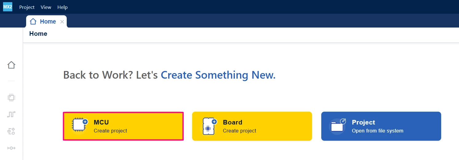

Open STM32CubeMX2. On the "Home" page, click the [MCU square] to create a new project

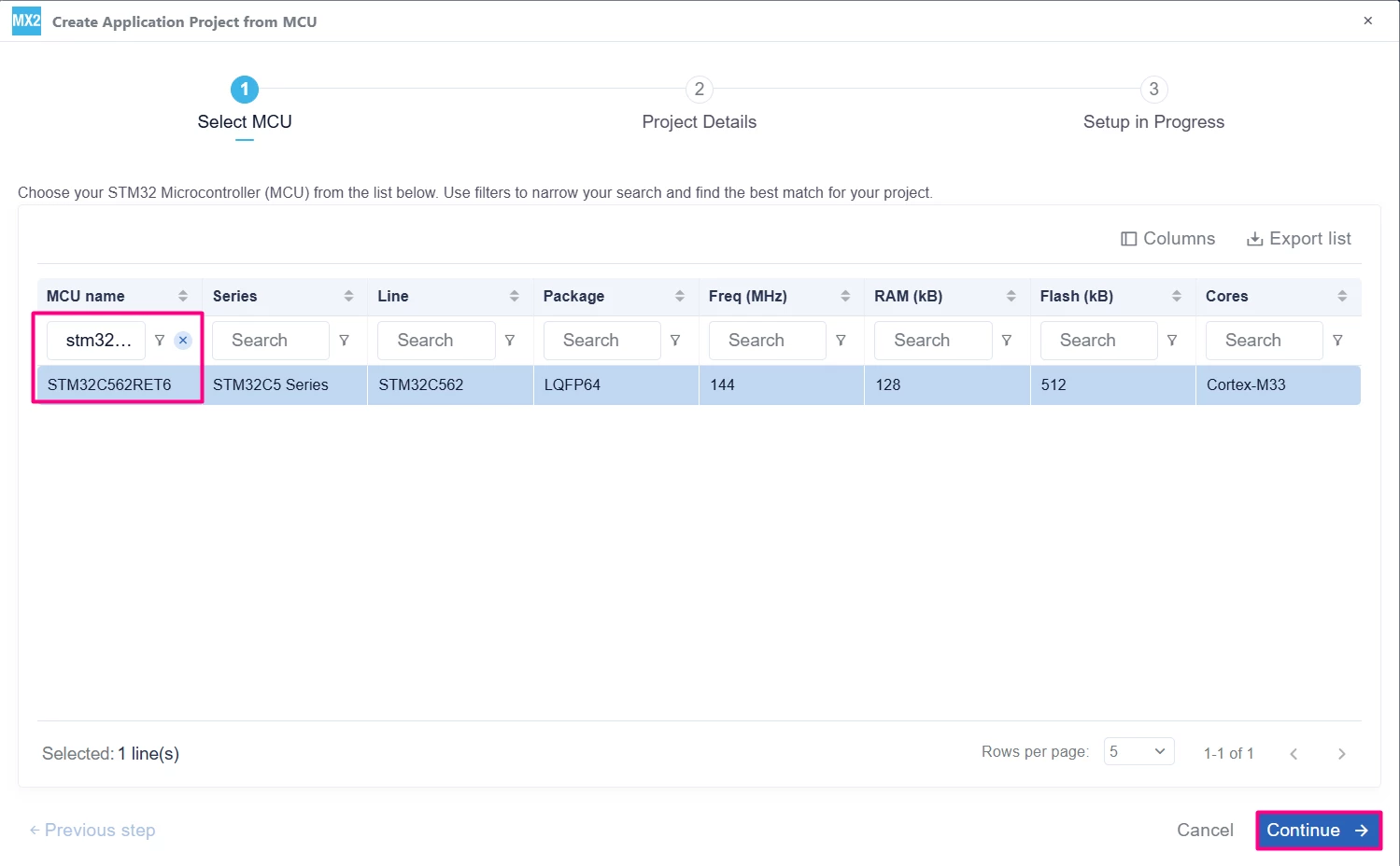

In the search field under MCU name, enter STM32C562RE and select the MCU. Click [Continue].

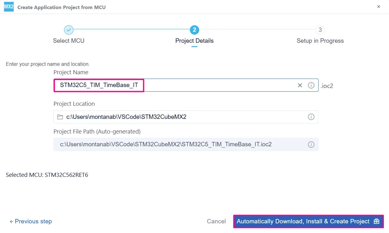

Enter the project name and location. Click [Automatically Download, Install & Create Project] to finish project creation.

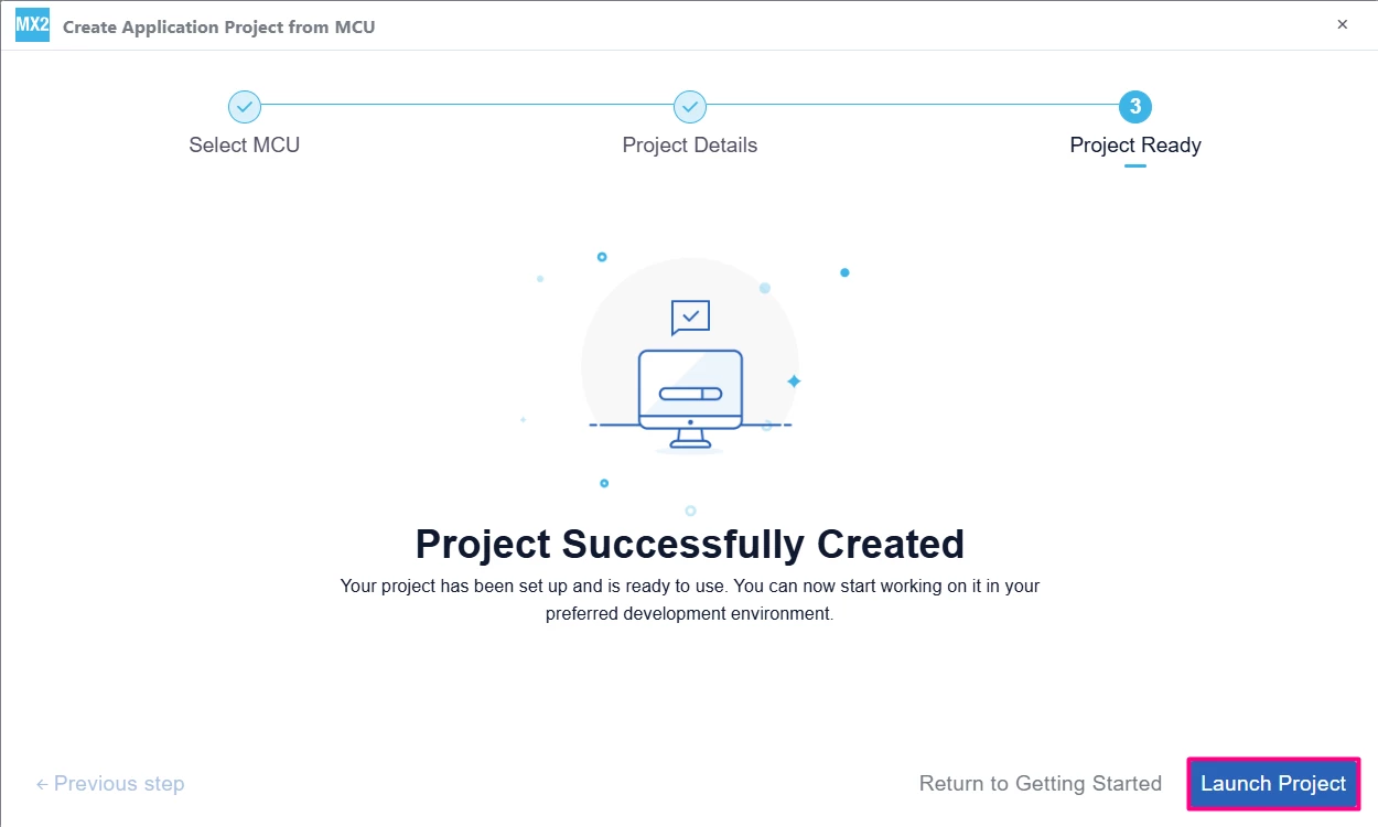

Select [Launch Project] to start.

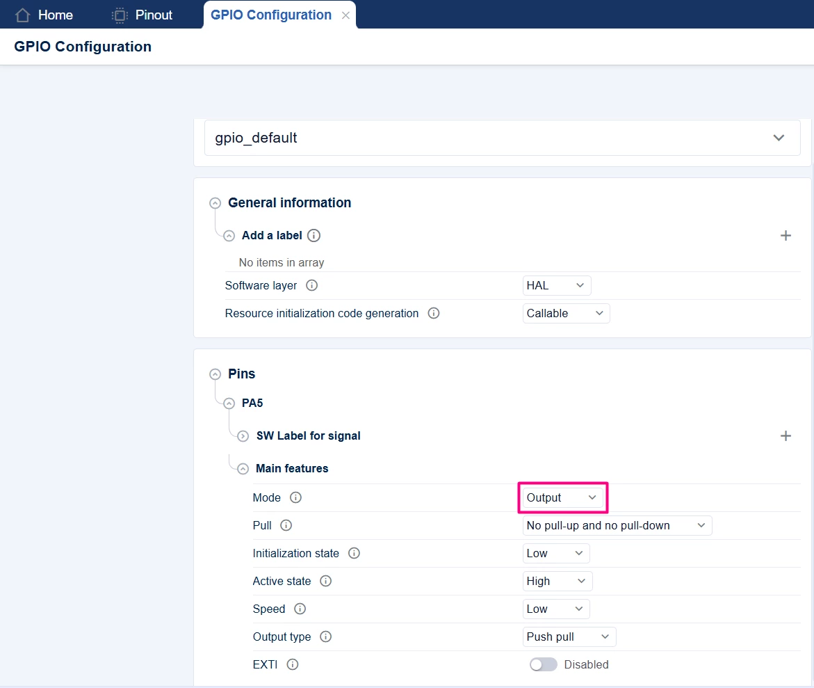

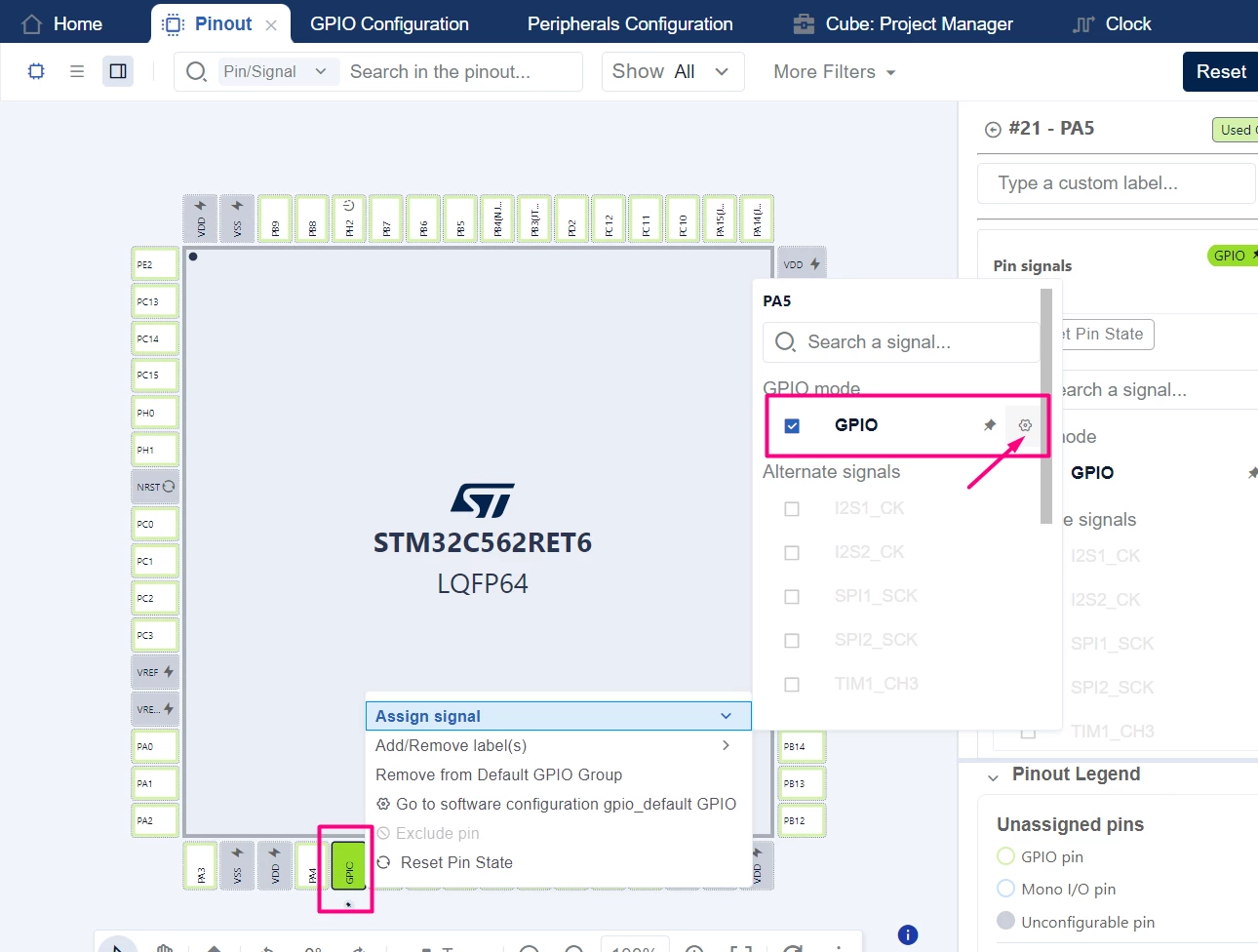

Configure the green LED, available on PA5.

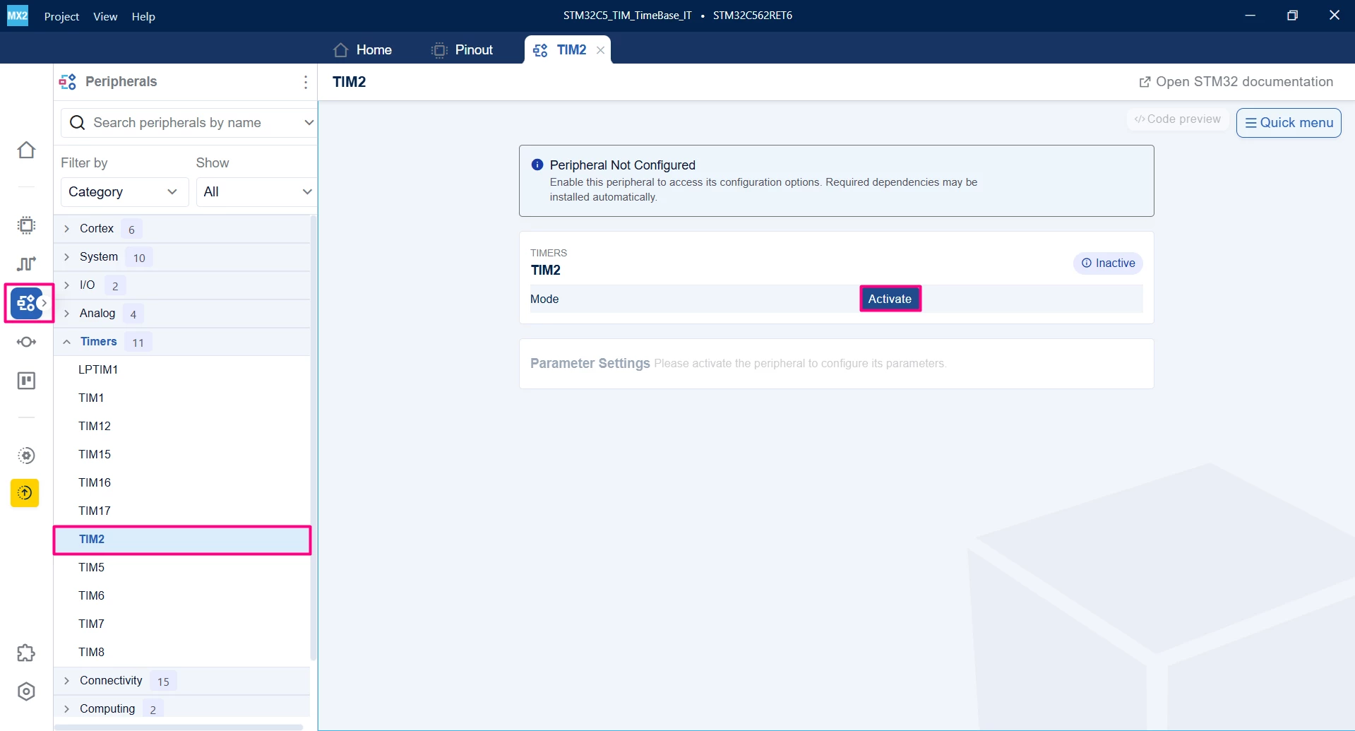

BMontanari_5-1769798930072.pngNavigate to the "Peripherals"section, then "Timers". Enable a general-purpose timer, for example, TIM2, and configure the timer mode for simple time base.

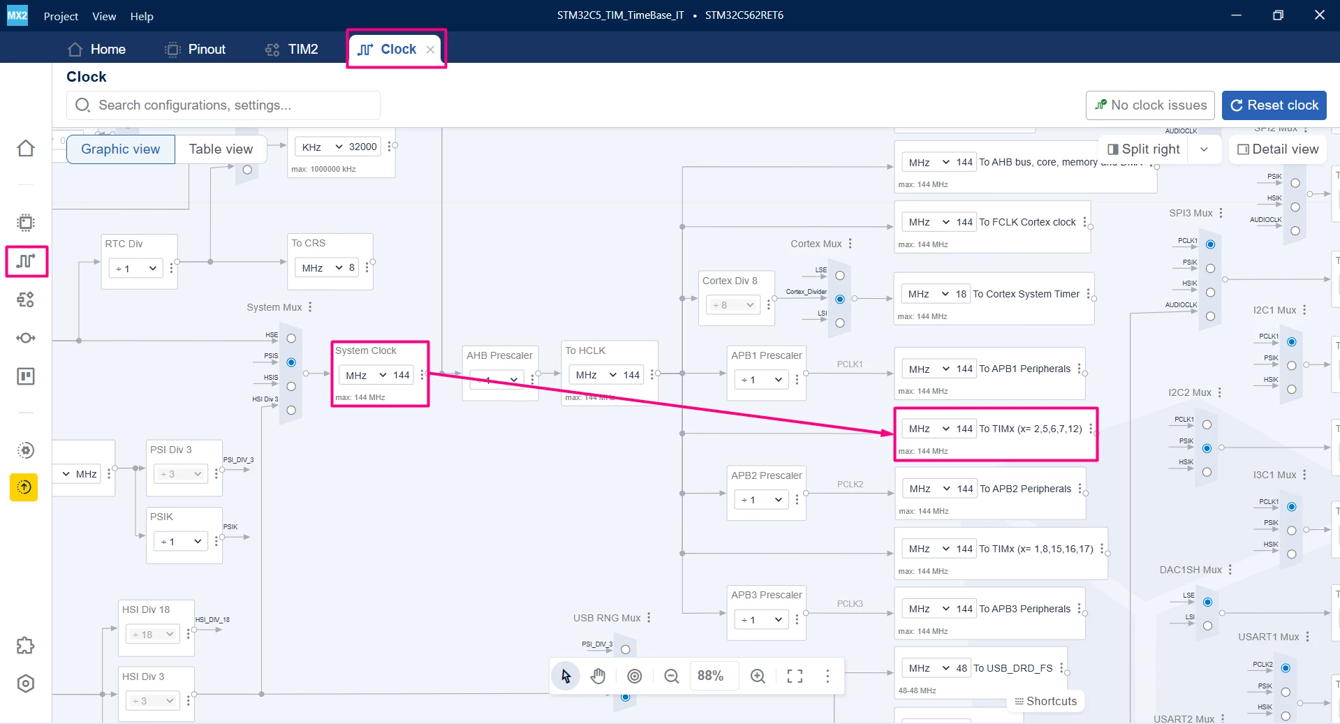

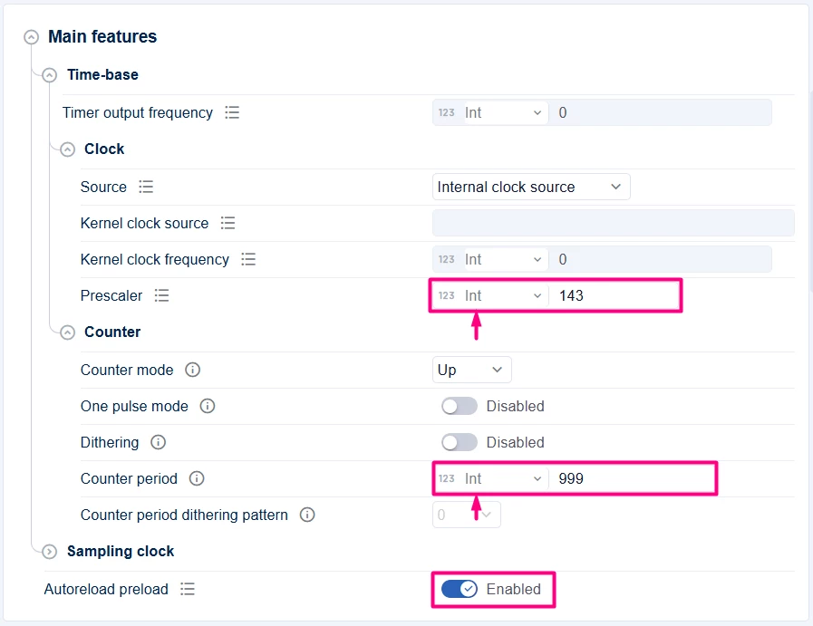

BMontanari_6-1769798930076.pngBefore setting the prescaler and counter period to define the timer frequency and period, configure the clock settings. Click the [Clock] icon and adjust the frequency as needed. For example, set the clock to its maximum of 144 MHz.
BMontanari_7-1769798930083.pngReturn to TIM and configure the prescaler to achieve a 1 ms time base. Use the standard formula:
Frequency = f_clk / [(PSC + 1) × (ARR + 1)]
Example calculation:
  • Step 1 (Prescaler): 143 + 1 = 144
  • Step 2 (Period): 999 + 1 = 1,000
  • Step 3 (Total Divisor): 144 × 1,000 = 144,000
  • Step 4 (Final Result): 144,000,000 / 144,000 = 1,000 Hz (1 kHz)

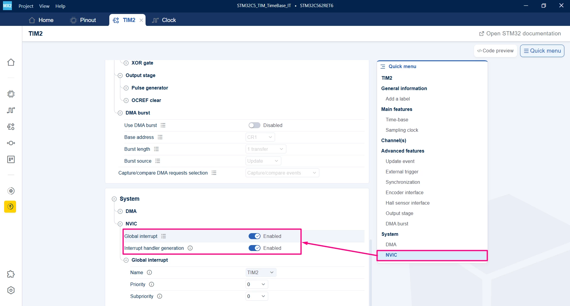

BMontanari_8-1769798930085.png Use the Quick menu to find the NVIC settings. Enable update interrupt to trigger an interrupt on timer overflow.

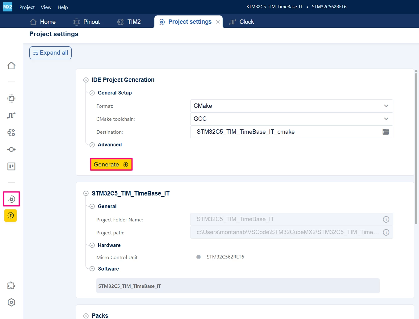

To generate the code:
  1. Click on the [Project settings] icon and select the desired IDE.
  2. Click the Generate button.

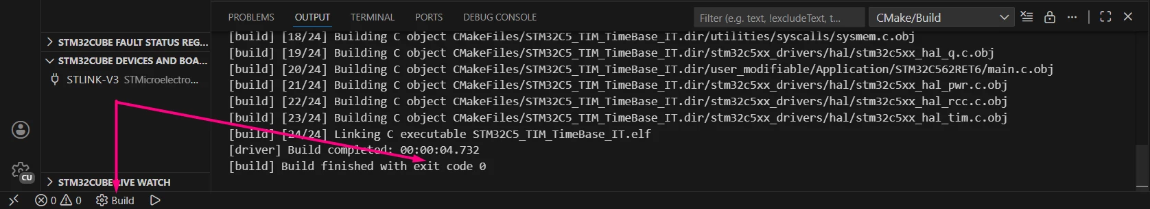

Build the project to ensure everything is set, then proceed to code implementation.

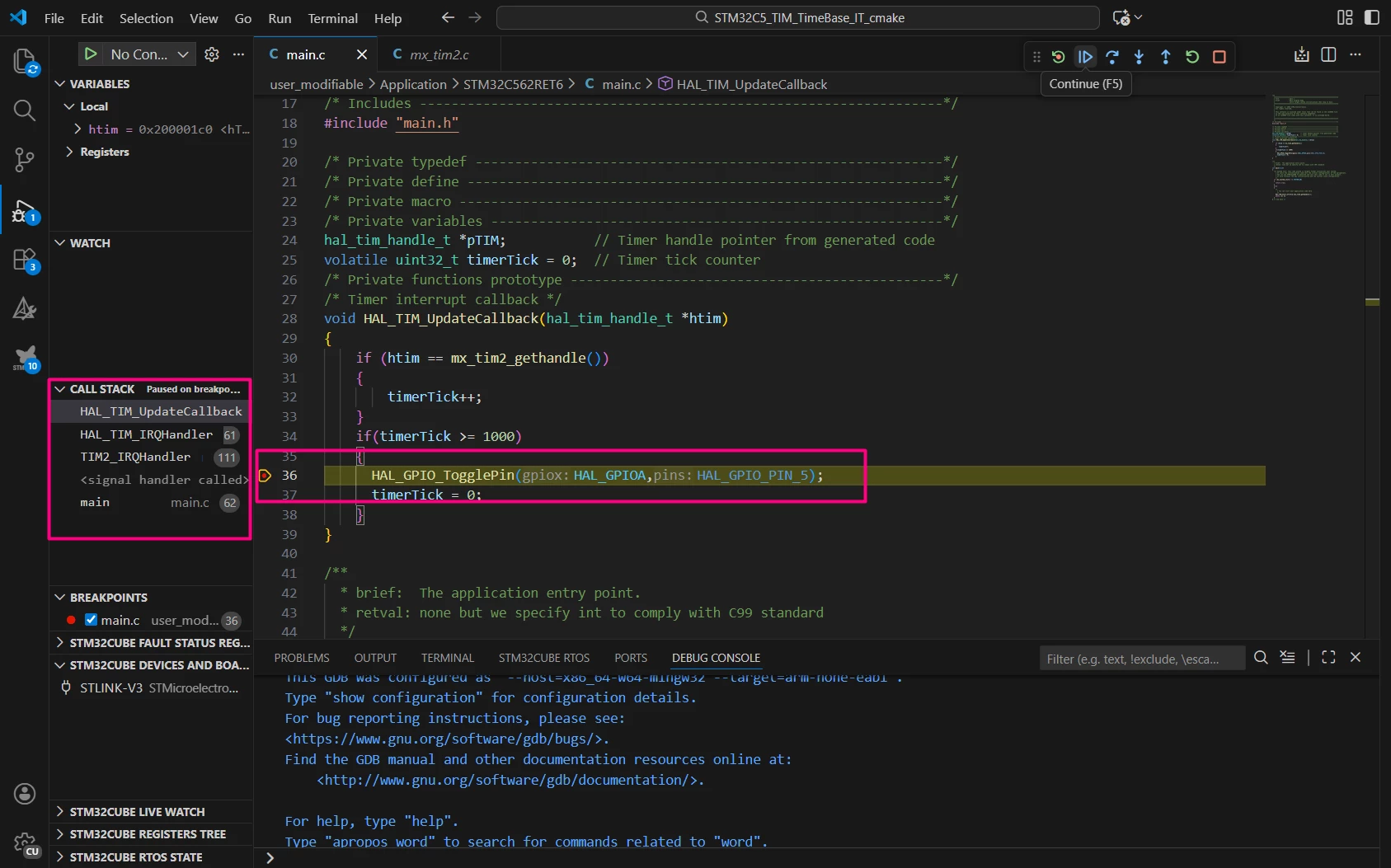

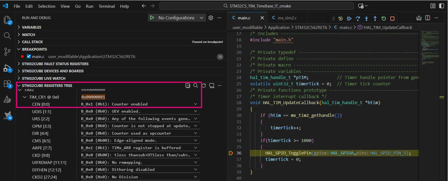

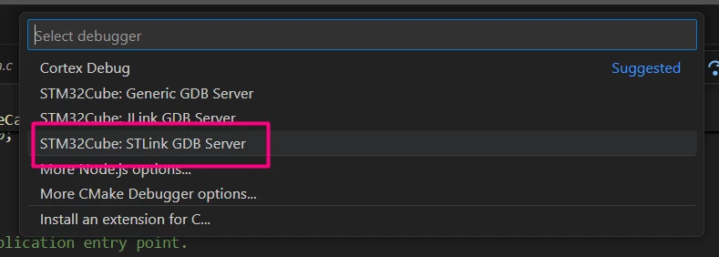

After building the application, locate the [Run and Debug] icon, create your debug session by selecting the [STM32Cube: STLINK GDB Server] option.
Once in debug mode, add a breakpoint in the callback or observe the LED blinking at a 1 second rate.
