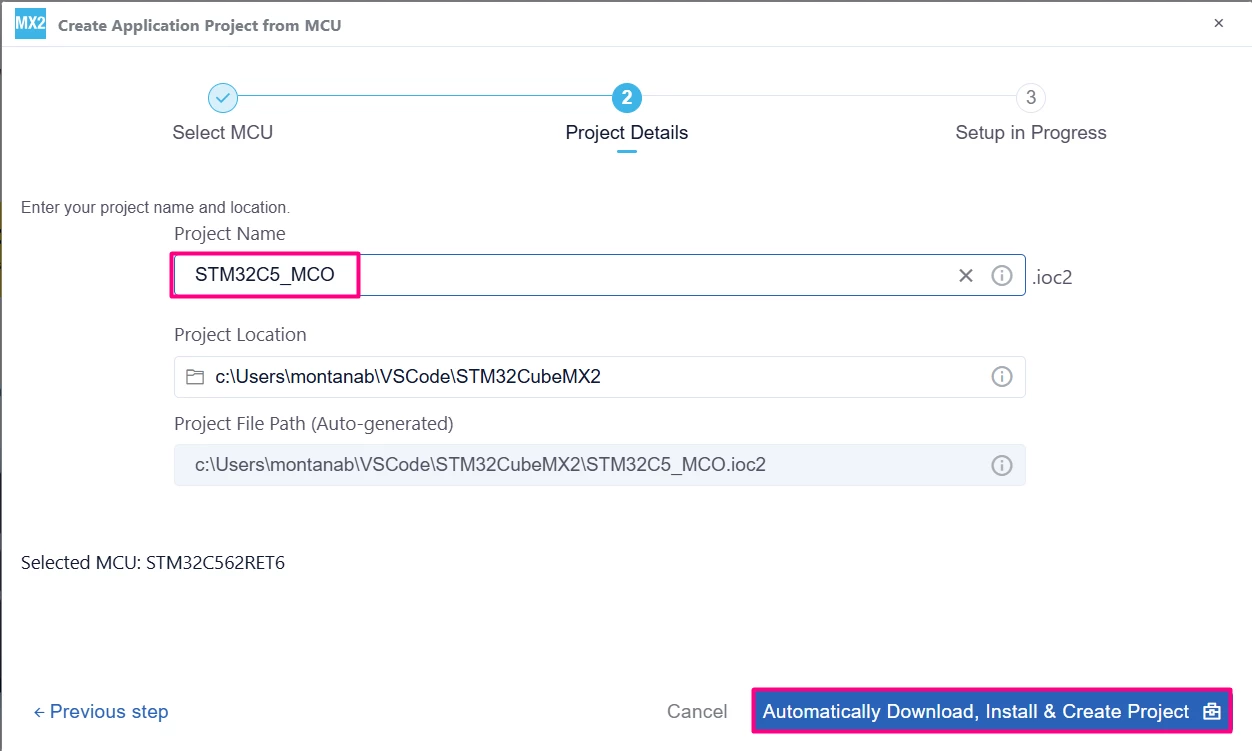

1. STM32CubeMX2 project creation and basic setup
Follow these steps to create the MCO application project for the NUCLEO-C562RE board:

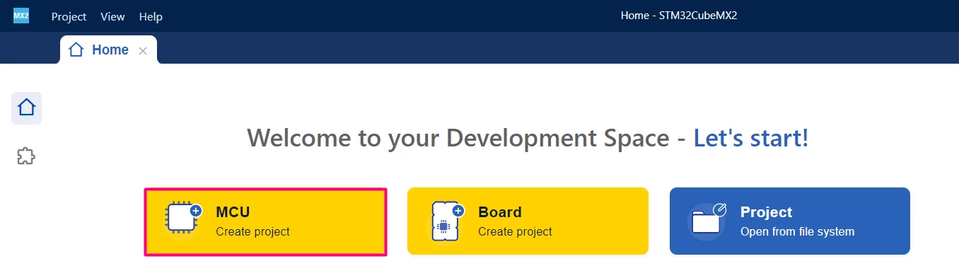

Open STM32CubeMX2. On the Home page, click the MCU square to create a new project.

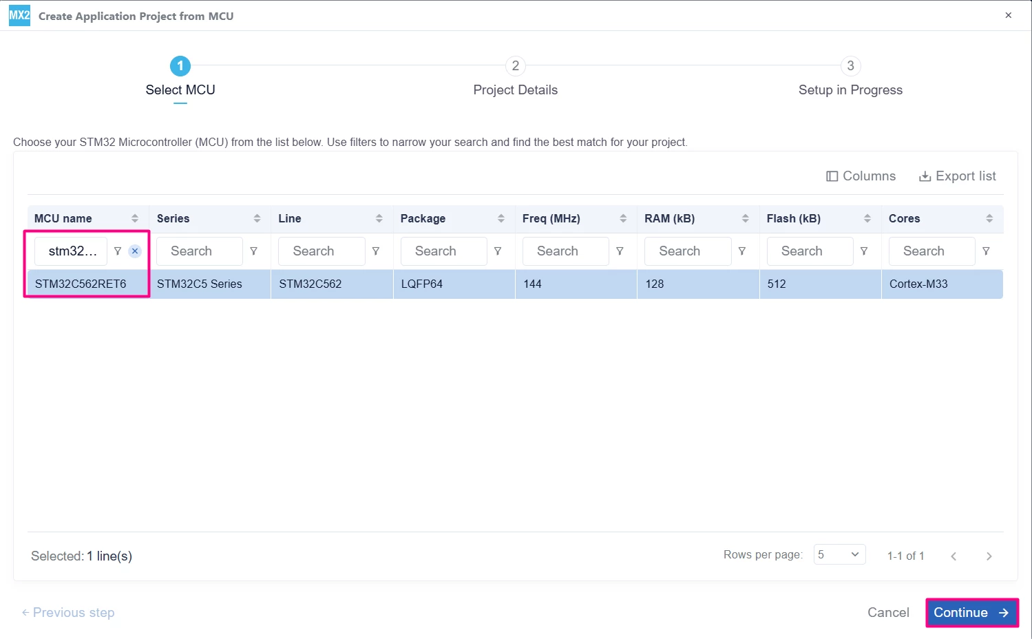

BMontanari_0-1769541272670.pngIn the search field under MCU name, enter STM32C562RE and select your board. Click Continue.

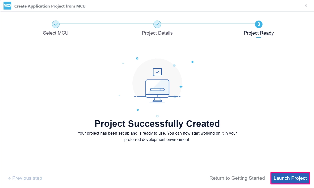

Enter your project name and location. Click [Automatically Download, Install & Create Project] to finish project creation.
Click [Launch Project] to get started.

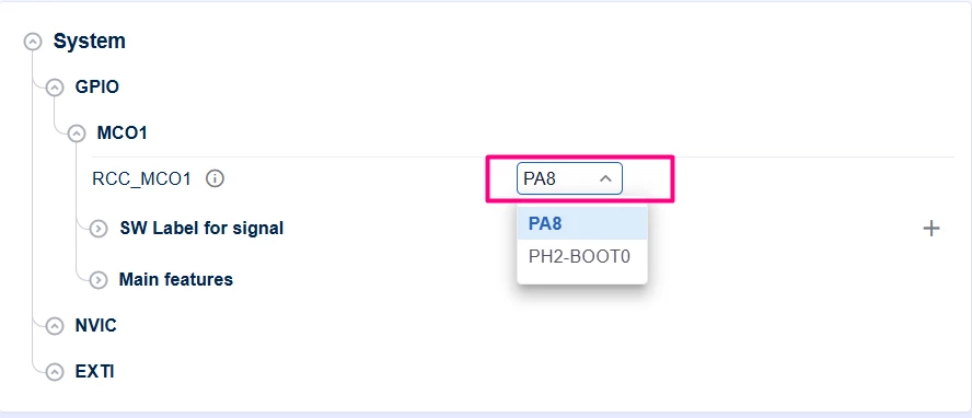

1.1 Pinout and peripheral configuration

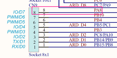

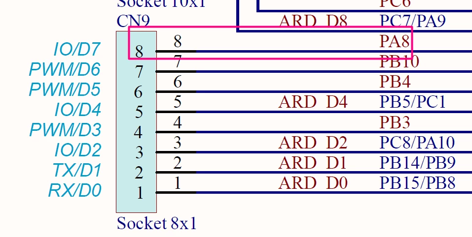

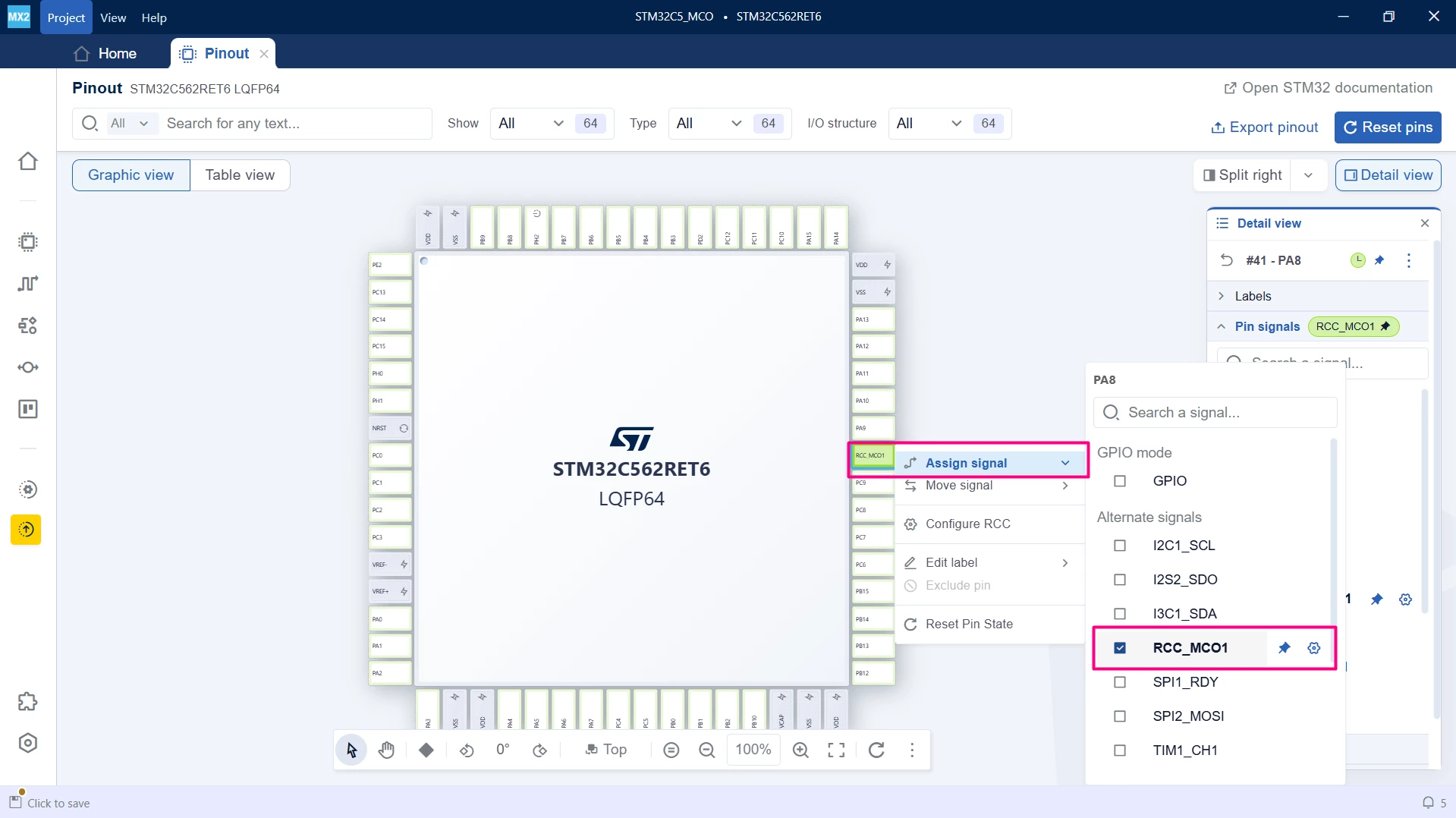

After the project workspace is ready, locate pin PA8 in the Pinout view. Right-click the pin and select RCC_MCO1 to assign it as the master clock output pin.

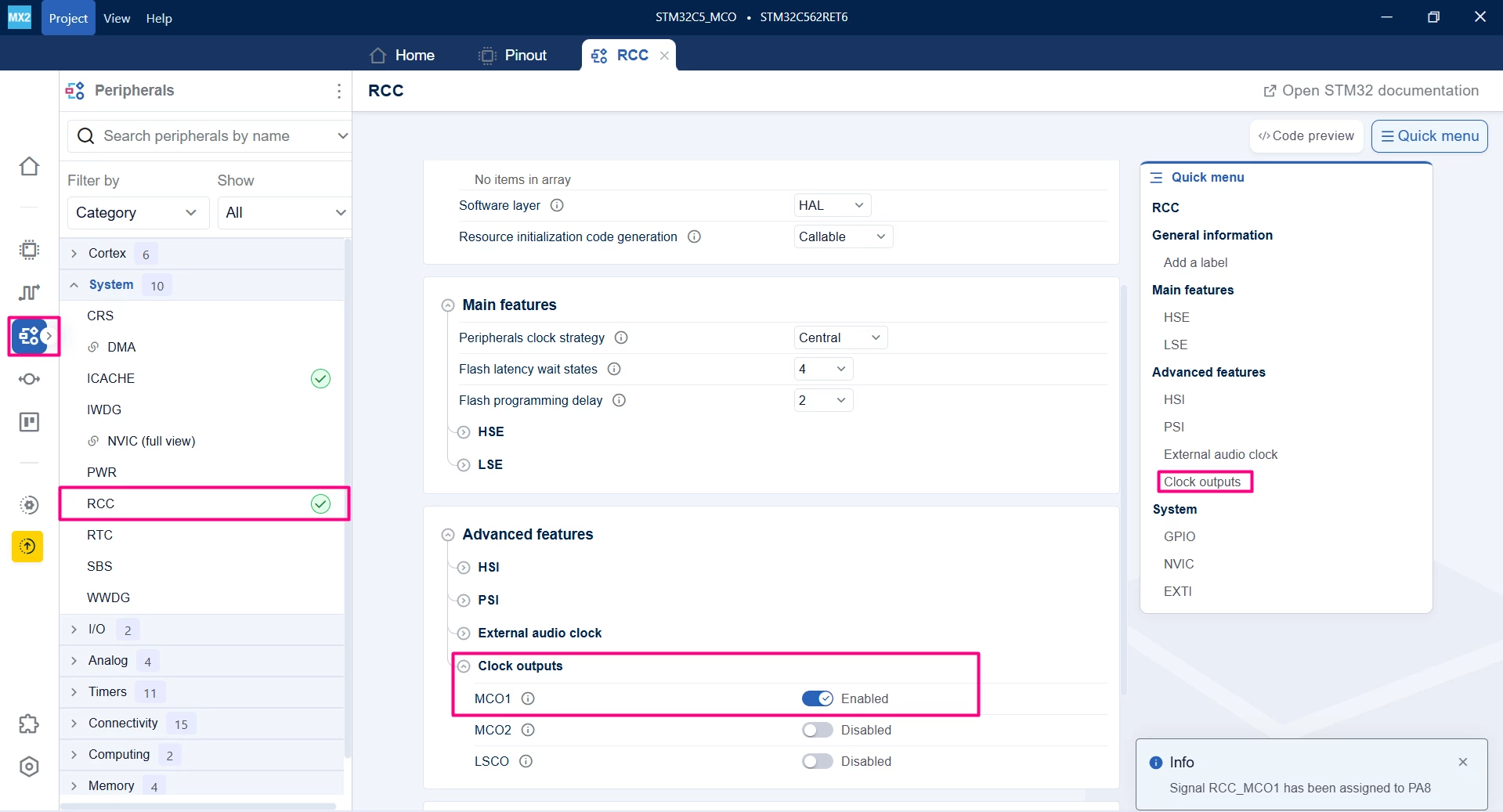

In the left Categories menu, navigate to System Core and select the RCC peripheral to open its configuration panel. In the RCC configuration settings, enable the MCO1 (master clock output 1) feature.
In case you failed to allocate it at PA8, you can use the System portion to specify which pin you want the MCO1 to be placed at.

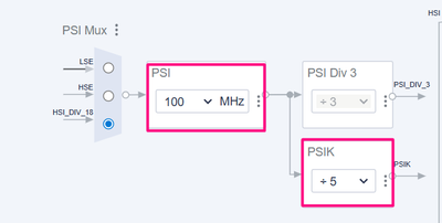

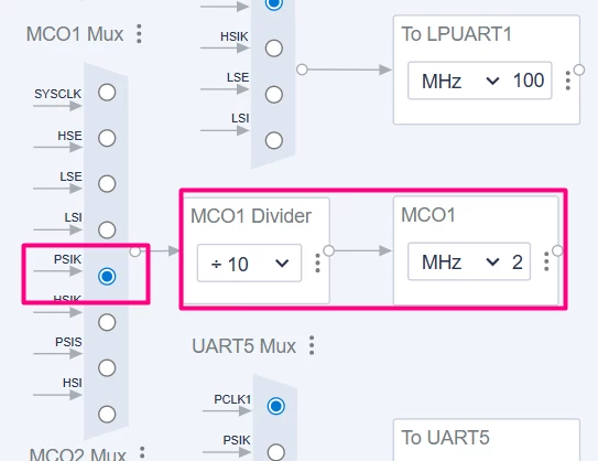

1.2 Clock configuration

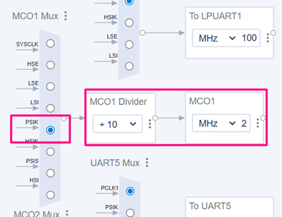

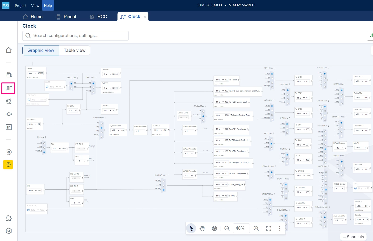

Switch to the Clock Configuration tab.

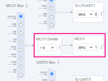

Adjust it in accordance with the desired clock branch that your application wants to evaluate. In this case, the selected output was adjusted for 2 MHz, coming from the PSIK:
To achieve a 1 MHz output clock, locate the MCO1 Mux. Select the desired source and set the MCO1 prescaler (divider) to 8.

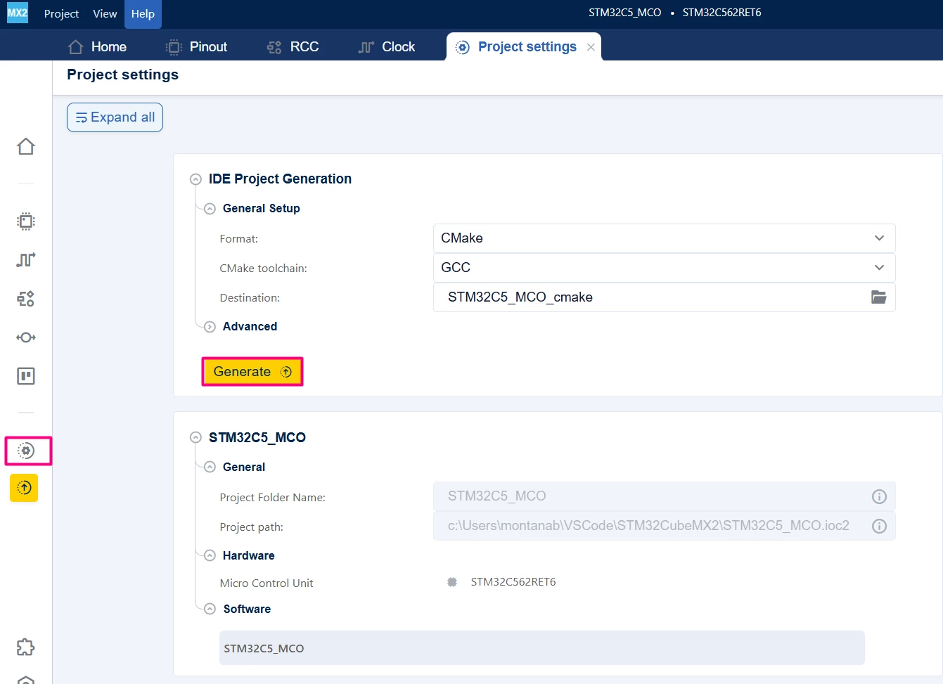

1.3 Code generation
To generate the code:
  1. Click on the [Project settings] icon and select the desired IDE.
  2. Click the [Generate] button.

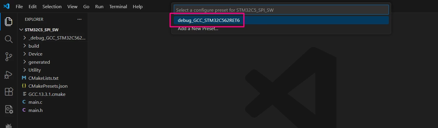

Open Visual Studio Code and open the project folder.
You are prompted with a selection. In case you miss click or that does not appear, press Ctrl+Shift+P, type CMake: Select Configure Preset, and choose your debug configuration.

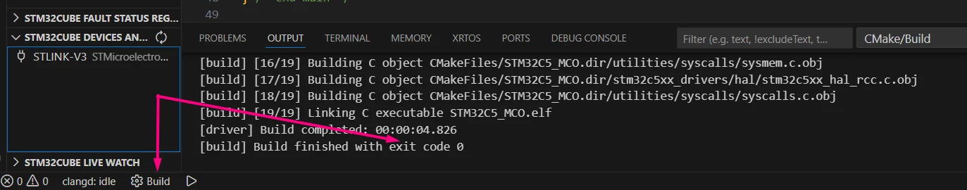

Build the project to ensure that everything is properly set and then go to the implementation code.

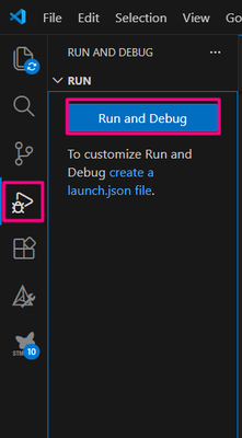

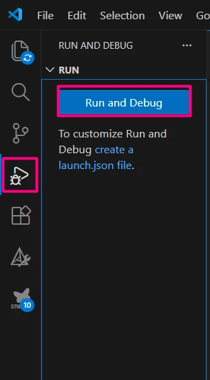

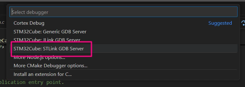

2.1 Validation

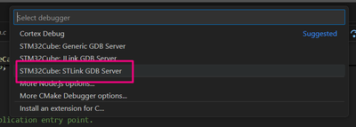

After building the application, locate the [Run and Debug] icon, create your debug session by selecting the STLINK GDB Server option:

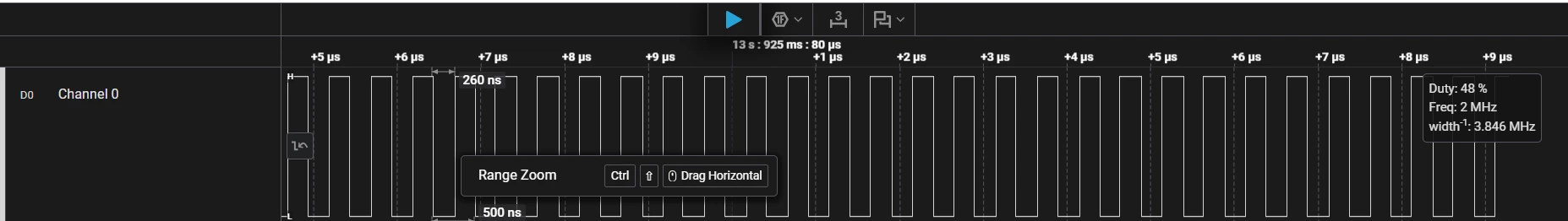

Connect the oscilloscope to PA8 and GND to verify the clock output.
Scope/Data trace image:
