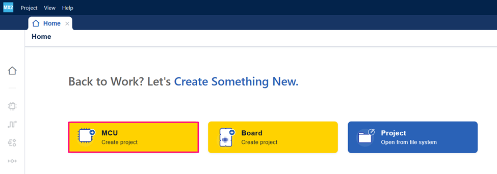

Open STM32CubeMX2. On the Home page, click the [MCU square] to create a new project.

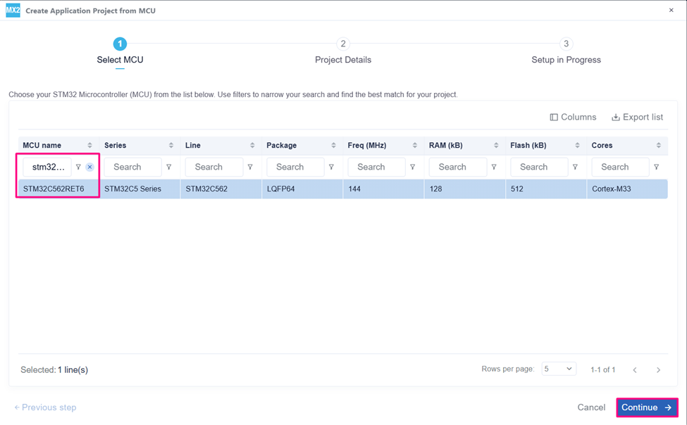

In the search field under MCU name, enter STM32C562RE and select your board. Click [Continue].

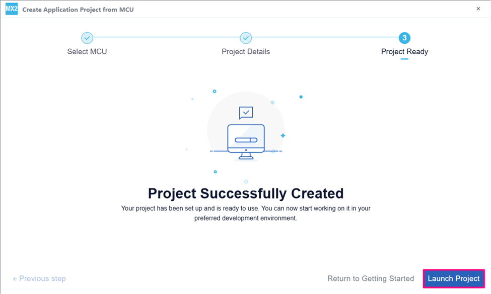

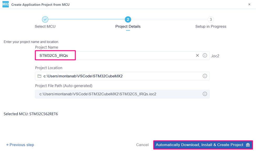

Enter your project name and location. Click [Automatically Download, Install & Create Project] to finish project creation.
Select [Launch Project] to start.

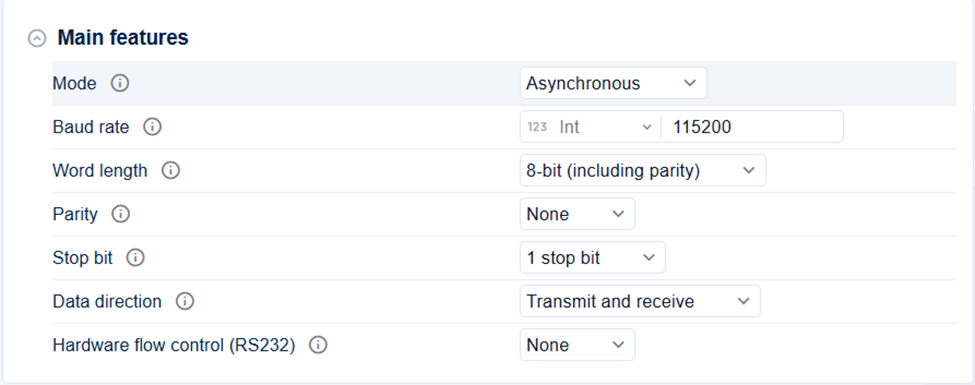

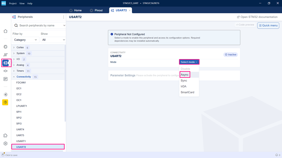

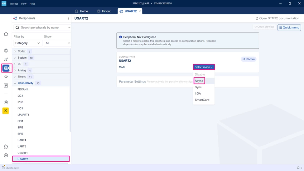

In STM32CubeMX2, go to the "Peripherals" section, then click "Connectivity". Enable the UART by selecting the [Async] mode.
Configure the USART2 peripheral as shown in the figure.

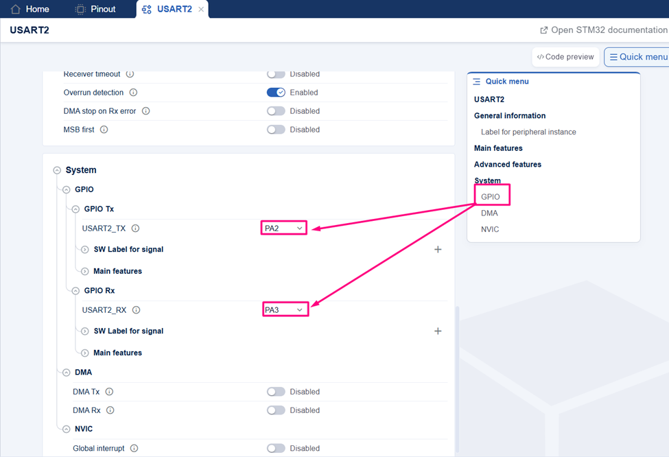

The VCOM bridge available on the NUCLEO board uses USART2_TX and USART2_RX associated with PA2 and PA3. These might not be the default pins selected. To change the GPIOs used, scroll down and change the GPIO Tx/Rx pins.

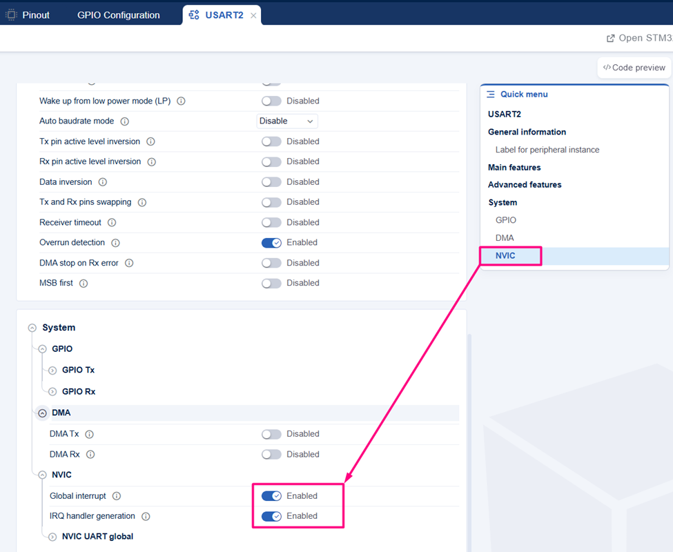

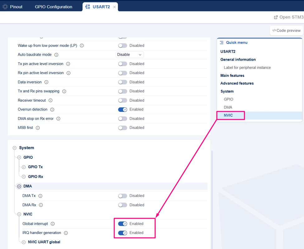

Add the USART interrupt by using the NVIC on the quick menu.

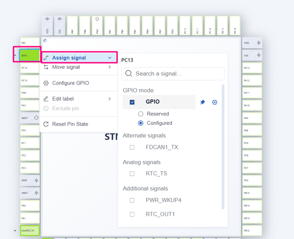

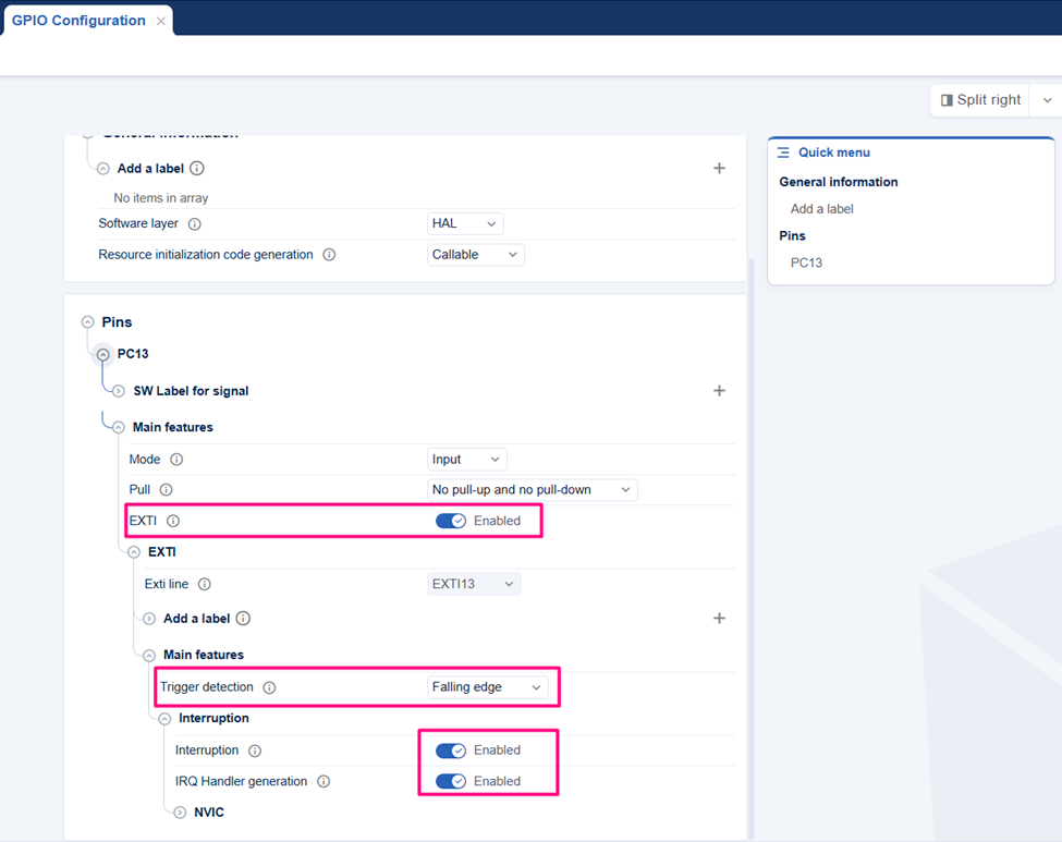

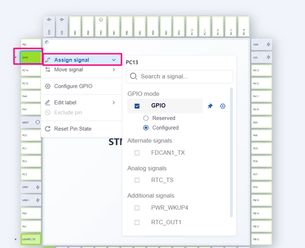

The PC13 is connected to the on-board push button. Click on the engine to configure the EXTI on that pin.
Generate the code and open the project in Visual Studio Code.

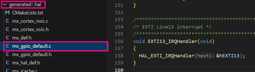

2. Changes in IRQ handler function location

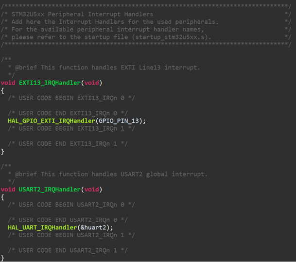

In HAL2, interrupt request handlers are organized so that each enabled peripheral’s IRQ is placed in a dedicated file. This improves code modularity and facilitates analysis through the code preview feature.
The following section compares the previous and current organization. The example uses two IRQs: one related to the EXTI13 line, associated with the NUCLEO-C562RE board GPIO push button, and one related to UART2 interruption, associated with the VCOM port created by the on-board STLINK.

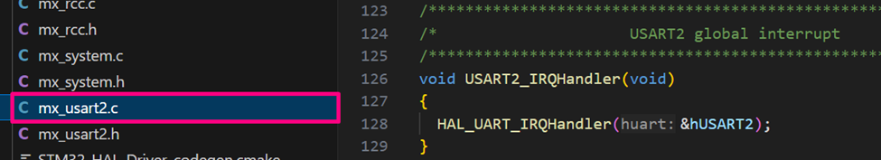

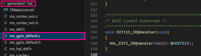

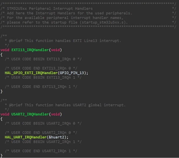

Previously, all IRQ handlers were placed in a single file, generically called the stm32xyz_it.c file.
In HAL2, they are placed in their respective peripheral files inside the generated/hal/ folder. Each peripheral automatically gets its own file upon creation, which is also the default location of the callbacks.

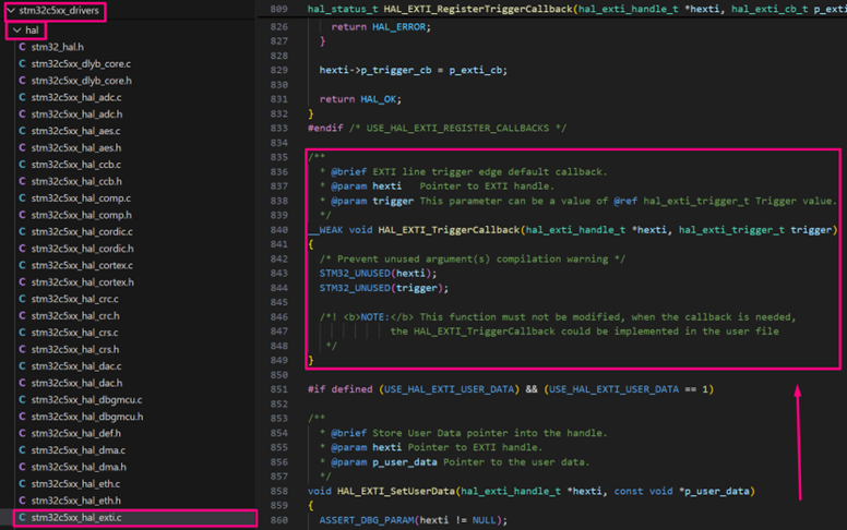

3. Where to locate the IRQ callbacks

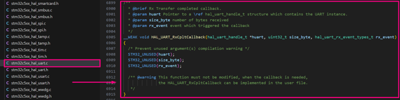

The weak callback functions are still located in the Driver folder, but now the folder has a slightly different name, generically called the stm32xyz_drivers/hal directory. All peripheral driver files contain their respective callbacks, all declared as weak functions.
A notable change is that the EXTI weak functions are now in the stm32xyz_hal_exti.c file instead of the stm32xyz_hal_gpio.c file, as in the previous HAL. This change is logical, since not all EXTI are associated with GPIO usage.

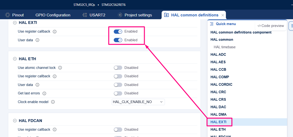

4. How to generate IRQ custom callback handlers

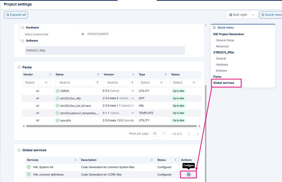

To generate the custom IRQ callback handler in STM32CubeMX2, go to the "Project settings" tab, click [Global services] via "Quick menu", and then the [gear] under Actions.
Use the quick menu to locate the peripheral, in this case, the USART2 and EXTI, and enable the Use register callback and User data.
Upon code regeneration, it is now possible to use the HAL2 function to register the desired callback. For the EXTI, use the following function:
HAL_EXTI_RegisterTriggerCallback(mx_gpio_default_exti13_gethandle(), &UserDetectedExtiCallback);

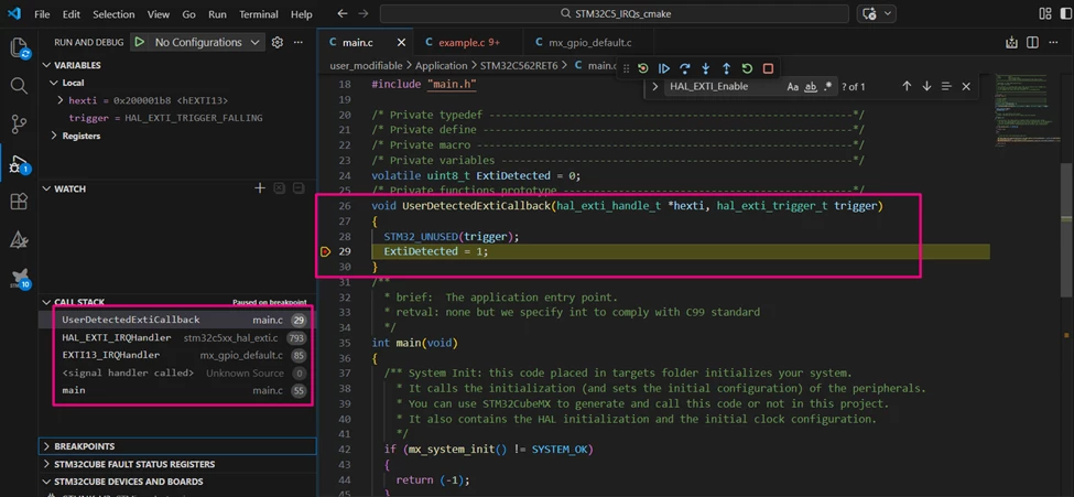

Validation

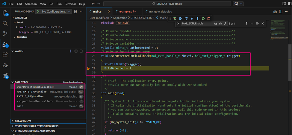

Enter in debug mode and place the breakpoint in the created callback. It is also possible to check the call stack.
