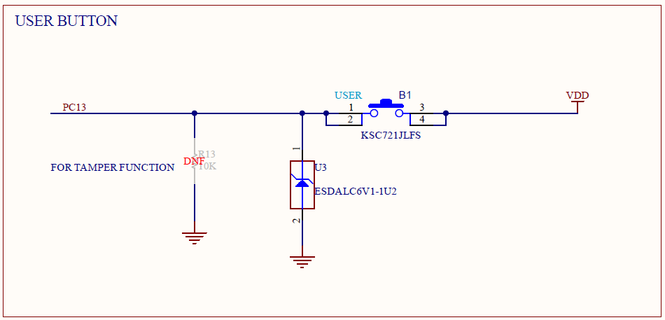

The EXTI module in a microcontroller enables asynchronous event detection by generating an interrupt in response to signal transitions on external input lines. It can be configured to trigger on rising edges, falling edges, or both, allowing precise detection of external events such as button presses or sensor outputs. This capability is critical for real-time responsiveness in embedded systems.
This article presents a demonstration in which pressing the user button on the board triggers an interrupt that causes the on-board LED to blink once.

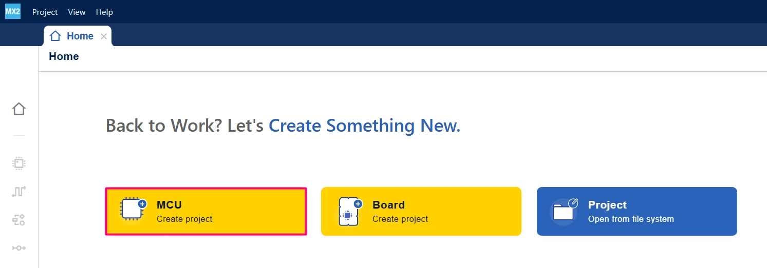

Open STM32CubeMX2. On the Home page, click the MCU square to create a new project.

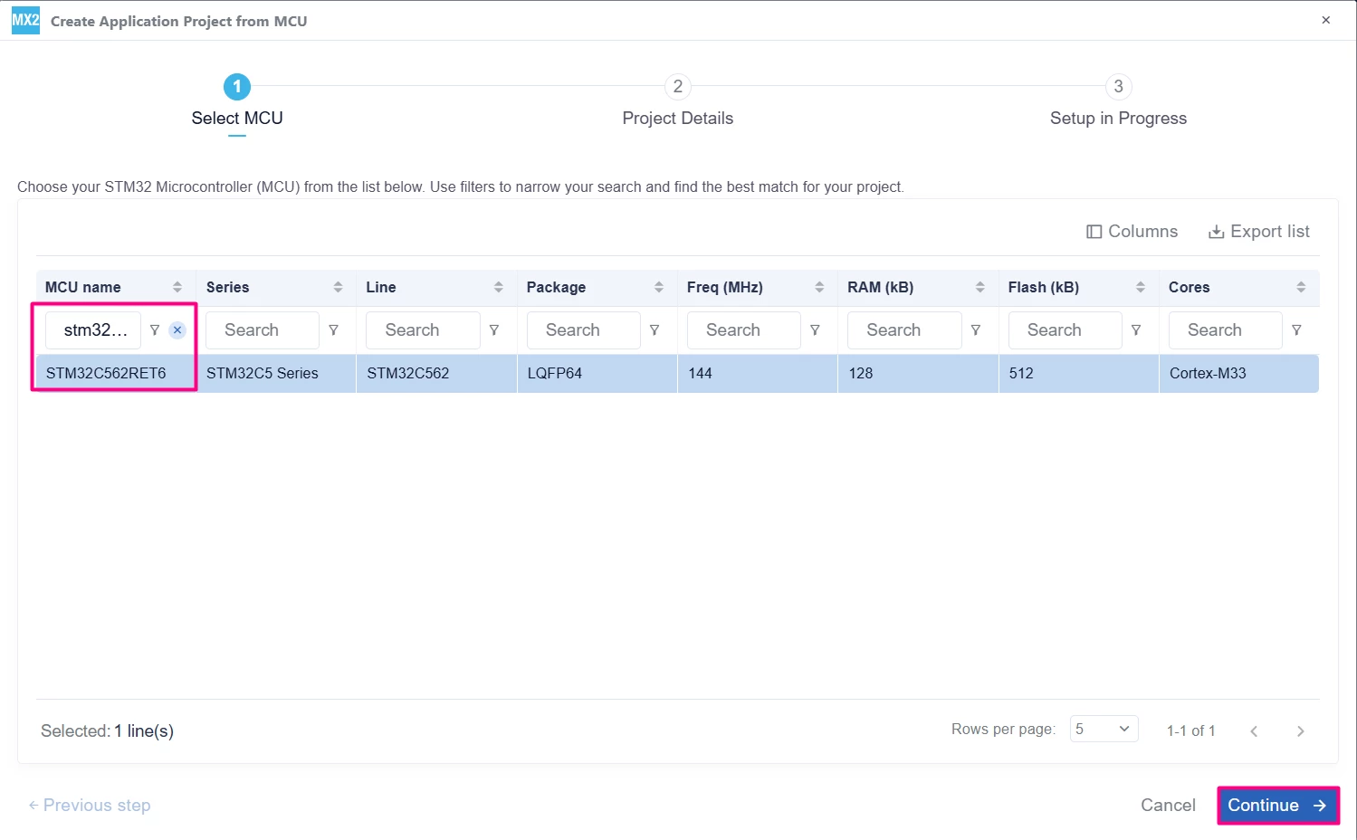

In the search field under MCU name, enter STM32C562RE and select the MCU. Click [Continue].

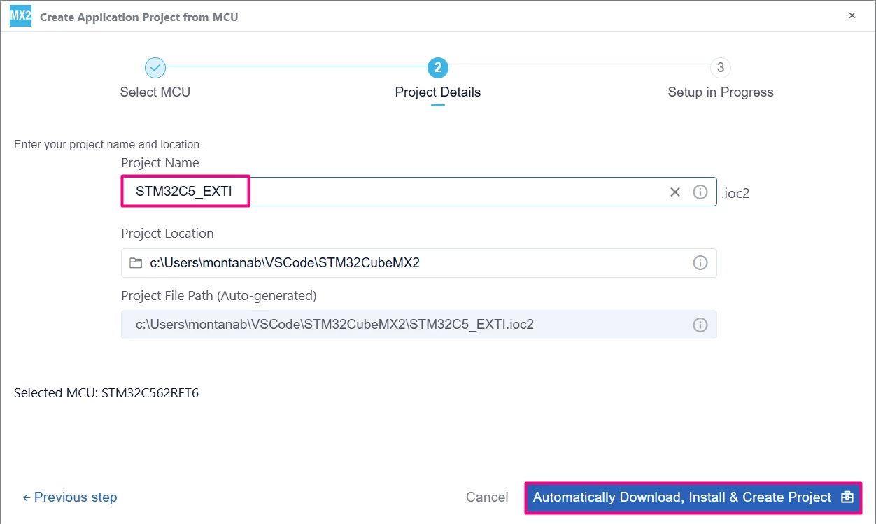

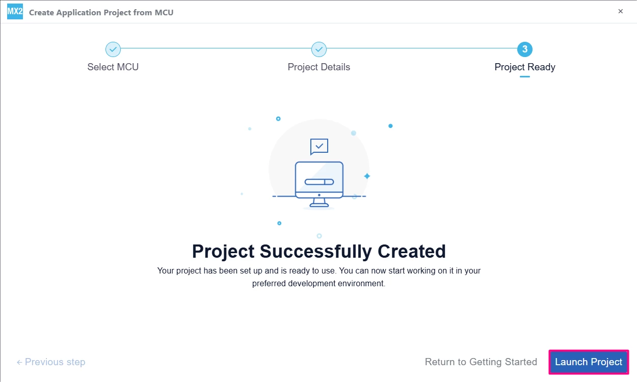

Enter the project name and location. Click [Automatically Download, Install & Create Project] to finish project creation.
Select [Launch Project] to start.

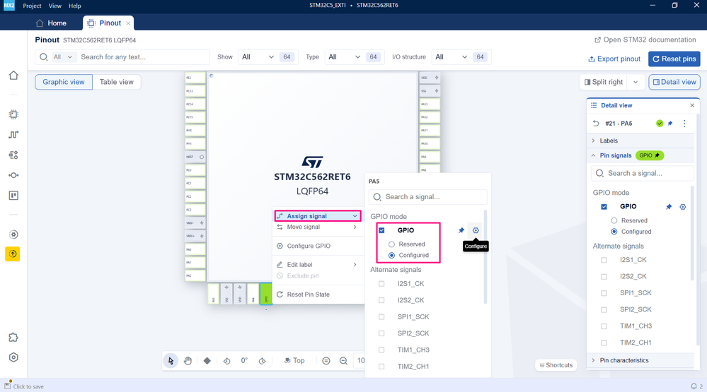

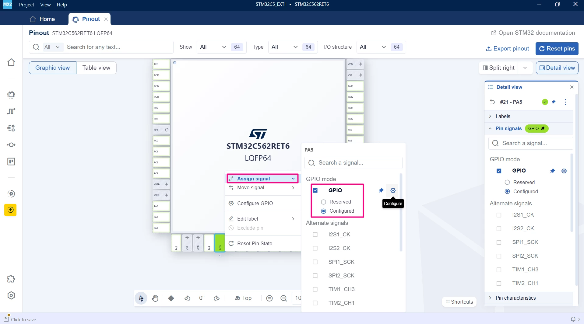

  1. In the Pinout view, click the [PA5] pin. In the menu, hover over [Assign Signal] to reveal additional options. In the GPIO mode section, check the box for [GPIO], and select [Configured].

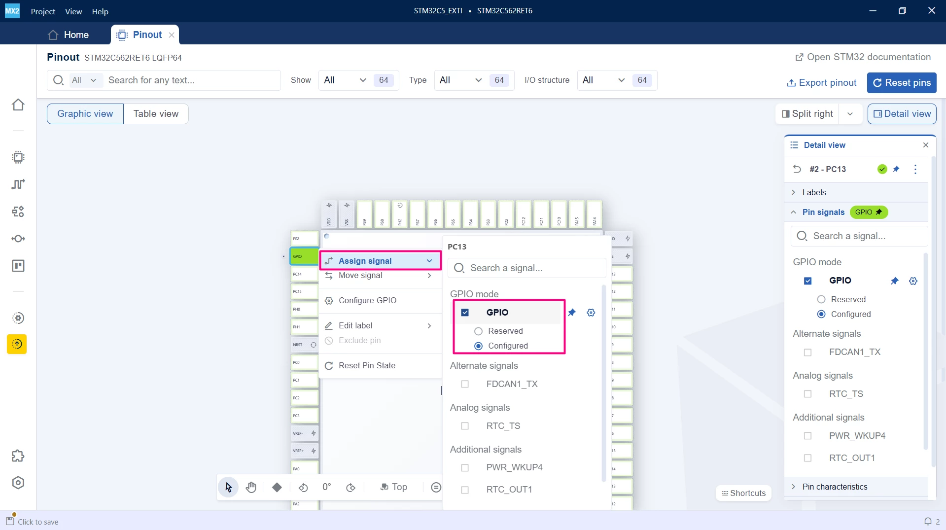

  1. Right-click the [PC13] pin and repeat the previous step.

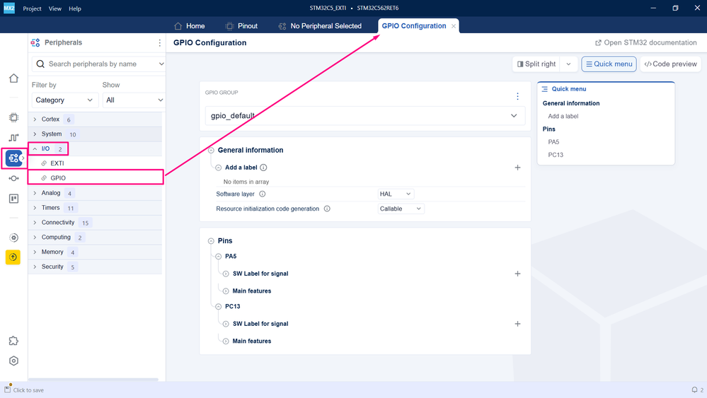

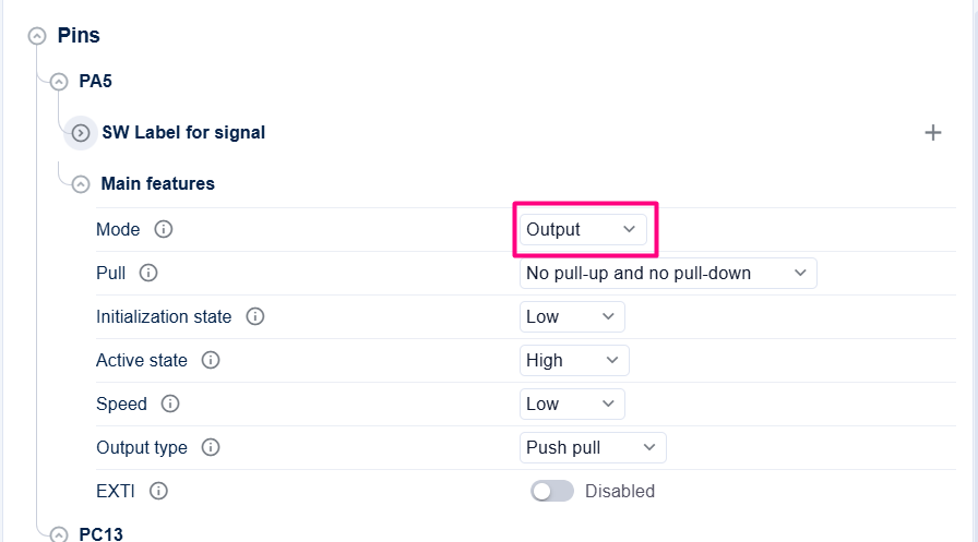

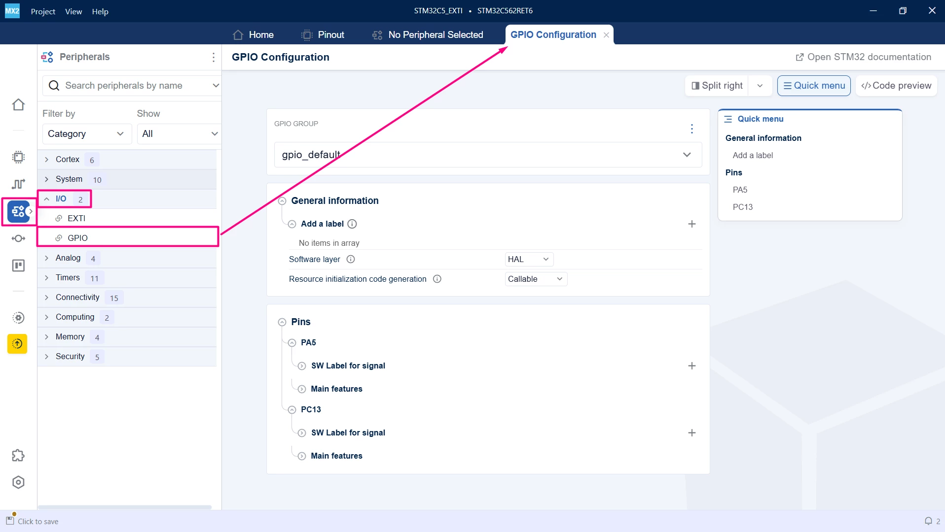

  1. In the GPIO Settings, select the Pins drop-down menu. Configure the main features for each selected pin.

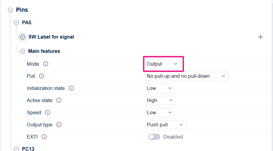

  • Select [PA5]. In the "Main features" tab, set "Mode" to [Output].

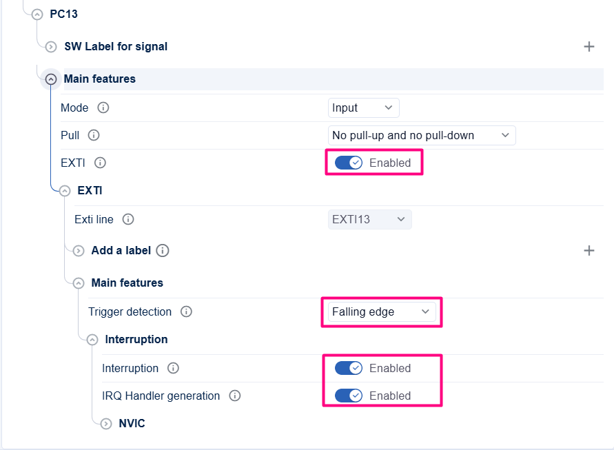

  • Select [PC13]. In the "Main features tab", set "Mode" to [Input]. In  "EXTI" → "Exti line" → "Main features" section, set "Trigger Detection" to [Falling Edge]. In the "Interruption" tab, enable [Enabled interruption] and [IRQ Handler Generation].

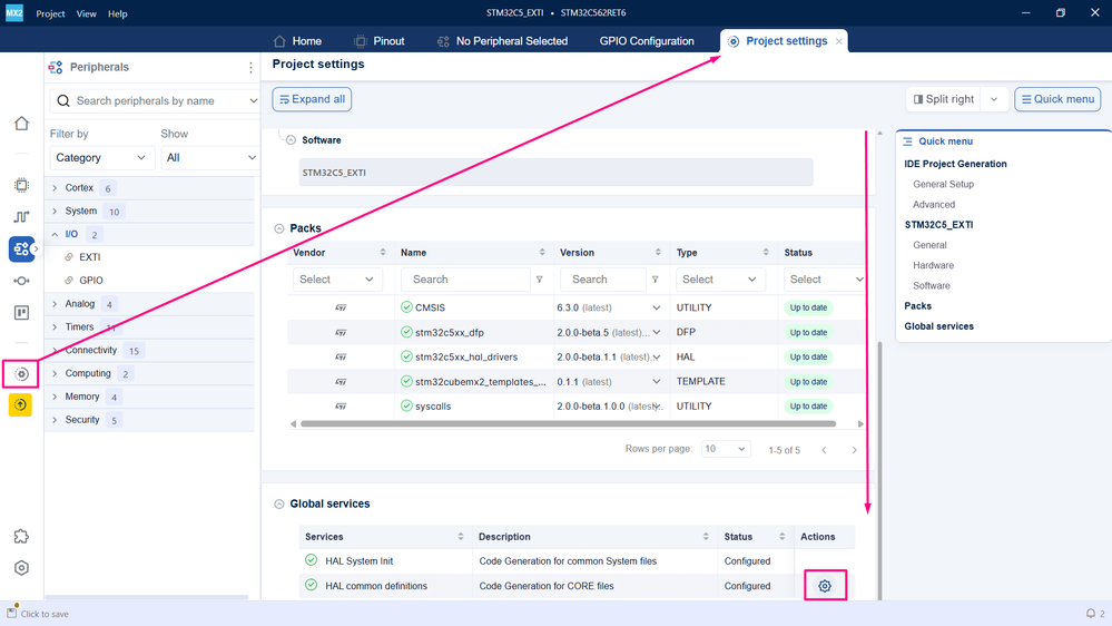

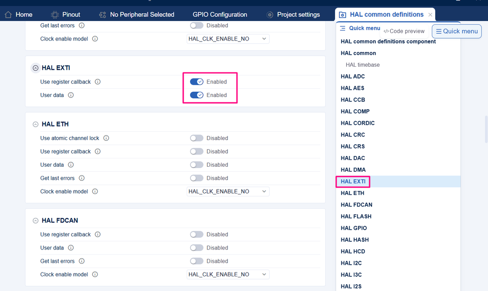

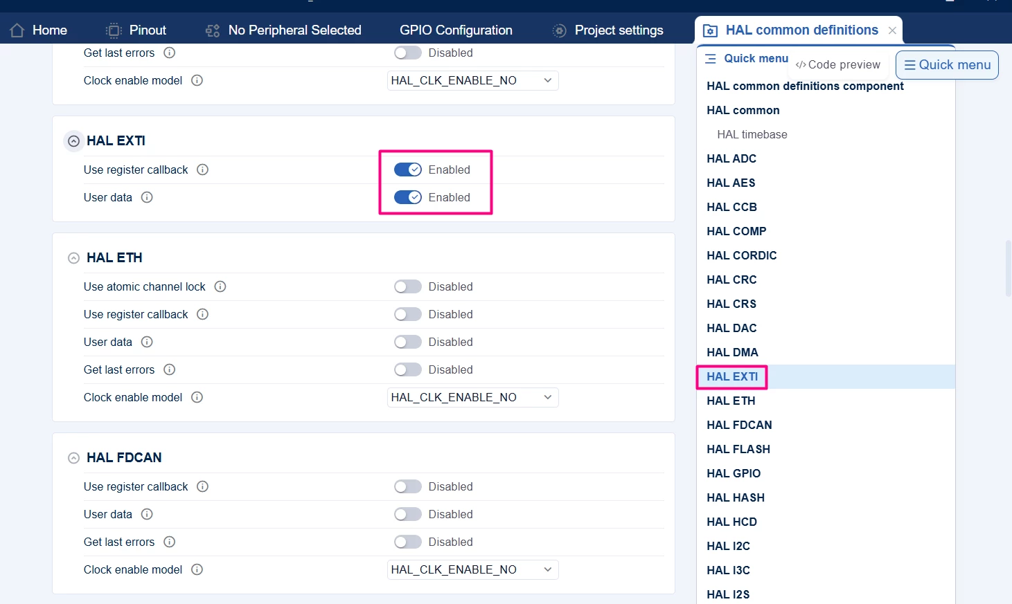

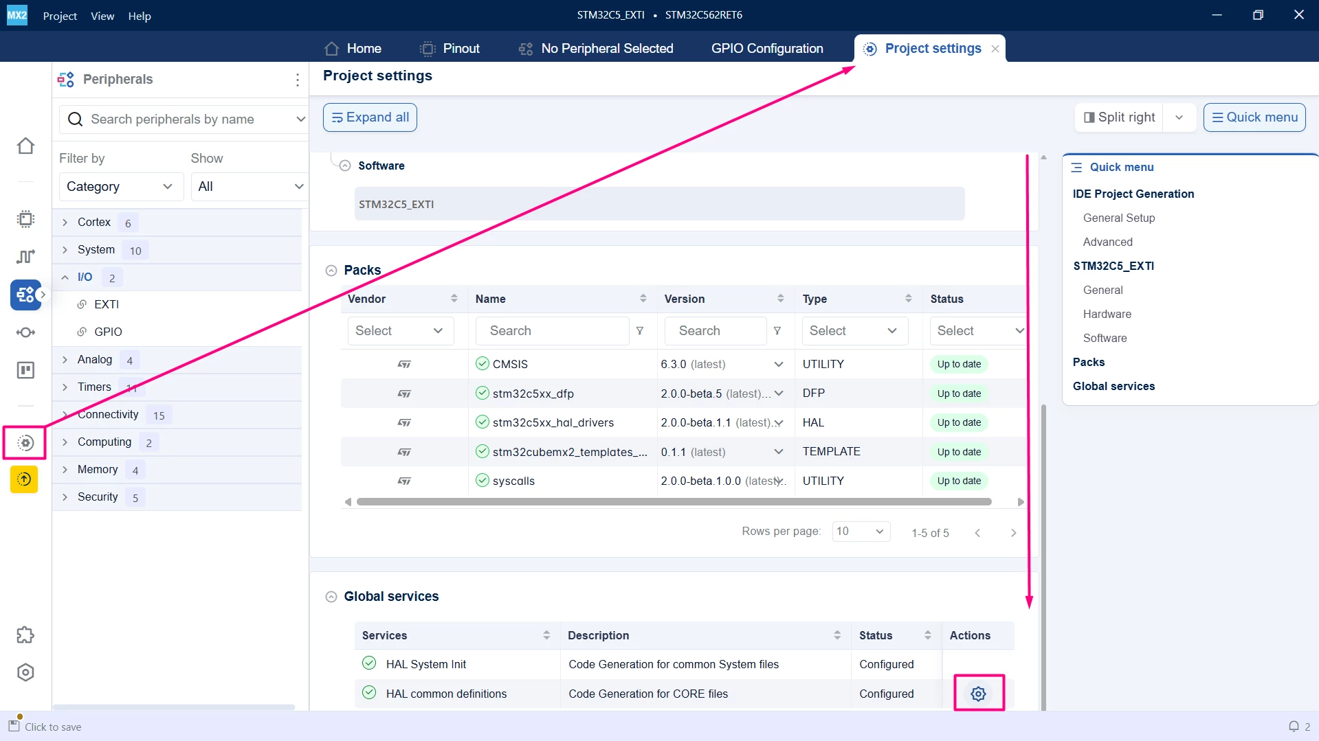

  1. Select the "Project settings" icon. In the HAL common definitions section, under HAL EXTI configuration, enable [Use Register Callback] and [User Data]. This configuration allows generation of the EXTI files.

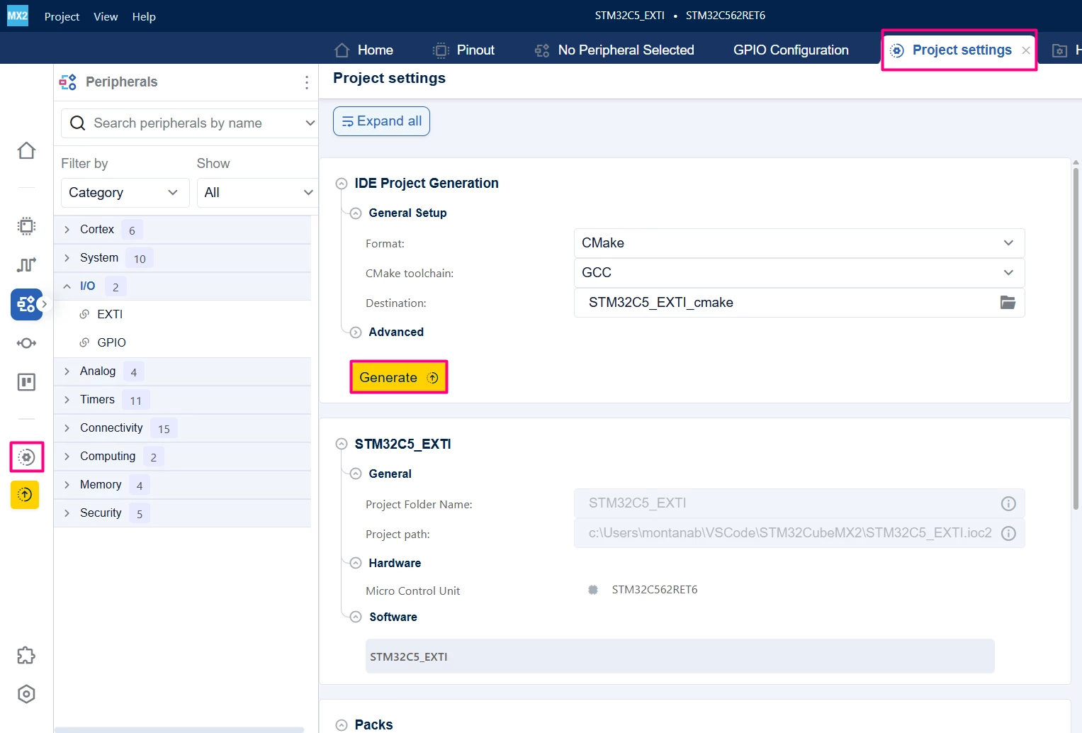

1.3 Code generation
To generate the code:
  1. Click on the [Project settings] icon and select the desired IDE.
  2. Click the [Generate] button.

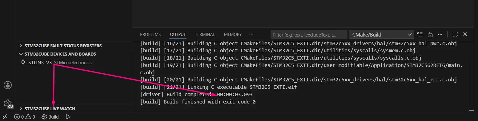

If prompted, select the configuration. If not prompted, press Ctrl+Shift+P, type CMake: Select Configure Preset, and choose the debug configuration.
Build the project to ensure everything is set, then proceed to code implementation.

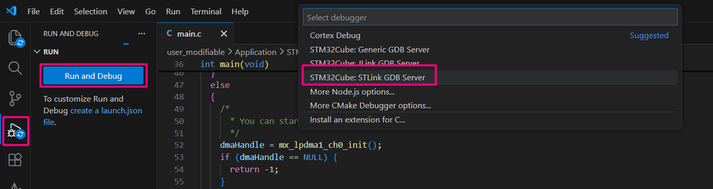

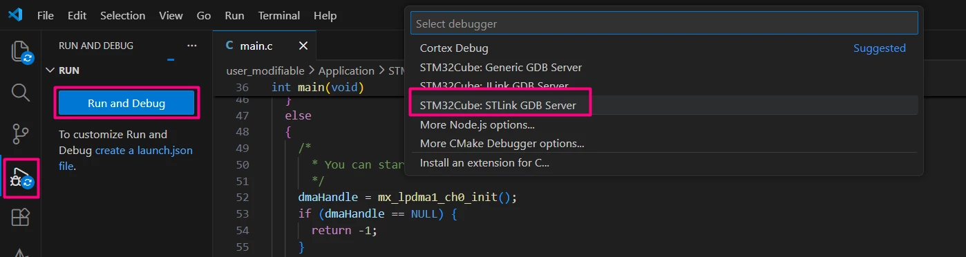

After building the application, select the [Run and Debug] icon. Create a debug session by selecting the [STM32Cube: STLINK GDB Server] option.

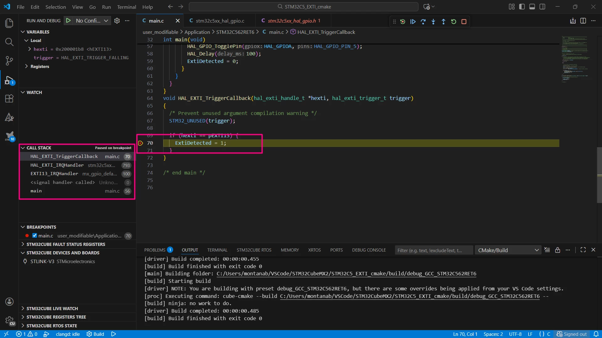

The USER_LED is off at the beginning of program execution. Pressing the USER_BUTTON toggles the LED state.
Insert a breakpoint inside HAL_EXTI_TriggerCallback to verify that the interrupt is triggered only when the button is pressed.
