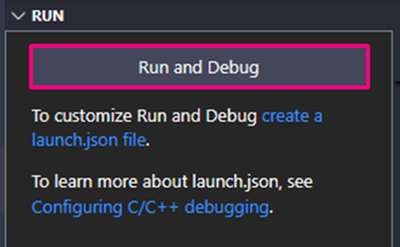

7. Create and modify launch.json
  • Open the Run and Debug view (Ctrl+Shift+D).
  • Click create a launch.json file.
  • Select STM32Cube: STLink GDB Server from the list of debuggers provided by STM32CubeExtension.
  • The extension generates a default launch.json with configurations tailored for STLINK debugging.

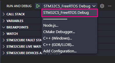

  • Connect your STM32 board to your PC using the STLINK debugger.
  • In VS Code, select the debug configuration you created.
  • Press F5 or click the green [Start Debugging] button.
  • The application should halt at main.c
