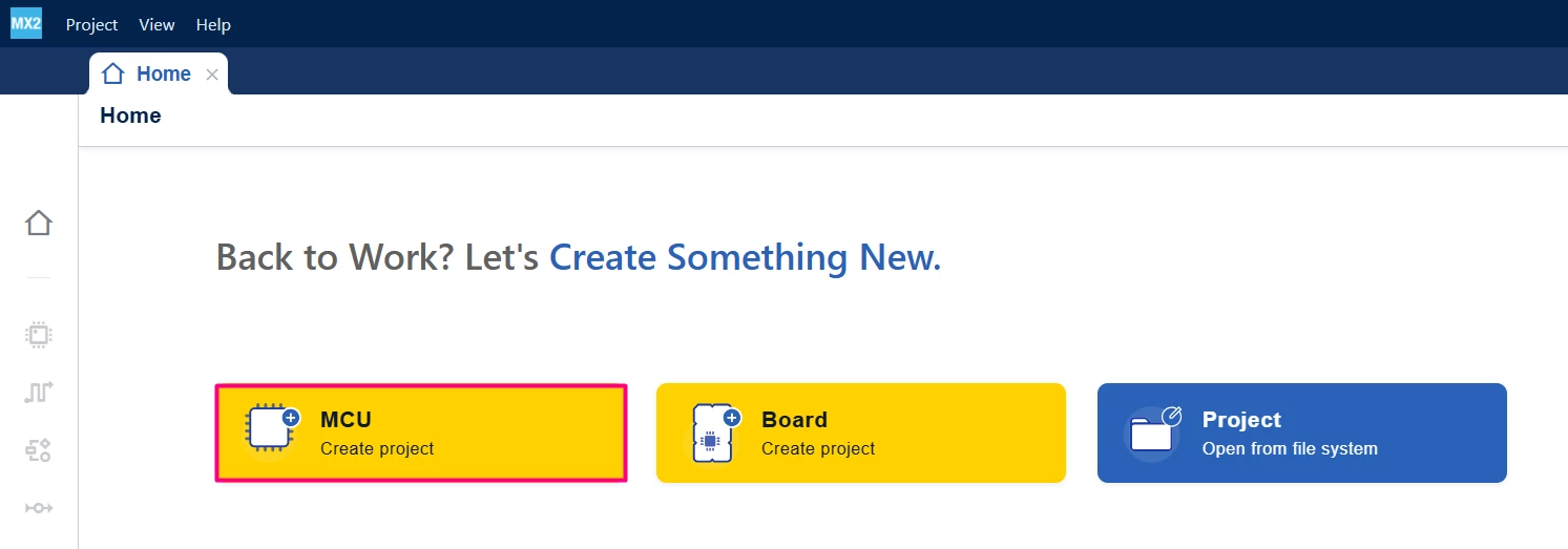

Open STM32CubeMX2. On the Home page, click the [MCU square] to create a new project.

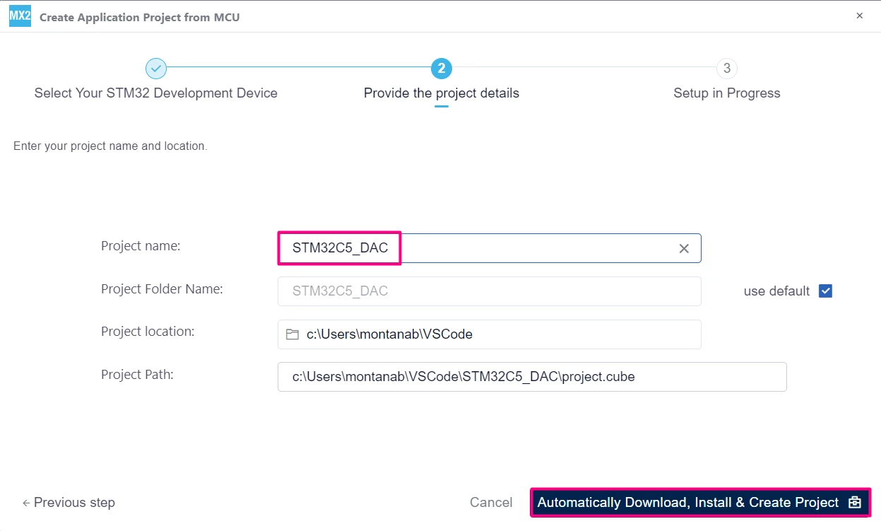

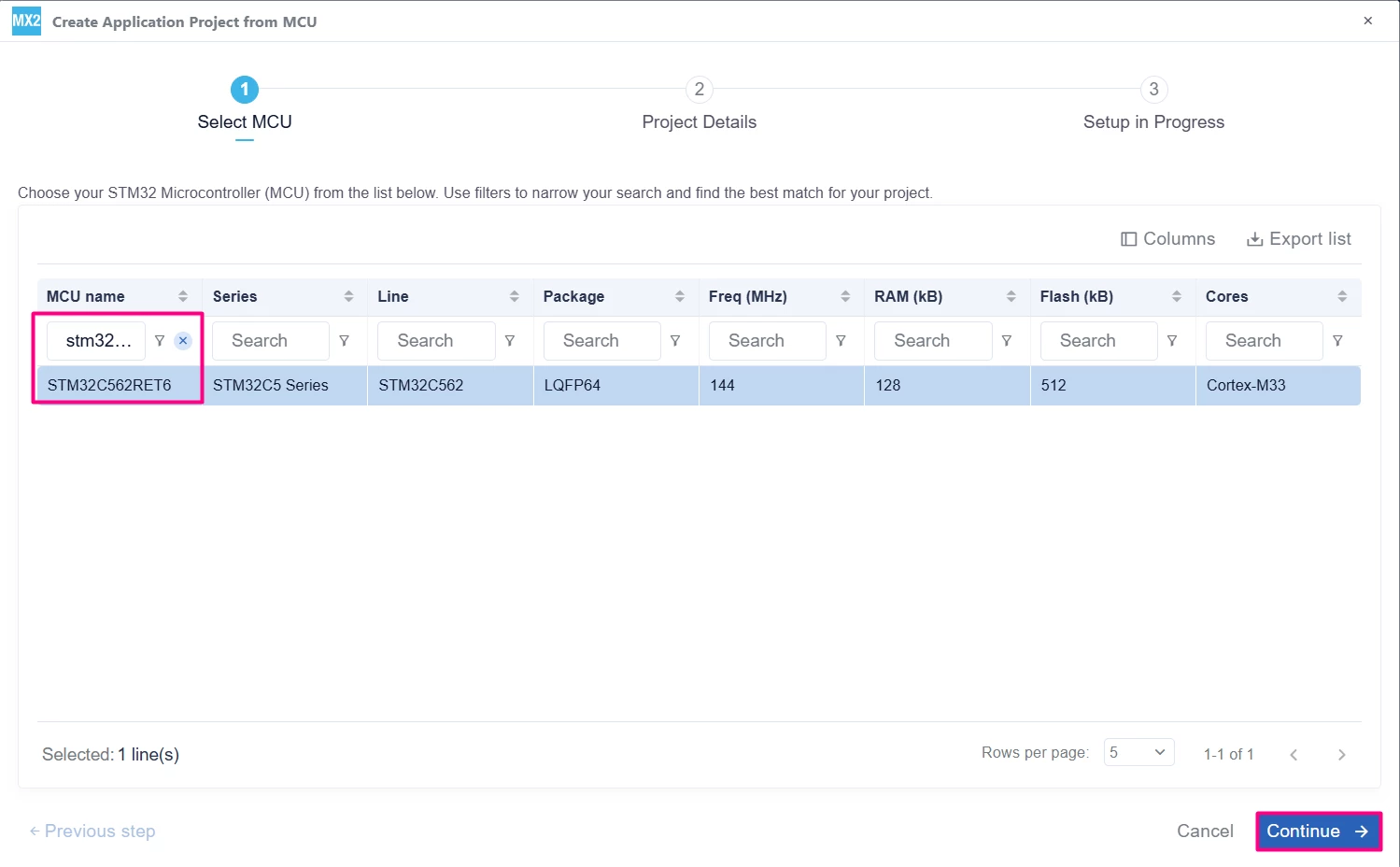

In the search field under MCU name, enter STM32C562RE and select your board. Click [Continue].

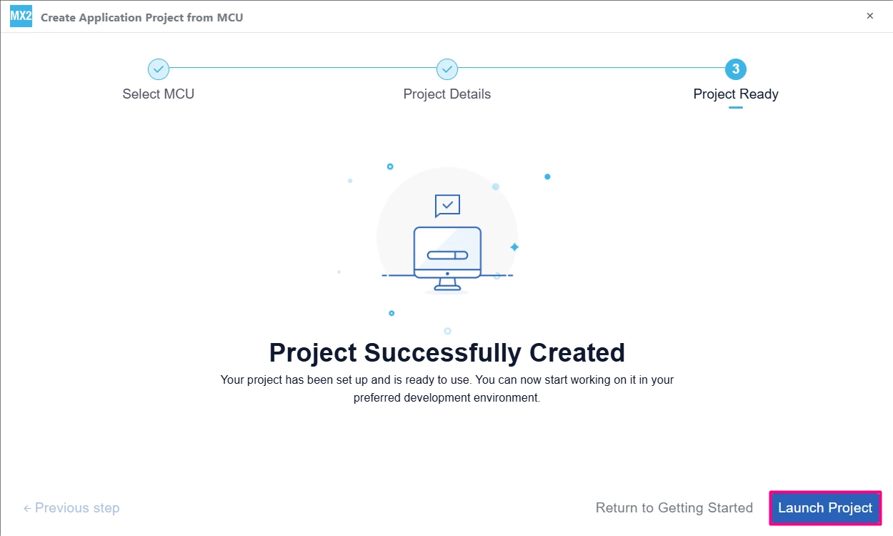

Enter your project name and location. Click [Automatically Download, Install & Create Project] to finish project creation.
Select [Launch Project] to start.

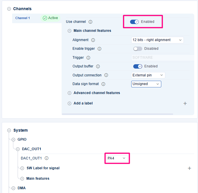

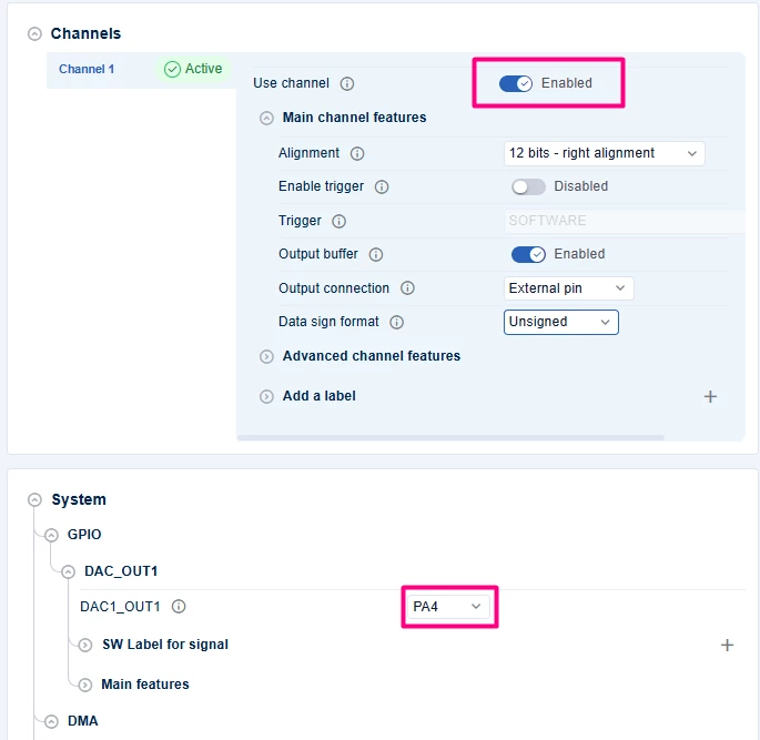

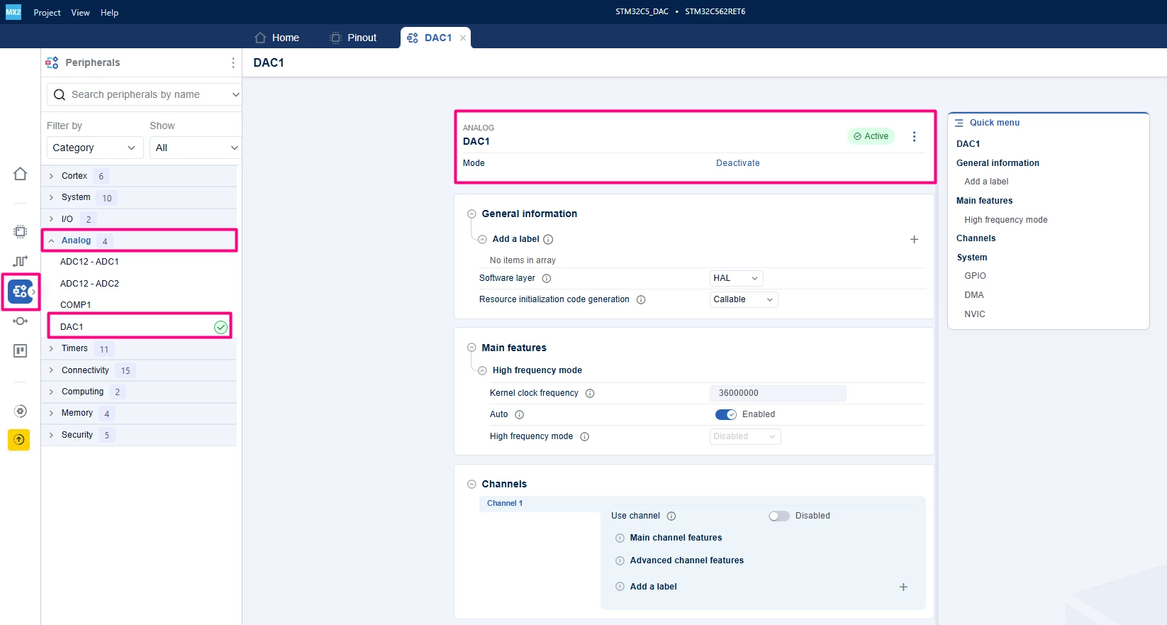

Go to Peripherals →Analog → DAC.
BMontanari_4-1771439105033.pngEnable DAC Channel 1 (typically on PA4)

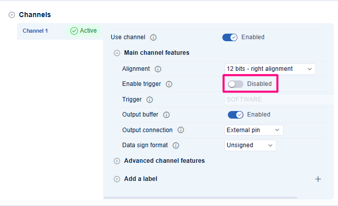

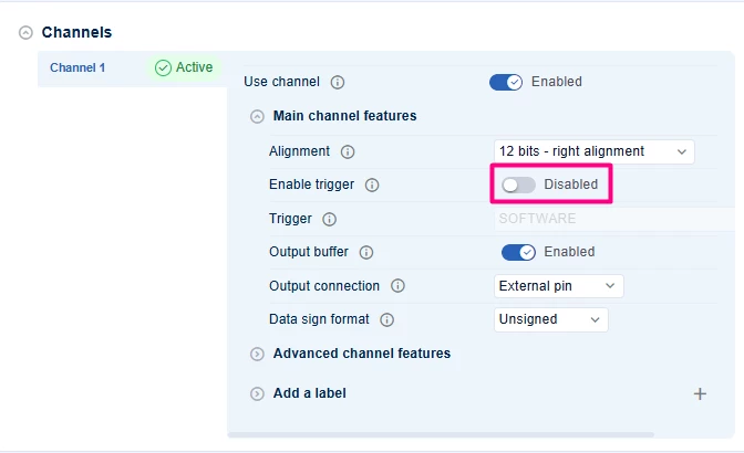

Set Enable trigger to [Disabled] for basic output or select a timer/event for triggered output. Enable Output Buffer for better drive capability (optional).

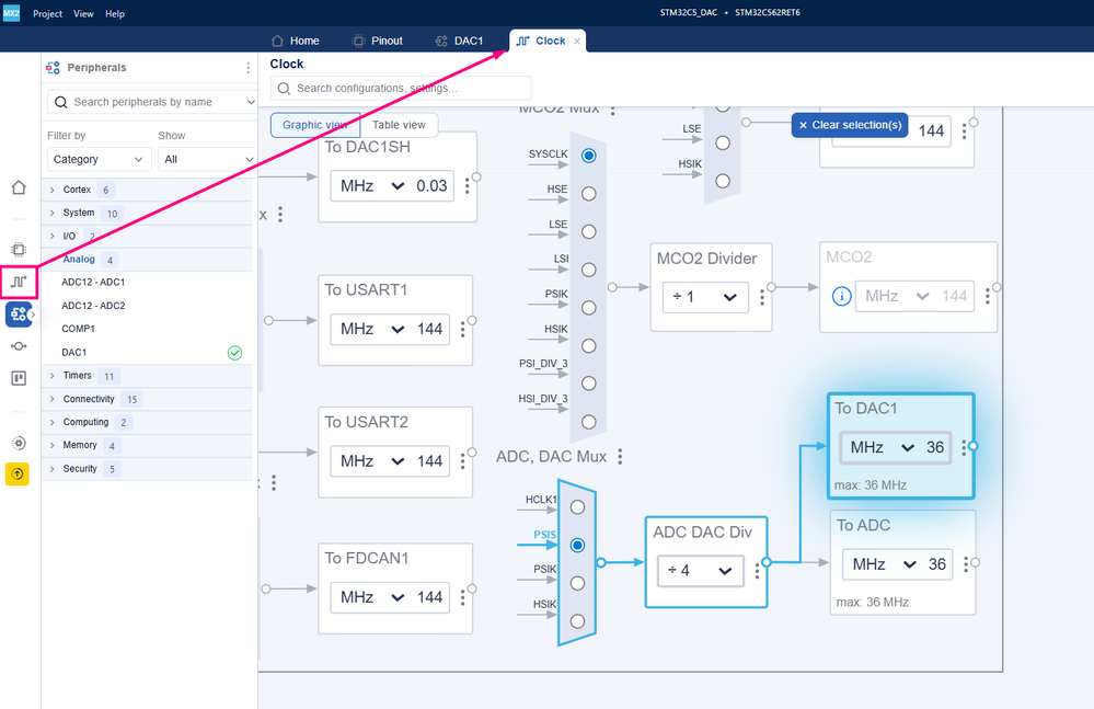

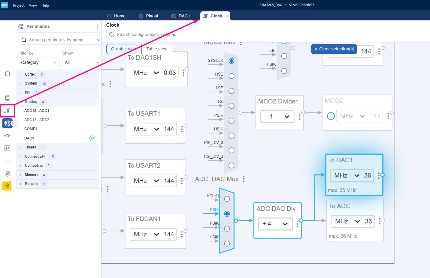

The DAC has two possible clock muxes, which can be observed in the Clock tab. This article uses the default one, via PSIS divided by 4.

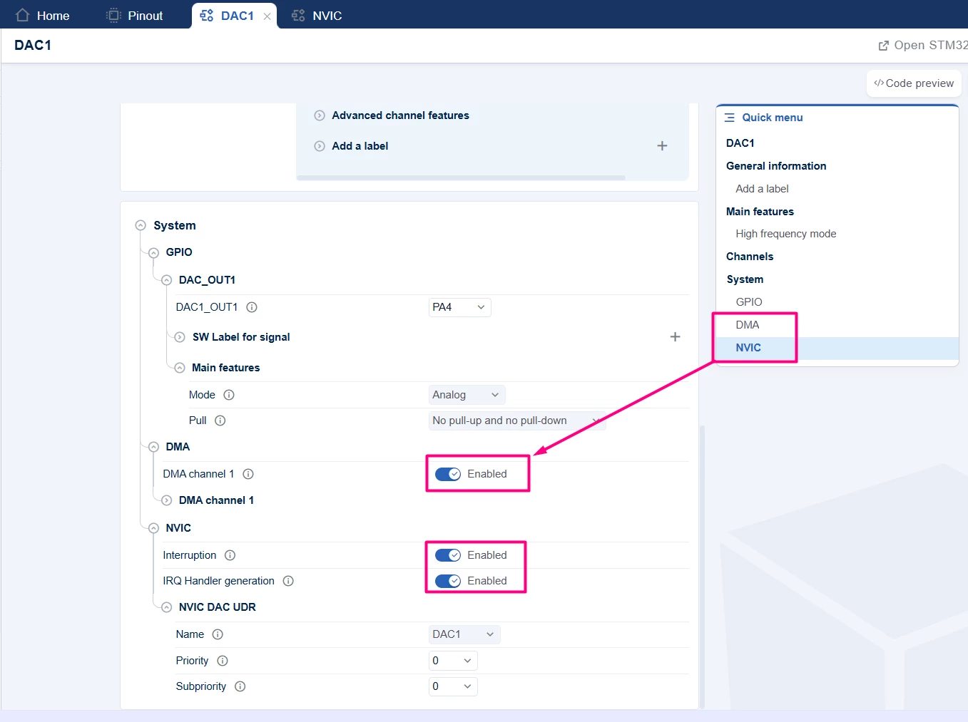

BMontanari_7-1771439105045.pngEnable DMA and/or Interrupt if you plan to use those modes. We cover that later in this article.

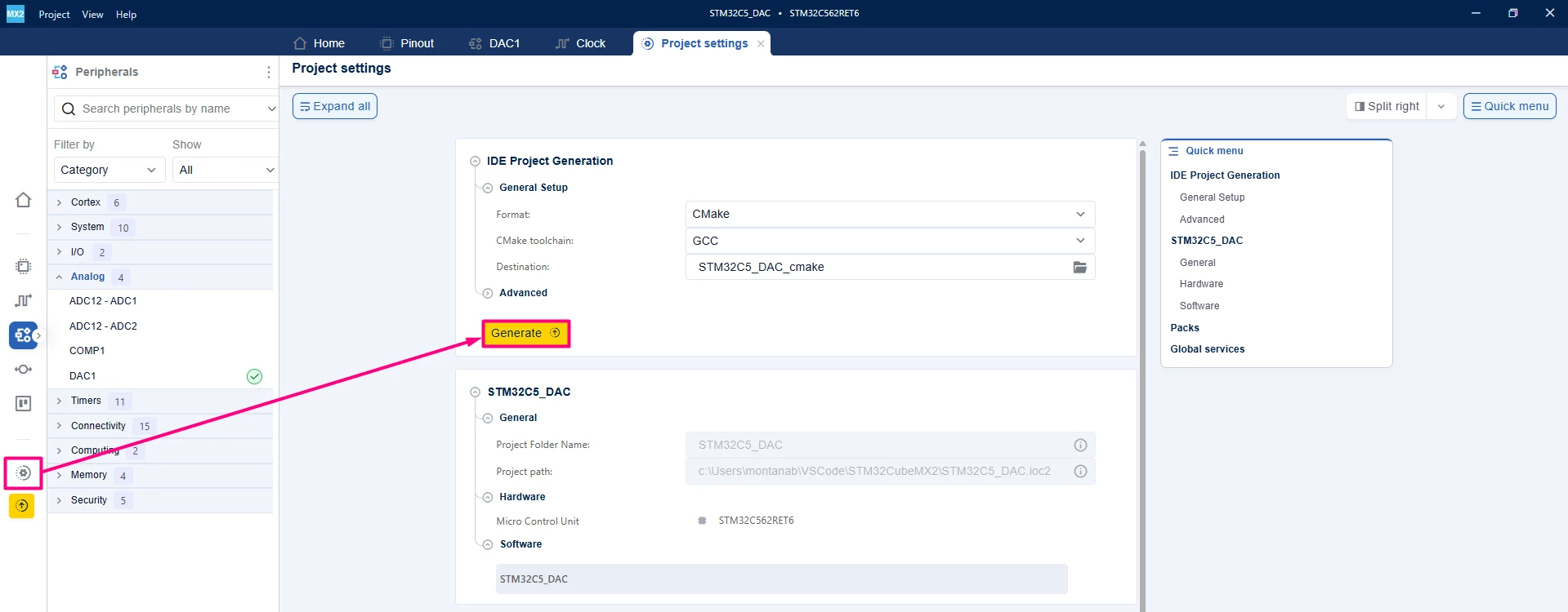

2.3 Project manager settings
  1. Go to Project Manager tab.
  2. Select your IDE (for example, CMake for STM32Cube for Visual Studio Code).
  3. Generate the project and open it in your IDE.

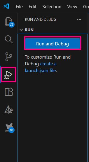

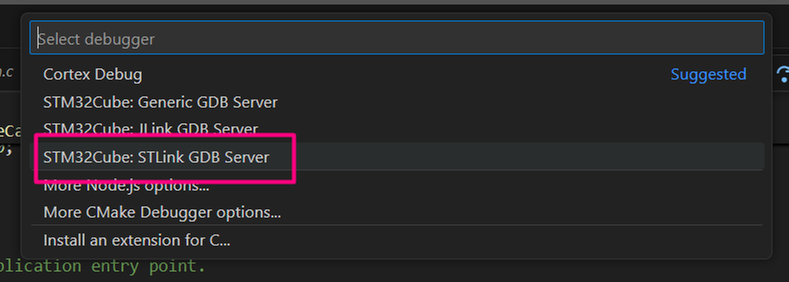

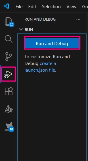

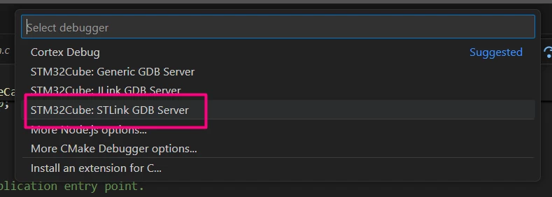

After building the application, locate the [Run and Debug] icon, create your debug session by selecting the STLINK GDB Server option:

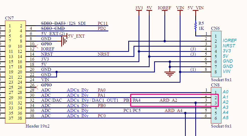

Locate the PA4 at CN8.3.

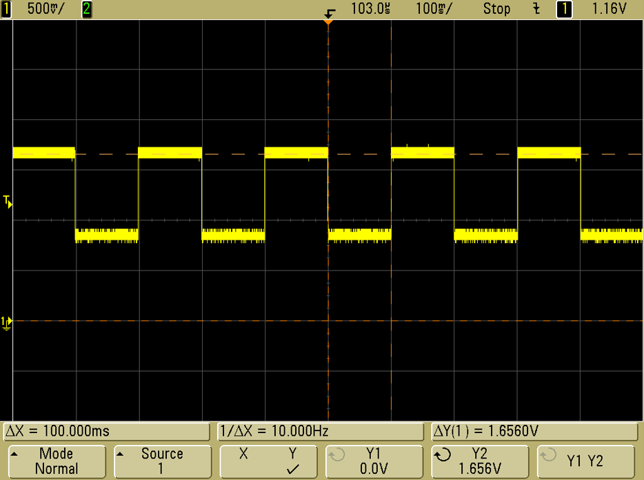

And connect a scope or similar to monitor the 100ms duration of around VDD/2 followed by 100ms of VDD/4.

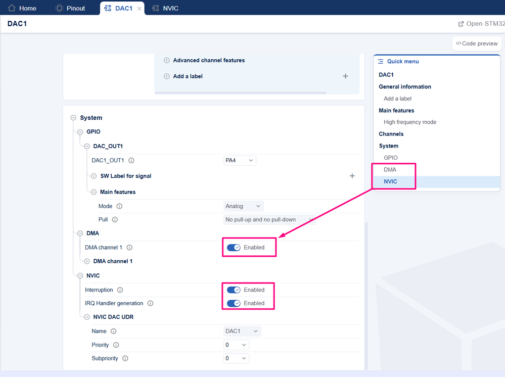

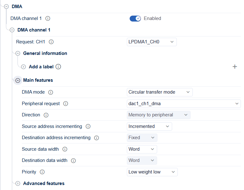

DMA mode is ideal for generating waveforms by continuously feeding DAC data from a buffer. To enable it, go back to STM32CubeMX2 and enable DMA and NVIC.
The default DMA settings should be set to Circular transfer mode, incrementing source address and word size.

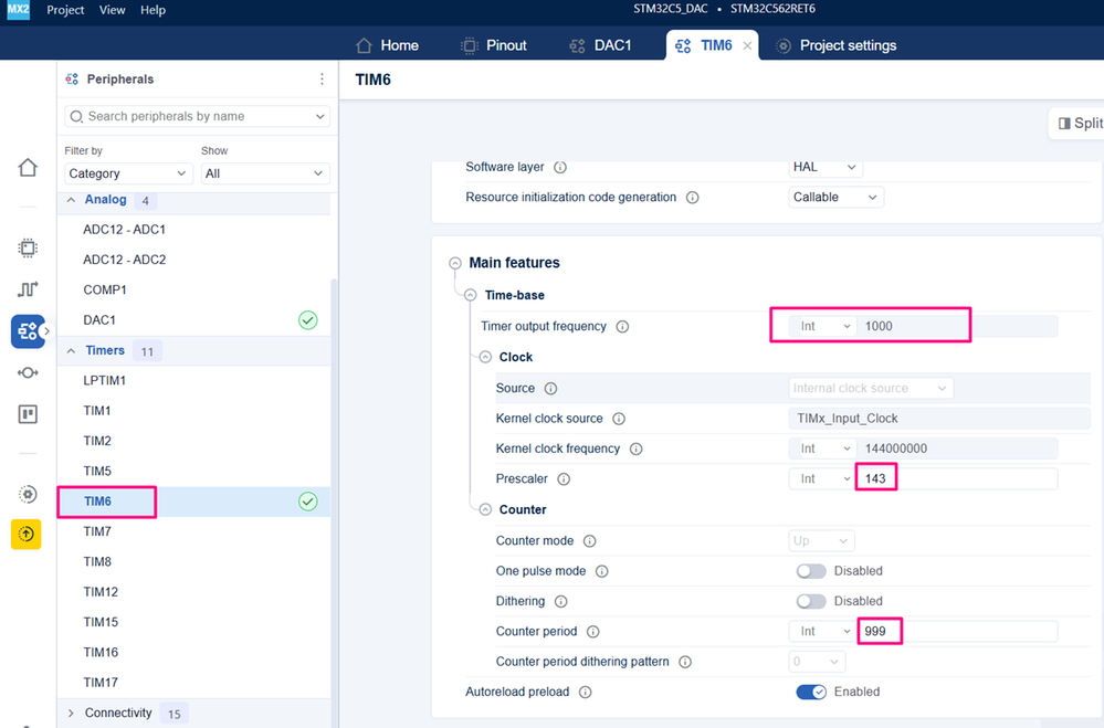

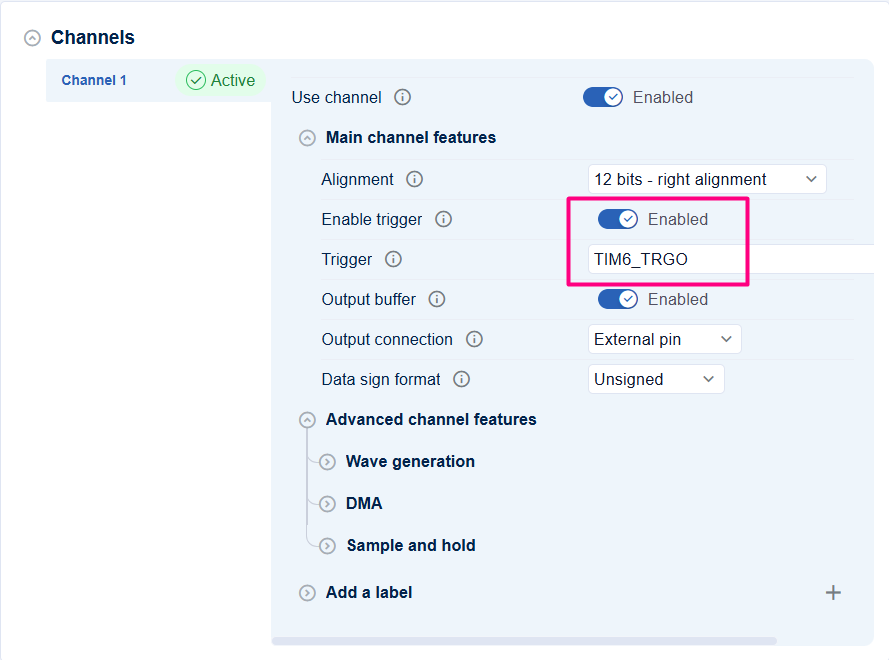

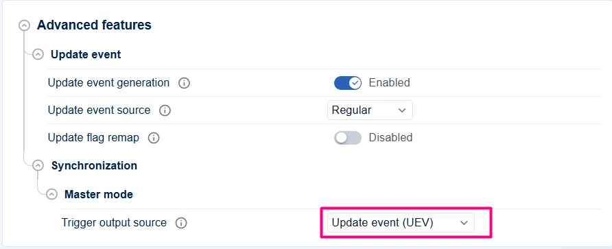

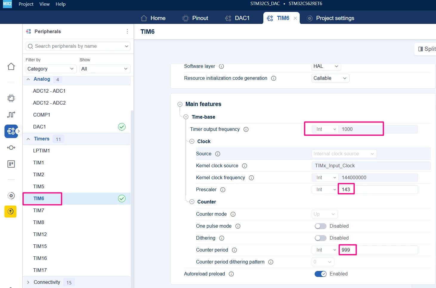

Add the trigger source for the DAC to be TIM6 based.

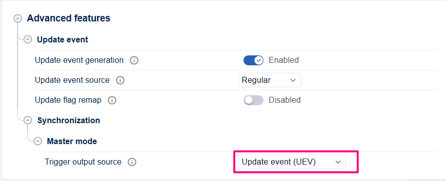

Configure TIM6 to be a 1 KHz frequency with the trigger output based on update.
Re-generate the code and make the following changes in main.c

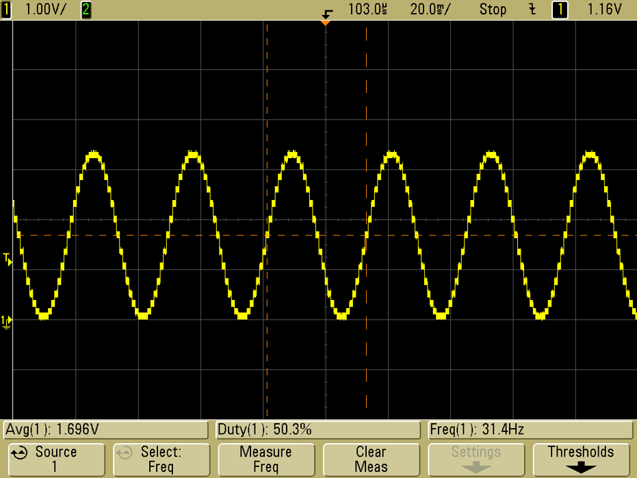

5.1 Validation
Running the code and connecting the DAC output in a scope or similar, it is possible to observe the wave form being shown, updating based on the TIM6 frequency.
