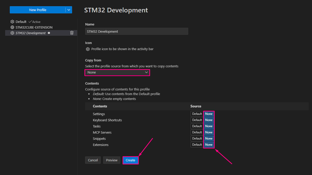

  • Type and select Profiles: New Profile…

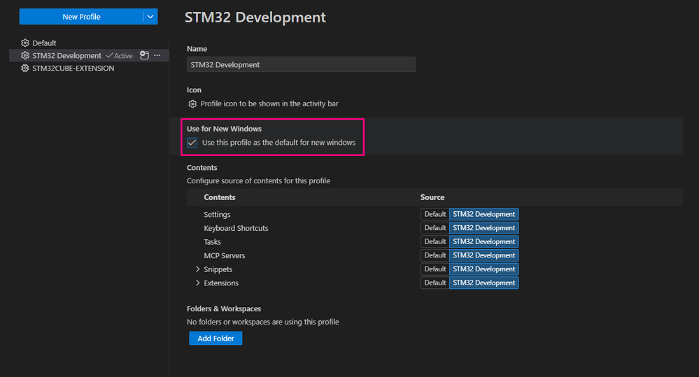

  • Enter a descriptive name, such as "STM32 Development".
  • For a clean profile, in "Copy from" and "Contents" select [None].
  • [Create] your new profile and set it as default for new windows.

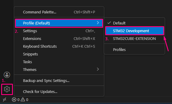

2. Switch to the new profile
  • After creation, VS Code will prompt you to switch to the new profile.
  • Confirm to switch immediately or switch later via the profile selector in the bottom-left corner of the VS Code window.

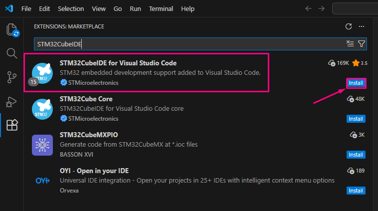

  • With the new profile active, install the STM32CubeIDE for Visual Studio Code extension and any other dependencies.
