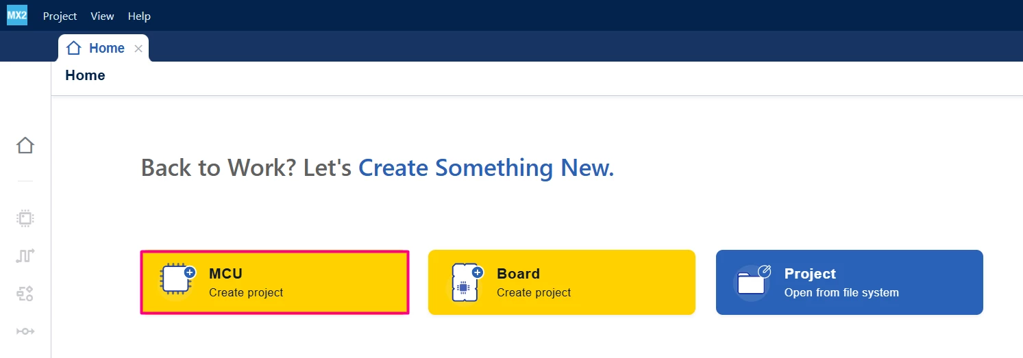

Open STM32CubeMX2. On the Home page, click the MCU square to create a new project.

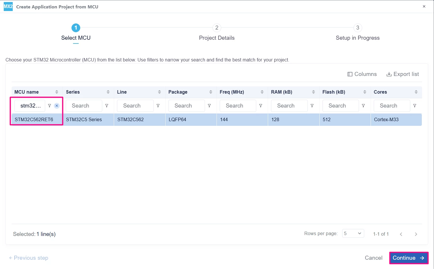

In the search field under MCU name, enter STM32C562RE and select the MCU. Click Continue.

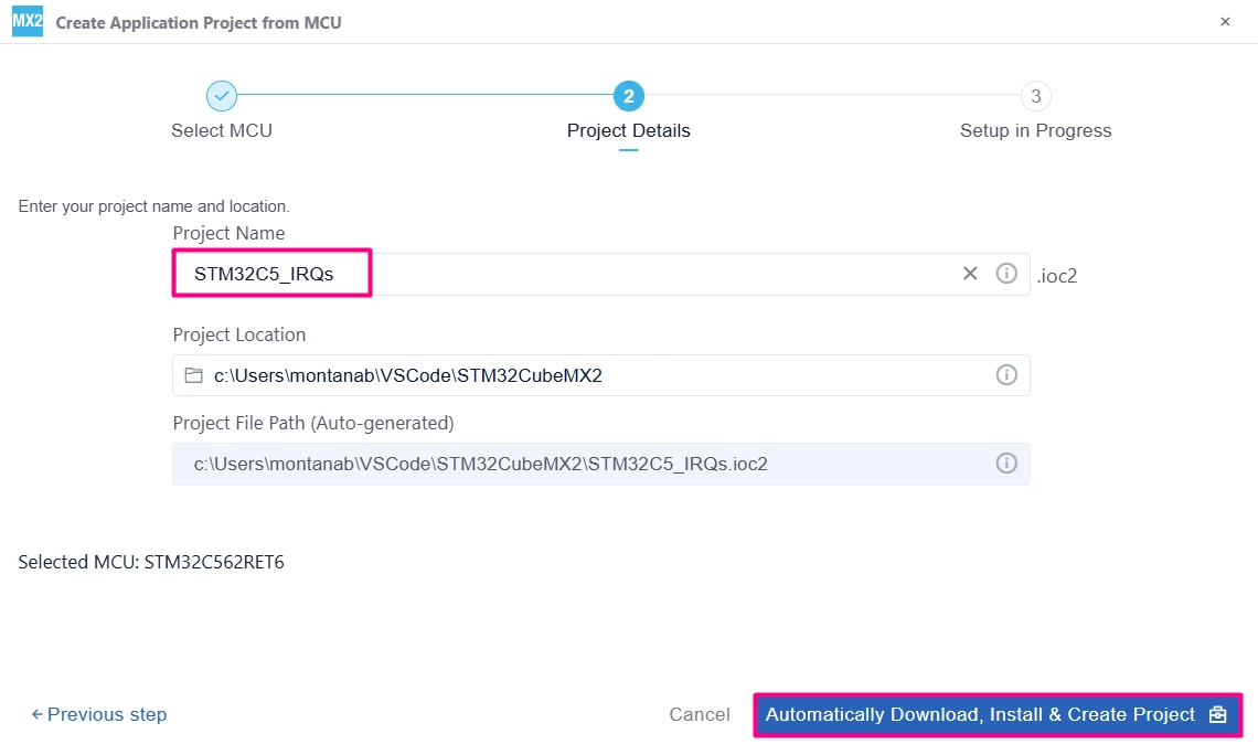

  • Set the Project Name and Project Location.
  • Continue with [Automatically Download, Install & Create Project].

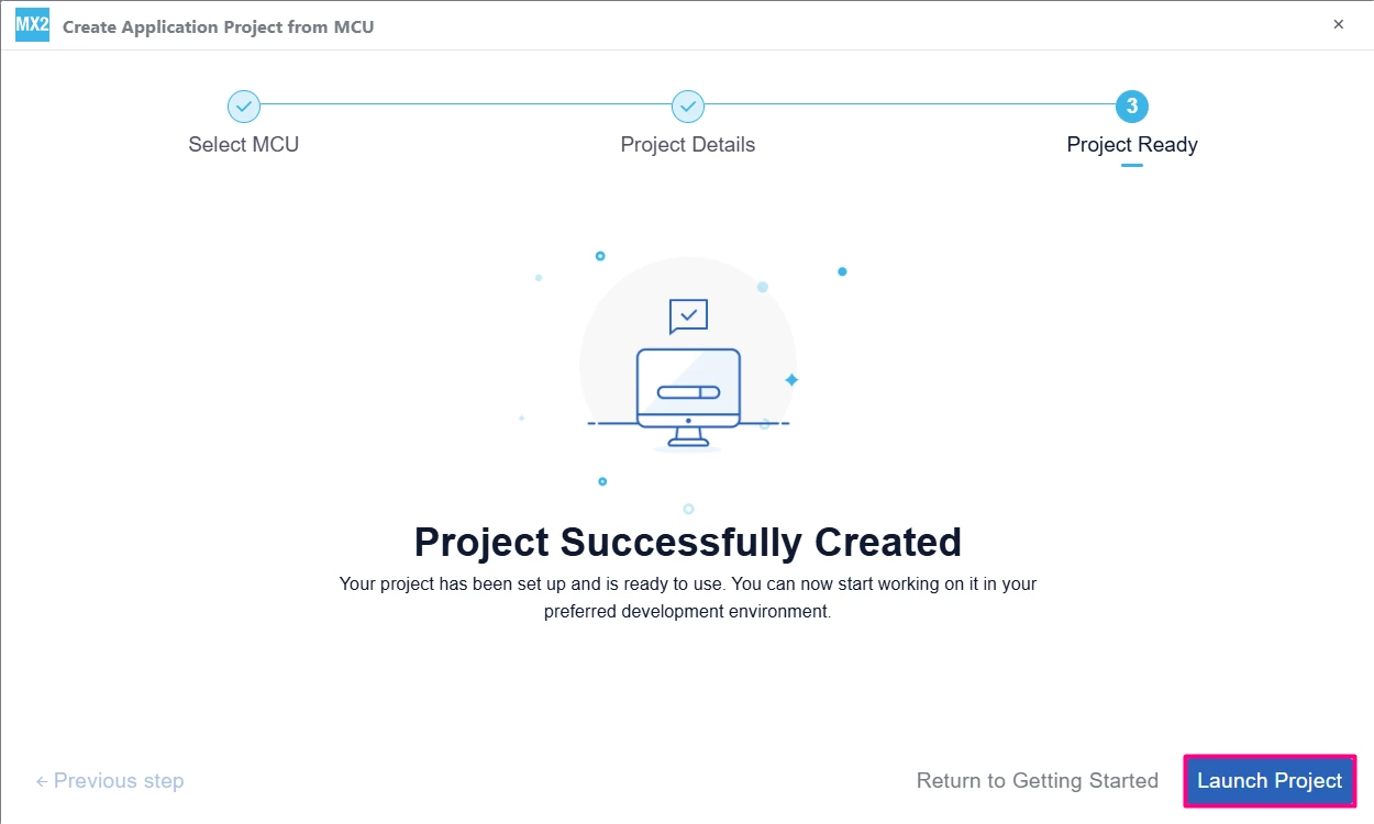

  • Select [Launch Project] to start.

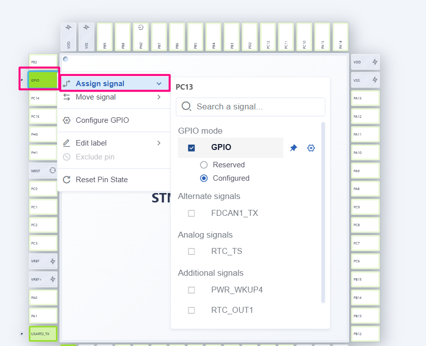

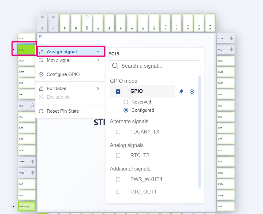

1.2 EXTI configuration
The PC13 is connected to the on-board push button. Click on the engine to configure the EXTI on that pin.

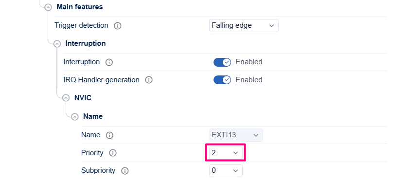

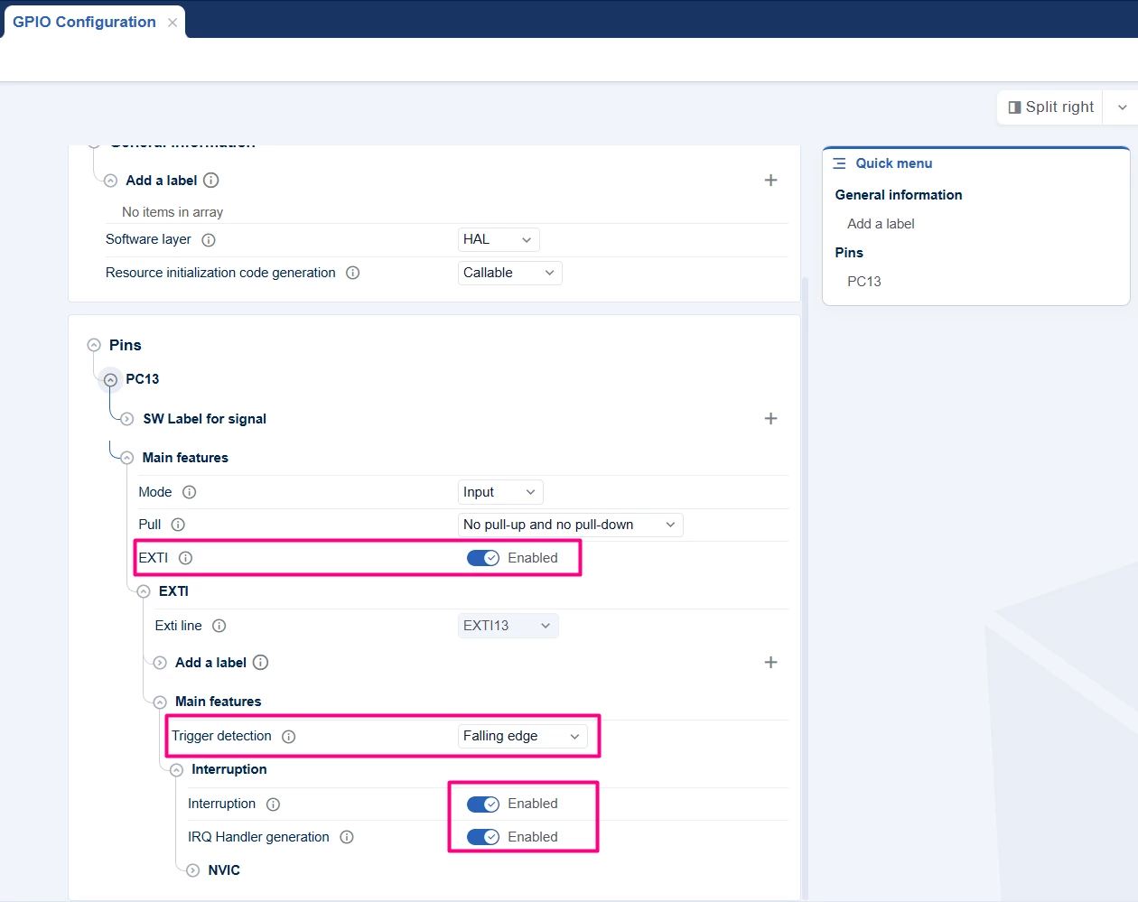

In the GPIO Configuration tab, add the EXTI for falling edge and enable the interrupt.
Expand the "NVIC" and change the [Priority] to 2.

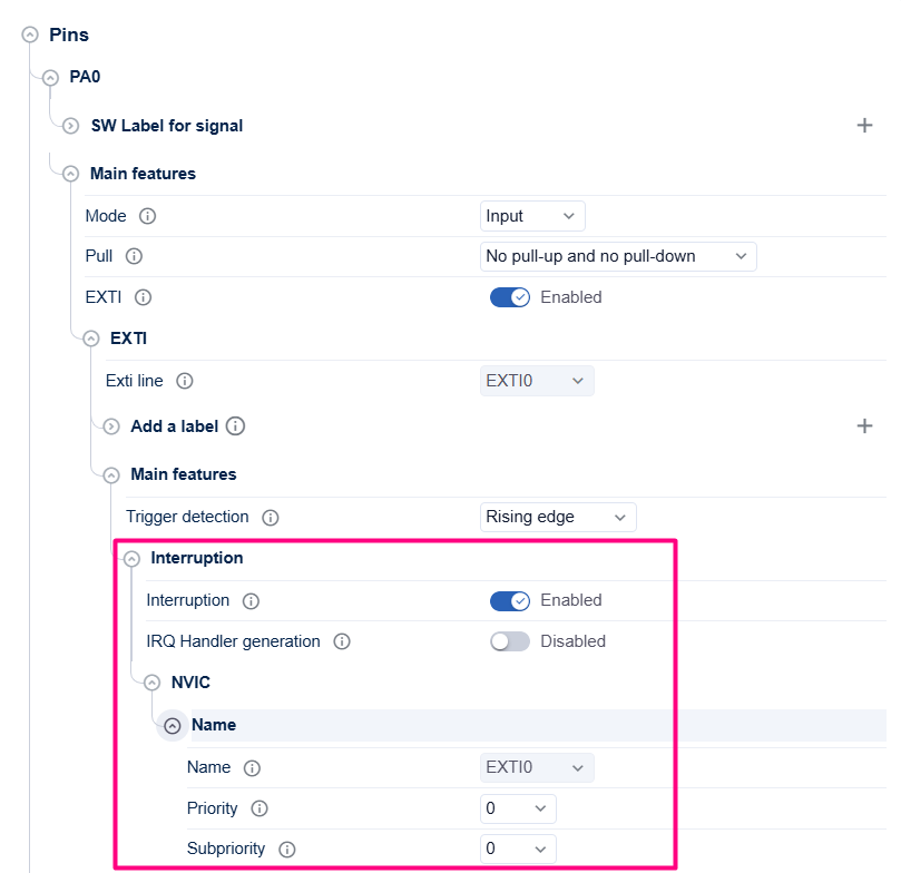

Perform the same actions for the pin PA0, however, do not enable [IRQ Handler generation] and maintain the NVIC [Priority as 0]. In Cortex®-M based systems, the greater the priority number, the less the execution priority of the interruption. This means that in this example, EXTI0 is of higher priority than EXTI13.

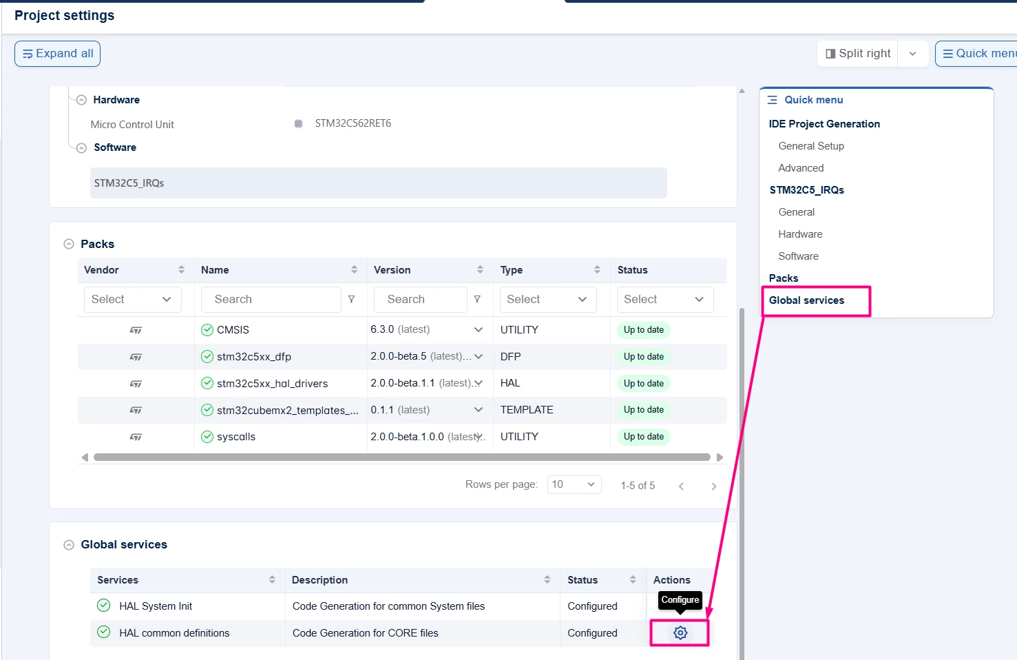

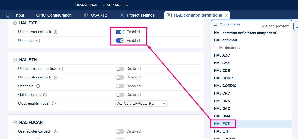

1.3 How to enable custom callbacks
To generate the custom IRQ callback handler in STM32CubeMX2, go to the "Project settings" tab, click in the Global services via Quick menu and then the gear on the Actions.
Use the quick menu to locate the EXTI and enable the Use register callback and User data.

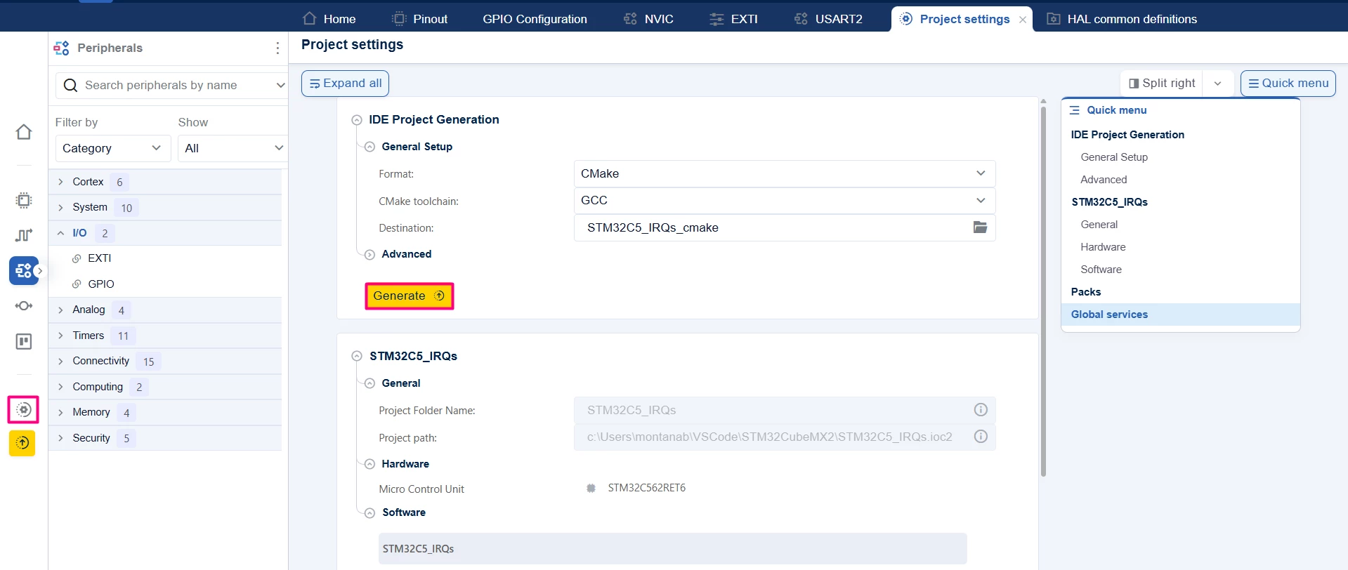

2. Generate code
To generate the code:
  1. Click on the [Project settings] icon and select the desired IDE.
  2. Click the [Generate] button.

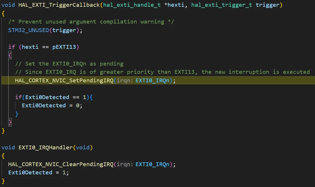

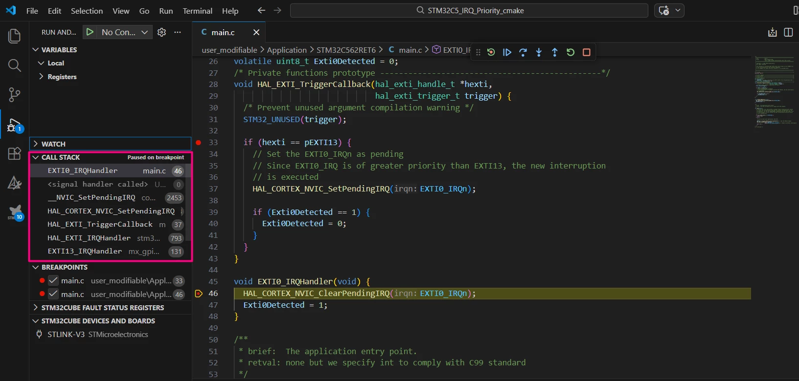

After generating the project in STM32CubeMX2 and opening the project in VS Code, we can use the following code to test how NVIC priority works.
The proposed example sets two interrupts:
  1. A button external interrupt (EXTI13) with priority 2
  2. A software interrupt in EXTI0 with a priority of 0

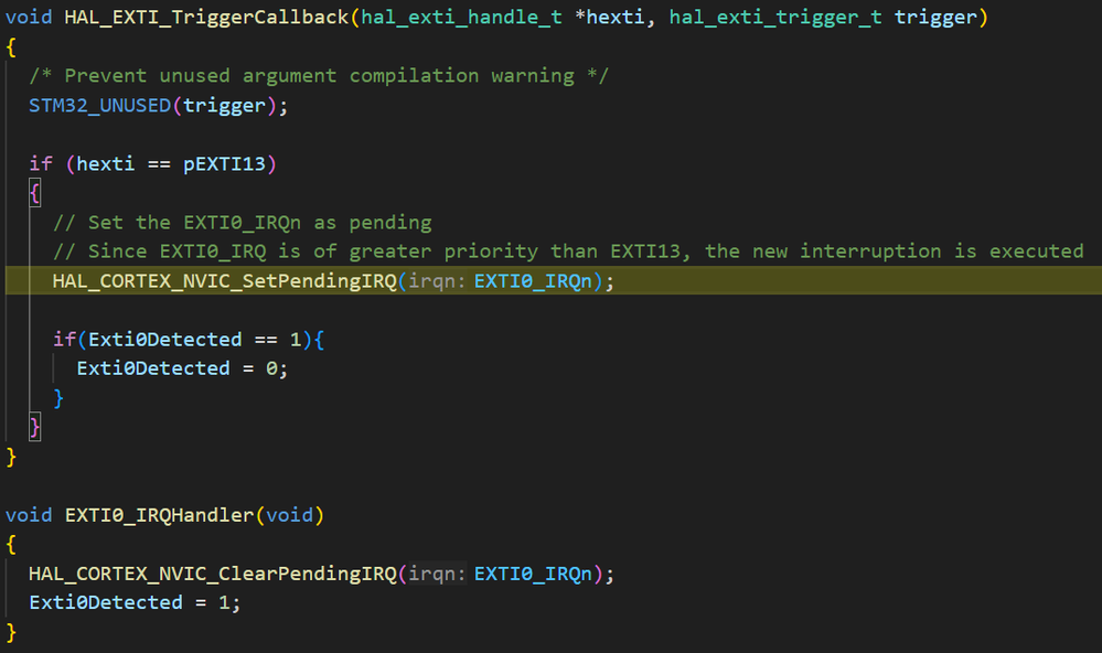

When the user button is pressed, the EXTI13 interrupt is called, inside the callback function a command will force EXTI0 to become pending. Since EXTI0 has a higher priority than EXTI13, EXTI0 is called and, after being served, the context is restored and EXTI13 is completed.

 if (hexti == pEXTI13) {
 // Set the EXTI0_IRQn as pending
 // Since EXTI0_IRQ is of greater priority than EXTI13, the new interruption
 // is executed
 HAL_CORTEX_NVIC_SetPendingIRQ(EXTI0_IRQn);
 if (Exti0Detected == 1) {
 Exti0Detected = 0;
void EXTI0_IRQHandler(void) {
 HAL_CORTEX_NVIC_ClearPendingIRQ(EXTI0_IRQn);
 Exti0Detected = 1;

5. Validation
Build the project and start a debug session. The code should run without errors or warnings. It is recommended to set breakpoints inside the HAL_EXTI_TriggerCallback function before the pending interrupt command and after it, inside the EXTI0_IRQHandler function to visualize the execution flow.
After the user button is pressed, the EXTI callback is triggered, as shown in the screenshot below.

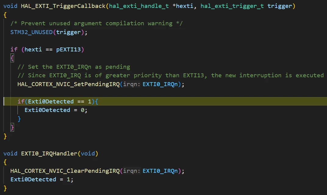

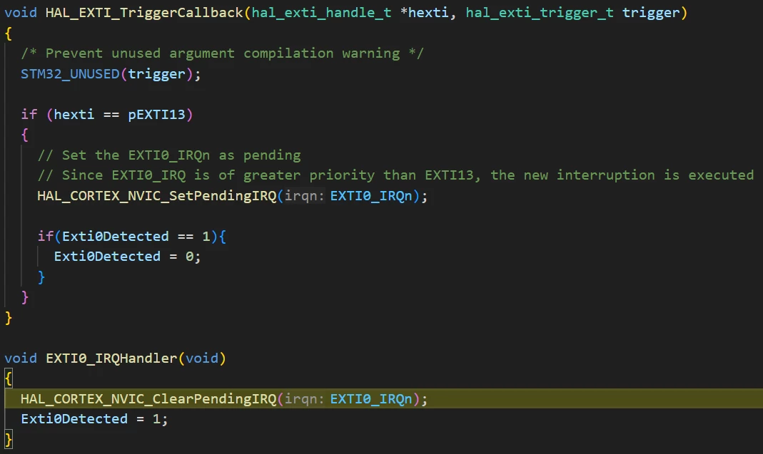

After the NVIC function sets the interrupt from EXTI0 as pending, the program immediately switches context for the EXTI_IRQHandler function.
After the EXTI0 interrupt finishes executing, the program restores the previous context to the EXTI13 callback in the point where it stopped and continues execution as normal.
The call stack gives a clear view of the events order.
