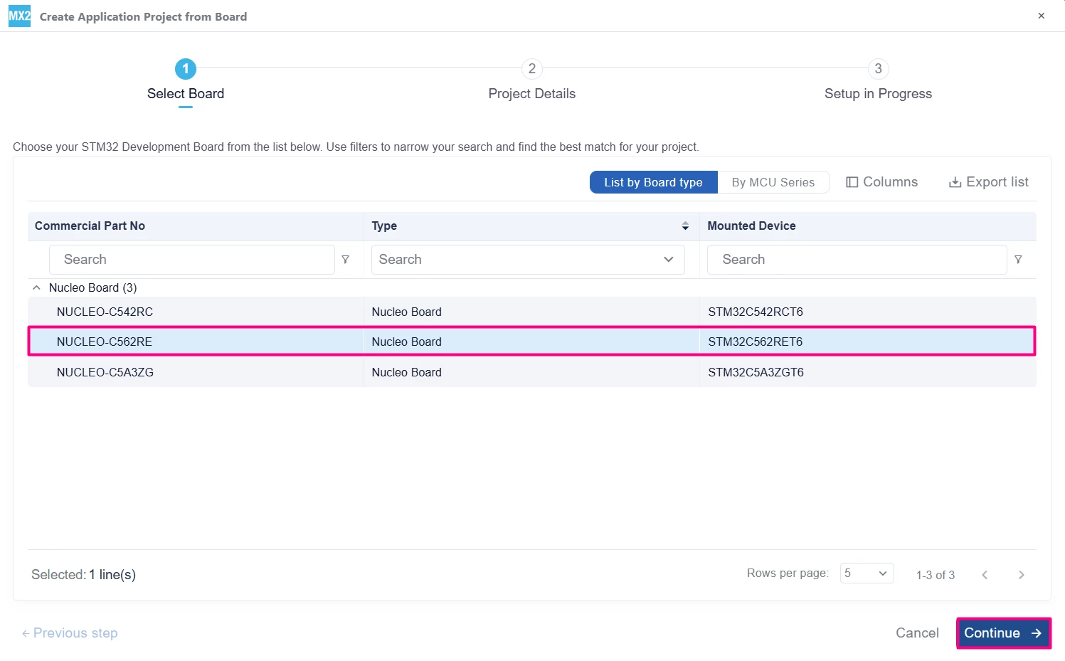

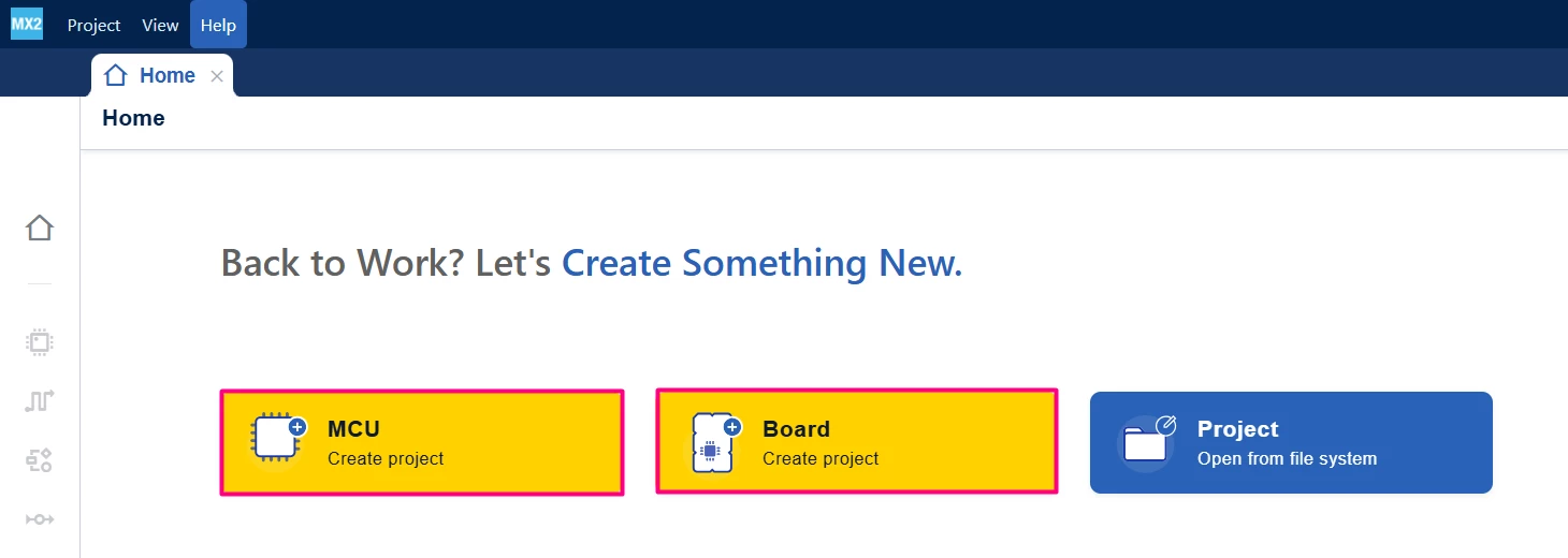

  • Launch STM32CubeMX2.
  • Select your target STM32 microcontroller or development board from the list.
  • Confirm the selection to proceed to the project configuration.

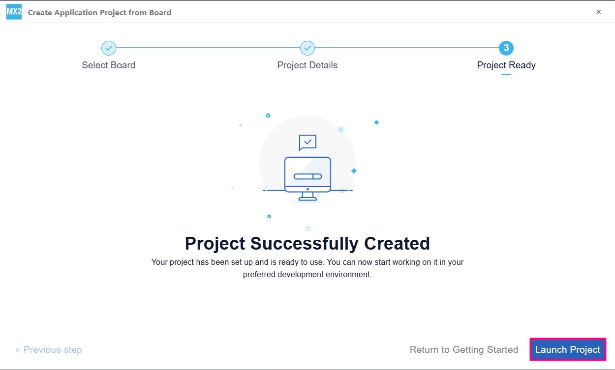

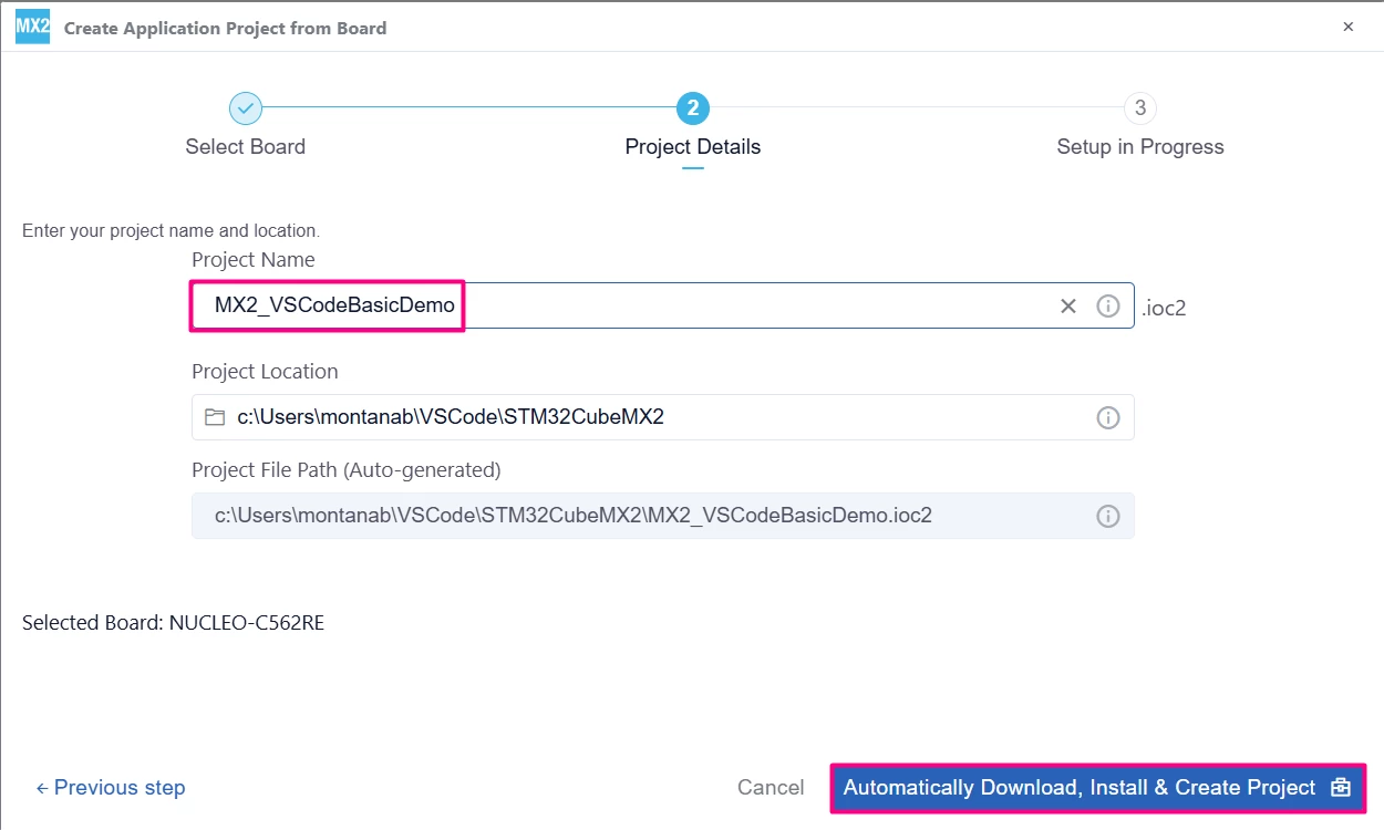

  • Set the Project Name and Project Location.
  • Continue with [Automatically Download, Install & Create Project].
  • Select [Launch Project] to start.

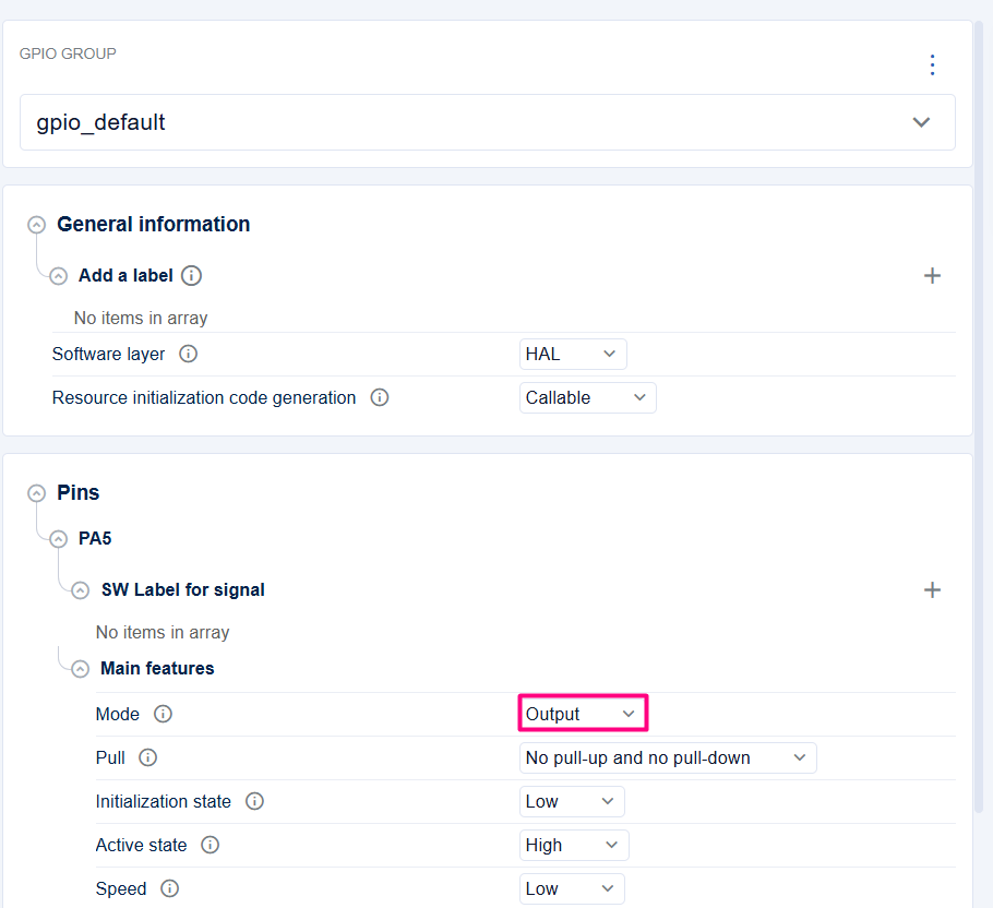

1.1 Configuring peripherals and pins

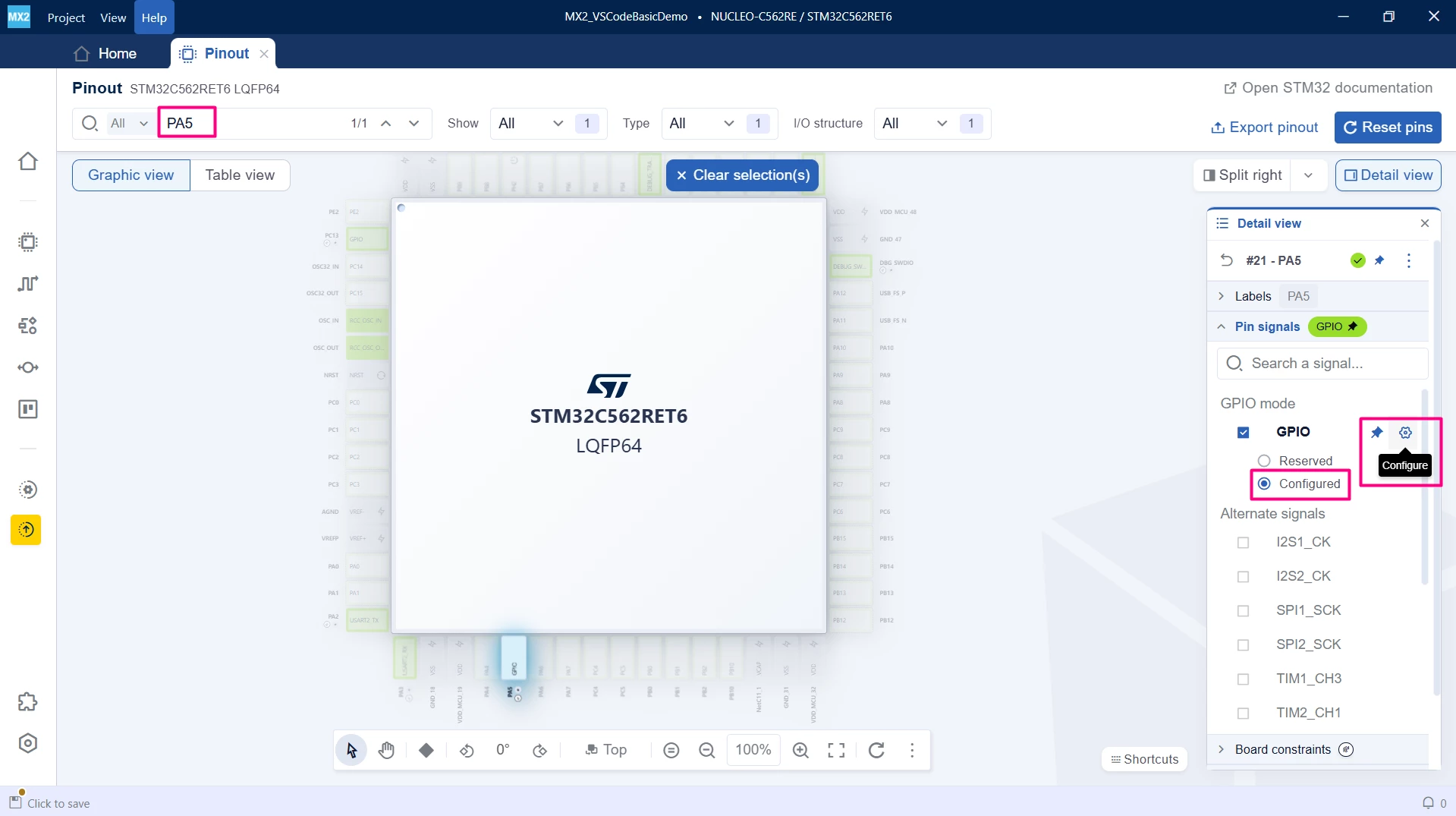

  • Use the "Pinout" tab to configure the pins you use in your application. For example, to create a simple LED blink application on the [NUCLEO-C562RE] board, configure PA5 as a GPIO output, which corresponds to the user LED.

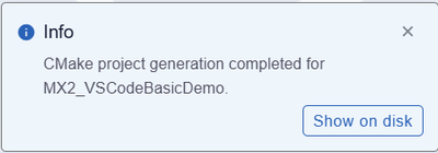

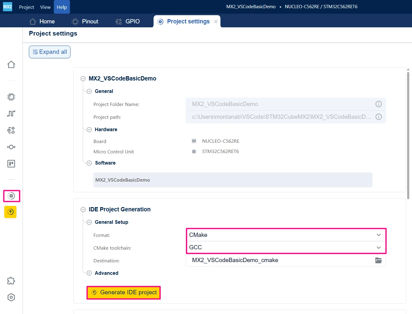

1.2 Setting the format for VS Code
  • In the [Project Settings] → [IDE Project Generation] → [General Setup] section.
  • Ensure the Format is set to [CMake] and the CMake toolchain is set to [GCC].
  • [Generate] the project.
STM32CubeMX2 generates the source code, header files, and essential build configuration files such as CMakeLists.txt.
These files are structured to be compatible with VS Code and the STM32CubeIDE extension.

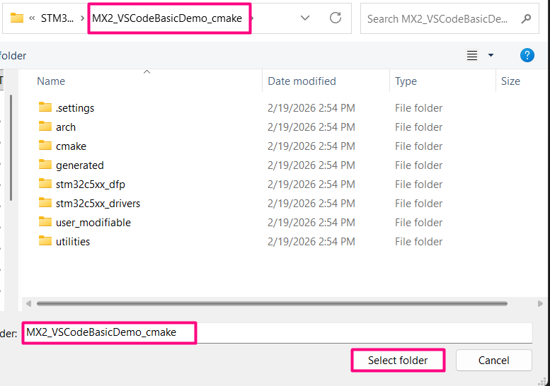

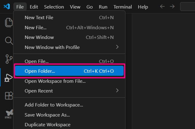

  • Launch Visual Studio Code.
  • Select [Open Folder...].
  • Browse to and select the root folder of your generated STM32CubeMX2 project.
  • Click [Select folder] to load the project into VS Code.

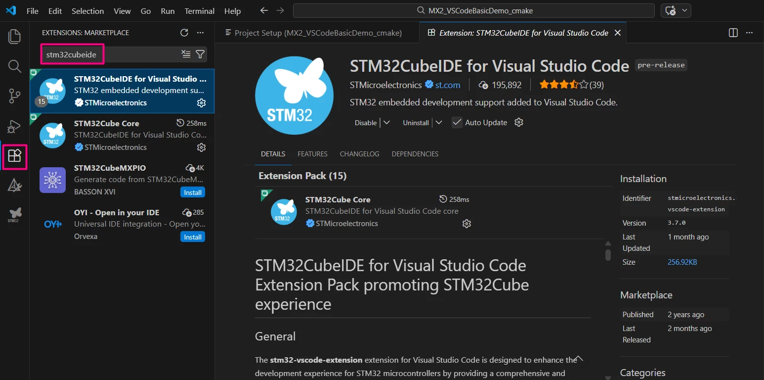

Ensuring required extensions are installed
Verify that the STM32CubeIDE extension pack and CMake Tools extension are installed and enabled in VS Code.
Installing the STM32CubeIDE for Visual Studio Code extension pack automatically installs all necessary dependencies and related extensions required for STM32 development, simplifying setup.
To manage these extensions and maintain a clean development environment, consider creating a dedicated VS Code profile for MX2 projects.

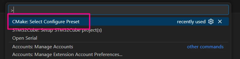

Upon opening the project, VS Code detects the presence of CMakeLists.txt files and prompts you to configure the build environment. To set up the build configuration, you can use commands accessed via the Command Palette.
To open the Command Palette, press Ctrl+Shift+P (Windows/Linux) or Cmd+Shift+P (macOS). This allows you to run commands by typing their names.
Select Configure Preset
Type and select [CMake: Select Configure Preset]. This command lets you choose a predefined build configuration preset.

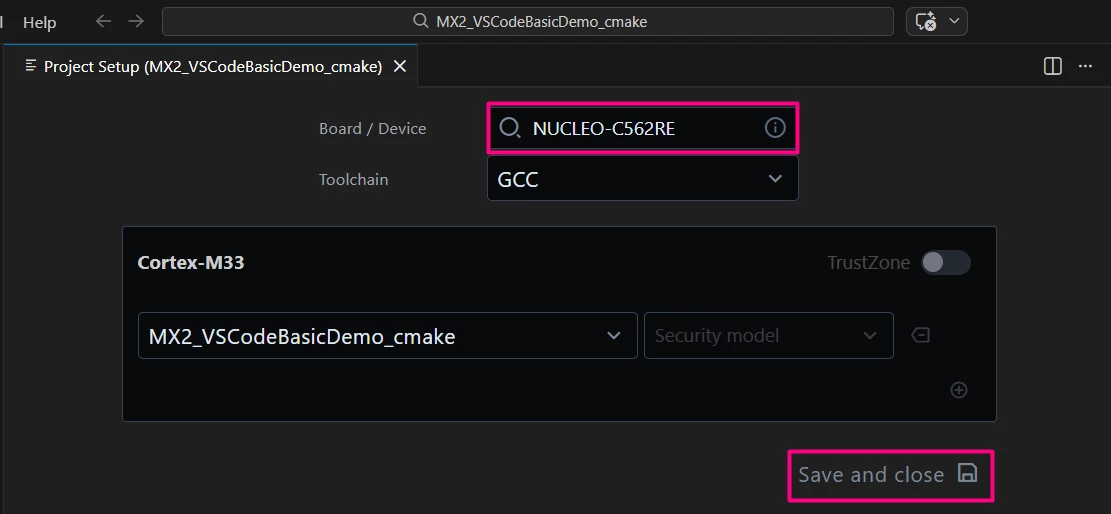

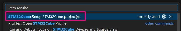

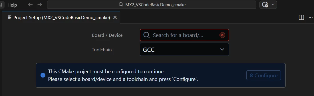

Set up the STM32Cube project:
Next, run the [STM32Cube: Setup STM32Cube project(s)] command from the Command Palette. This opens a configuration tab where you select the target Board/Device and Toolchain for your project.
Modify the options according to your project, then [Save and close] to apply these settings.
Completing these steps configures the CMake Tools and STM32CubeIDE extensions to build and debug your STM32CubeMX2 project with the correct toolchain and device settings.

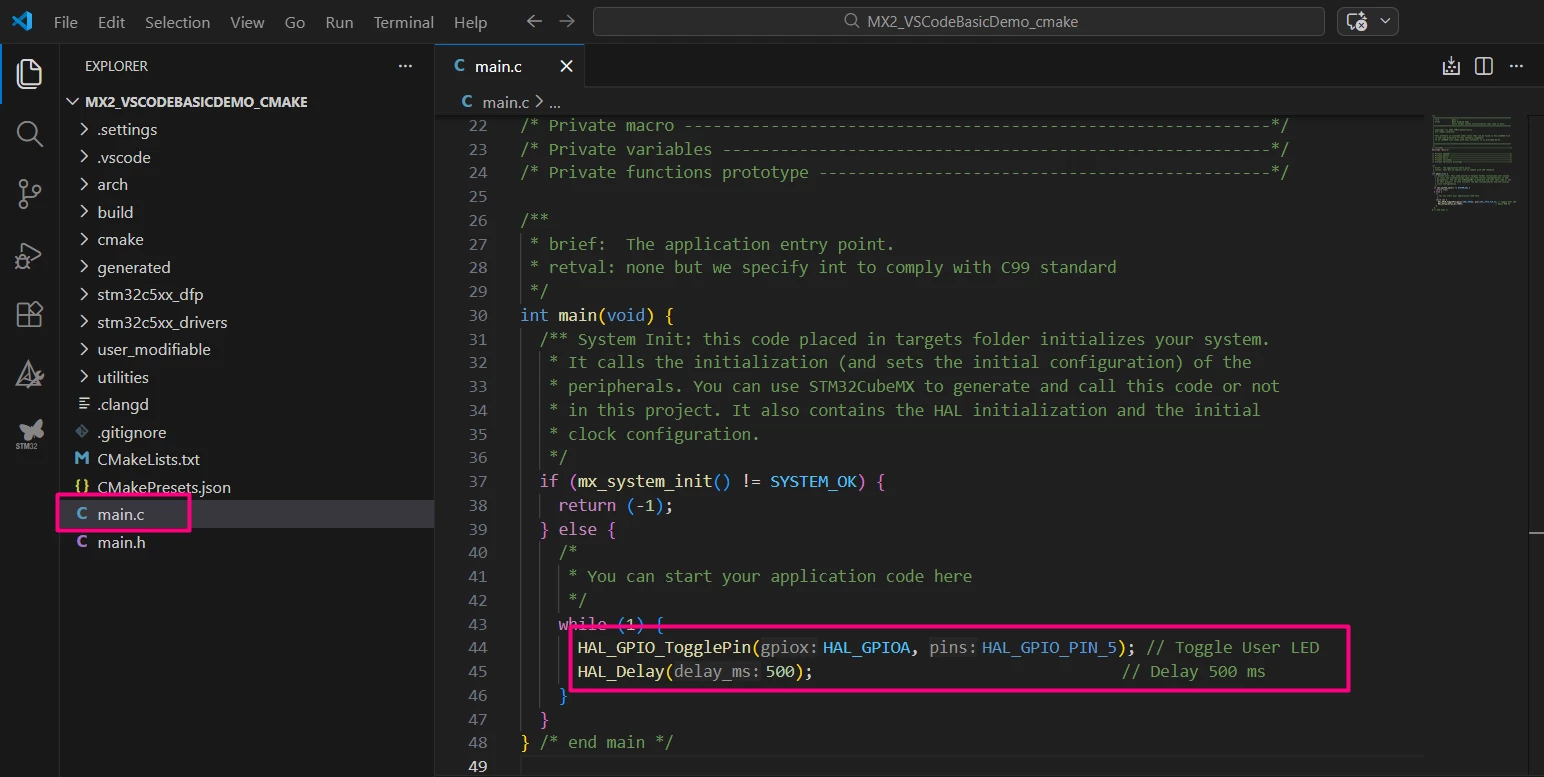

Add a simple LED toggle code:
Before building, for this example, let us add a simple LED toggle implementation to verify the setup. Open the main.c file and add the following code inside the while (1) loop to toggle the user LED (PA5).
while (1) {
 HAL_GPIO_TogglePin(HAL_GPIOA, HAL_GPIO_PIN_5); // Toggle User LED
 HAL_Delay(500); // Delay 500 ms

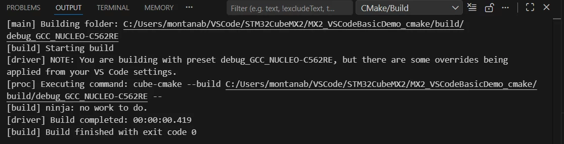

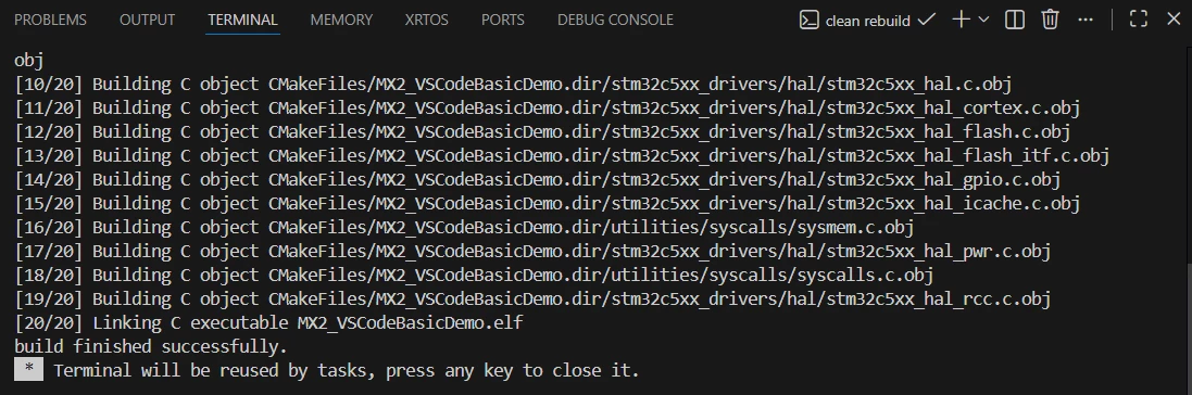

Build the project:
Press Ctrl+Shift+B to trigger the default build task, or open the Command Palette (Ctrl+Shift+P / Cmd+Shift+P) and run [CMake: Build] or press F7.
The build output appears in the terminal panel, showing compilation progress and any errors or warnings.
  • Clean and rebuild
To do a clean build, use CMake: Clean Rebuild from the Command Palette. This removes previous build artifacts before rebuilding the project.
BMontanari_19-1771525749888.pngBuild configuration files:
The build process uses the CMakeLists.txt files generated by STM32CubeMX2, ensuring all source files and dependencies are correctly included.

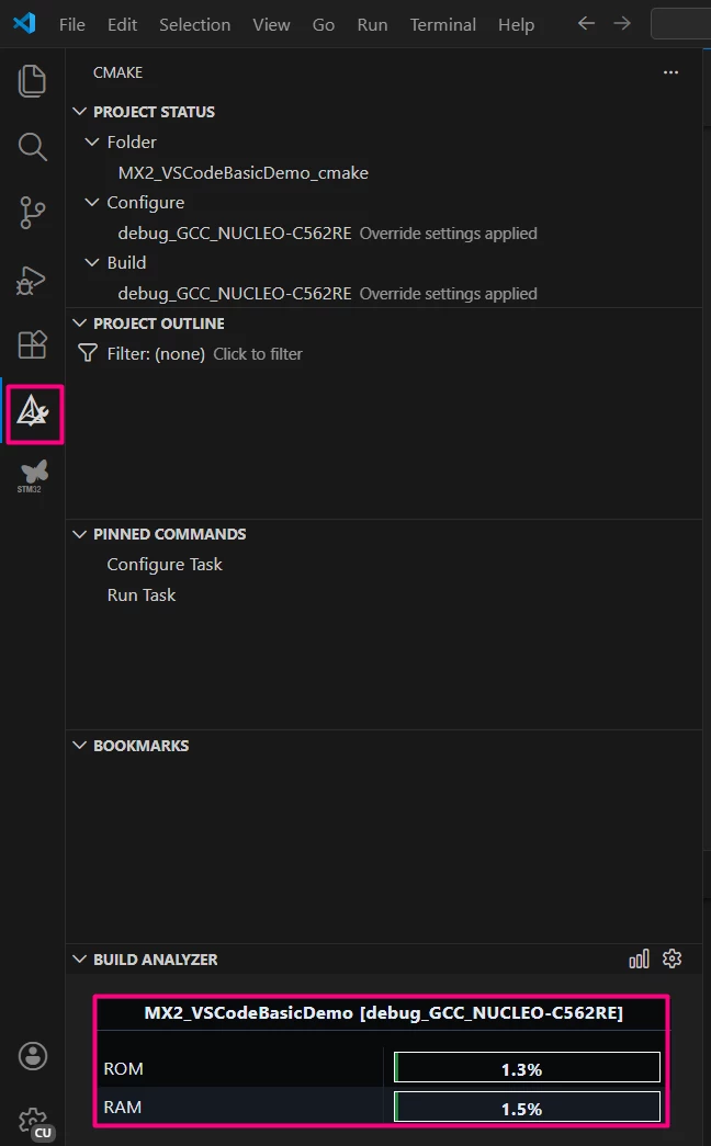

Select the build target:
Use the CMake Tools extension project status bar at the left of the VS Code window to select the targets for Build, Debug and Launch and check the Build Analyzer.

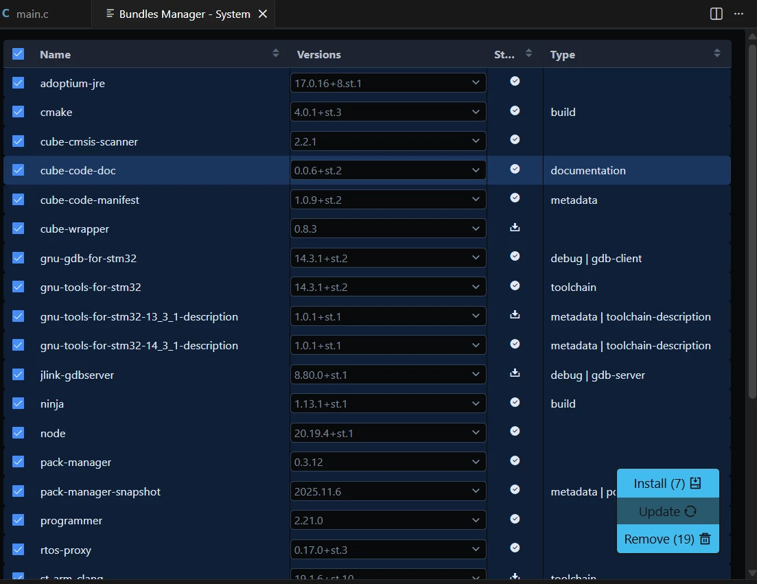

Check bundle updates
Ensure that your project bundles are up to date by checking the [Bundles Manager] section provided by the STM32Cube Extension. Keeping bundles updated guarantees compatibility and access to the latest debugging features.
Open the Command Palette (Ctrl+Shift+P / Cmd+Shift+P) and run [STM32Cube: Open System Bundles Manager].

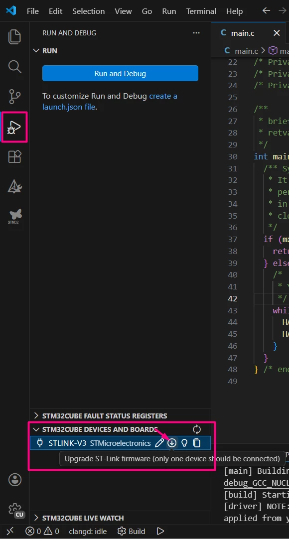

Connect your STM32 board to your PC using the STLINK or compatible debug interface. Verify if the drivers and firmware are up to date for reliable communication.

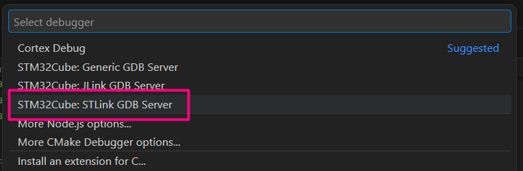

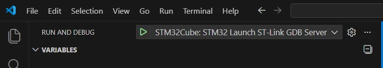

Select the debug configuration:

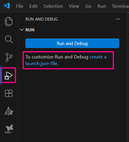

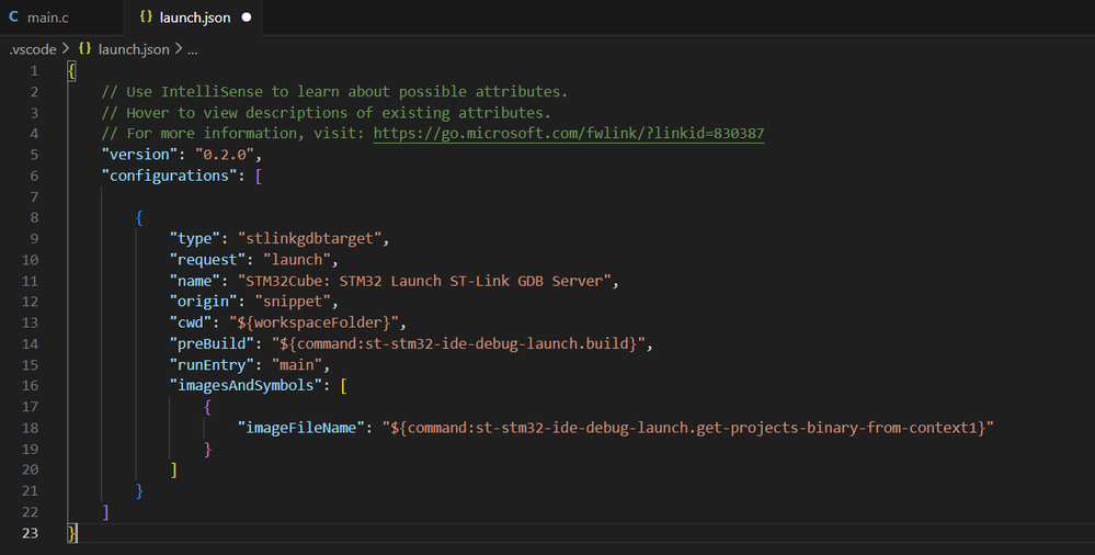

Open the Run and Debug panel (Ctrl+Shift+D).
Create a new debug configuration by clicking create a launch.json file.
Select [STM32Cube: STLink GDB Server] or the appropriate debug environment provided by the STM32CubeIDE extension.

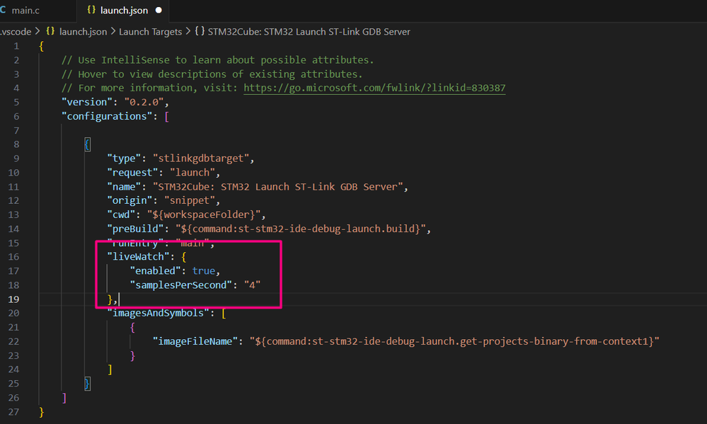

This generates a launch.json file configured for your STM32 project, enabling seamless debugging integration.

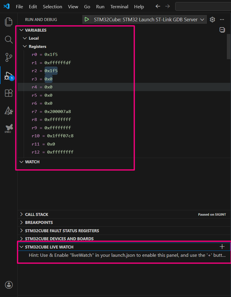

Pro tip: add live watch by simply adding the following line in the json:
You can customize the launch.json to specify debug parameters such as executable paths, server loaders, and SVD files as well.

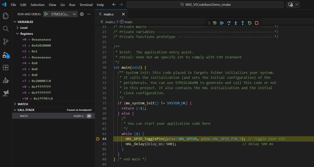

Start the debug session:
Press (F5) or click the green [Start Debugging] button. VS Code launches the debugger, program the device, and halts at the reset vector or the first breakpoint.

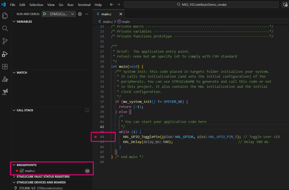

Set breakpoints:
Click in the gutter next to the code lines where you want execution to pause. This allows inspection of variables and program flow.
Step through code:
Use the debugging toolbar to:
  • Step Over (F10) to execute the next line without entering functions.
  • Step Into (F11) to dive into function calls.
  • Step Out (Shift+F11) to exit the current function.

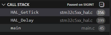

View call stack:
The call stack panel shows the sequence of function calls leading to the current execution point, aiding in debugging complex flows.
Inspect variables:
Use the Variables and Watch panels to monitor the values of variables and expressions during execution.

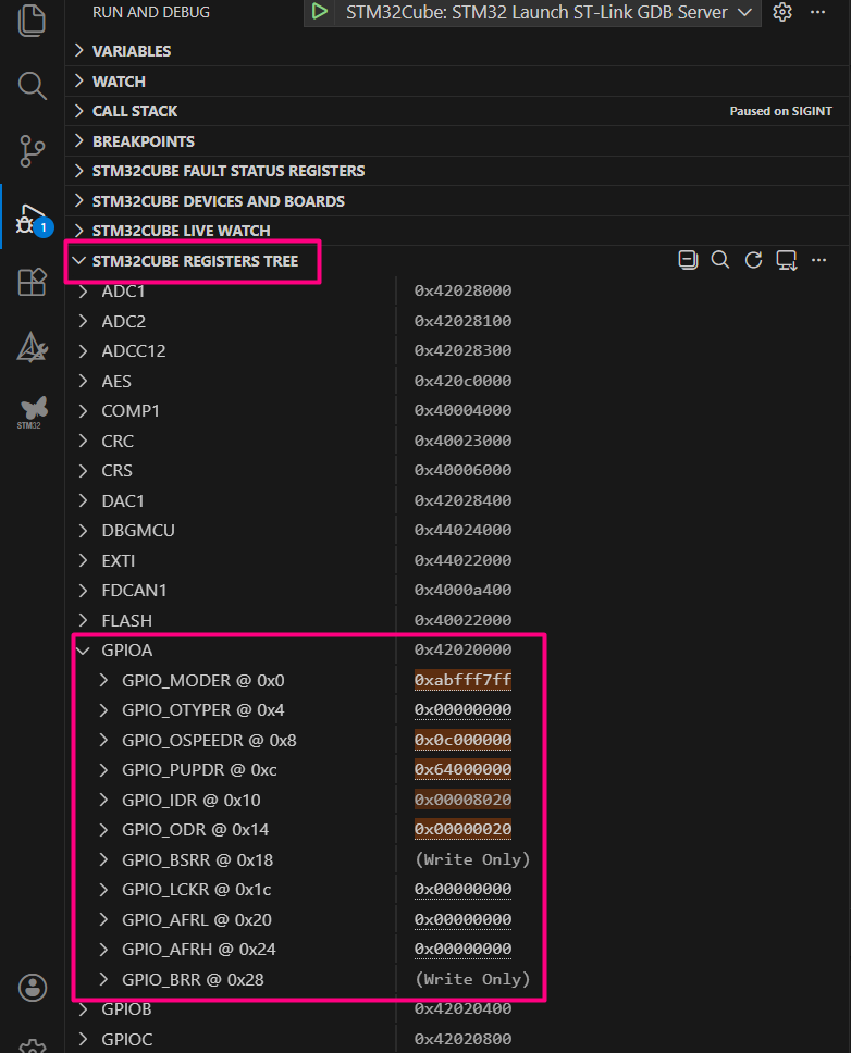

Inspect registers:
The Registers’ view allows low-level inspection and modification of CPU registers if needed.

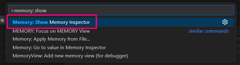

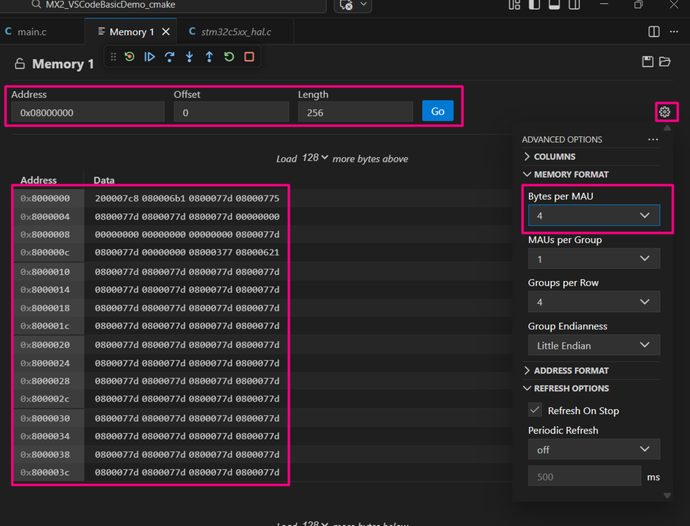

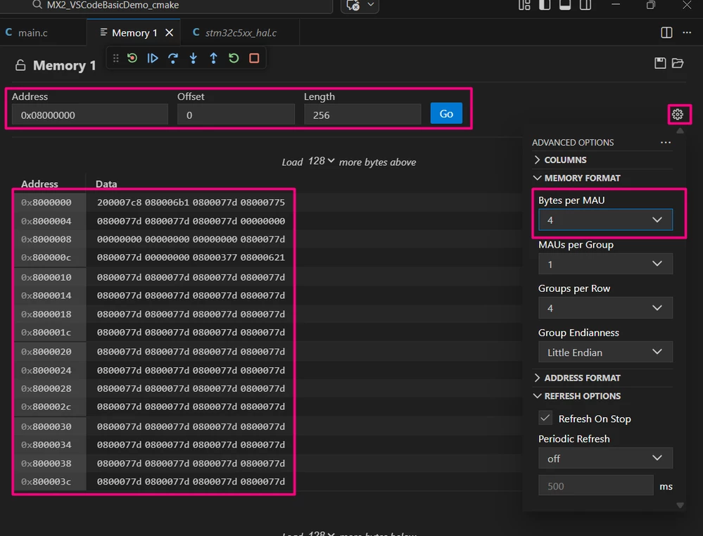

Inspect memory:
To inspect memory contents, use the Memory Inspector extension provided by Eclipse CDT Cloud.
Open the Command Palette (Ctrl+Shift+P / Cmd+Shift+P), run the command Memory: Show Memory Inspector, and enter the desired memory address to view its contents.

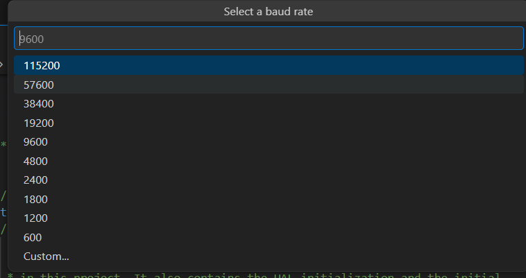

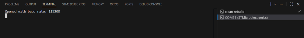

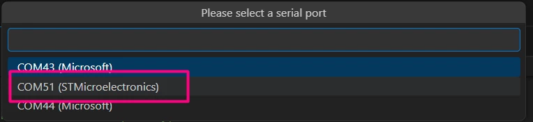

Serial monitor:
For serial communication, the Serial Monitor extension (also from Eclipse CDT Cloud) can be used.
Open the Command Palette and run the command [Open serial] to launch the serial monitor.
When opening the serial monitor, you will need to configure the COM port and baud rate to match your serial communication settings.

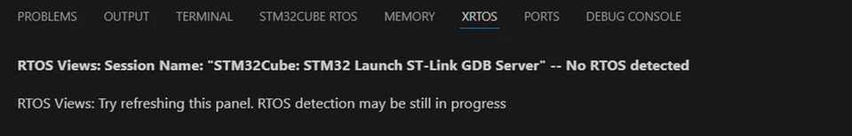

RTOS debugging (if applicable):
If your project uses FreeRTOS™ or other RTOS middleware, the STM32CubeIDE extension supports RTOS-aware debugging.
Open the RTOS view to monitor task states, priorities, and stacks in real time.
