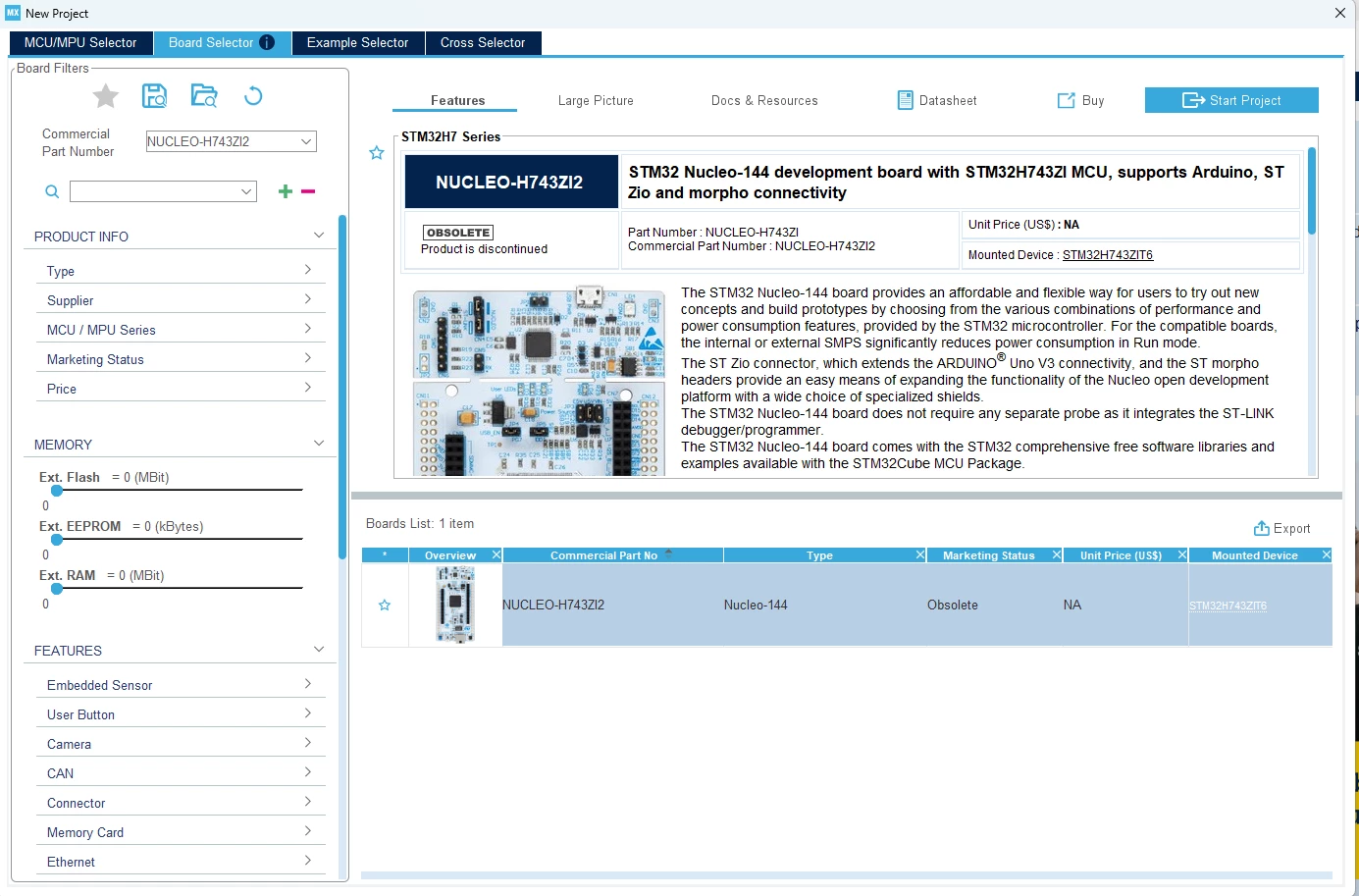

Start by creating a new project using the STM32CubeMX by clicking [file -> New -> STM32 Project]. Use the [Board Selector] tab and select the [NUCLEO-H743ZI2]

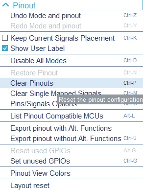

Once the project creation is done, press [Pinout → Clear pinouts].

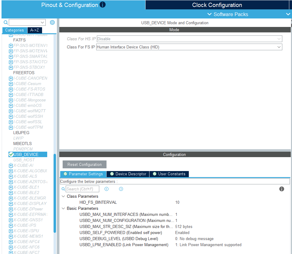

Select [Human Interface Device Class (HID)] in the class for FS IP in [USB_DEVICE] under "Middleware and Software Packs].

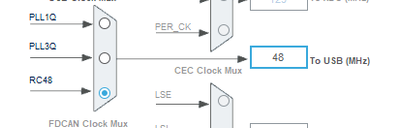

In "clock configuration", ensure that USB is receiving 48 MHz.

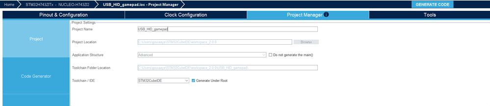

Select a name for your project and click the [Generate Code] button.

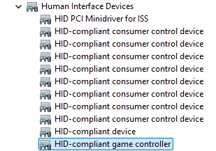

After flashing the code, you can open Device manager or any other tool, and you will see that your STM32 enumerated as a game controller
