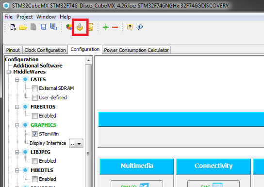

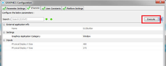

In the configuration tab click on GRAPHICS
Click on the Execute button to launch the GUIDesigner

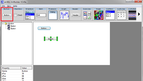

Add 2 buttons by clicking twice on the dedicated item in the list of widgets
Close the GUIDesigner and re-generate the project by clicking on the button hilighted below

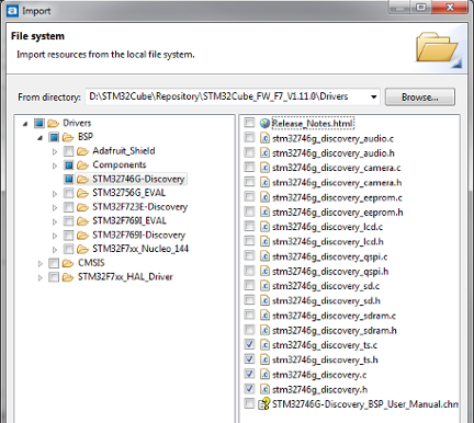

2. Import Touch drivers (low-level, BSP interface and HAL interface)

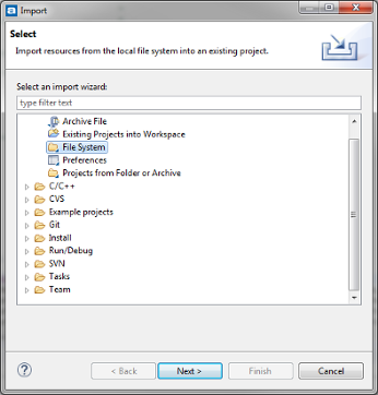

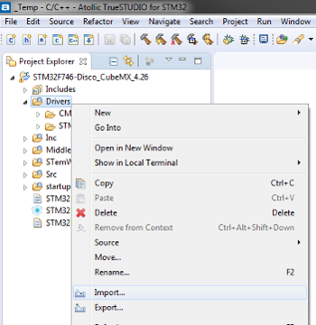

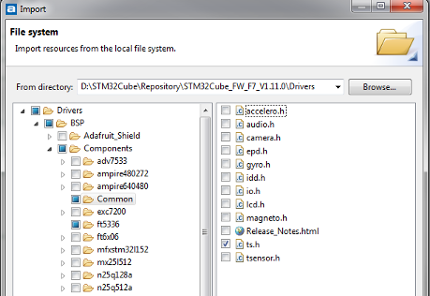

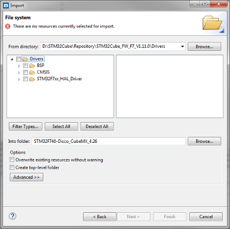

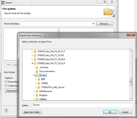

Import the generated project in Atollic TrueStudio, right-click on the Drivers folder and select Import
Select File System
Select the Drivers folder as the base folder and click OK

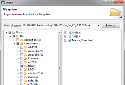

From this dialog box we will select all the required files
First the low-level touch driver ft5336.c/h
Then a higher level interface in the Common folder
The BSP driver common files and touch dedicated

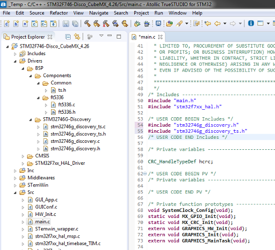

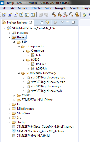

Then click Finish to actually import the files, you should now have the following structure in your Atollic project

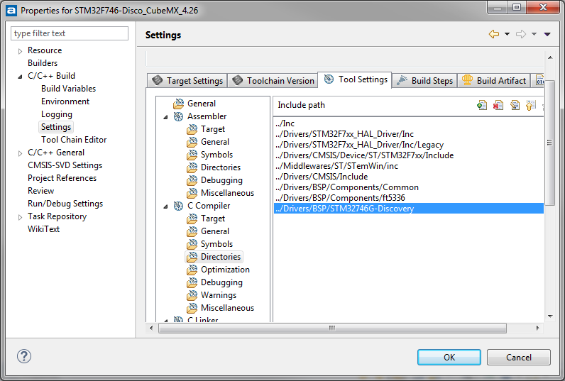

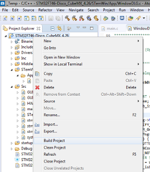

3. Update Include files search path
Since some include files have been imported you must add their parent folder in the include folder list.

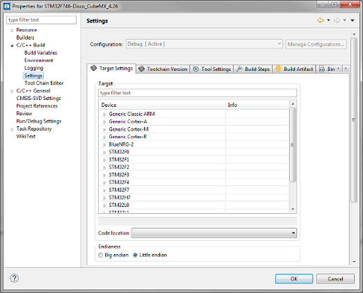

Open project properties and go to C/C++ Build -> Settings
Then go to Tool Settings tab and C Compiler->Directories section
add the new folders containing include files:
../Drivers/BSP/Components/Common
../Drivers/BSP/Components/ft5336
../Drivers/BSP/STM32746G-Discovery
Open the ./src/main.c file and #include directives (between the USER tags) as below

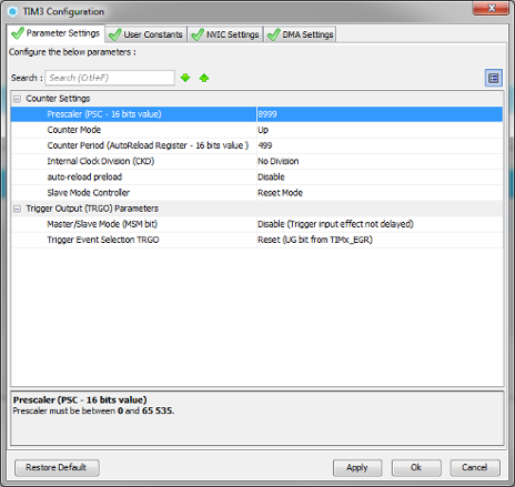

Configure TIM3 as follow (expiration every 1 ms)
and enable the interrupt

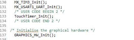

Initialize the touch screen and timer so that on each expiration the touch status is retrieved (polling mode)
  • In main.c file in USER CODE BEGIN/END PFP section add the declaration below:
  • In main.c file in USER CODE BEGIN/END 2 section add the call below:

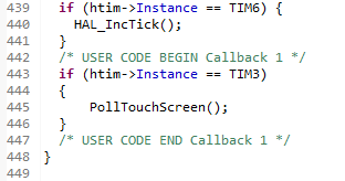

  • In main.c file in HAL_TIM_PeriodElapsedCallback USER CODE BEGIN/END Callback 1 section add

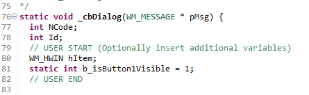

First declare some variables
  • In WindoDLG.c file in cbDialog function in USER START/END Callback 1 section add696.png

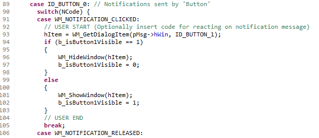

  • In WindoDLG.c file in cbDialog function, case ID_BUTTON_0 and case WM_NOTIFICATION_CLICKED in USER START/END section add697.png

Touching the Button 0 (top left corner of the screen) will hide the second button, clicking it again will make the second button appear again !
