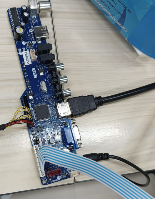

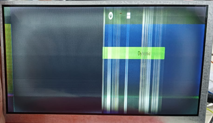

Hello Everyone!! right now I'm working LCD - TFT LVDS display (MDT0700E3IH-LVDS) I cannot get proper output there is an some issue. Please, anyone give me a solution

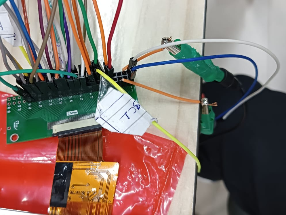

Can you show us the expected picture? Colors are same? LVDS clock pair frequency vs pixel clock? Is it single or dual link 5 or 10 differential pairs (24 bit RGB), single or dual pixel per clock? DE signal and timing is important for display. Differential pair should use twisted wires per pair to reduce data and signal noise.
Thankyou for your response

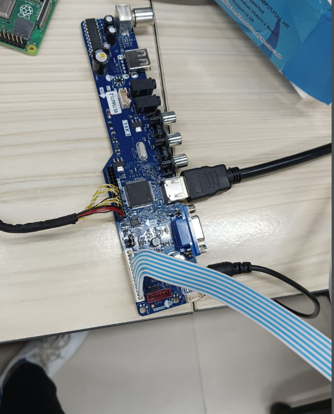

we are not using STM32 board we are working on LCD TV board((MDT0700E3IH-LVDS)
I am sharing you the board image with an attachment given below
Can you explain What is the procedure of the differential pair should use twisted wires per pair to reduce data and signal noise?
