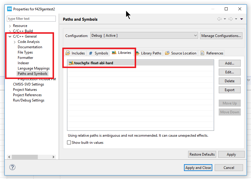

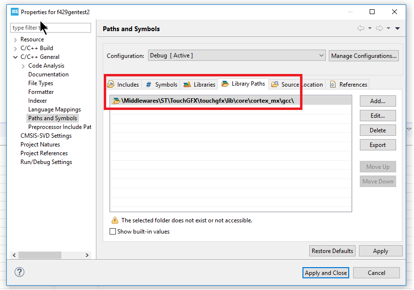

KMunj
​Thanks, Martin.
I don't know how to do #7. Is there any sticky for following how to do this?
  1. The library settings are wrong. Include the touchgfx library in MCU G++ Linker\Libraries:
    1. Libraries (-I): touchgfx-float-abi-hard
    2. Libraries search path (-L): \Middlewares\ST\TouchGFX\touchgfx\lib\core\cortex_mx\gcc\
Thanks.
-Kiran
Hi @KMunj​,
I'll update the description to be more concise - Here's a few screenshots of how to do this:
