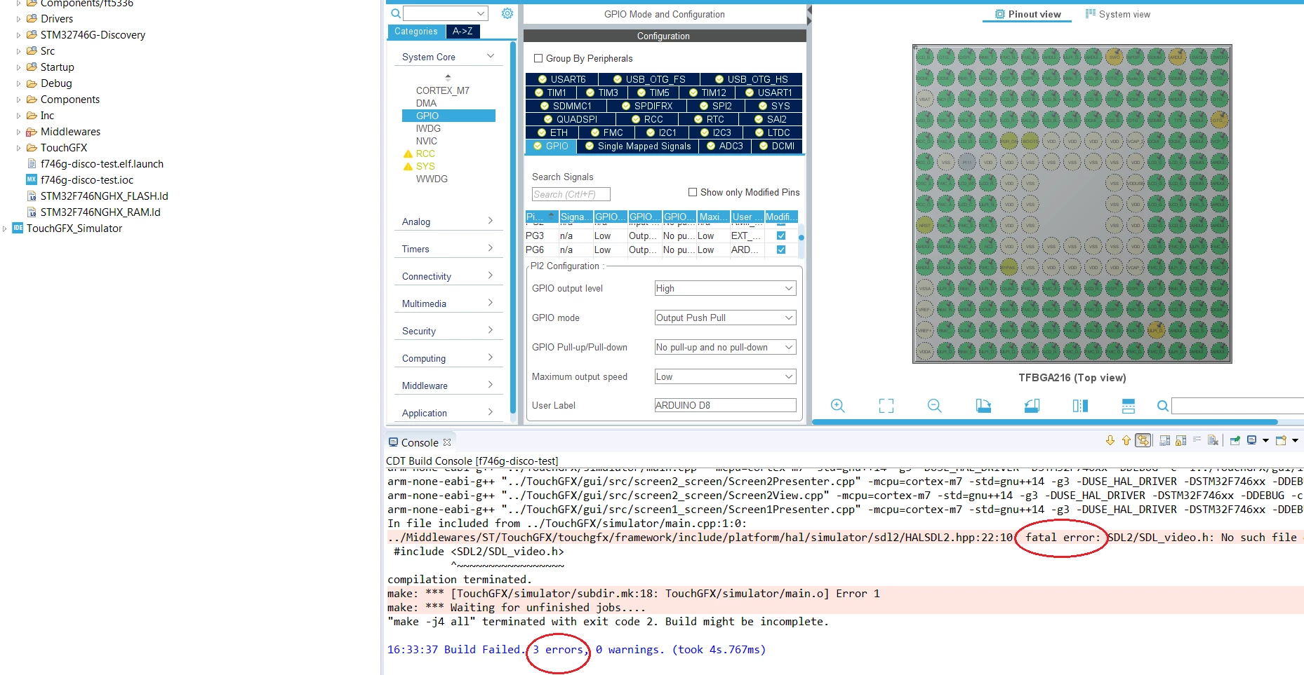

KMunj
KMunjAuthor
May 28, 2019 11:53 PM UTC
​Hi Martin,
Thank you very much for doing this. You did an excellent job. I started with your project. I changed your GUI with my GUI and every thing worked perfectly. Then I opened .ioc file and changed PI2 output from Low to High. Then I build the project again. But I got errors. Please see attached. Then I did clean project and build it again. Then I still got the build errors. Any idea why? I need to make few changes to few GPIOs in my set up.
Also please update your sticky at your convince at;
https://community.st.com/s/question/0D50X0000AqD8zPSQS/stm32cubeide-and-touchgfx-4100-a-brief-introduction
Thank you very much.
KIran
Martin KJELDSEN
Principal III
May 29, 2019 6:52 AM UTC
The problem is that when you make changes in CubeMX to GPIO you will overwrite what you've just fixed in the faulty project generation.
I would suggest that you use some form of version control, like git, to restore your "fixes" after you've regenerated. Maybe i'll do a guide for this as well.
It's really not in a good state right now but we're fighting to get this integration prioritized.

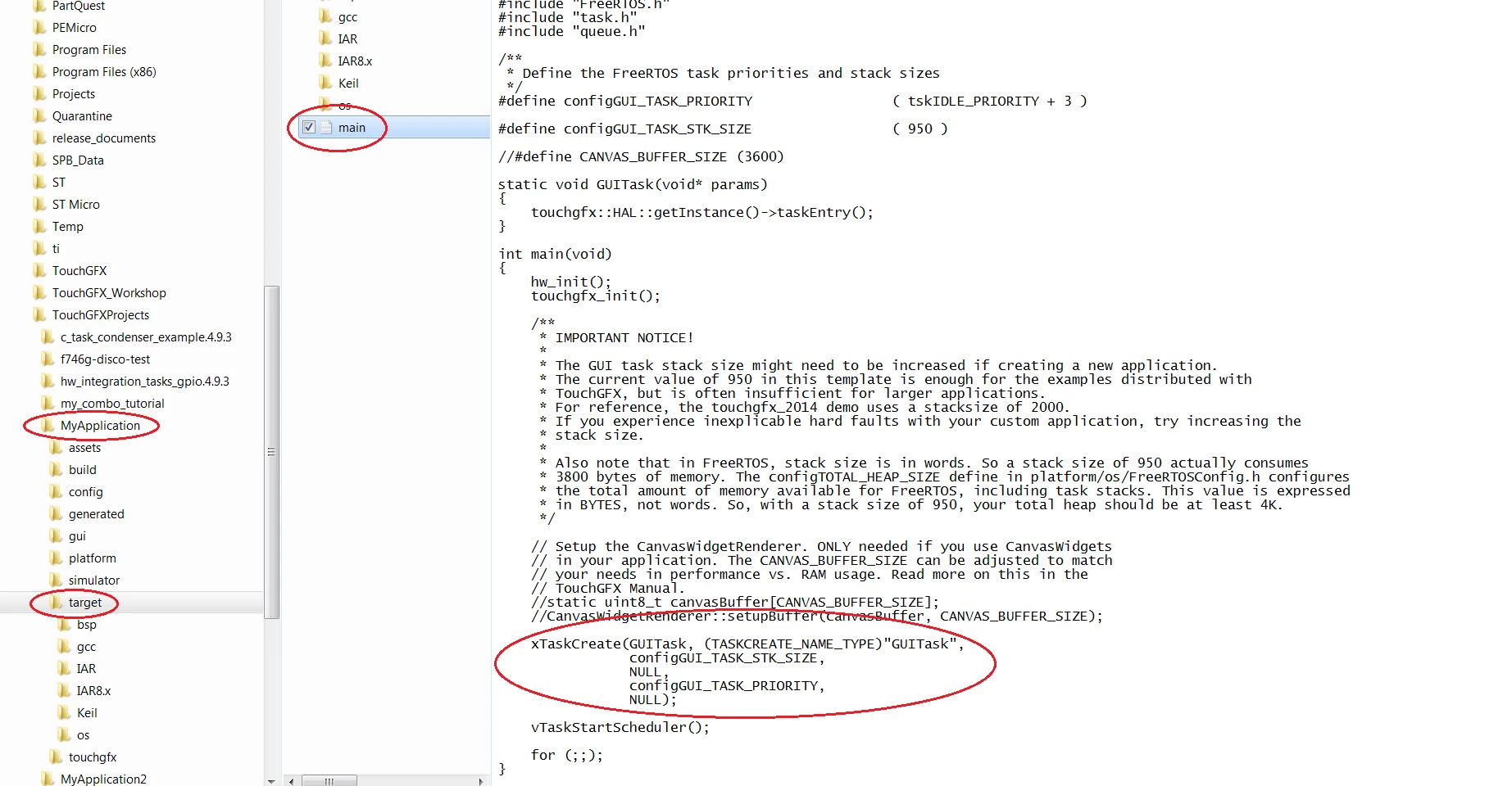

​Hi Martin,
I am trying to add ledtask and buttontask to your project. But I can't find the file like following generated by TouchGFX.
#include <touchgfx/hal/HAL.hpp>
#include <touchgfx/hal/BoardConfiguration.hpp>
#include <touchgfx/canvas_widget_renderer/CanvasWidgetRenderer.hpp>
using namespace touchgfx;
/* Kernel includes. */
#include "FreeRTOS.h"
#include "task.h"
#include "queue.h"
 * Define the FreeRTOS task priorities and stack sizes
#define configGUI_TASK_PRIORITY                ( tskIDLE_PRIORITY + 3 )
#define configGUI_TASK_STK_SIZE                ( 950 )
//#define CANVAS_BUFFER_SIZE (3600)
static void GUITask(void* params)
   touchgfx::HAL::getInstance()->taskEntry();
int main(void)
   hw_init();
   touchgfx_init();
   xTaskCreate(GUITask, (TASKCREATE_NAME_TYPE)"GUITask",
               configGUI_TASK_STK_SIZE,
               NULL,
               configGUI_TASK_PRIORITY,
               NULL);
   vTaskStartScheduler();
   for (;;);
I found two main.cpp (one in src folder and one in simulator folder) in your project. The one we want to add task is in target folder in touchGFX. I don't see target folder in your project either. Please see attached.
Thanks
Kiran
Martin KJELDSEN
Principal III
Jun 3, 2019 8:14 AM UTC
Hi.
You're right to be confused. If you generate the project using CubeIDE you will not have the same type of main.cpp as you refer to. You could define the tasks through CubeIDE/CubeMX. The task definitions will go to Src/main.cpp. e.g. for the default task:
 /* Create the thread(s) */
 /* definition and creation of defaultTask */
 osThreadDef(defaultTask, StartDefaultTask, osPriorityNormal, 0, 4096);
 defaultTaskHandle = osThreadCreate(osThread(defaultTask), NULL);
And the handler for the default task which enters the main event loop of touchgfx.
* USER CODE END Header_StartDefaultTask */
void StartDefaultTask(void const * argument)
 /* init code for FATFS */
 MX_FATFS_Init();
 /* init code for USB_HOST */
 MX_USB_HOST_Init();
/* Graphic application */
 GRAPHICS_MainTask();
 /* USER CODE BEGIN 5 */
 /* Infinite loop */
 for(;;)
 osDelay(1);
 /* USER CODE END 5 */
Hope this helps.
/Martin

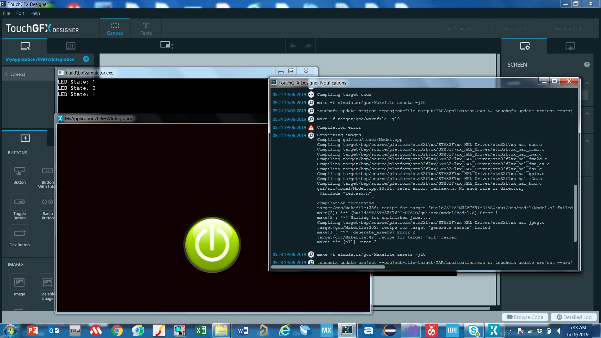

KMunj
KMunjAuthor
Jun 19, 2019 12:53 PM UTC
​Hi Martin,
Sorry for the delay.
When I did HW Integration project using TouchGFX10.0, Simulator works fine, but when I give "Run Target", I get following fatal error;
"Model.cpp:10.21: Fatal error: ledtask.h No such file or directory #include "ledtask.h". I followed same steps as your project using TouchGFX4.9. I can't go back to 4.9, since it's not available on ST Web. I have ledtask.h and ledtask.c in the Target folder (same as your project). I tried with F746g-Disco (Rev 1.1) and F769i-Disco (Rev1.1).
In both cases I get the same error. Please see attached.
Another problem with TouchGFX10.0 is if I use Rev2.0 version of both the Disco boards, it doesn't produce the Target folder in the Project Directory like 4.9 did.
Thanks
Kiran
Martin KJELDSEN
Principal III
Jun 20, 2019 7:03 AM UTC
4.10.0 is the first official ST version, so you cannot download it anywhere anymore, true.
Could you compare the makefile before and after the upgrade? (You have the original zip). The upgrade may have removed the include of ledtask.h from the makefile.
/Martin
